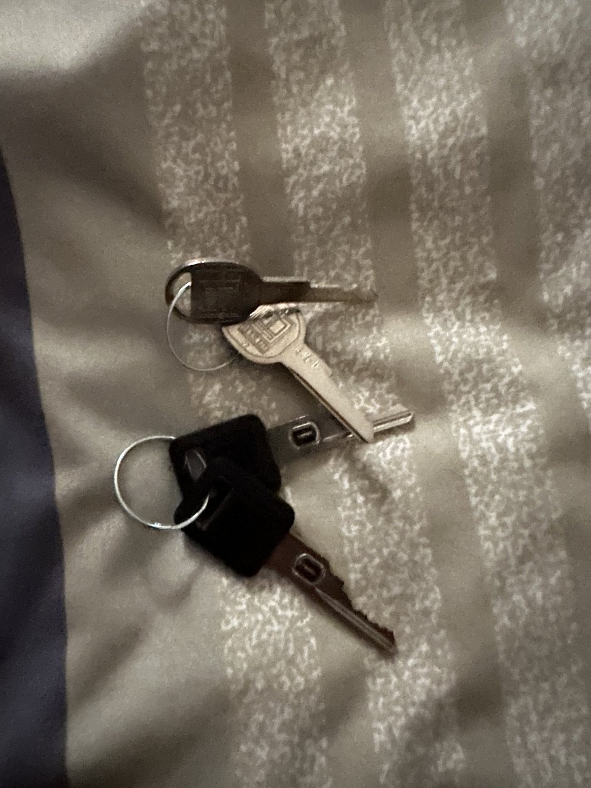

My buddy told me where there was a key shop that has the old “chip reader” from the dealer back in the day. Sure enough, read the key code and cut me new keys. Now I have extras. Still waiting on my key fob.
Could he do Goblin (Cobalt) keys? Would he be overwhelmed if he started receiving keys to duplicate? How much would he charge?
I have a single key for my Goblin and would like to have a couple spares.
All you have to do on the c4 Vette is measure the resistance of the chip with a dvm. The chip is just a resistor and there are only a few possibilities that it can be. Order the blank with the correct resistance and any key cutter can handle it from there.
Cobalt has to have the correct blank with the correct chip cut and then the programming is done by/in the car, As long as there hasn’t been 10 keys already programmed and you have a good key. Local locksmith supplied the key and cut for about $25.
This dude had the machine, the keys and the cutter. I didn’t have to do anything but pay him.
cobalt and all newer GM vehicles are easier. Get a key cut that is made for passkey. (I’ll get the GM part number when I get home). Get it copied from your key. Go to goblin and put original key in, turn to run (not start). Turn to off and Pull key out, put in new key and turn to run. Turn to off position and new key is programmed.

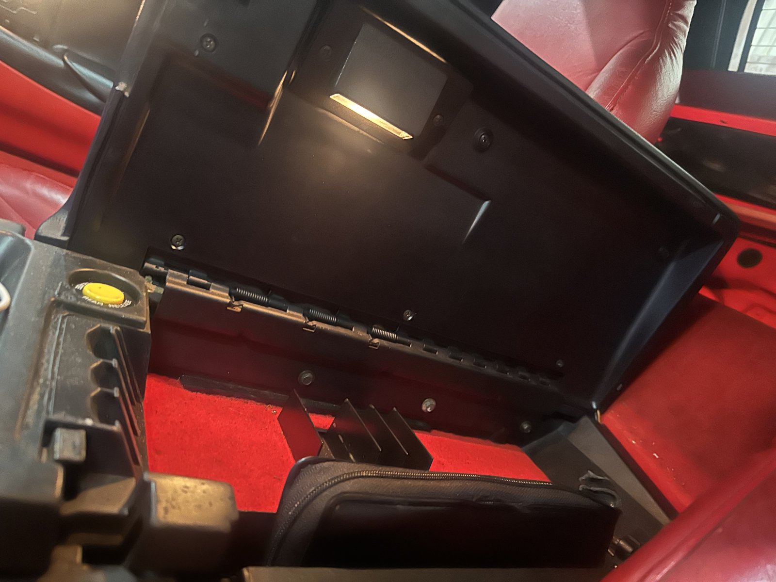

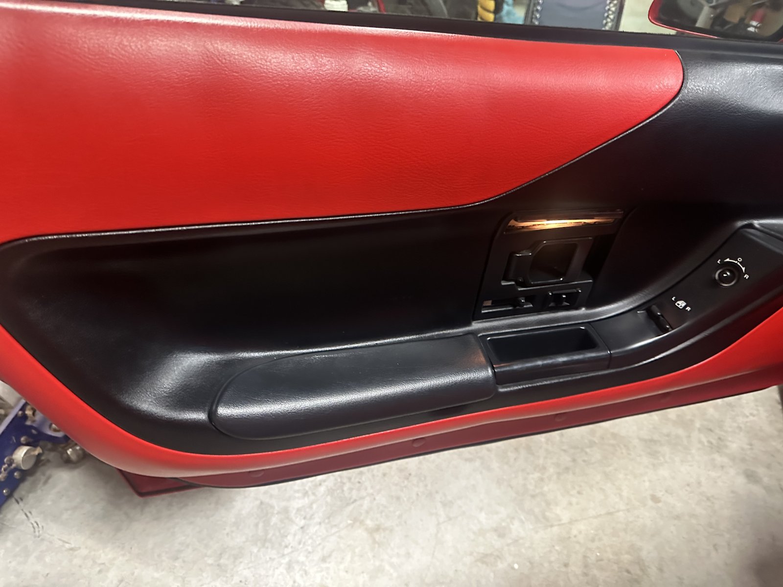

Things that just make sense.
glove box light, with lid that locks
back lockable storage
Armrest storage
