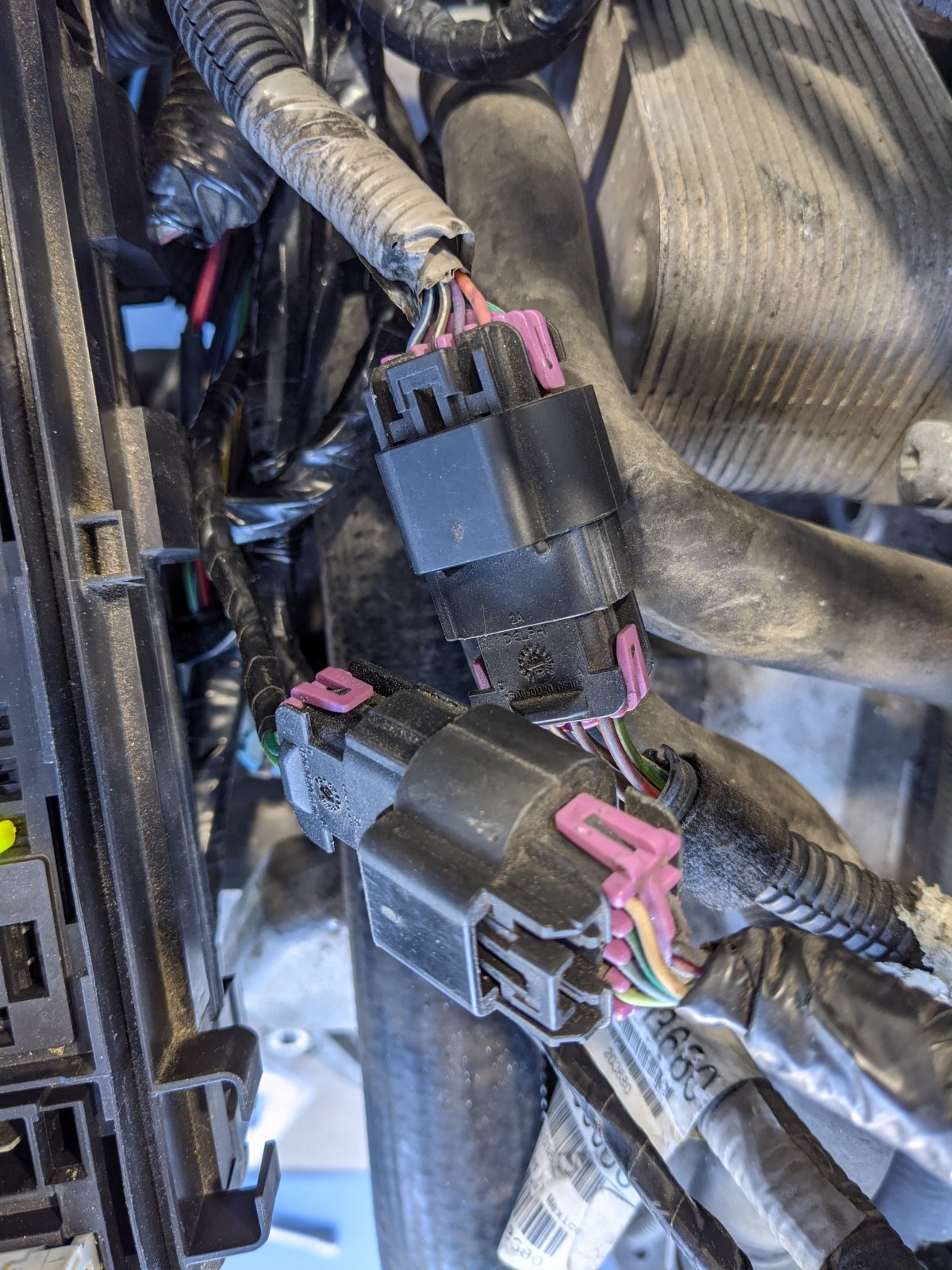

The gray wire there went to the taped union. Is that wire needed (for the info buttons, I mean)? I think Lonny said to keep the green white stripe and pink wires... Both go to the cluster plug.
I think it need to be kept. Hell, extend it to the cluster, when you wire it up, you’ll know if you need it or not.

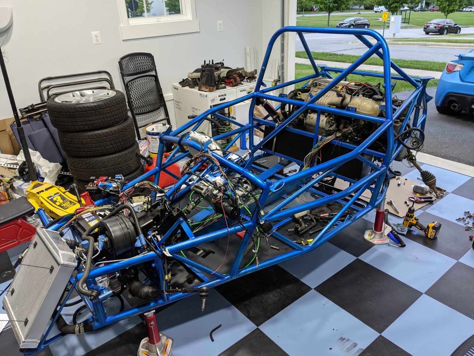

An emotional day but I'll figure it out. Got the wiring harness laid into the car so I could test fire it up. Turn switch on, fuel pump primes, turn starter on, gauge cluster turns off and reboots basically. Nothing happens. Starter does not engage. I did the wait 10 minute thing. Didn't make a difference.

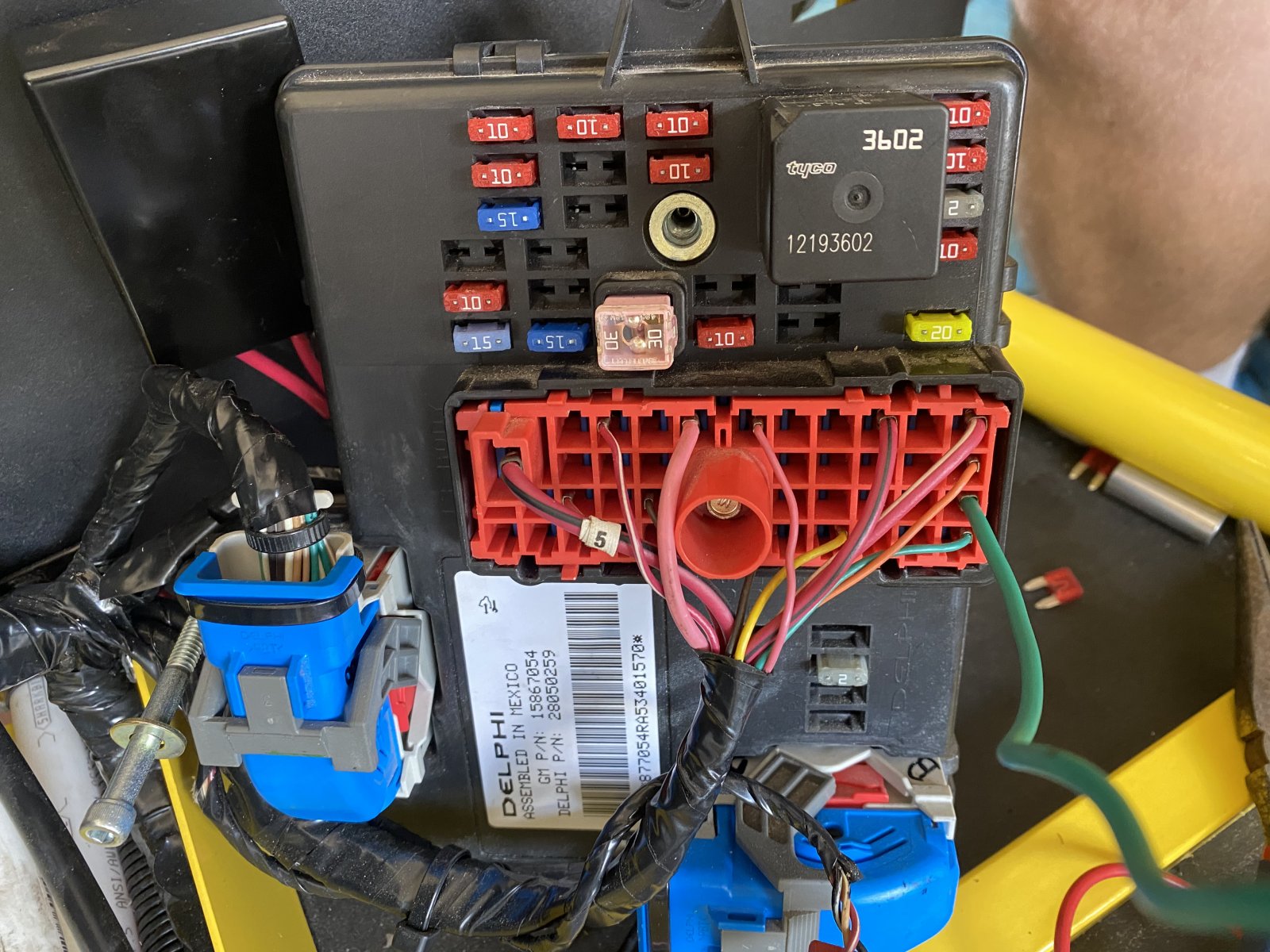

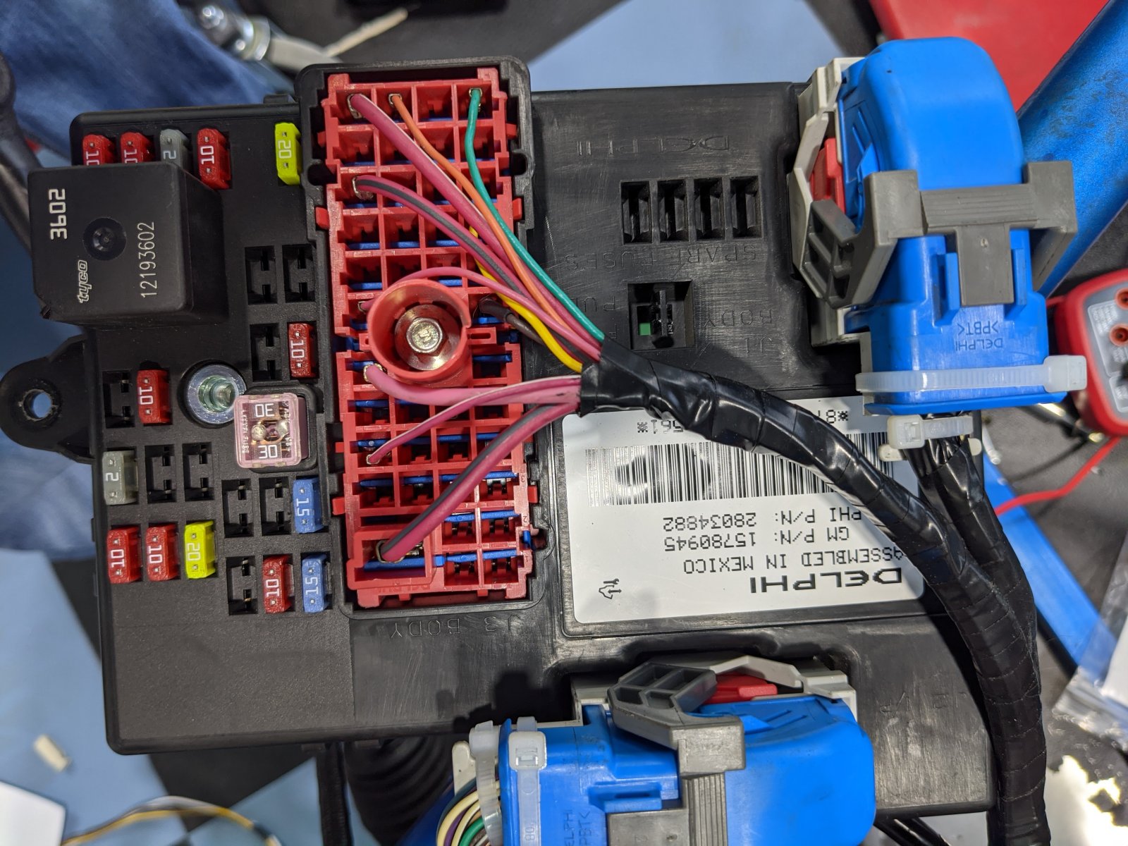

I continue looking at fuses in the fuse box and BCM. Figure out that a fuse is missing on the circuit for HVAC/IG in the BCM. Plug 10A fuse in there, starter comes to life. Smell of gas in the exhaust. No fire. Try again. Nothing. I start to hit the accelerator pedal and whoosh. Car stops trying to start. Relays are clicking but nothing.
I think maybe I killed the battery.
I try to charge it and I hear the relays in the BCM and the fuse box clicking in weird patterns - like it has a dead battery.
I find and try a new battery. I hear a HARD click and nothing. It then also starts not wanting to try or even run ACC. I'm wondering if maybe the starter solenoid is shorted internally and I just got lucky. Or something else is shorted (which could be real difficult to find. I'm going to replace the starter and do some new grounds. They're all really rusted and corroded. I got my battery unhooked and charging. Intermittent issues are always the worst!
I've got the battery connected to the starter. The starter then runs to the fuse box. There's a connection for the alternator in there somewhere (I think off the starter).

Find the missing 10A fuse ;) I know where it is....

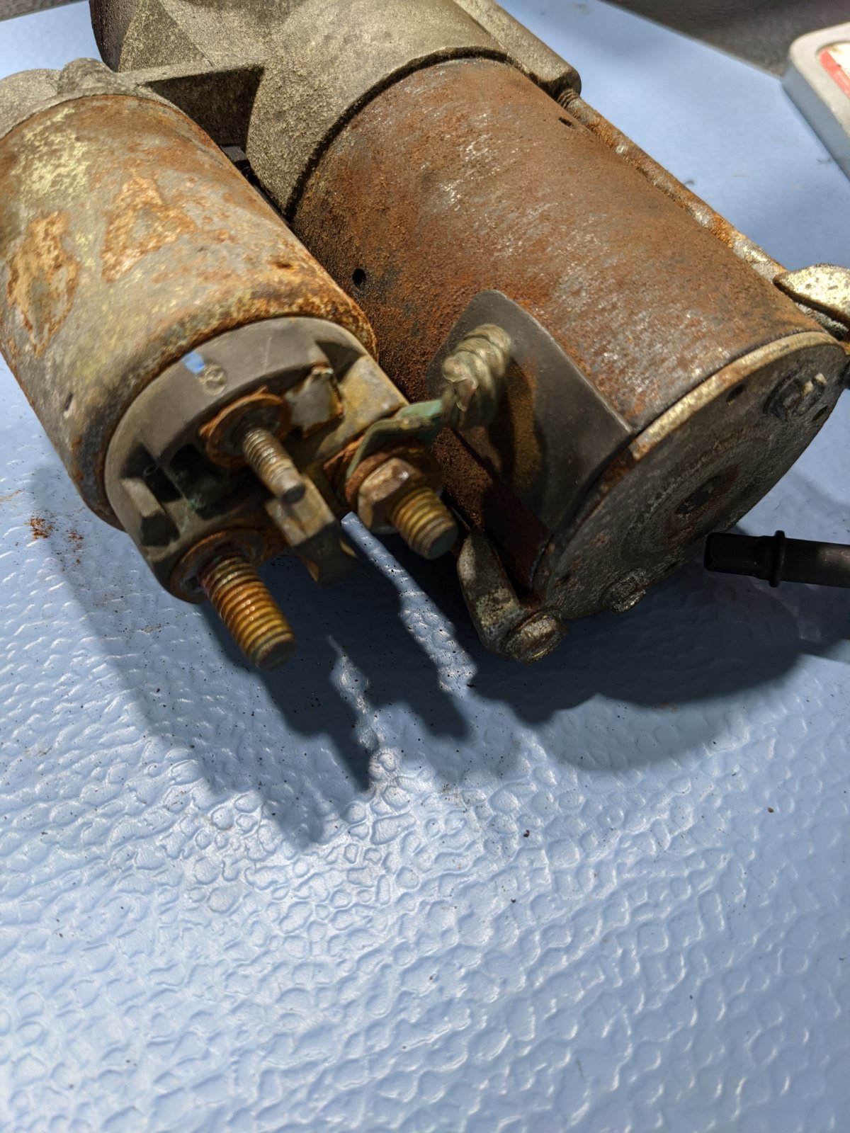

I also discovered that the starter is intermittently engaging but then not disengaging... Which is really bad for a multitude of reasons. Mainly being that it creates a short and is horrible for the battery. New one on order.
I figured that out by turning the engine by hand (because I was worried something was making the engine locked and not turning over). Turns out you could hear the starter gear turning against the flywheel. It eventually disengaged and the motor spun freely. Fun times.

This is good to know (it's not hooked up). Tonight I removed the old starter and freshened up the wiring between the fuse box and starter. New starter should be here Saturday.

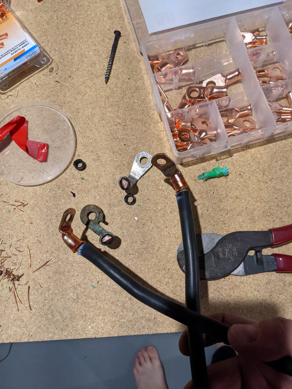

Coming from somewhere where we never see rust, that’s like been in the bottom of the Gulf for years, type bad. o_O

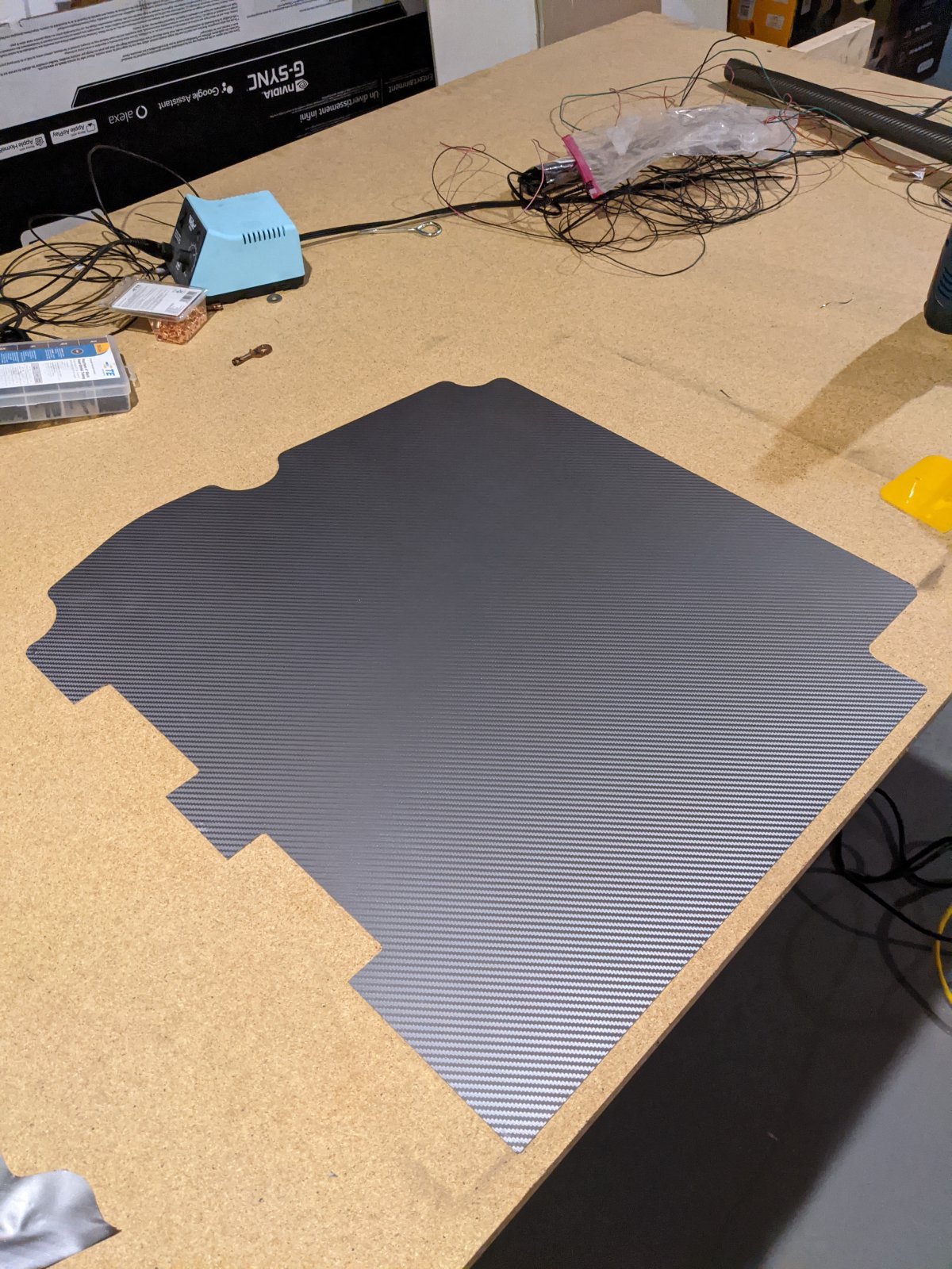

While I'm waiting on my new starter, I worked on wrapping some of the aluminum panels for the firewall. Going to do the same to the floor pan. Really happy with the way it looks. Whether it holds up or not being so close to the engine :confused:

New starter works like a champ. No issues with it sticking engaged. However still no start. Fuel no ignition. I start looking at the coil on plug cable and what do you know, it's not plugged into the right area. Swap the connectors and BAM. The neighborhood is awake.;)
