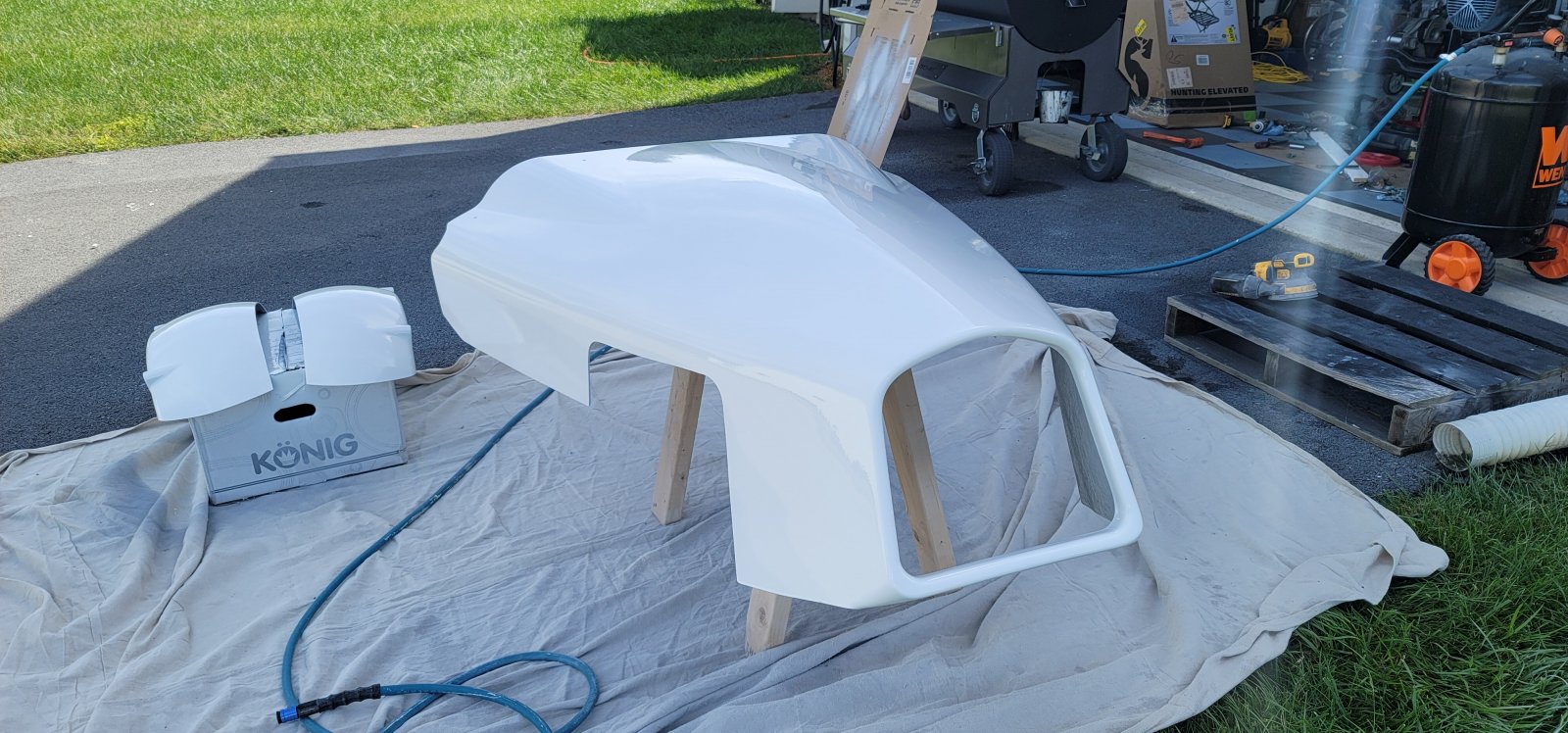

Got the hood and fenders painted today as well. I decide to just wrap the side panels. The single stage paint worked out incredibly well. I was impressed.

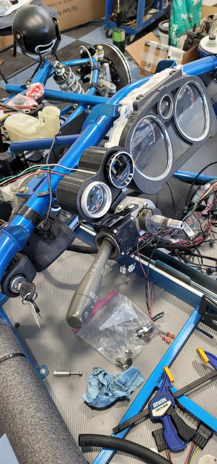

Steering wheel parts in.

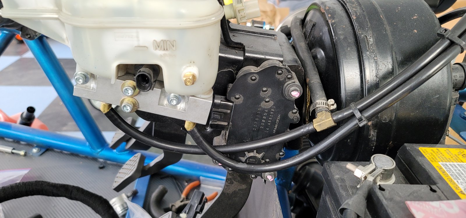

Drilled and tapped the mount for my gauges. I don't like where they are so I'll probably do that again.

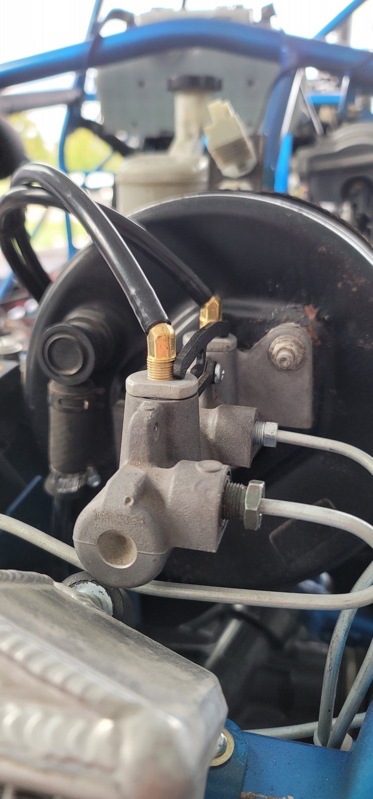

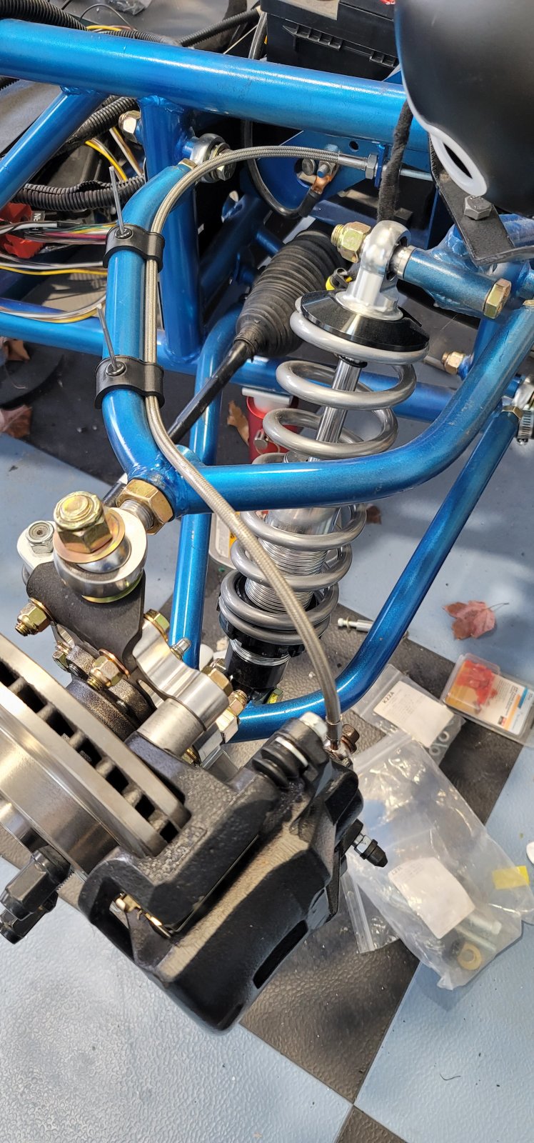

Front brake lines are in and ready. Tightened up a few other things.

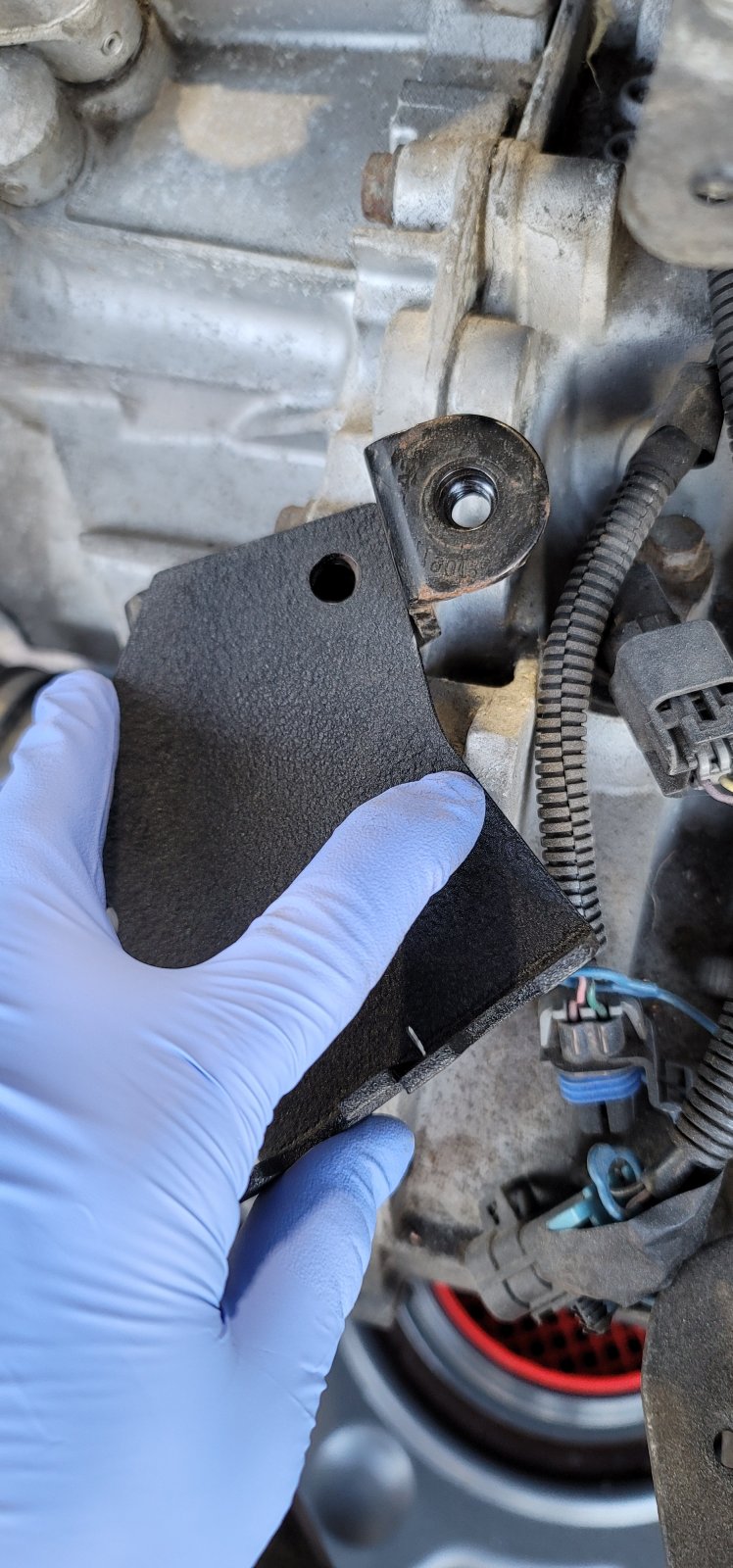

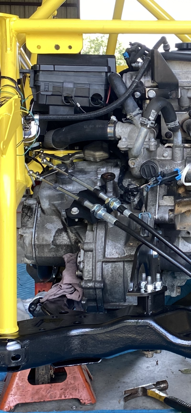

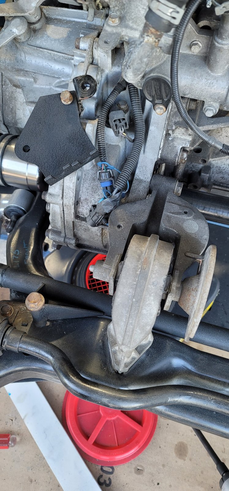

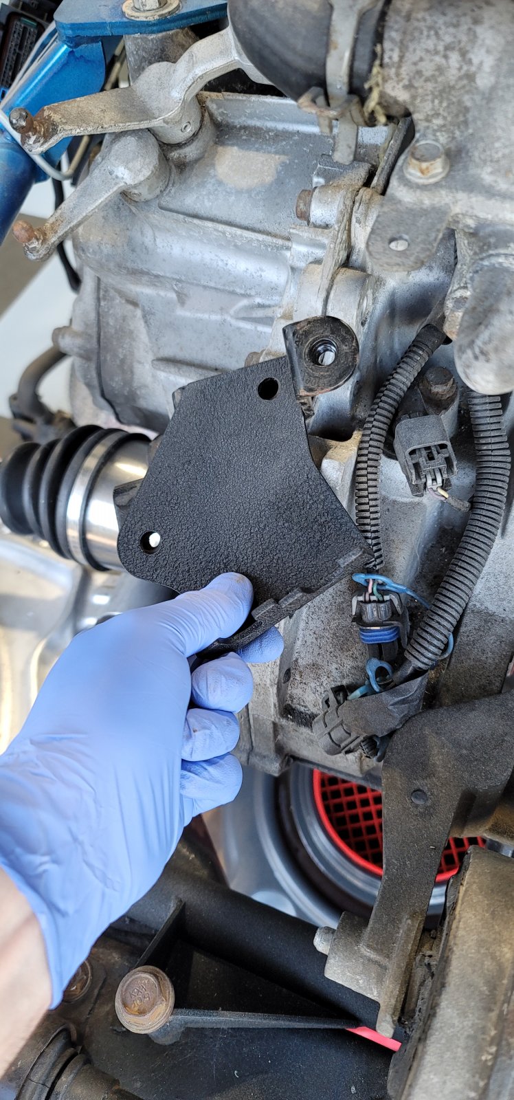

Started to mount the plate for the shifter cables. Something seems off. Bracket contacts the engine. I'll have to shave that off a bit. Also. The cables seem like they'll kind of be in the way of the mount. Not sure yet.

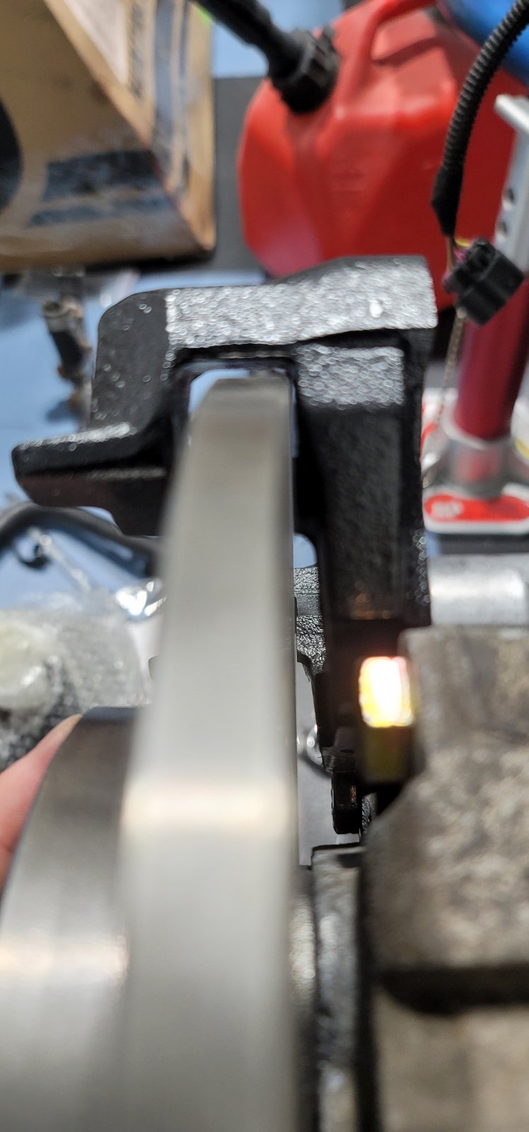

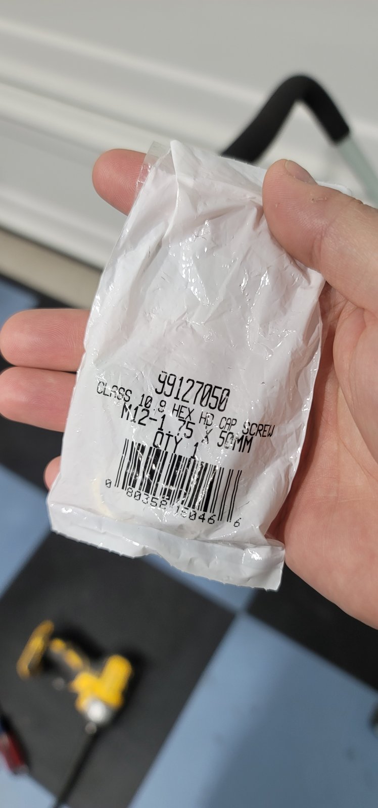

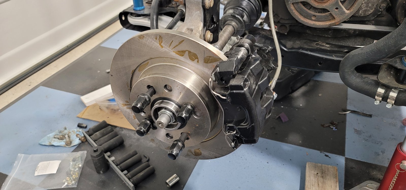

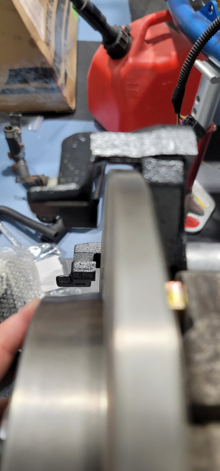

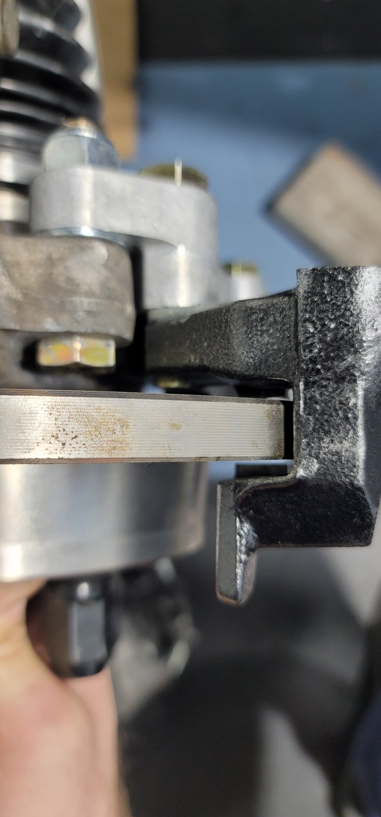

Started to mount up the rear brakes. (Solstice) with parking brake... Something off here. I need longer bolts.
27172
speedhacks
To be completely transparent, this is likely because I purchased completely new wheel bearings and there's a small shim there that I did not reuse.
Don't quote me, but I think DF is including these spacers in newer kits.

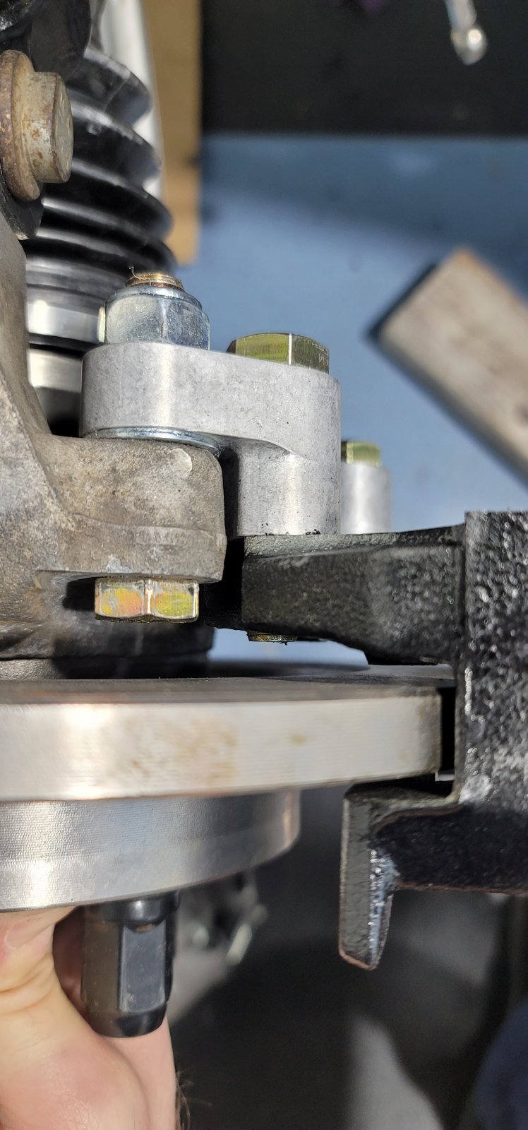

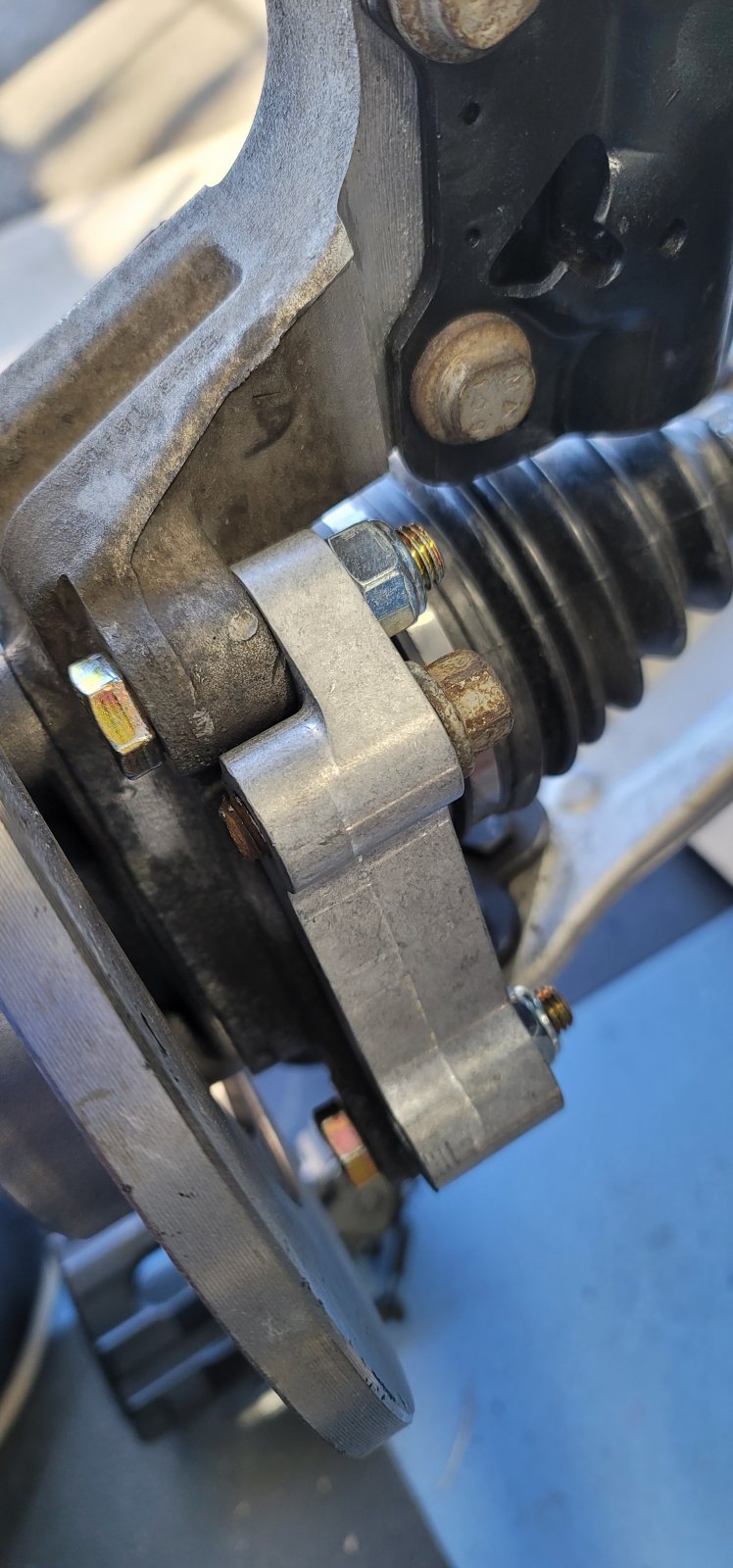

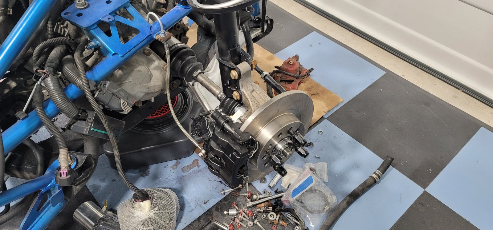

Rear brakes on!!! I think this looks correct. Not a whole lot of photos out there.
The springs were slightly bent so in fixing that I ended up scratching up the paint on the rotors.
I tried working the shifter cables this past weekend. The bracket I have seems, odd, maybe incorrect?? The cables will probably bend underneath the rear mount, but something still doesn't feel right. Also, the bracket makes contact with the engine block. I can shave that or the bracket, or shim it.
