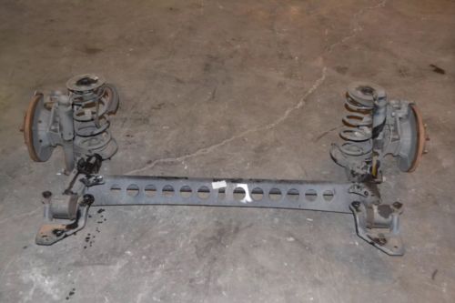

I think I have located a rear axle beam here local. I have attached a pic of the beam/axle I am talking about. The driver side of this car's beam seems to have 2-3 degrees of camber, while the passenger side has none.
BTW, I am now pretty convinced that the LSD is an important item on the higher horsepower cars. This cobalt is modded, and has a ton of power. When it breaks the tires loose, the passenger front tire is the one doing all the spinning and smoking. It may be different when in the back of the Goblin, but having had many cars with LSD differentials this would be no fun one-legging it all the time. ....
