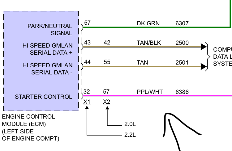

I'm referring to the purple wire with a white stripe that runs to the fuse box from the ECU. Not the solid purple wire that runs to the solenoid from the fuse box. I had codes but none that had to do with the starting system if I remember correctly. I went over it with my dad and he also thought none of the codes should matter in this situation. I can run out and get the codes again after I shower if that helps. Would the ECU spit out low voltage if any of those starting criteria were not met?

Battery voltage is 12.25. When measuring, I touch to engine block directly or that frame stud where all those grounds are relocated to. I've confirmed that the relay has a good ground. I actually ran a new ground because I wasn't getting one initially. I also replaced the relay with one I got from a gm dealership.
Using the continuity mode, I've tested the connection where the relay plugs in, through the board to where it comes out of the board. No resistance.
The plastic block the board plugs into, through the purple and white wire to pin 57 of the X2 ECU connection. No resistance.
Which all makes sense as the reading on the fuse box where the relay plugs in and the purple and white wire as close to the ECU as possible have the same reading.

I did try testing the voltage going to the ECM. At least I think. I tried measuring the battery voltage at pin 56, and the ignition pins at 3,5, and 6. I got nothing.
My technique must be wrong or something since the car does come alive a bit when the key is turned, brake lights, throttle body flap, etc.
I'm using about 4 inches of wire with the ends stripped. Seperating just a few strands to shove in the X2 pin ports, enough so I don't have to hold it. Then put the black lead to either chassis or engine and the red to the other end of that stripped wire.
Lastly, the 9v comes even when the car is turned to run, not start. It stays the same when cranking but while testing that purple and white wire I'm realizing now that I had the relay out so I will check for voltage drop with it in.
