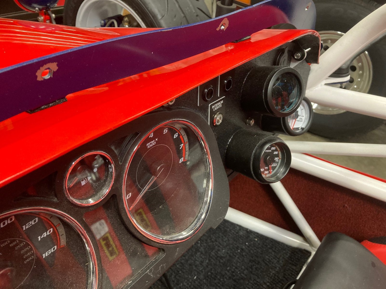

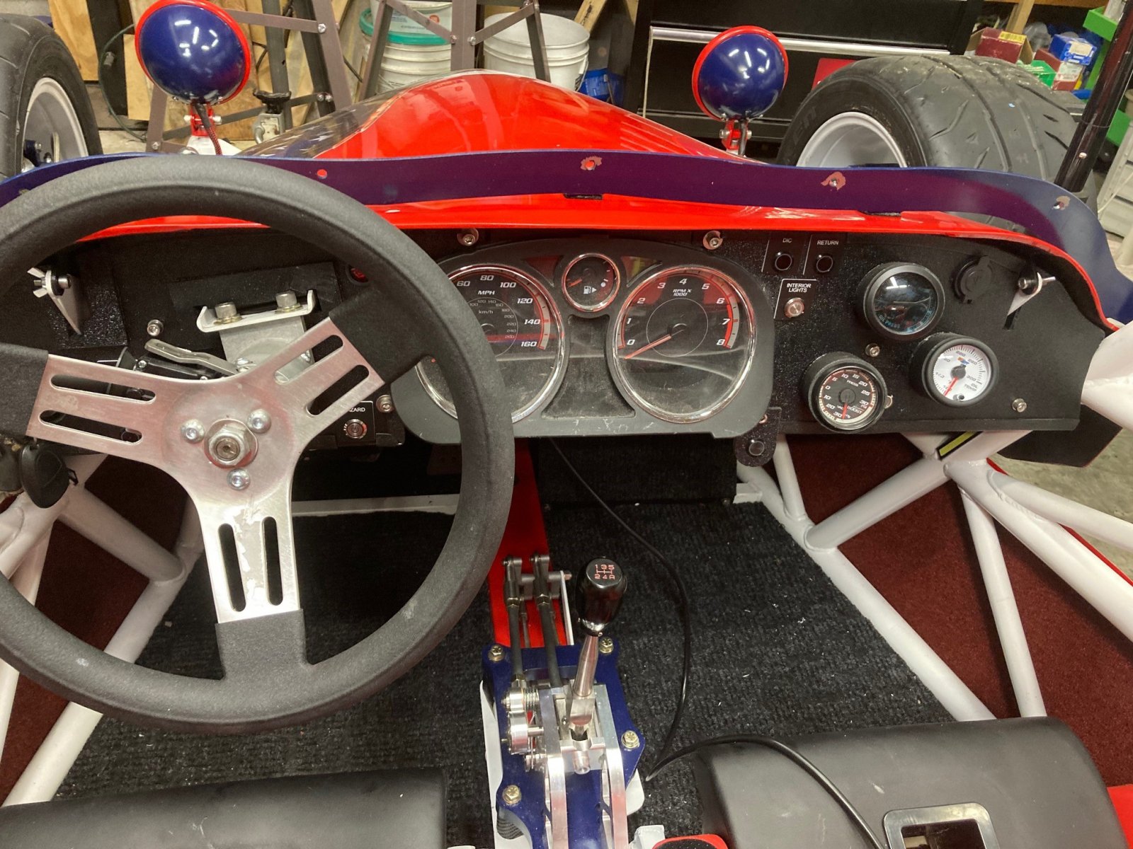

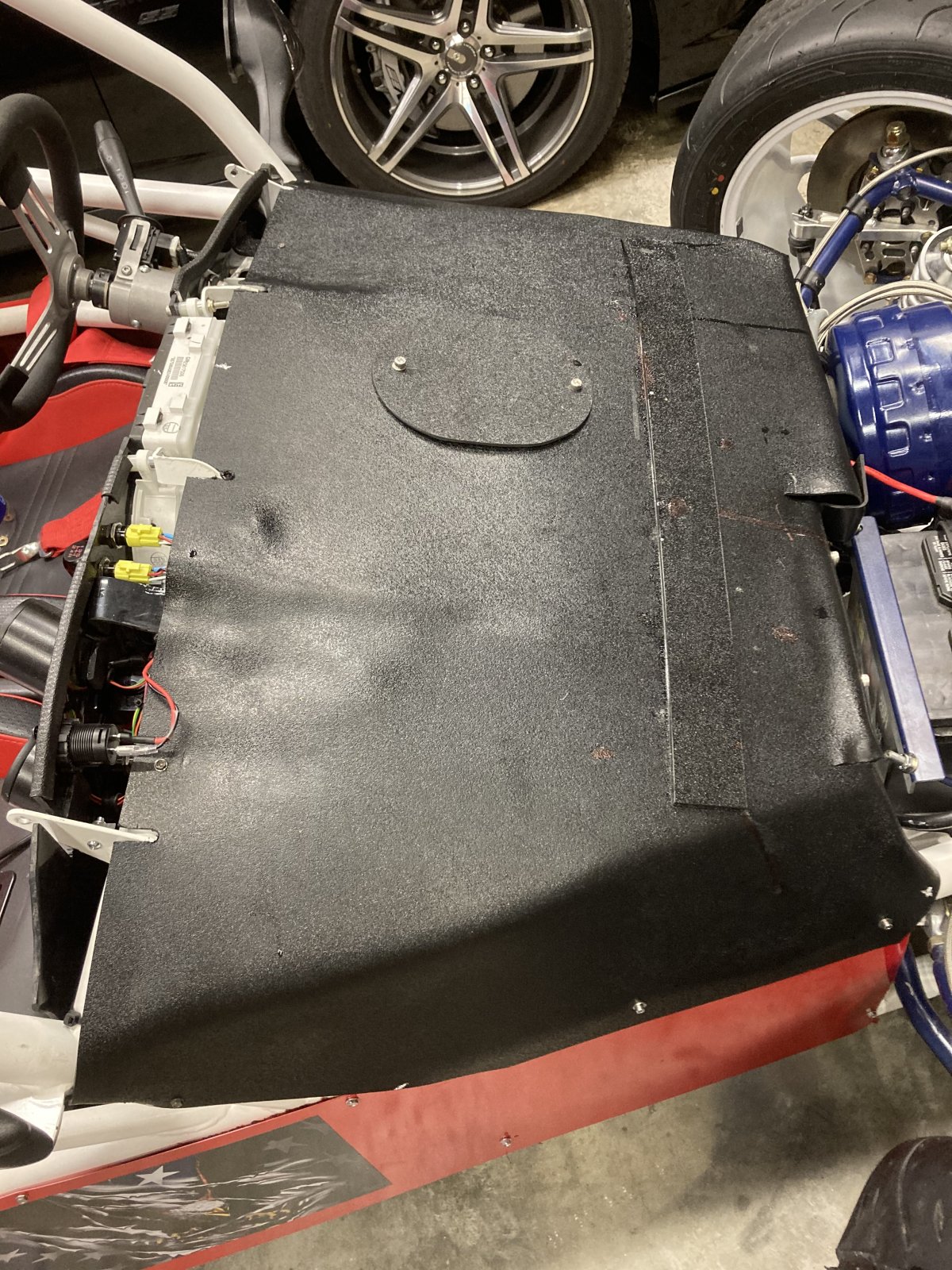

I had a request for pictures of my dash. 3/16 ABS, attached with the bolts holding the center cluster in and ABS brackets solvent welded onto the back with acetone and fastened to the frame bar. Gauge pods are ABS pipe bored out slightly & solvent welded on.
I still need to paint the white hood mounts black.
This was the first time working with ABS. If I were to redo it I could really tighten up some of the gaps. It doesn't really show up in these pictures but I matched the top to the hood without the windshield bracket in place so the gaps changed a little when it was installed.
