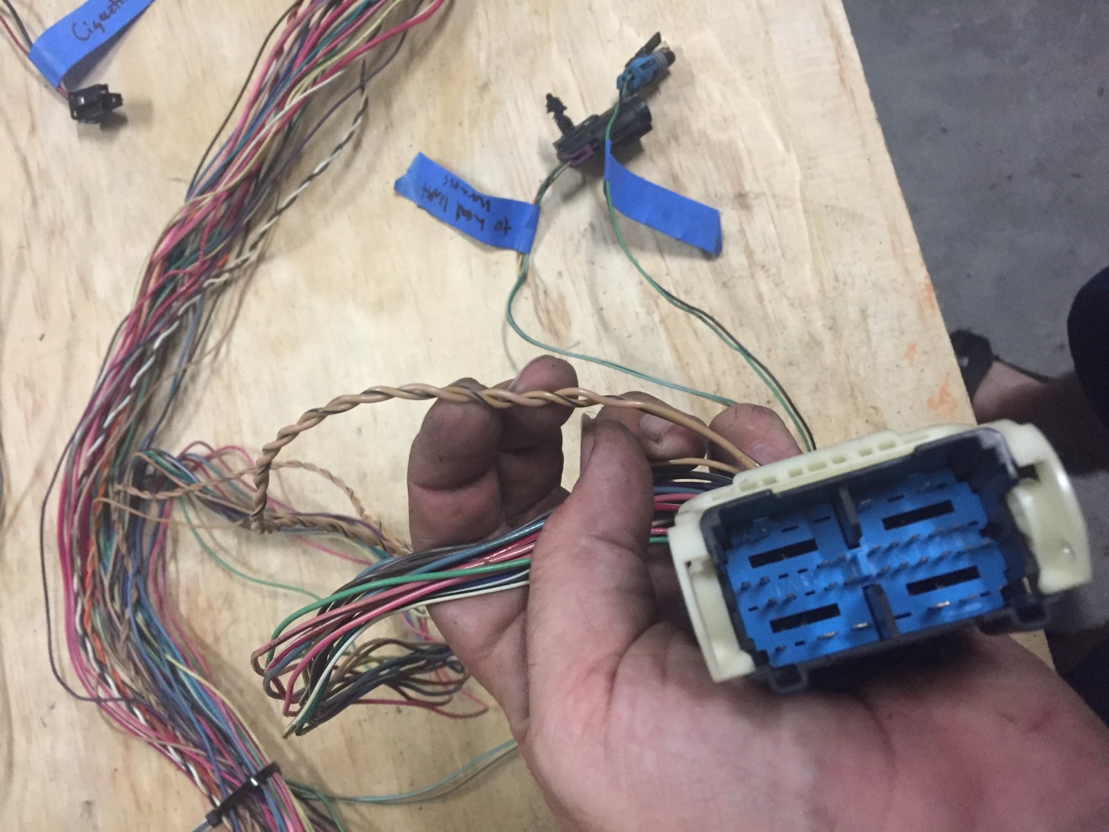

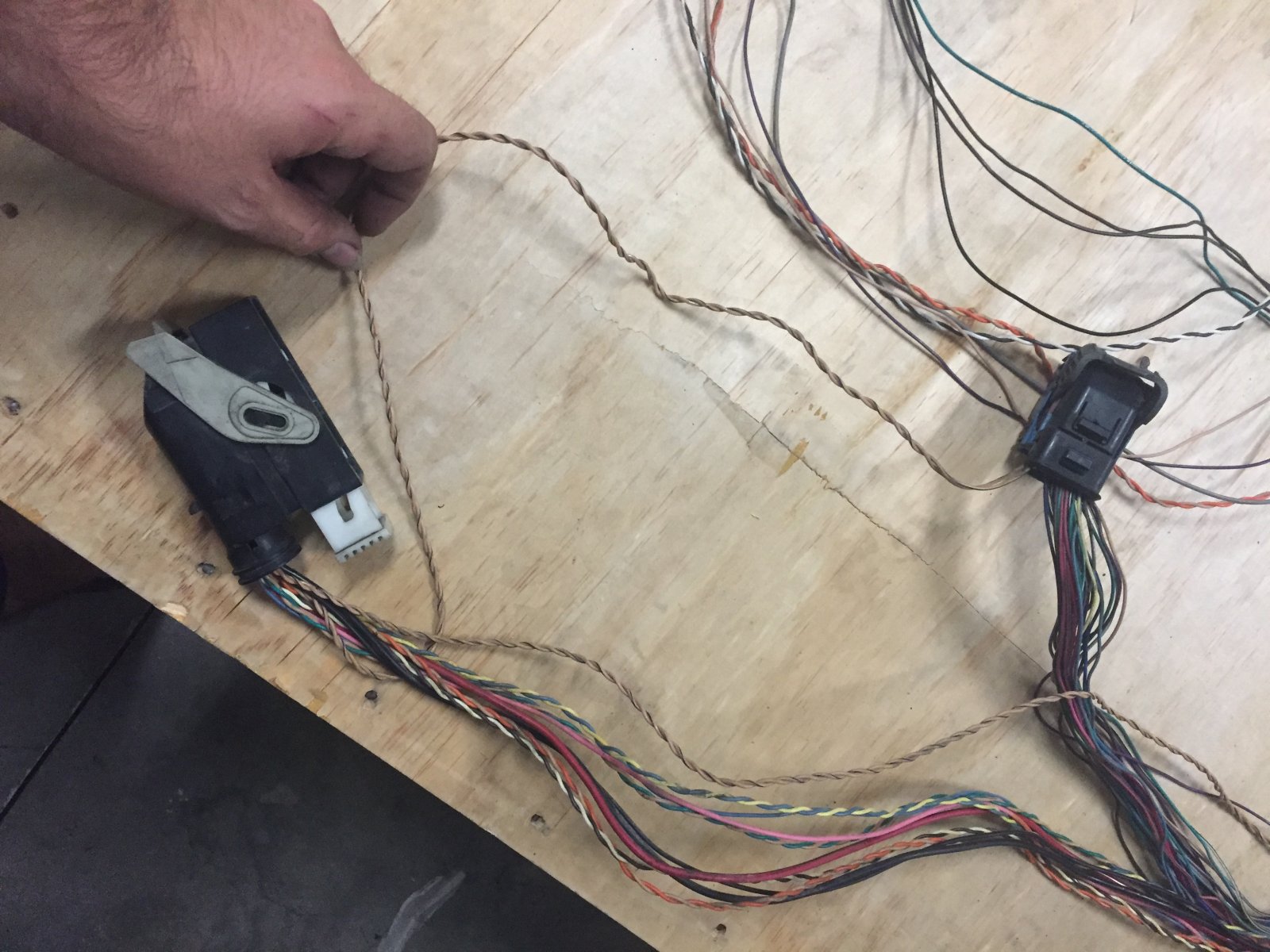

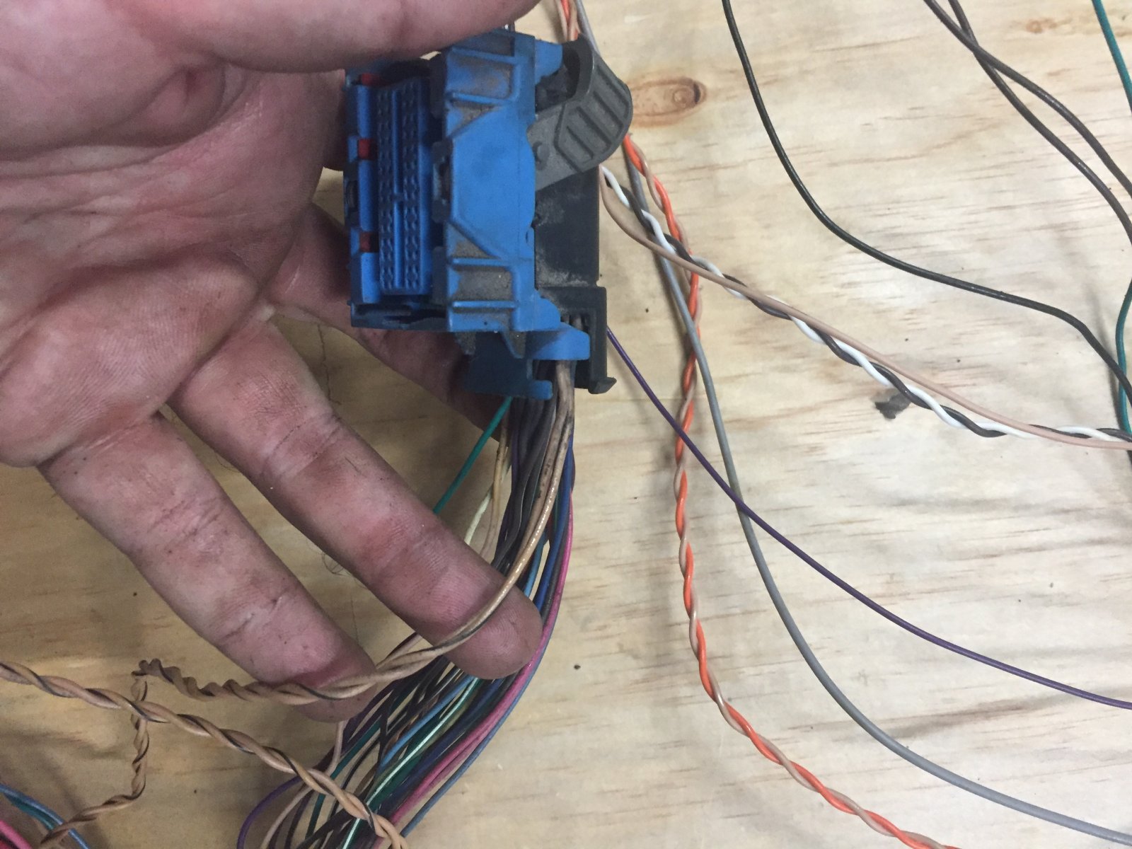

On the abs issue I snapped a couple of pictures of the tan/ tan with black stripe twisted data communication wires. The wires go from the plug in the first picture to the second plug in the second picture ( the abs/ esp module) then they go to the plug in the third picture. Since I am taking out the abs module and the plug in the second picture do I just need to connect the wires from the plug in the first picture to the plug in the third picture to maintain the data communication wires?
Correct
