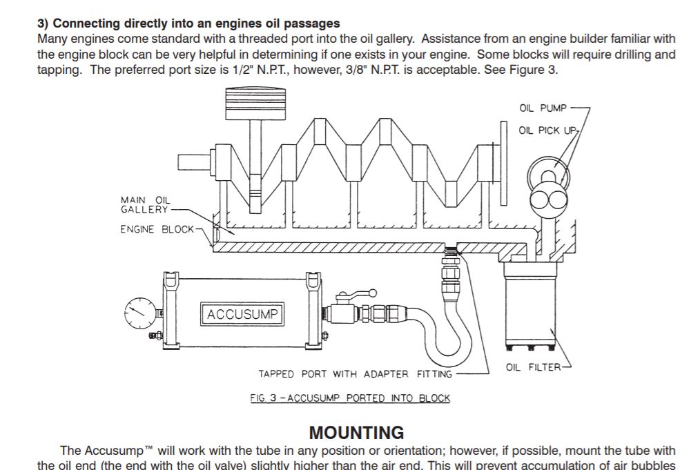

ccannx
Accusump instructions Here show an example of piping straight into oil passages. It would be nice to know if oil backflow would have any negative impact on the pump.

Fozda
Some of the Accusump kits have a check valve, some don't.
"The Check Valve ensures all the oil being discharged out of an Accusump goes to lubricate the engine bearings and is not fed back toward the pump. For use in systems where a remote oil filter or a cooler is used."
Eventually I found an article explaining how it works.
There is a diagrams showing the oil leaving the Accusump accumulator, and only flowing to the engine, not the pump.
The Ecotec has a Rotor Oil Pump with 9 internal lobes, and 8 external lobes. I haven't found any info yet telling me if it will pump air or not.
Even if it pumped air, it wouldn't be able to create as much pressure as if it was pumping oil so the accusump will take over forcing the check valve closed and lubricating the engine until the pump is back to pumping oil.
I doubt oil backflow would have any negative impact on the pump.
Thanks for the instructions. It helps me understand it.
