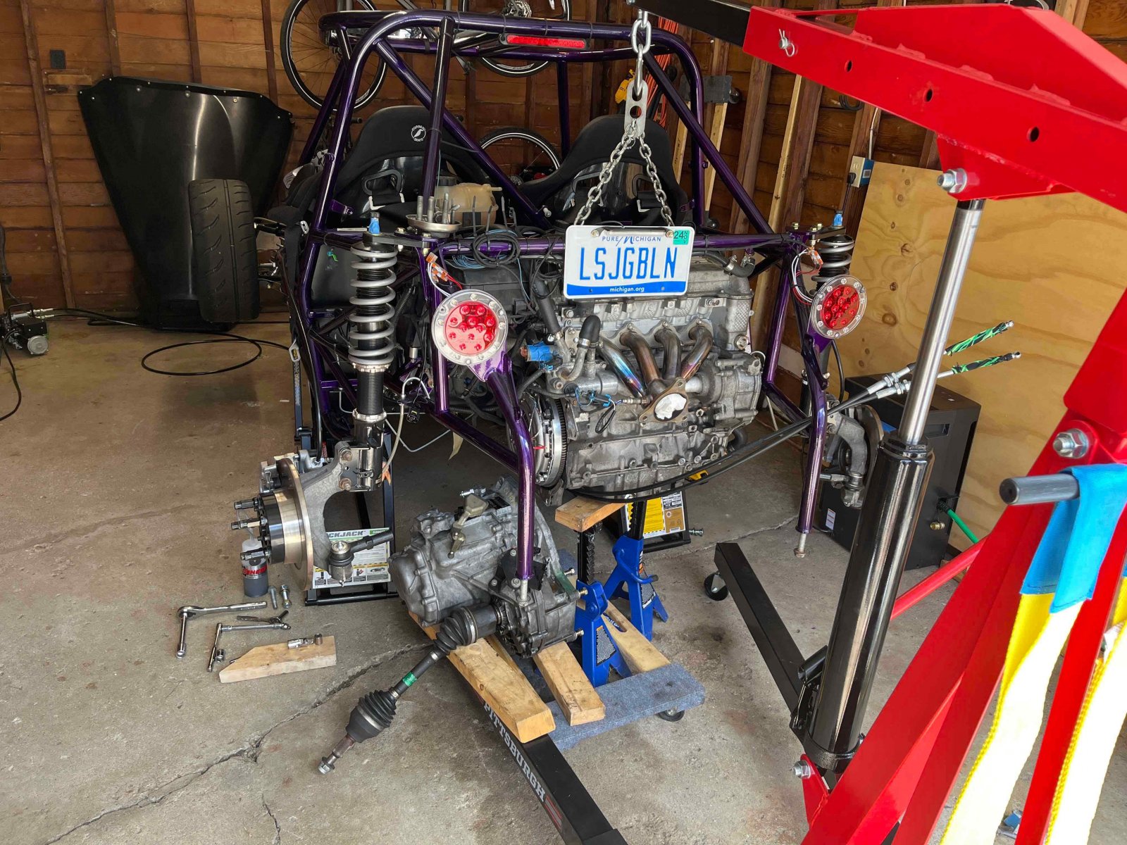

neodied
The first half (easy half) can be done! Just me and my tools and some swearing. Yet again the Quickjacks were super nice to have easy adjustability on the frame height. TBD whether flywheel bolt clearance is actually the issue

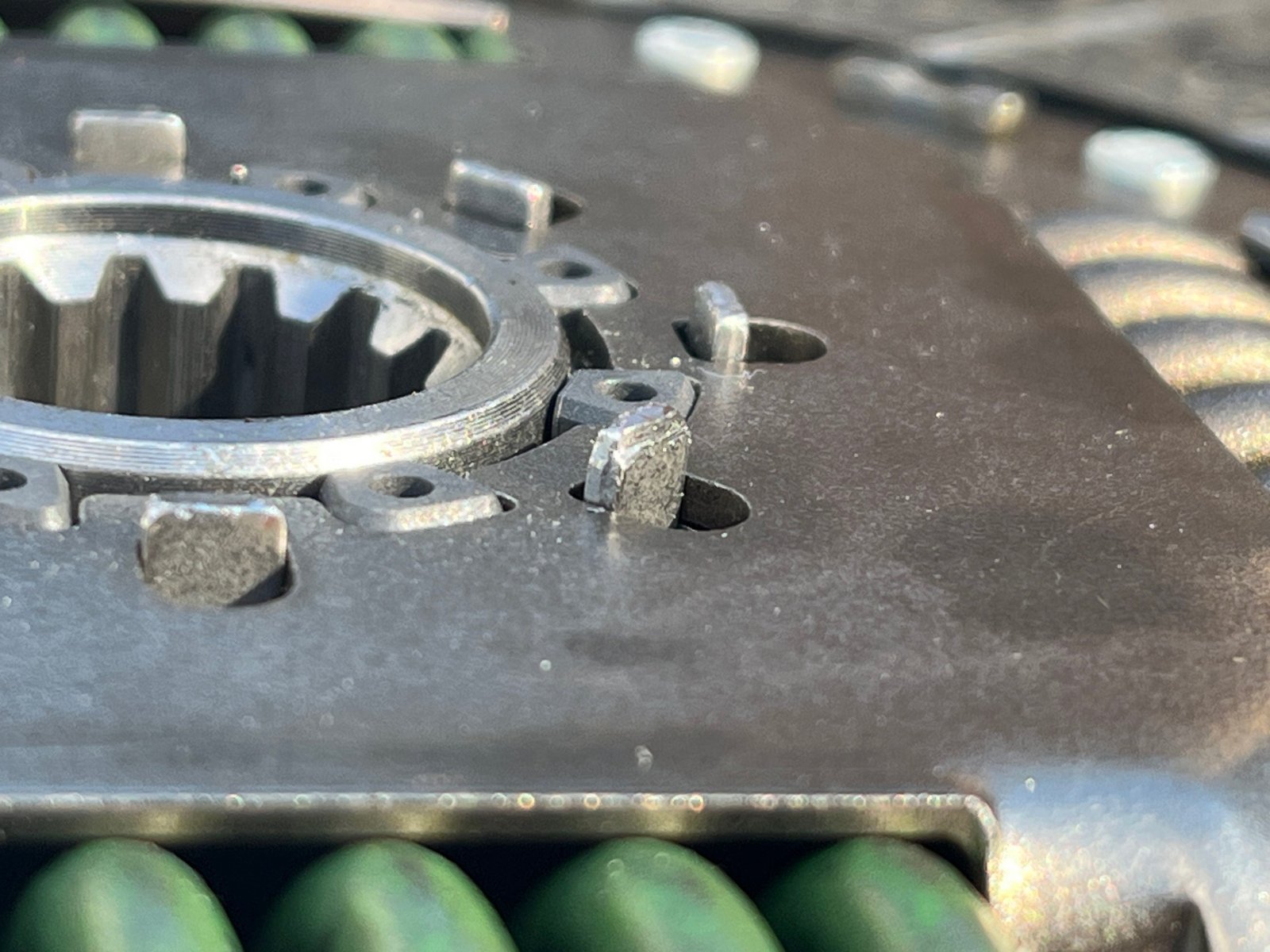

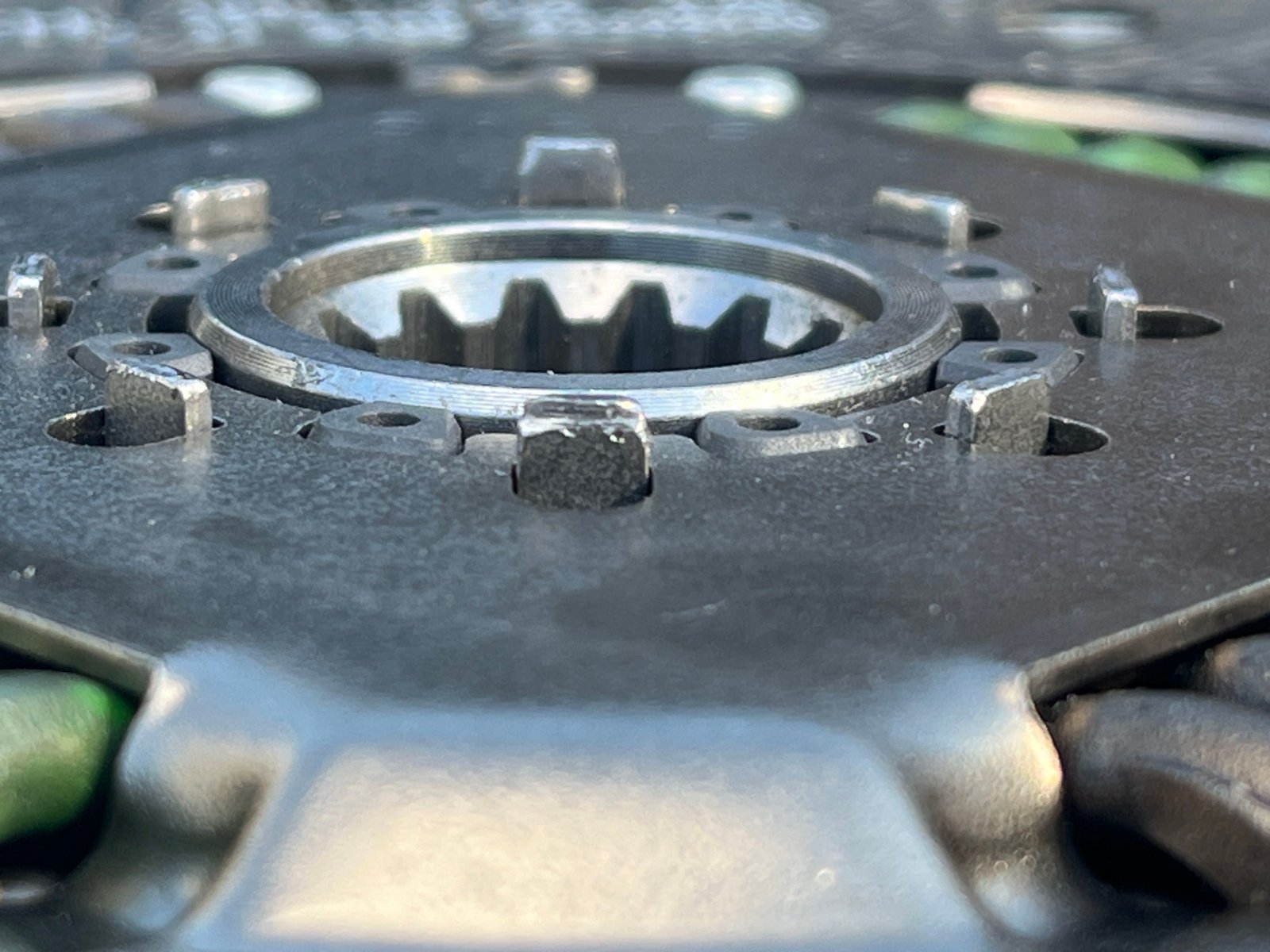

neodied
Pulling the clutch apart showed wear marks on two of the eight small tabs on the back side of the clutch disc. The two tabs with wear marks were 1-2mm taller than the other tabs which had no wear marks. As far as I can tell, there's no need for the two taller ones to stay taller, so i ground them down to match the other tabs' height.
Hopefully this next weekend I can get the trans back up in there and check for the sound again. This time I put a vacuum cap on the clutch line connector to hopefully minimize the amount of air that gets in and bleeding that needs to be done when it goes back together.
