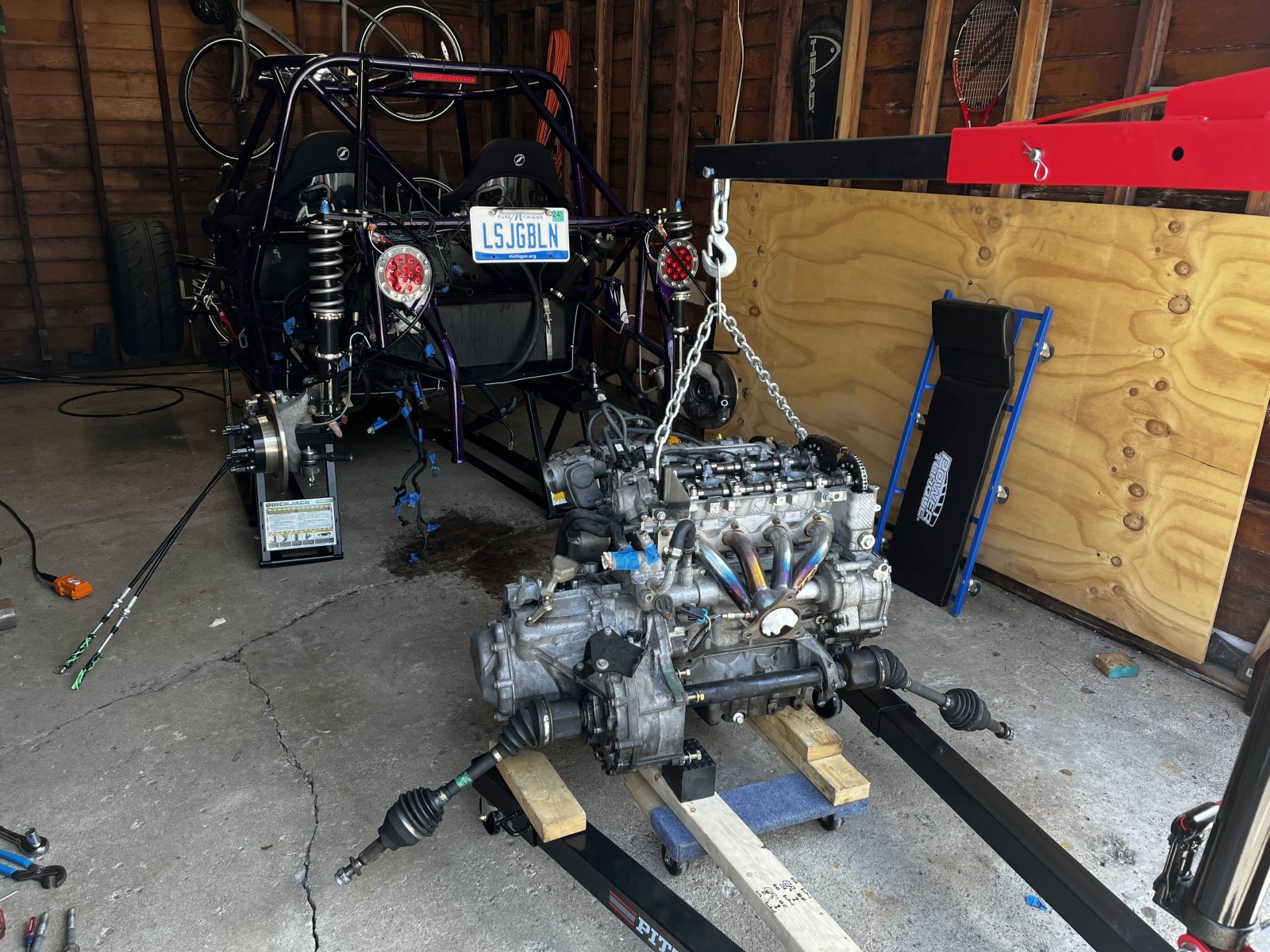

Finally(!) got some uninterrupted vacation time while the kid is at daycare and the wife is at work. Yesterday and today I disconnected (and labelled) all the chassis to powertrain electrical connections and dropped the subframe, then the engine+trans.
QuickJacks have been very helpful. They collapse lower than my floor jack so I can get them under without raising the front end up on a ramp. They lift higher than my floor jack too. Once they are up at max lift, they feel quite sturdy. Being able to pause the lift at any point and check for interferences was very convenient while lifting the chassis up over the engine+trans.

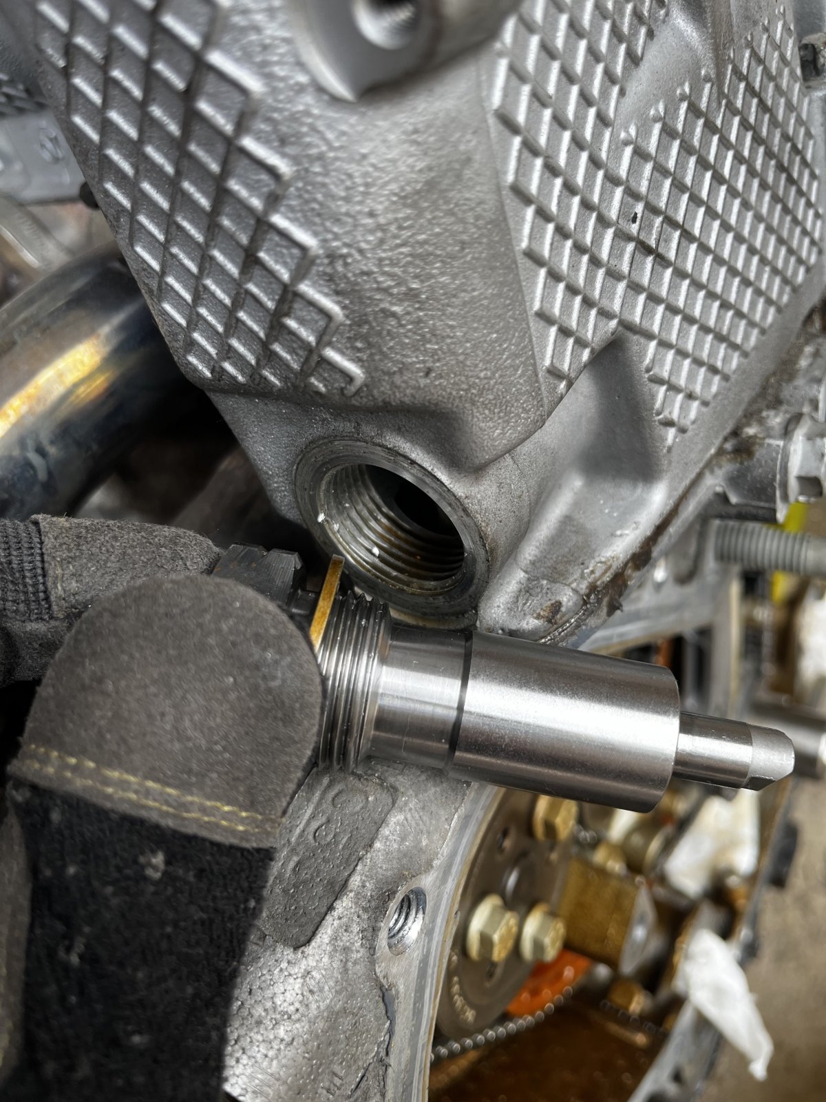

Timing chain & guides maintenance done. I found some metal shavings in the timing chain tensioner threads which worry me a bit. I probably should drop the oil pan and check for other metal bits. Maybe clean out the oil pan and check it again after running it for a while.

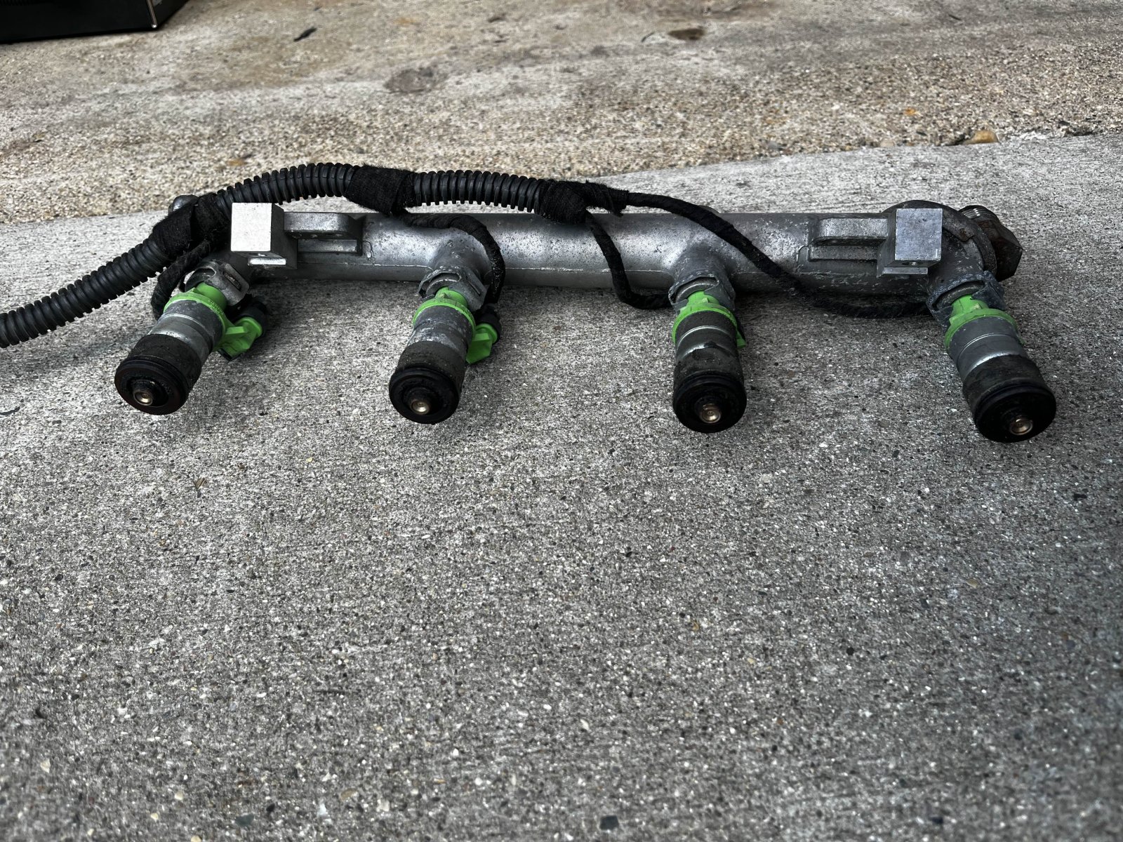

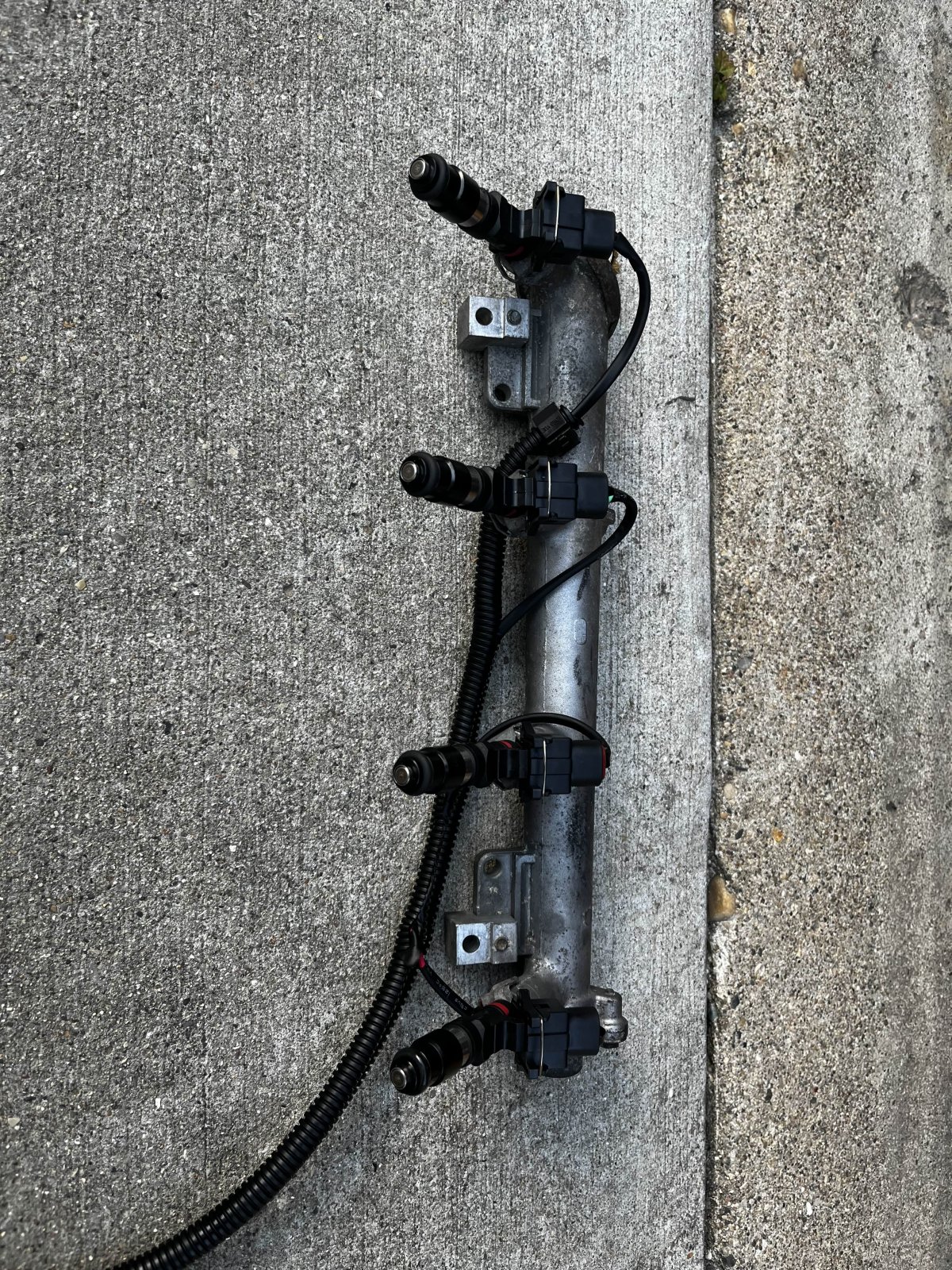

Fuel injectors swapped, which was actually way easier than I expected. After pulling the old injectors, I checked the intake valves for carbon buildup and cylinders 1-3 had some light deposits, but it didn't seem too bad.

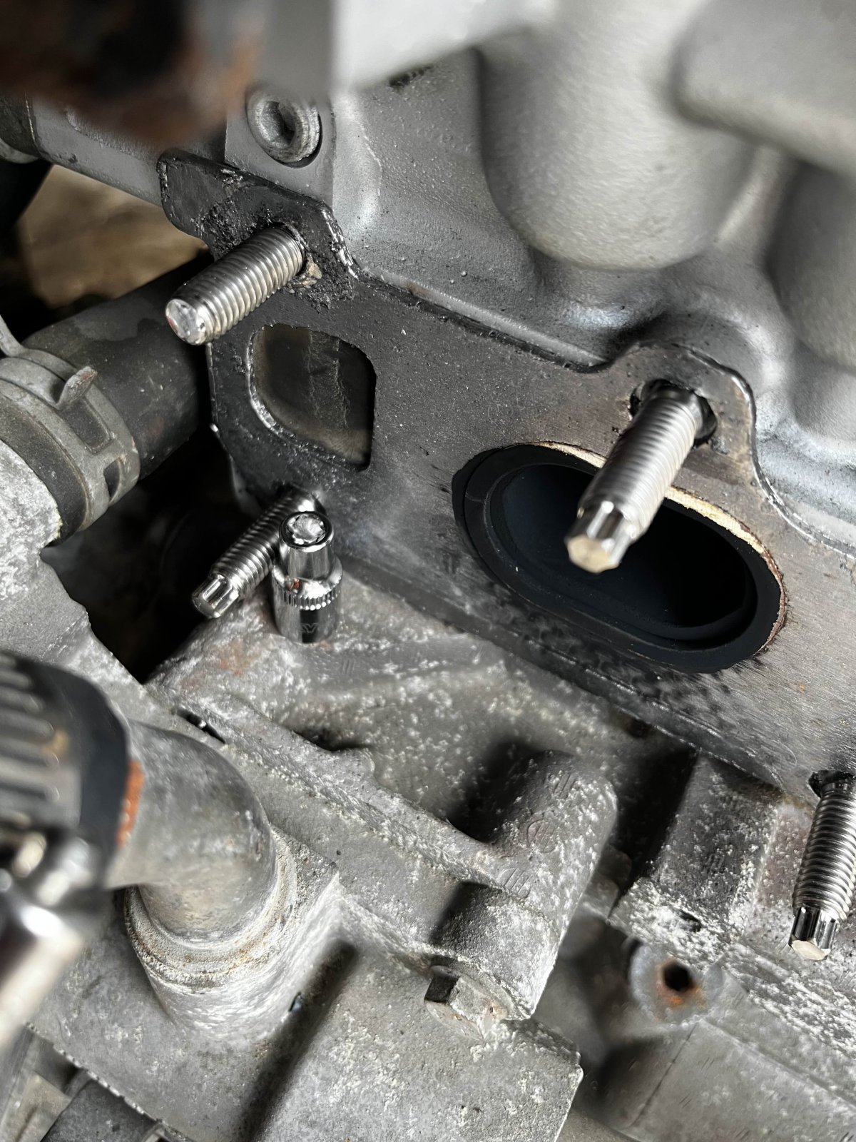

Installing the shiny exhaust manifold studs was not as pain-free, since I snapped one of the heads off at the 16ft-lb GM torque spec. :rolleyes: 14ft-lbs for the rest of them worked fine.
