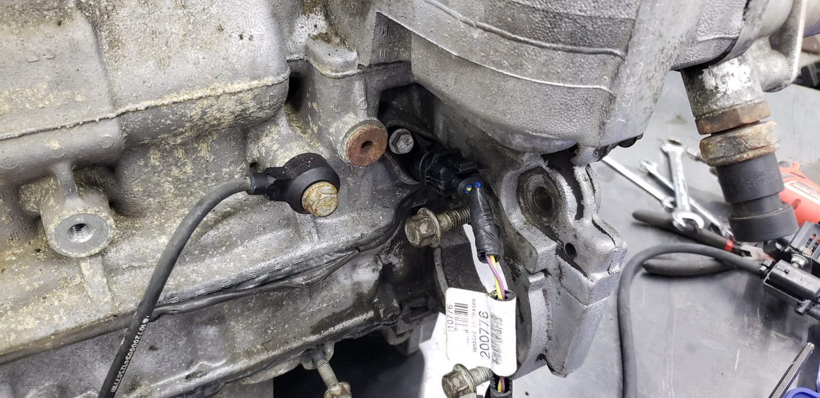

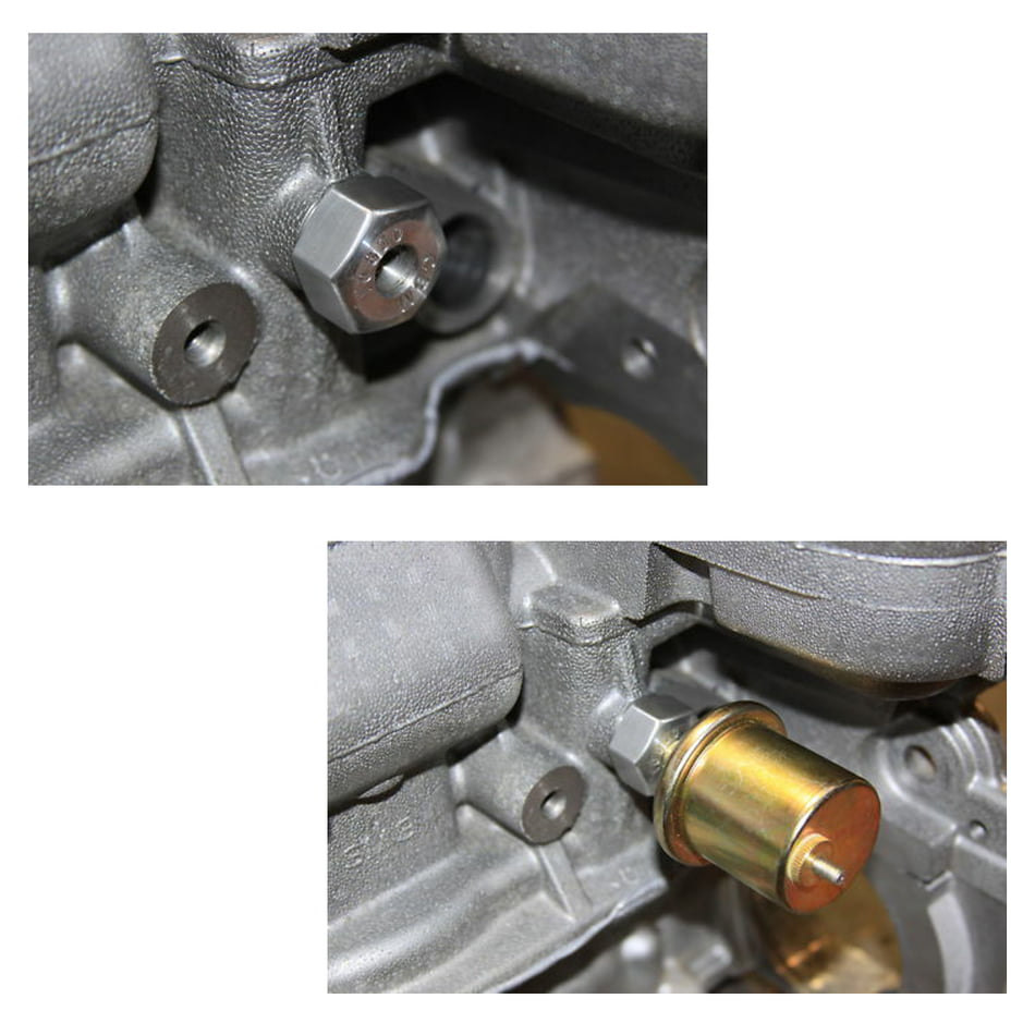

I’m working on an L61 and looking for good places to add senders for an oil pressure gauge and a coolant temp gauge.
CBM sells a 12mm oil pressure adapter and gives you this picture. Anyone care to tell me where this spot is? I can’t seem to find it.

Ok I found that spot but that adapter they sell is screwed into the hole that my engine has a low oil pressure switch. Can I eliminate that and just replace it with my new one?

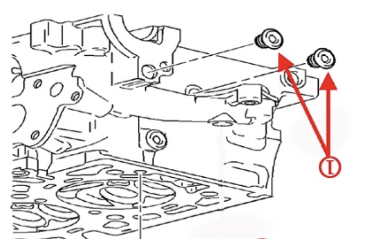

Or you could put the oil sensor in the hole that was made for it, and leave the oil pressure switch alone, and fully functional.
I removed the sensors on either side of the plug, and heated the block with a torch for about a minute, and got the block warm. Then the thread lock released enough for me to remove the plug.

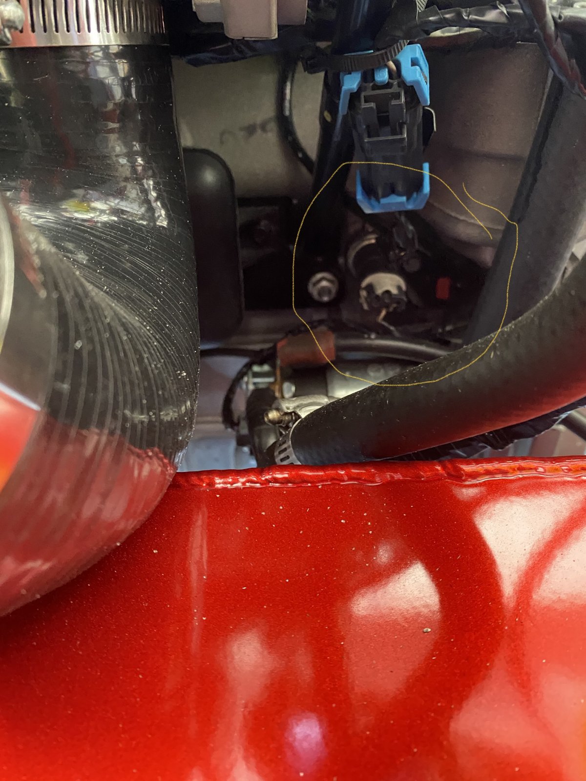

Mine is like the alldata pic in that post with the sensor there. It doesn’t have a plug like your LSJ did.
So your car already has an oil pressure sensor in it?

Oh, GM put the oil pressure switch in that hole. Well, I guess you could put a Tee on it, and have 2 sensors off of the one oil port, or skip the oil switch.

I did some more digging on some cobalt forums too. It does seem like that place is the most accurate. I’m going to put the new sensor from the gauge set in the factory location then move the factory switch for the idiot light to one of these spots with a 12mm adapter.
