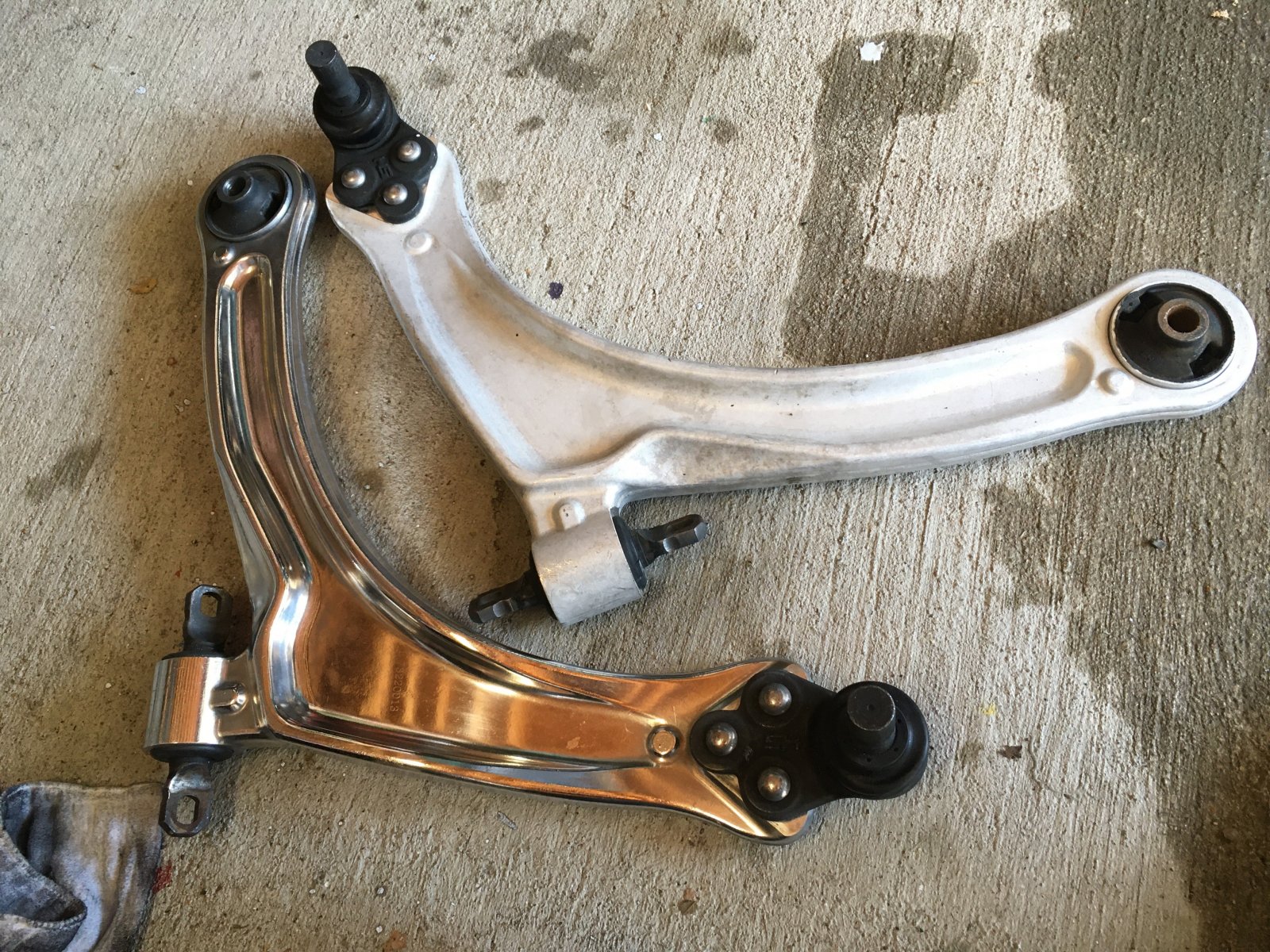

Anyone powdercoat the control arms and did you press out the bearing and remove the rubber first?
Polish them but I would recommend replacing the rubber rear bushings with metal ones from Moog or OTTP
46325
Powdercoater may not want to do it with the ball joint still attached since the amount of grease might contaminate his oven. And won't be good for the ball joint either.
ToothMagician
This is awesome but I don't have the time or patience to get this quality finish
I considered that. I may just spray them with a solid few layers of primer underneath, clear coat on top and hope for the best

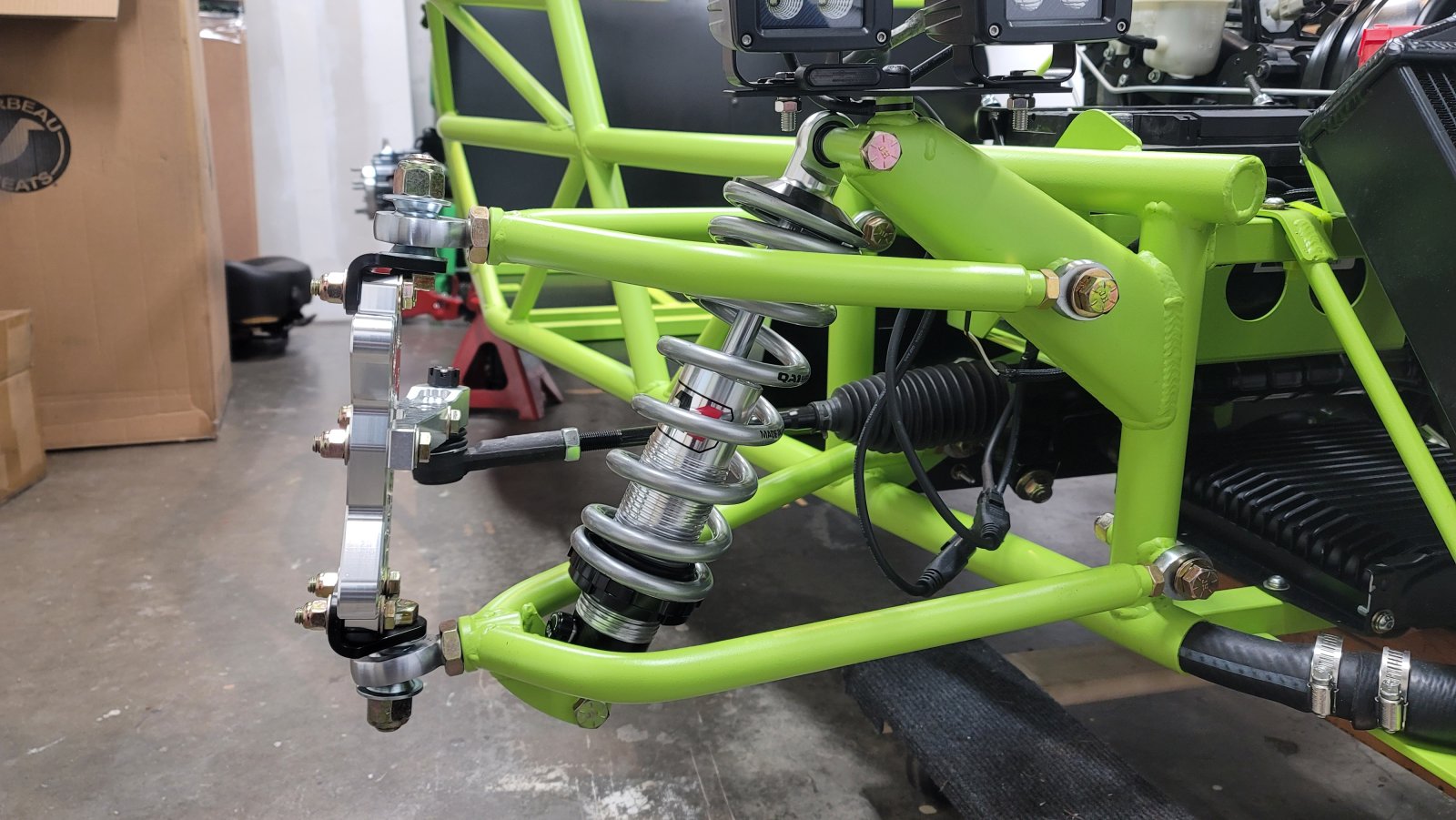

Wrapping up the last parts of the goblin, but I've got some roadblocks I need help with:
1. How many turns for the front control arm spherical rod ends. Is it 4 turns for all 12, then align from there? Also looks super toe out on 8–12 threads from the steering tie rod. Is that normal?

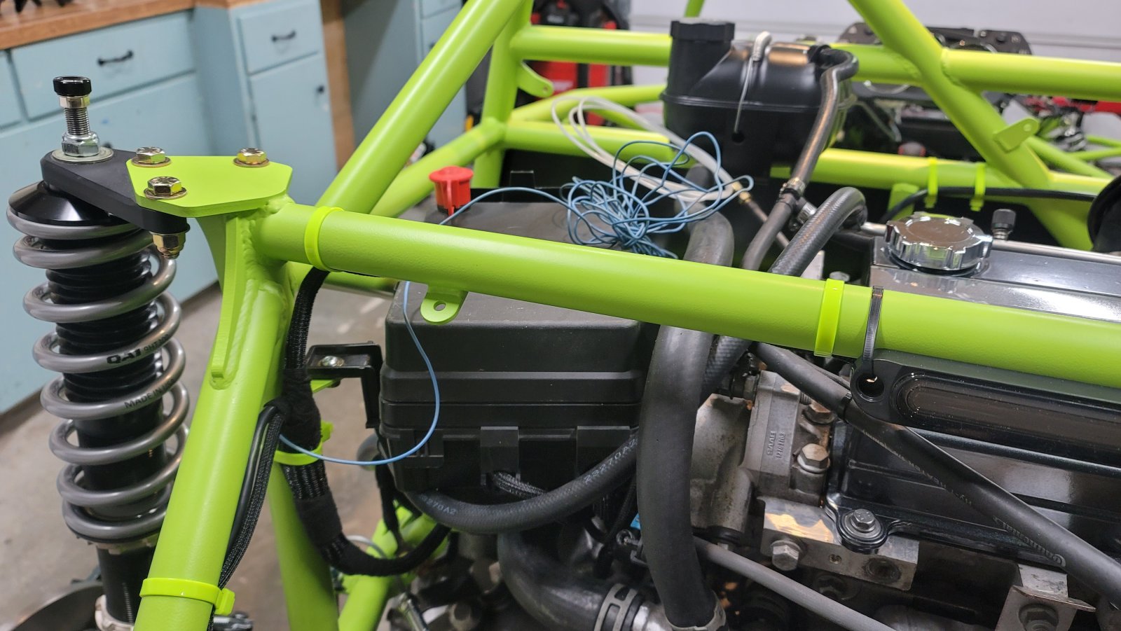

3. I have a long blue wire that I don't know what it goes to, hanging out where the tail light wires are
