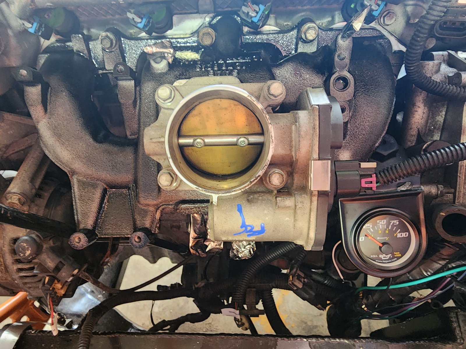

So, I'm not loving the fact the Cobalt only has a dummy light for the oil pressure. I have one of these on order, https://www.summitracing.com/parts/atm-2278 so I can remove one of the intake balance shaft plugs and have pressure. Anybody mount a gauge by the engine like this yet?
Oh that's the Saab intake and the 2.4 throttle body temp installed.

The gauge is just there on a temp basis to see if the oil pressure drops when my lower engine noise starts. Going to go electric later on, but would really love to drop the factory cluster for some real gauges.

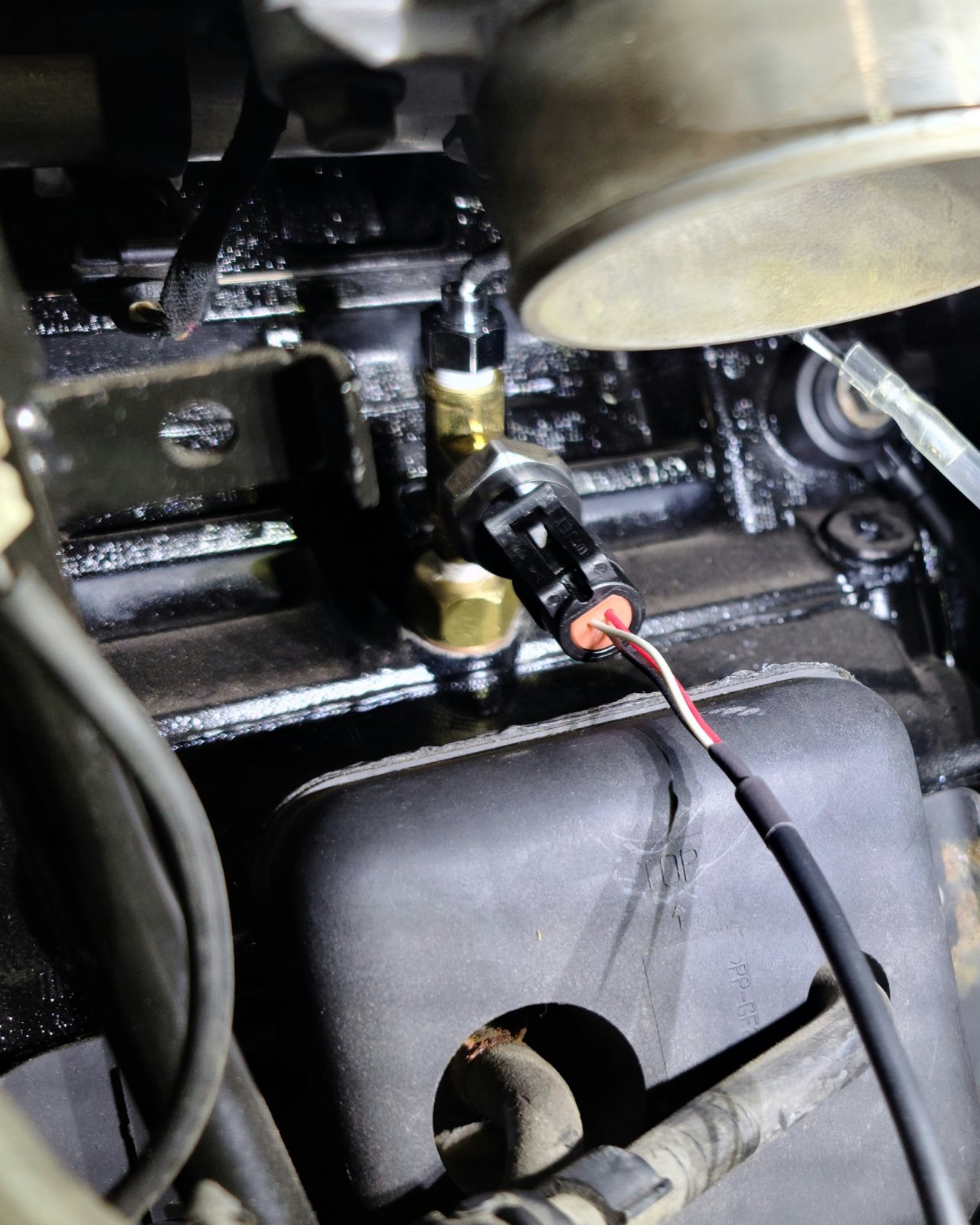

I bought the same adapter the put a T after to install a oil pressure and temp sensor there.
I'm not sure that oil temp will be very accurate somewhere that isn't actually in the flowing/moving oil. I thought about adding it into my manifold, but decided to go with one that mounted in the oil drain plug. And I don't know that the temp in the pan is a meaningful measurement. If it is, there isn't much need of an additional oil coolers on these cars.
Mahkoi
Yeah that thought occurred to me after I installed it since it was in a dead end path for the oil. I haven't put any thought into a better location for it so I've left it there for now.
At least you sensor is fairly small. But I would still be a worried that the brass tee would break. They really don't like the load on them with vibration.
