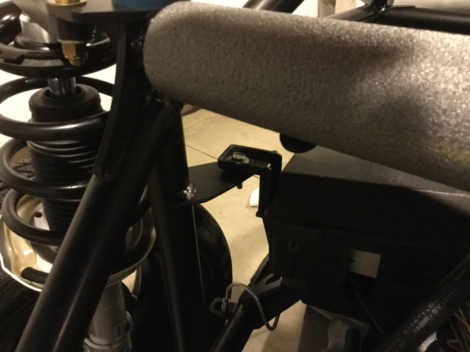

Tab for the main fuse block.

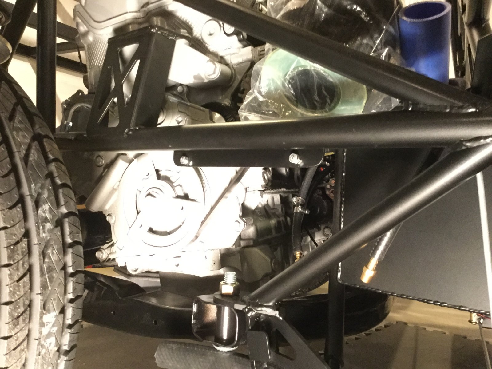

Both sides have longer tabs for the brake lines and fuel filter bracket on the drivers side.

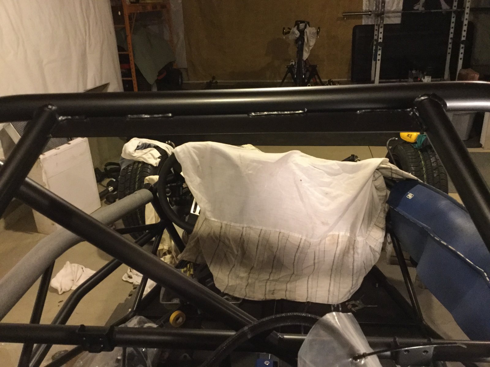

Tab between the upper roll bar for future bikini top or for a light bar.

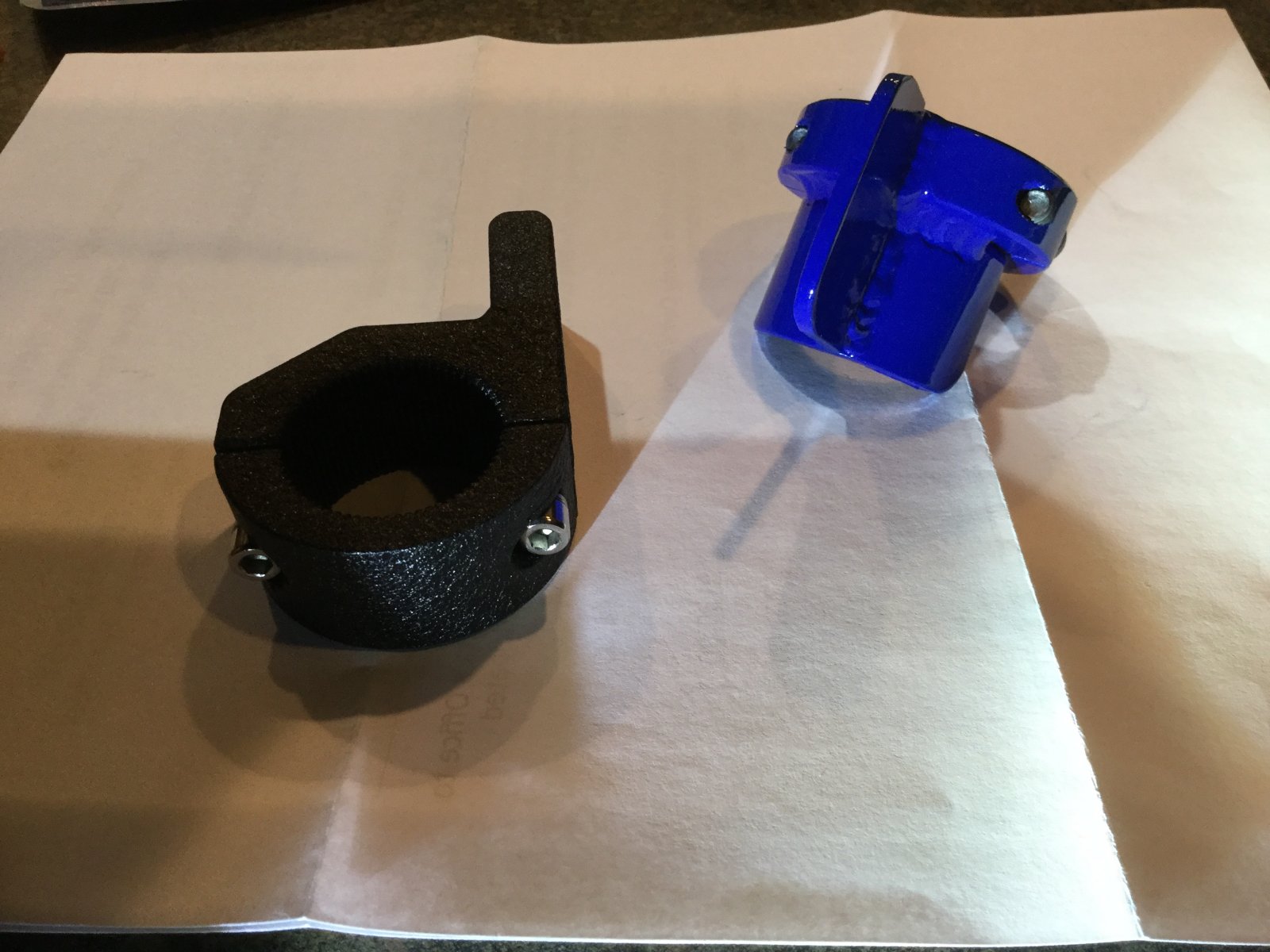

One home made removable tab and a store bought light mount tab.
