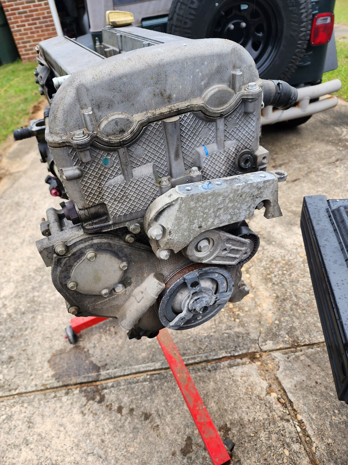

I have a different (maybe) front engine mount.

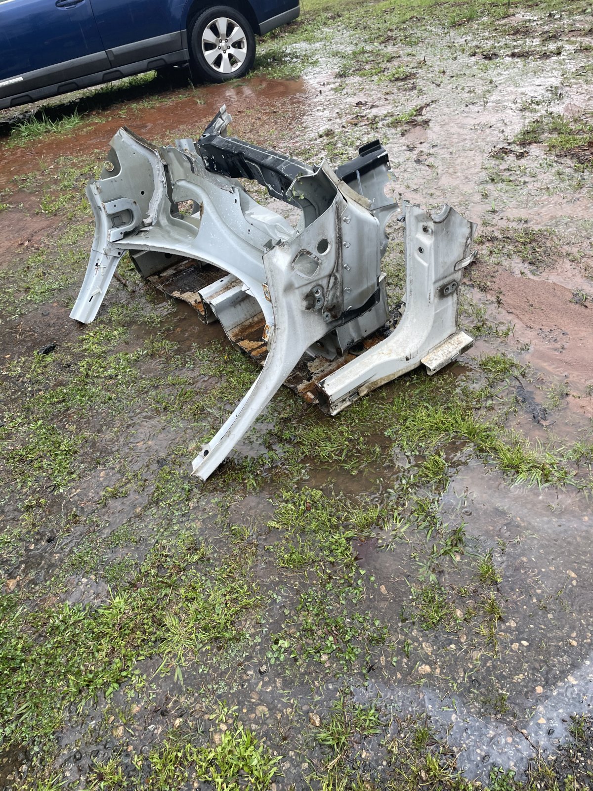

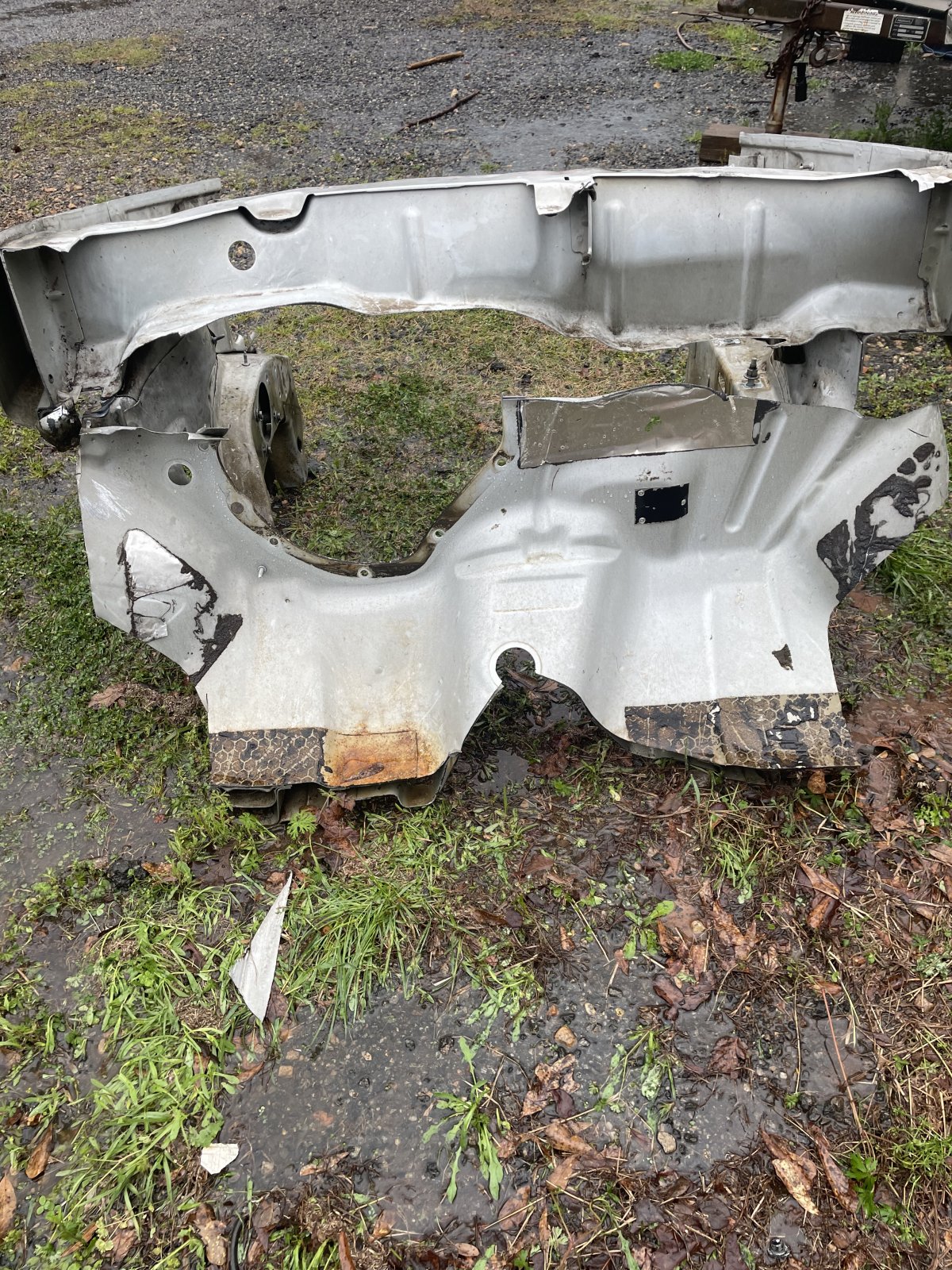

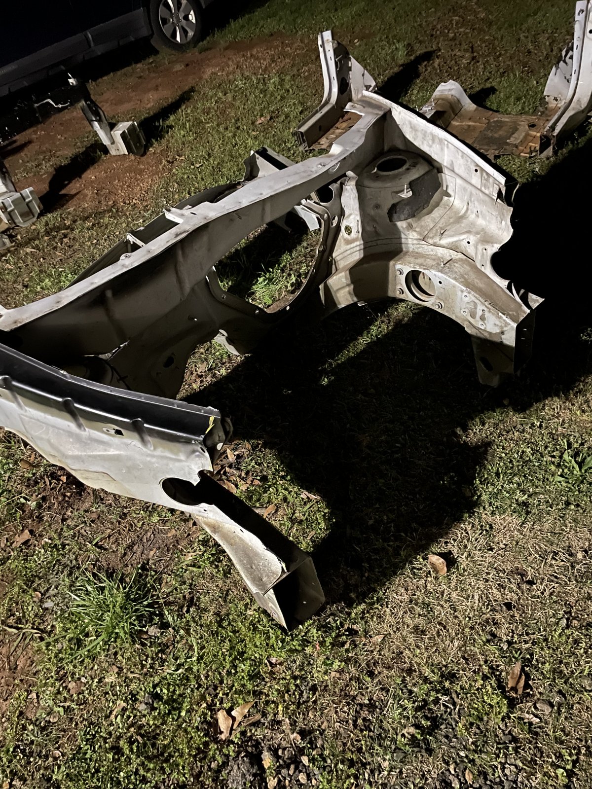

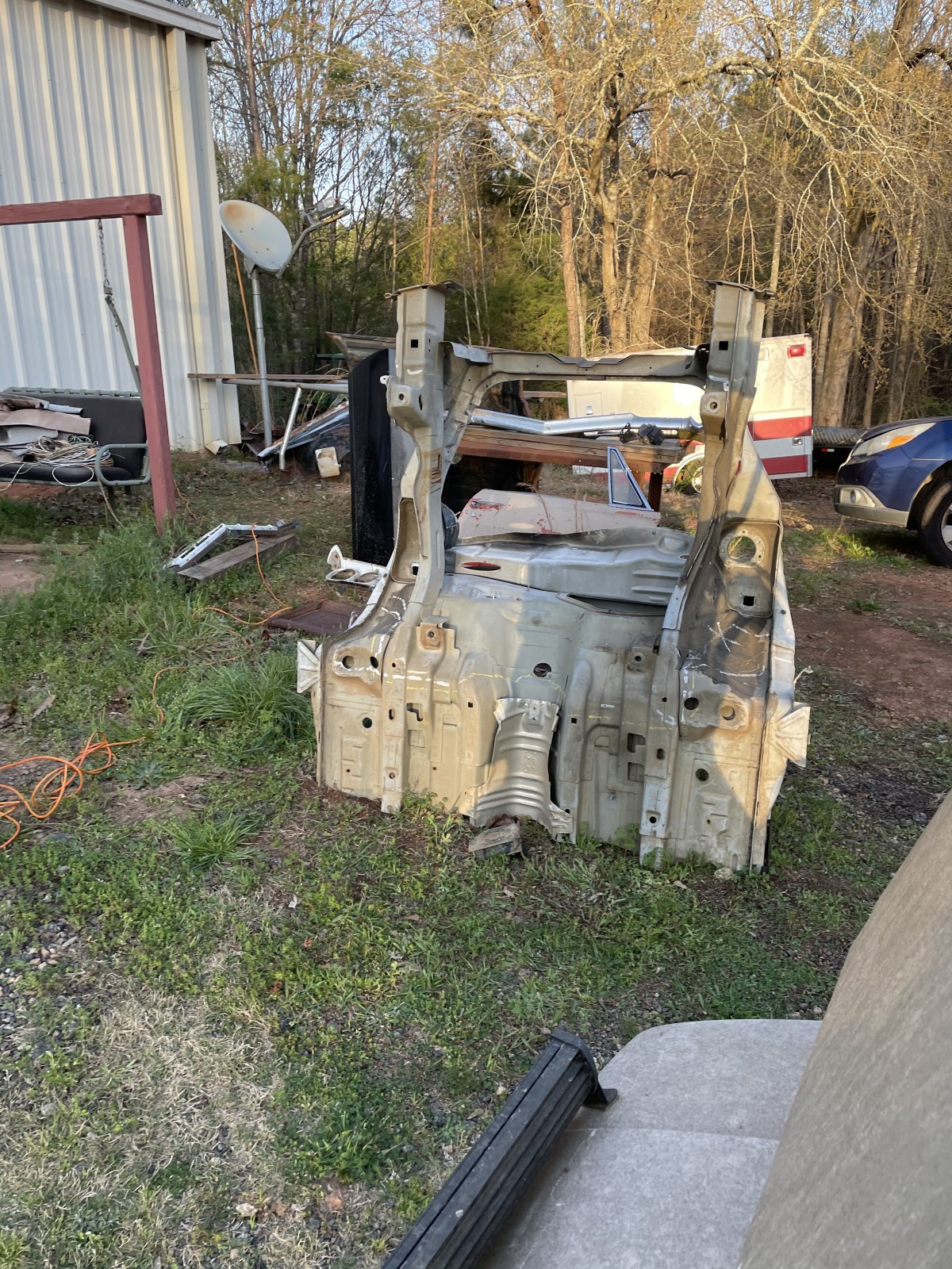

Noah and the Ark time locally; with a sprinkling of tornado's! I'd gotten a lot done on Saturday and then the storms moved in. We winnowed down the front steel of the cadaver donor, a bunch, to create my "driveline cage". Driveline cage will locate all asundry "GoGo" bits to the back. It saves the original 4) "K member" mount points, R, L engine and Strut mounts, keeping everything dimensionally stable. There is more to cut away on it, then we're down to jamming it into the 06 body by actually cutting on the car! I called a glass guy to pull out the back window and the little triangle quarter windows. (or I can just hit them with a hammer and make a huge mess for me to clean up. But we're trying to step away from our Demolition Derby roots, at 60, we are "sophisticated auto enthusiast's" now?) I've completed my wiring extension "kits" and next I will actually cut, splice, solder and heat shrink all the connections(there's only 45 of themo_O) under the hood of the currently functional car to test. {Sometimes I'm thoughtful, I remembered I could just coil up the extensions and test my systems now!} The extensions will just be disconnected as with any engine drop and zip tied to the engine. This car runs currently but has a bad clutch, no release, though it may hold pressure long enough to actually drive;). Just now? Laundry.
