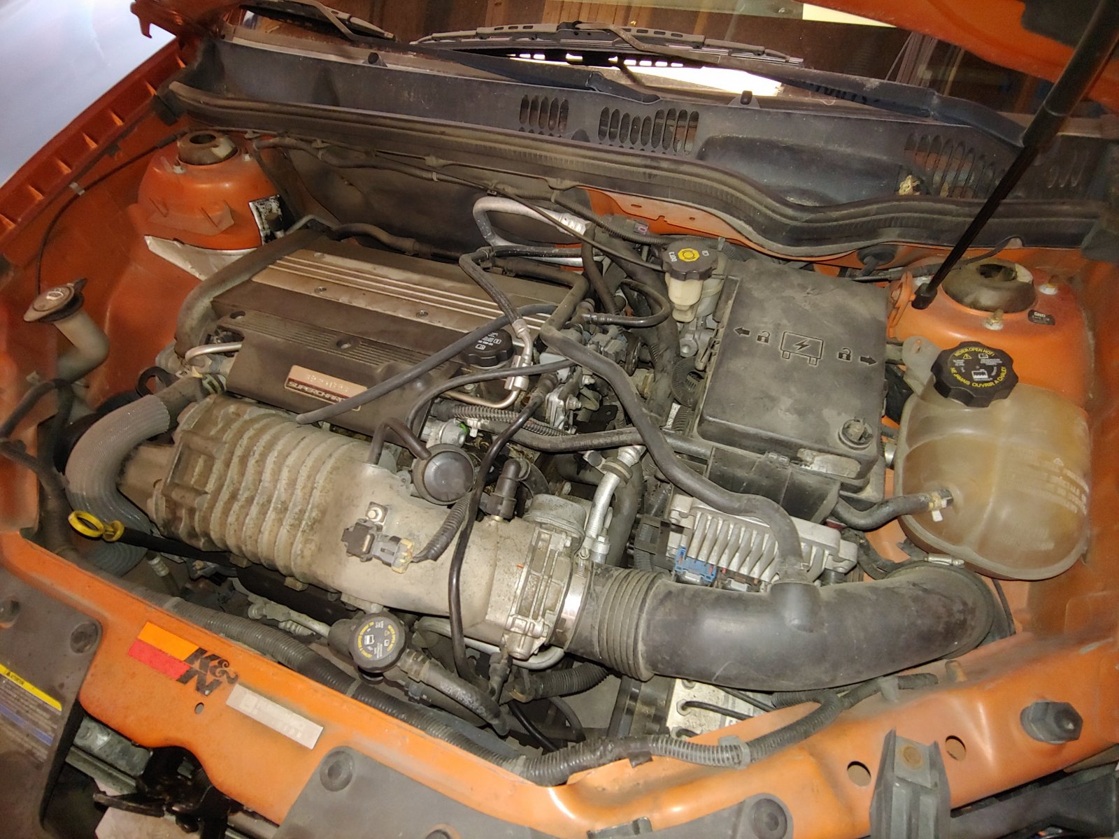

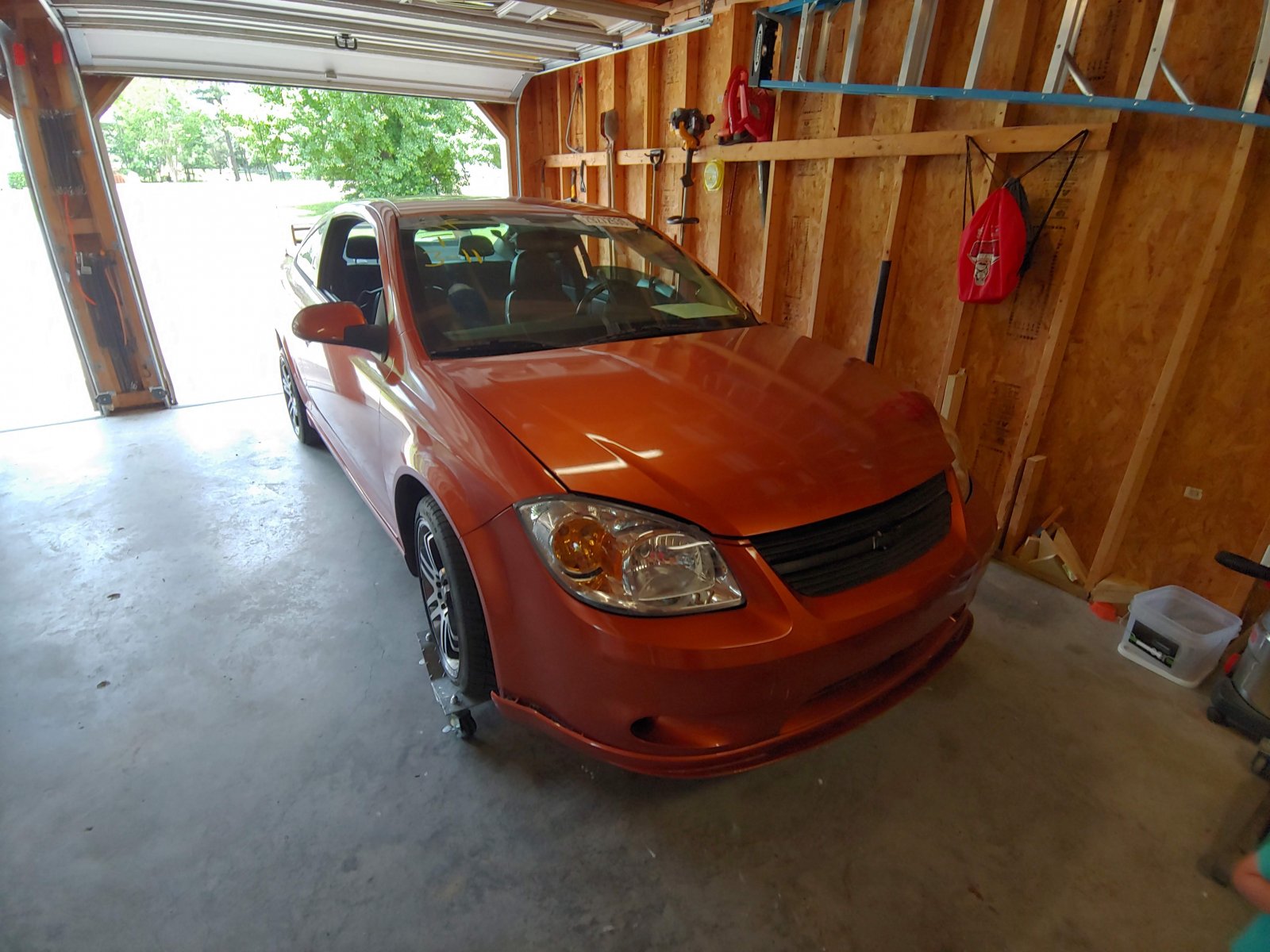

Disassembly of my donor has begun and I figure I should start up a build log.

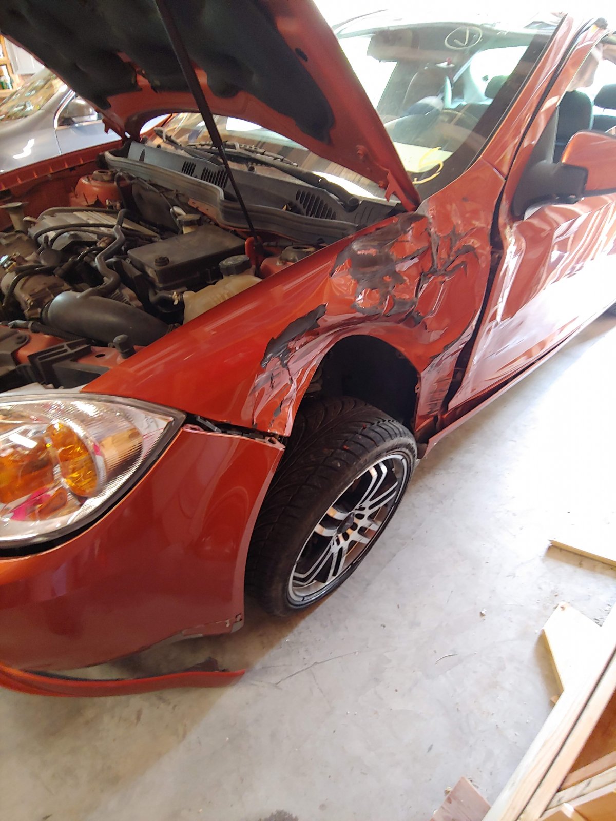

76205 miles on the odometer when I got it (not able to drive due to damage) into my garage.
Placed my order for the DF kit car on 5/8. I think chassis #157 is scheduled for me. Definitely interested in some of the other options that aren't built into the online ordering: flat tow bar, parking brake setup. Also curious about the rear wing options.
I've chosen the extended version because I plan on having the seats in the normal/short distance since I'm only 5'10" and can have a box for items needed when away from the garage behind the seats.
Haven't decided on colors yet but I have an orange Tacoma and my wife's car is a dark gray Jetta Sportwagen. Not looking to duplicate the colors we already have.

Got the donor through Copart. Winning bid was $1450, add copart fees, and broker fees because it was in South Carolina and it was $2188. They offered a transport fee of just $520 to my driveway, or I could pick it up by way of having a tow company take it from copart and then I load it on a trailer nearby. I took up the $520 transportation fee so in total it's cost me $2708 but I think the combo of not fighting any rust and such low miles is worth it for my starting point.

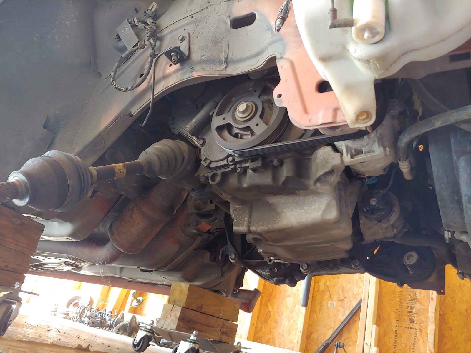

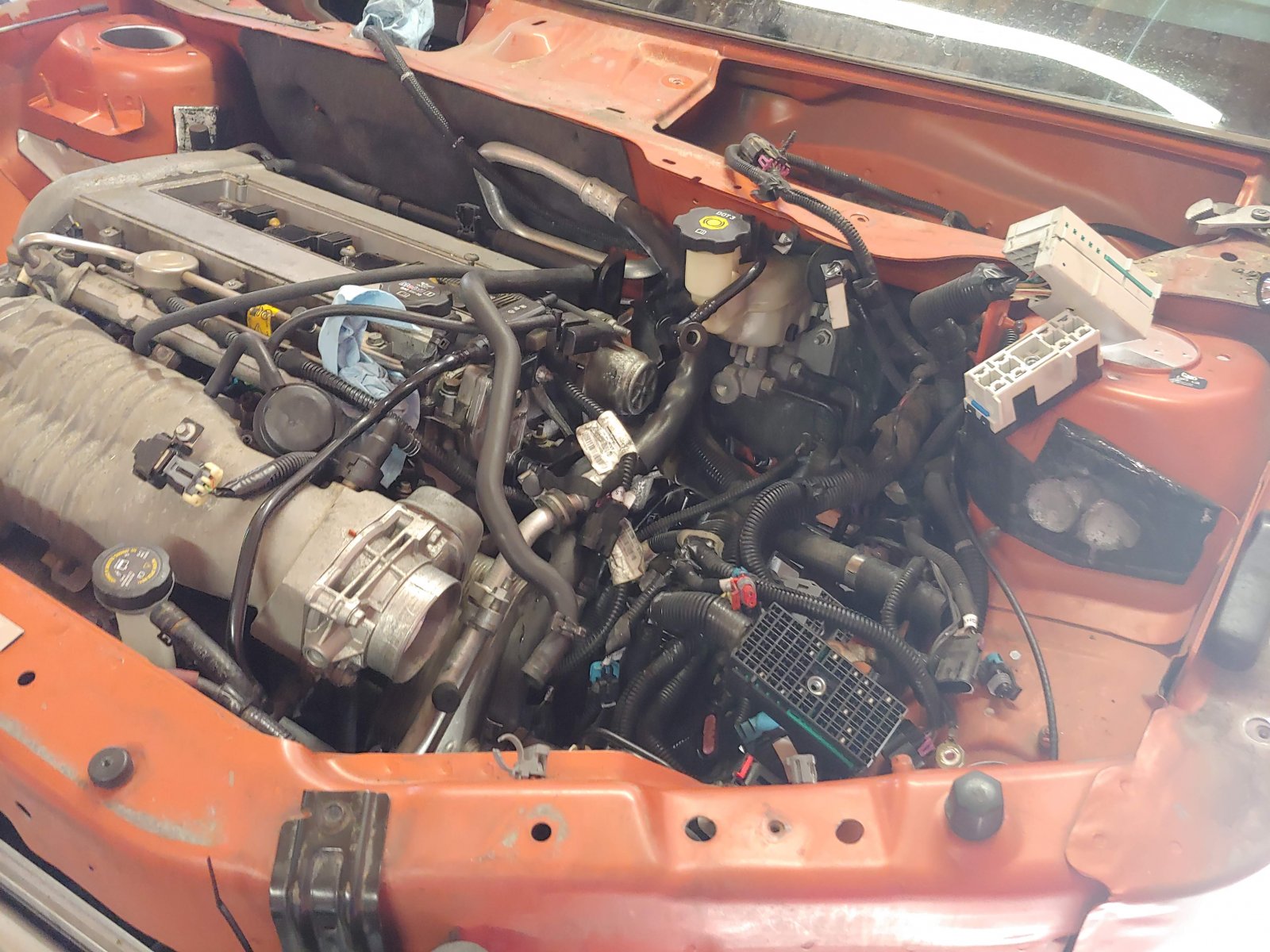

Progress is being made. So far I've followed the first 4 build videos but haven't quite finished unplugged the harnesses to be ready to drop the engine out. I've already made progress on the interior though, opening things up and removing a bunch. One of the parking brake cables actually was broken right at the handbrake end.

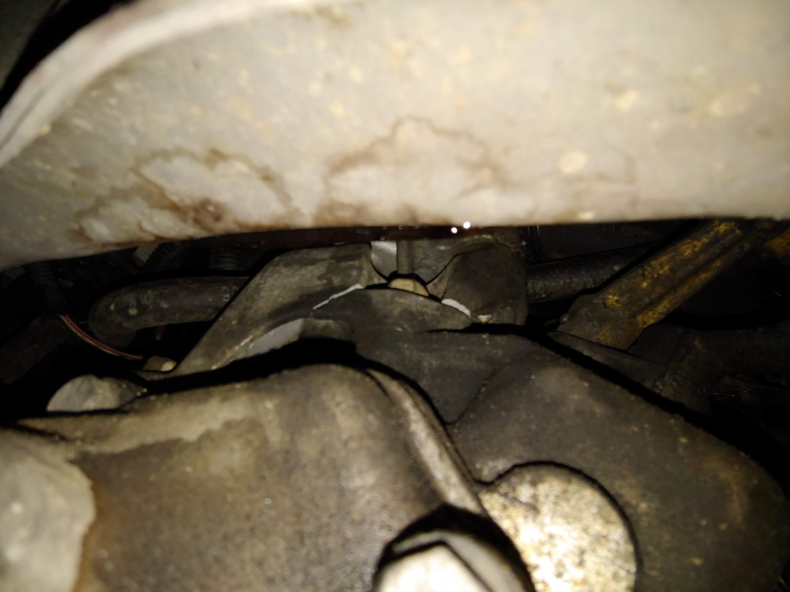

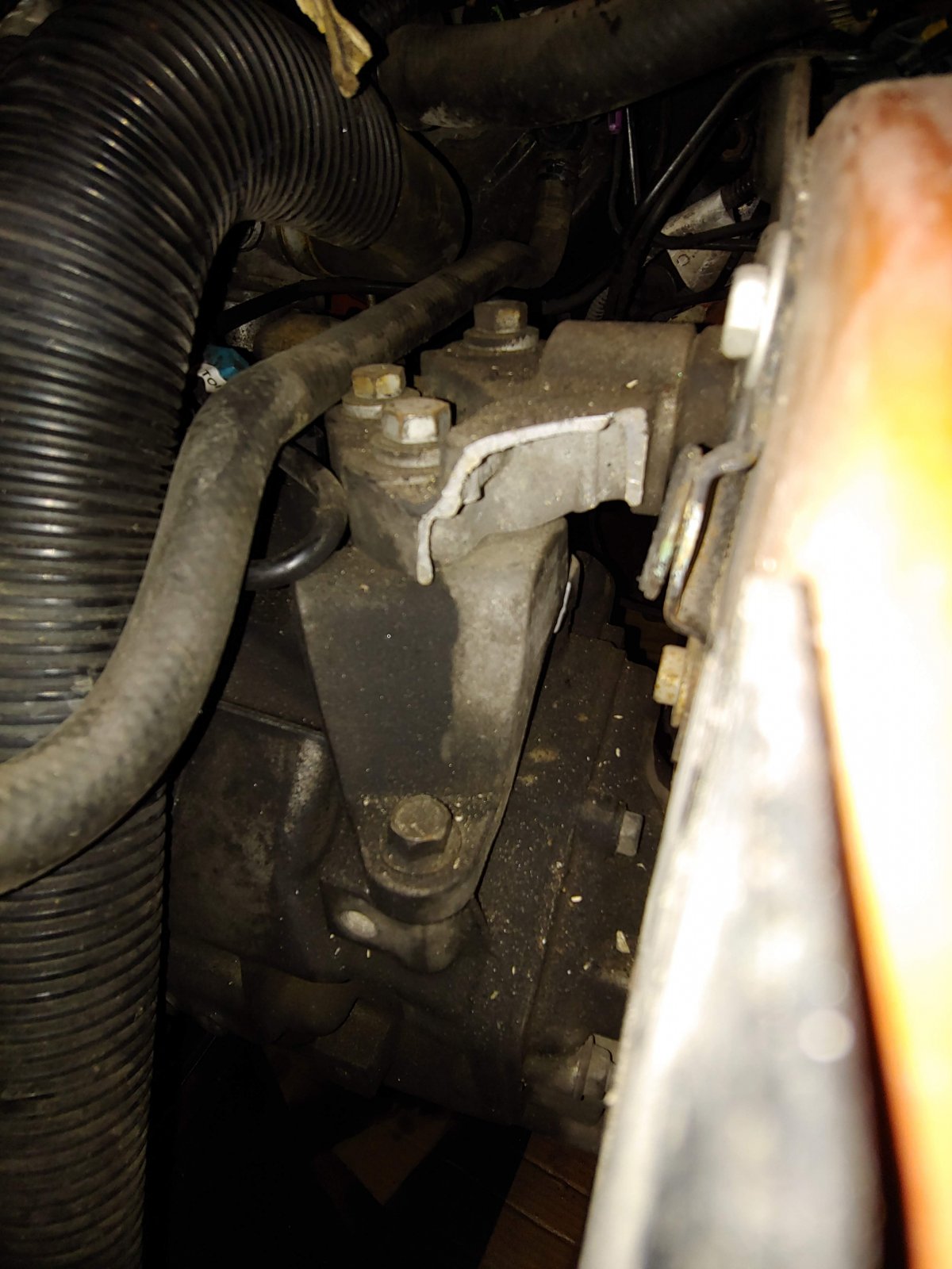

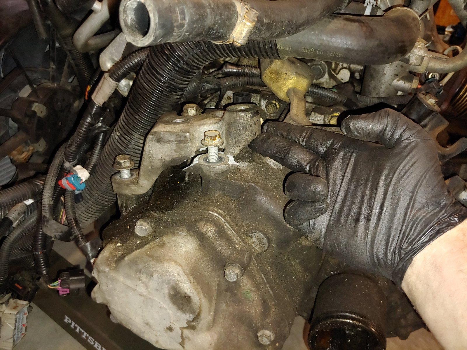

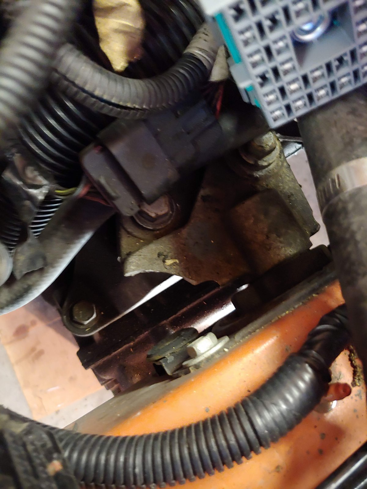

When I removed the fuse box I noticed the upper transmission mount is no longer whole, not the bushing failing, the metal is missing an entire corner. I can also see the mating bracket to the mount is broken clean in at least 2 places. I did pressure wash the engine after getting the car, and have drained a good it of the gear oil out of the transmission in prep steps, no water was coming out (but the magnetic plug was maxed out with gunk) which I think means the transmission casing isn't cracked. I'm hoping that what I'm seeing is that the GM trans mount is busted and the adapter bracket GM put on the F35 to adapt the SAAB design to fit the GM space is busted but nothing else (I'm not sure if this is an accurate assumption but I'll know more when I drop the engine. Maybe I'll be able to do that in the coming week.

Don't worry about the motor mount, it is not used in the Goblin. The spacer/adapter is used to connect the trans to the Goblin frame. If this is damage or broken, it will need to be replaced.
Looks like you are making good progress with the donor teardown. Make sure you label each plug as you remove it to make sure you know where it came from. This will become very important once you start working on the wiring harness.

Looks like the adapter bracket (item 6 on this website) would be $40 after shipping for a new one, probably can get it cheaper at a local dealer to avoid double cost due to shipping. I hope that I can just replace that adapter bracket and the rest is still solid.

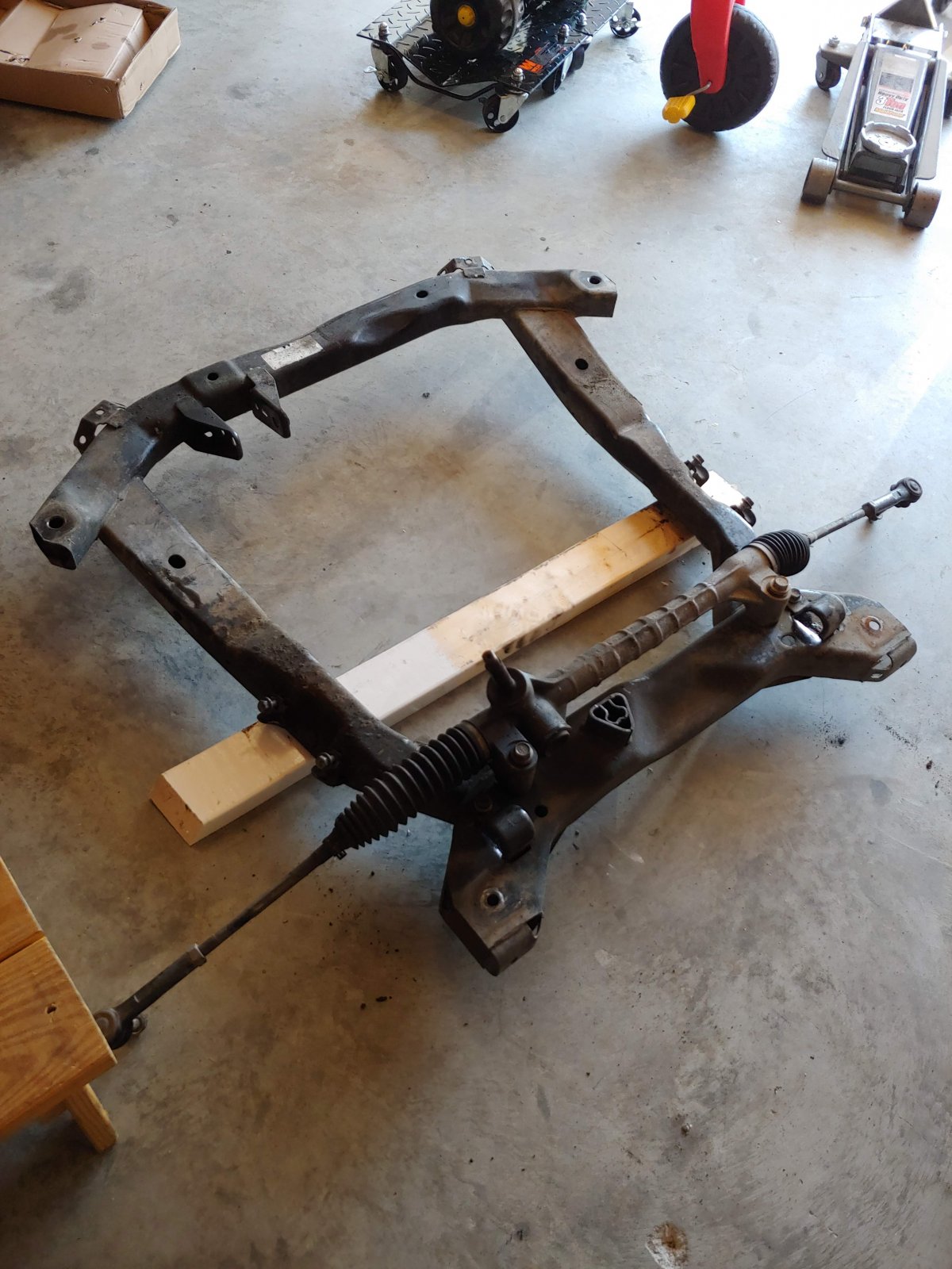

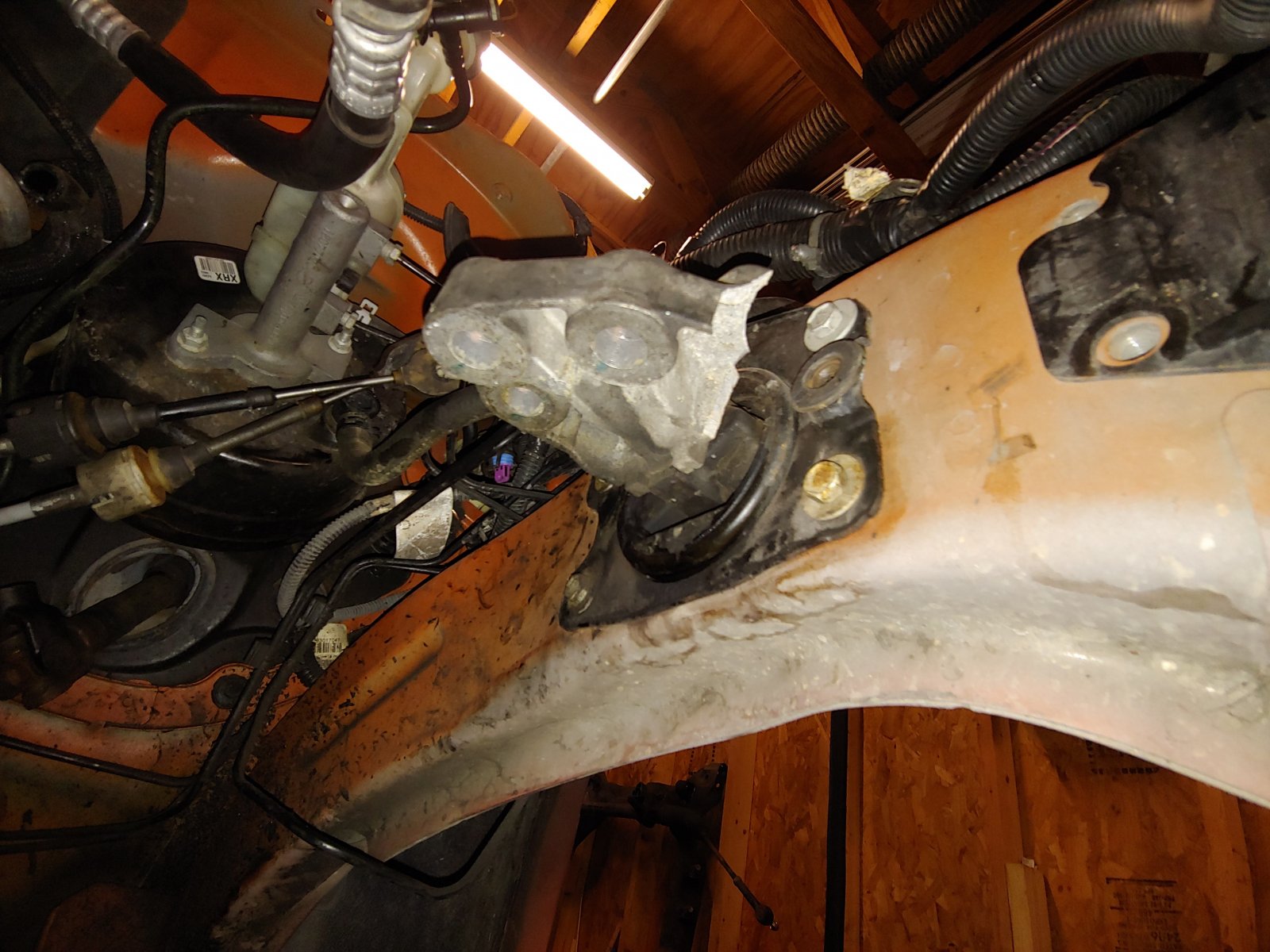

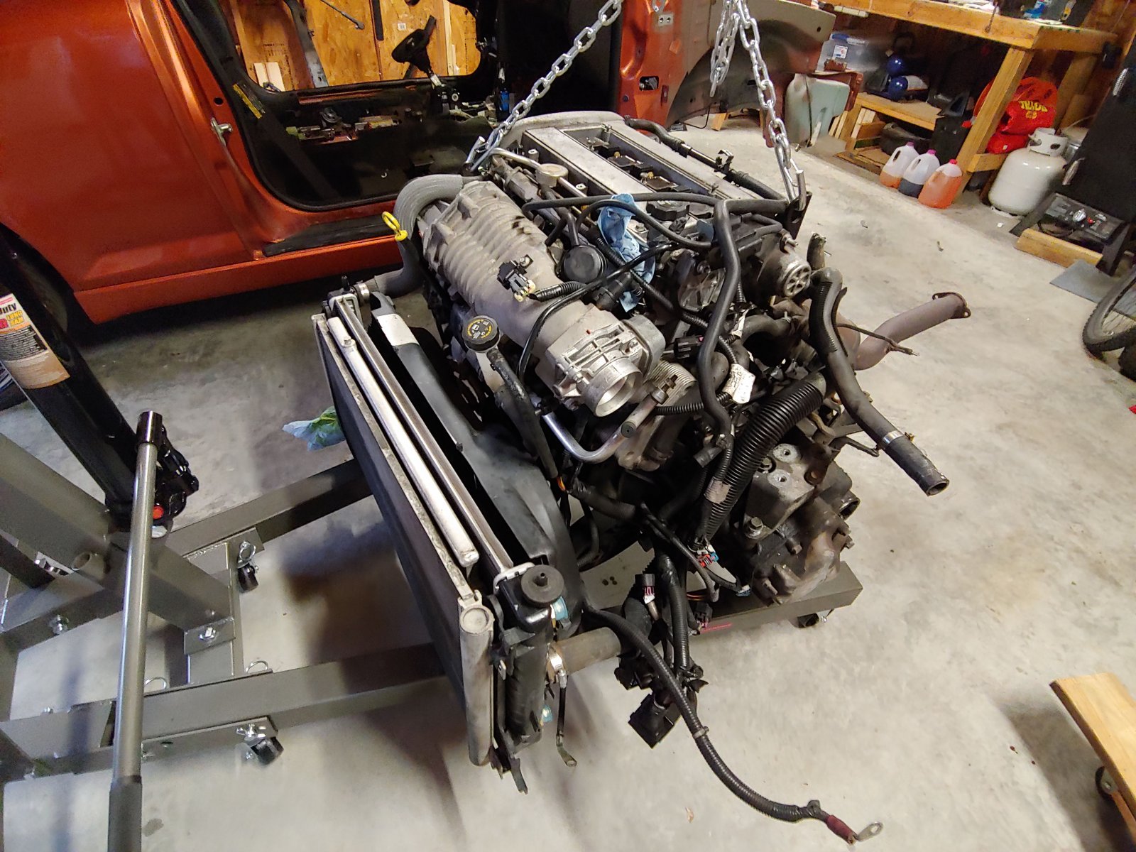

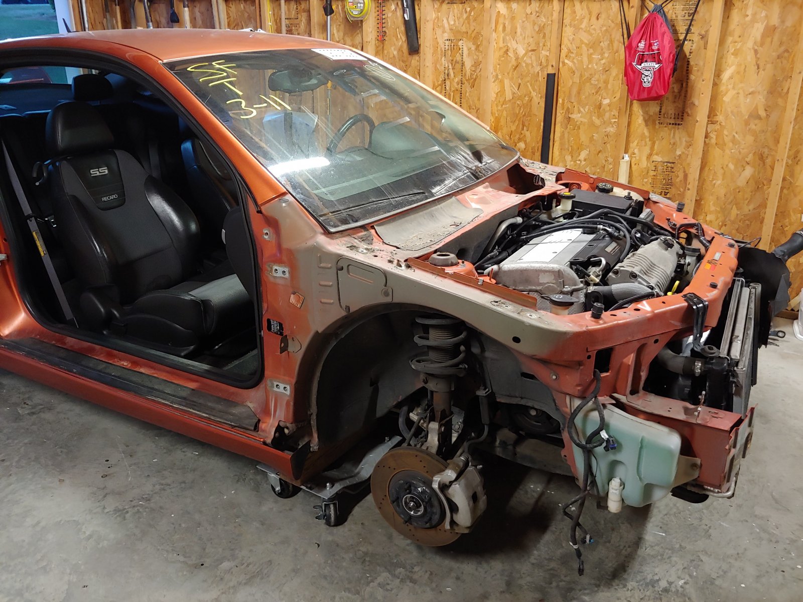

More progress happened this evening. Engine is fully removed from the Cobalt!
Also, confirmed the damage to the transmission mount adapter didn't carry through to the transmission itself, so that'll be an easy 1 part replacement. I did notice the shift cable mount was overtightened at some point and it has cracked out the bottom of the blind screw hole, looks like the screw hole has plenty of meat though so it should be fine to not touch (could pull the fragments and use longer bolt with nut if needed). Its nice to have full access to the engine now, I've never actually pulled an engine before.

Congrats on your first engine pull. Not as hard as it seems, if you have the right instructions to follow? :D
Other than the damaged mount spacer and over tightening looks like you have a great drivetrain for your donor.

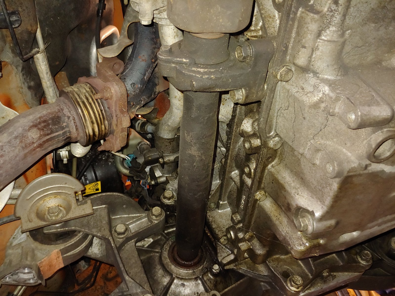

I'll be replacing the output shafts for the f35 transmission I've got since 1 was broken. It looks like the output shaft seal (the one for the passenger side output at the transmission case) could use being replaced as well. Any other thoughts on what I should plan to replace when changing the CV half shafts?

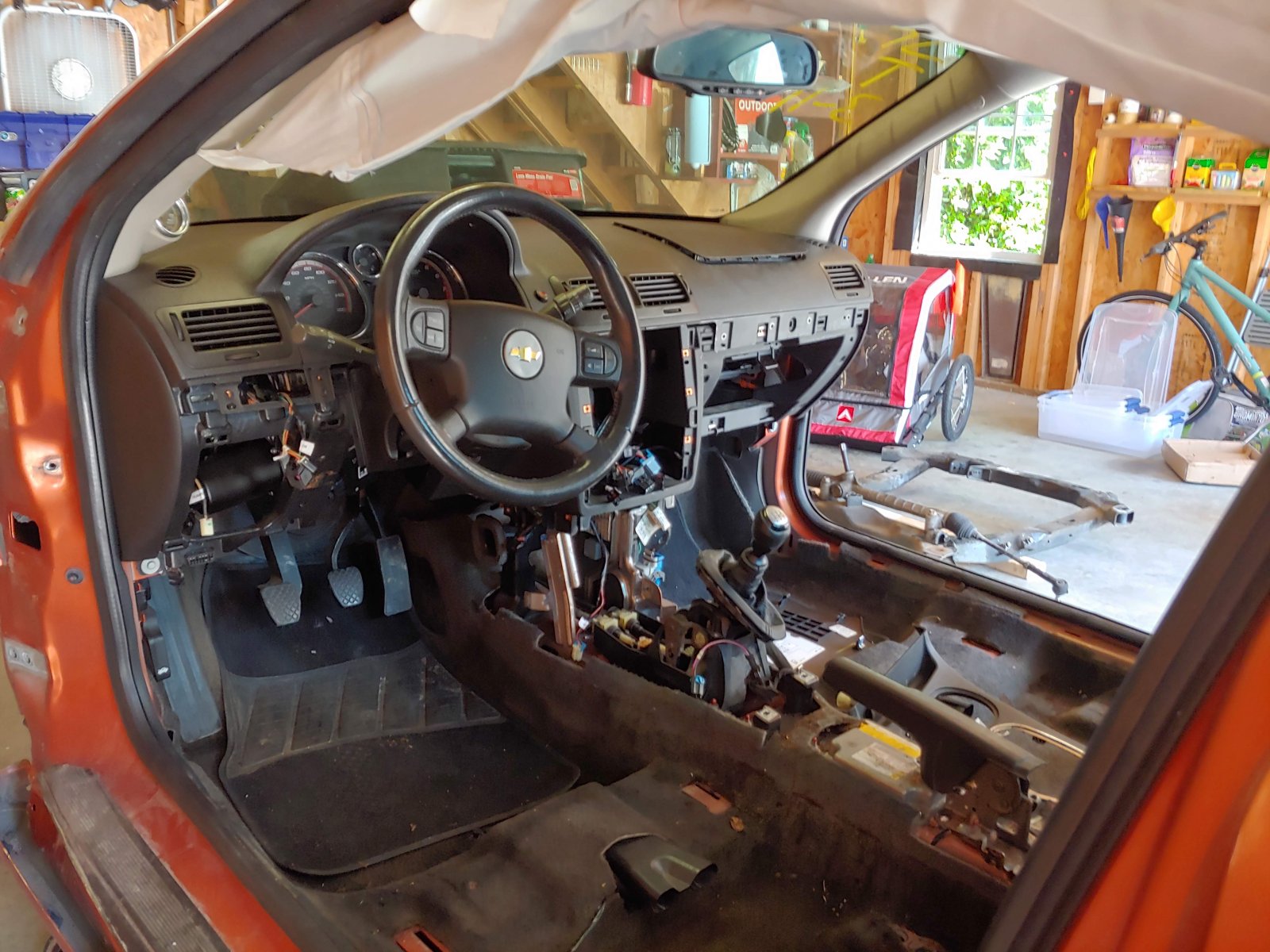

Dash is out. Harnesses are out. I'm all the way through the 6th build video.
