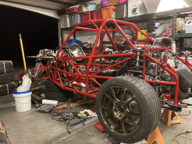

Progress seems to be cooking now :cool: Stage 2 and 3 arrived recently, now the only thing stopping progress is a full time job :rolleyes:
Brakes, shifter and wiring are on the short list. This weekend I hooked up the intercooler, heat exchanger and air intake.

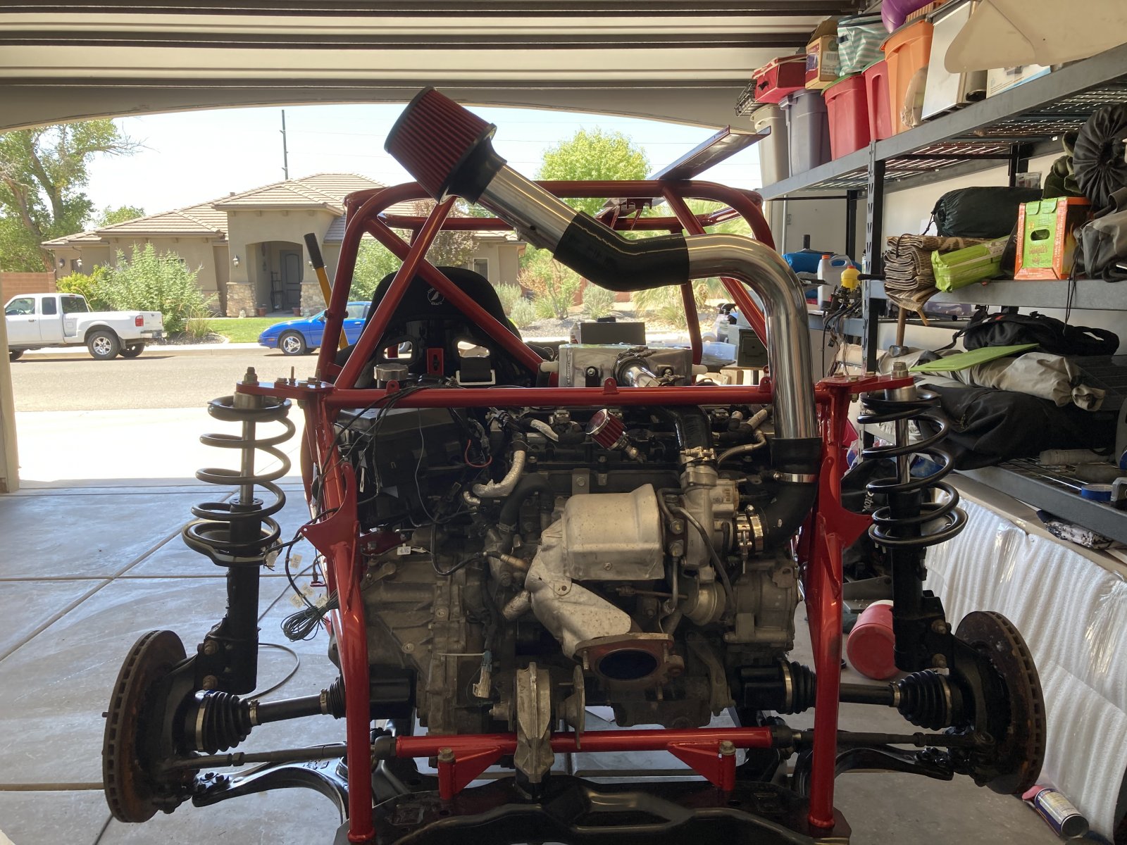

As I was messing around with the air filter location and had to tease my wife to see what she thought... gotta get those IAT’s down!!!

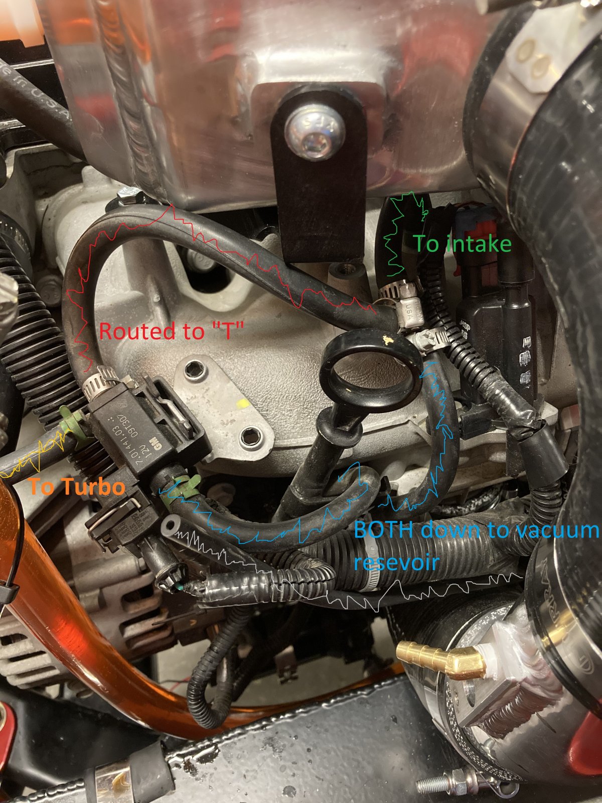

In this week's edition of "I have know idea what all these vacuum/boost lines do..."
I think the only thing I removed when pulling the engine was the orange line to the turbo. So if everything was correct before, I'm not sure where the barb next to the MAP is supposed to be routed? The gray line not hooked up is my AFR gauge which will just be tee-d into wherever the brass barb is routed...

I've been suspect of the "t" between the red/green/blue marked lines in the pic above, since they were using hose clamps, not the OEM clamps on the rest of the lines. I am fairly confident about a few things at this point... the red line needs to go to the brass barb next to the MAP. The "t" needs to be eliminated and just plumbed straight, and I will plumb my AFR/boost gauge vacuum line off of the brass barb to register boost. Amateur hour over here :)

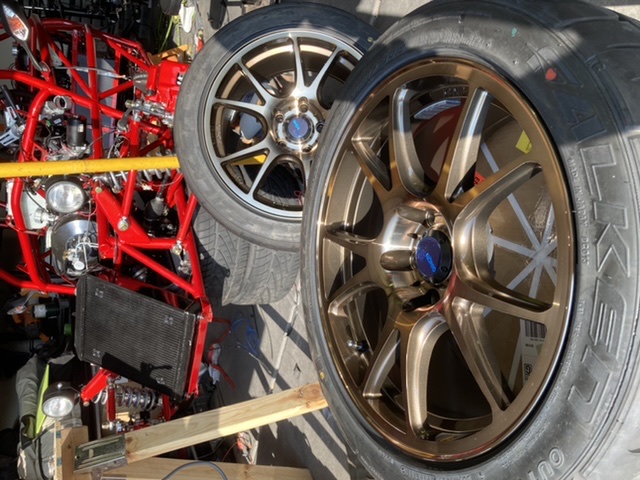

Wheels arrived yesterday. Online pics make them appear very gold, but in person they are a very rich bronze color. Excited to get them mounted up!

Looks good. I was just looking at those last night. Its between those and Cosmis XT-206R's in Hyper Bronze
