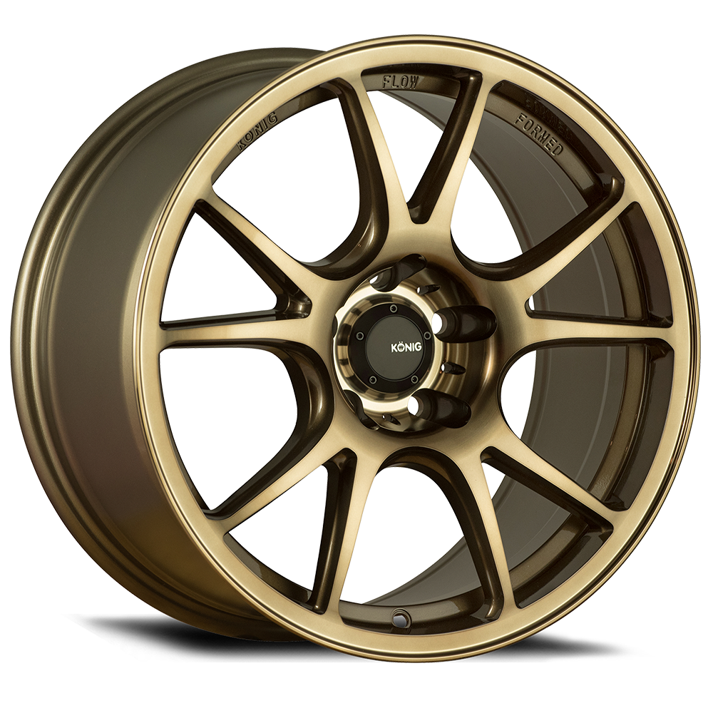

Trying to decide on wheels and tires has probably taken me longer than the wiring harness :rolleyes: They're not ordered yet so I welcome any feedback. The intended purpose is primarily fair weather driving. I have also tossed around the idea of participating in Vegas autocross events, but I've never done anything like that before, it sounds like fun?
Wheels
Front:
Konig Freeform 15x7.5 35mm offset lug pattern 4x100 (just have to buy non abs hubs from a base model cobalt, correct?)
Rear:
Konig Freeform 17x8 40mm offset lug pattern 5x114.3 (adapters seem more simple... are they safe? In the offroad world they are frowned on)
Tires
Front:
Falken Azenis RT615K+ 205/50/R15
Rear:
Falken Azenis RT615K+ 255/40/R17
This tire setup would be almost a 2" height and width difference between front and rear.... Is that too much of a spread?

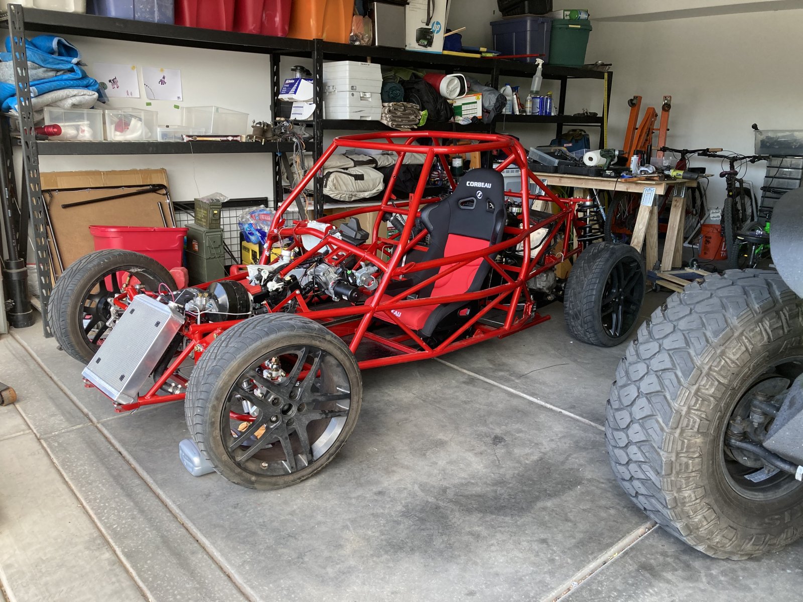

I also got the rear suspension mounted, so I had to throw on the stock wheels/tires to see how it looks. It's been said before, but having not seen a Goblin before, standing next to this thing is CRAZY. It is so tiny, I love it.

The Freeform is a nice looking wheel! Two things to watch out for: 1) caliper clearance on the 15 inch wheel and 2) front end clearance on a 23.2 inch tire diameter. I plan on staying above 24.5 inches for my front end tires. The stock wheels you have on it now look pretty good! The Dekagram has a 16 inch option if want to go taller on the front and still stay staggered. I've looked at about a thousand wheels over the past year and trying to stay within budget is very hard. :)

Also ordered wheels/tires. I wanted a staggered set, but after @JeffsGoblin mentioned to watch out for ground clearance, I did some measuring and decided I had to stay over 25". I wanted the Konig Freeform more than I wanted staggered, so these are on the way...

Very nice wheel and light too! Are you going with the Freeform 17x9 5x114.3 with a +25mm offset? What tire brand and size?
I went with the 40mm offset, in case I end up using wheel adapters instead of redrilling the lug pattern.
Tires are Falken Azenis RT615K+ 255/40/R17. I wanted something lower cost before I tried my hand at auto cross and did a bigger commitment to R888's.
JeffsGoblin
Ah, ok... sounded like you already had the 5x114.3 hubs, but I see what you are doing. That should be a good setup. I might be going with the Falkens too. At $126 a tire, might as well try them for a season and if you don't like them onto something else the following year.
