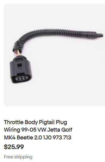

Is that throttle body connector one of these listed on Ebay?
I know that on the V1 Cobalt engines, I can get those parts from Mouser, but I have to get the exact connector name, either from AllData, or sometimes you can find it in micro printing on the old plastic connector.
It looks extremely similar to this one in that link, 6 pin connector. Might even be the same one, but good call on checking the print on the plastic.

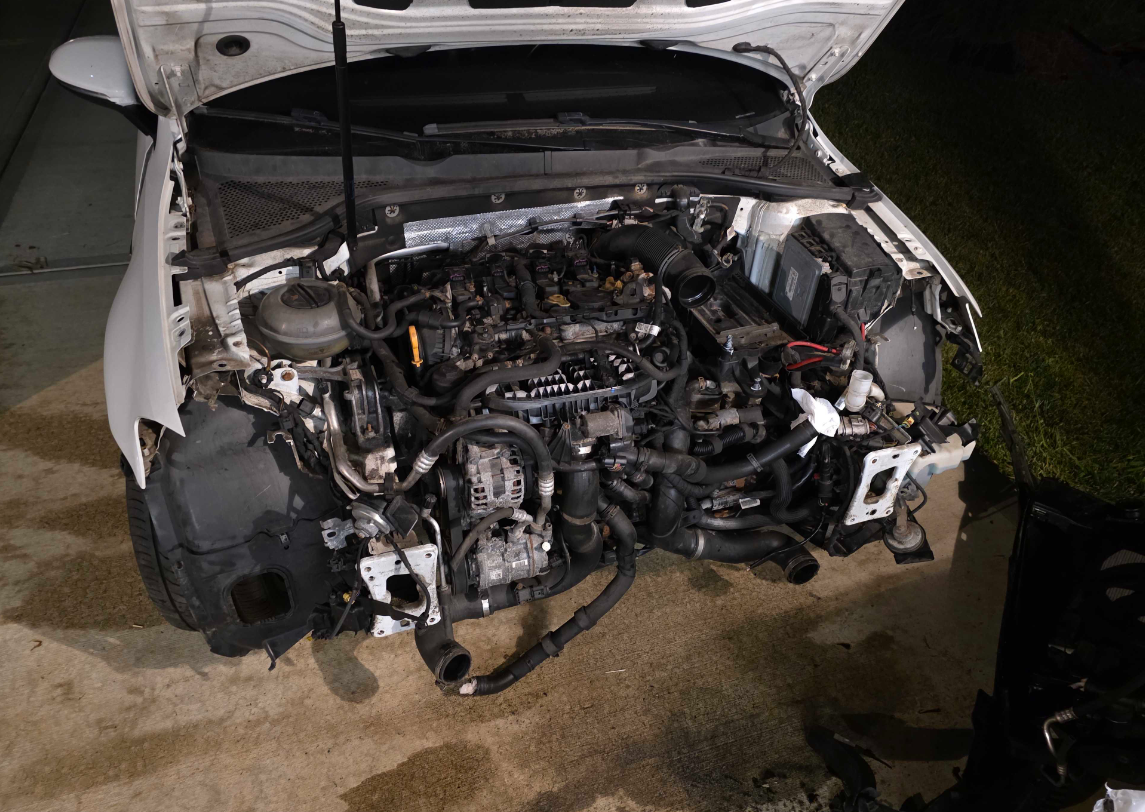

Day 3. I finally made it past all the broken connectors.
54143

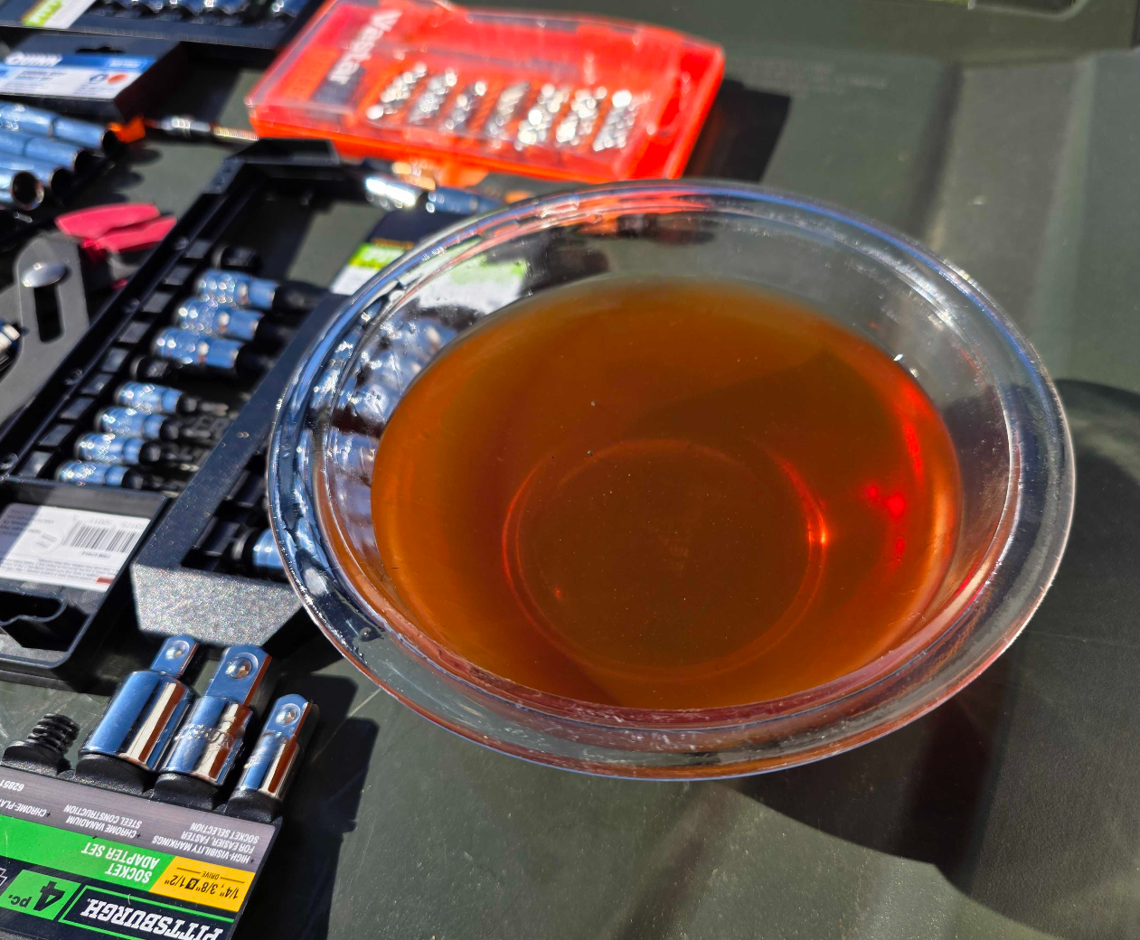

Also here's a fun photo with more context than meets the eye:
1) The coolant is either rusty or the salvage yard combined some common green coolant and the car had G12 VW coolant already in it because green + red = brown.
2) Yes that's a glass bowl for baking stuff i put that in. I couldn't find the fluid pan, and instead of looking for it, i went into the kitchen and got some bowls to cook with. Mistakes were made. My wife wasn't happy about it.
3) I can't be the only one that puts sockets back on the packaging they came in. Those things are so convenient for keeping them not rolling around in a cheap tool box

A couple of thoughts/notes:
The V2 reuses the factory airbox, and mine was partially broken. I'm assuming an aftermarket one would work that uses the same mounting points? I'm probably going to wait to order that until i see the actual frame.
Kind of a similar question for the intercooler piping, except my current piping is fine, I just want to get aftermarket piping for aesthetic purposes. If it follows the same routing would it likely be fine?
I was kind of hoping a good cleaning would solve my dirty coolant reservoir problem, but I'll just order another one, it's absolutely disgusting. $30 isn't much and I'm not spending another second smelling whatever crawled in there and died.
The laundry list of things I want to replace is adding up enough where I'm starting to wonder if i shouldn't have just bought all the pieces individually instead of buying a salvage car lol hindsight is 20/20 i guess. And I still have a lot to sell off the car remaining.

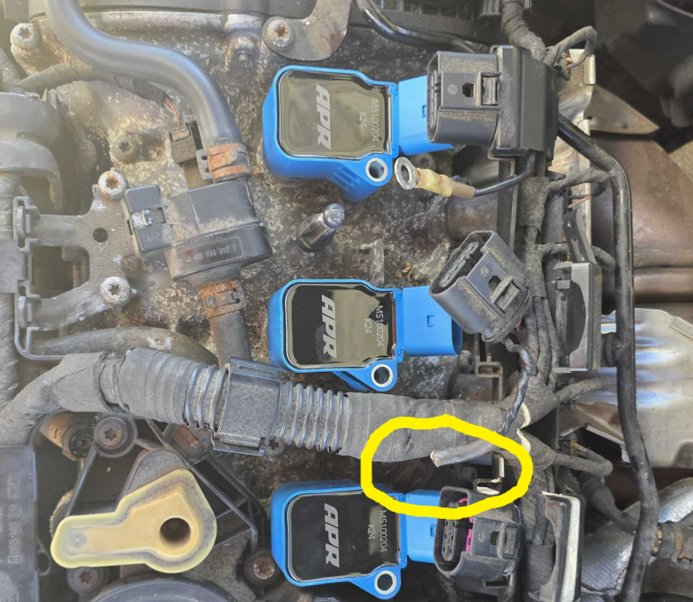

I'm about to take this car out back and Ole Yeller it like the previous owner should have done. Tried taking off the nut to get the coil packs off, barely touched it and the lead just shattered. Add one more thing to the purchase list. Anything else on the harness breaks and i'll just add a new wiring harness to the list and just cut through it. I see a lot of pretty brittle pieces anyway.
Edit: Purchased coil grounding kit. I could have just redone the one but i have a feeling i just got lucky on the others and the grounding studs were pretty rusty anyway.
54169
Those grounds or notorious for breaking off, I ended up cutting off all the ends and running new wires to a chassis ground. Also go with the OEM coil packs, aftermarket are hit/miss from wat I've read.
I already have a stuff to rewire the ground in the mail, I didn't have anything at home unfortunately I don't do a ton of wiring jobs. I did have the thought that I don't know where the grounding points are on the goblin so I might not test this in vehicle so I don't waste cutting the wire and risk cutting it too short though. If the coil packs end up being a miss I'll move back to OEM, they're pretty inexpensive and I also got them half off. Cylinder 1 and 4 coils were struggling so those absolutely needed to be replaced, I just figured I'd replace all 4 since I was doing 2 already.
