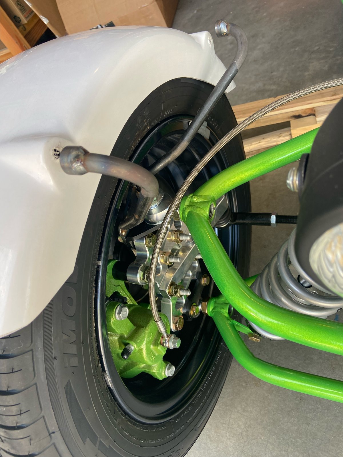

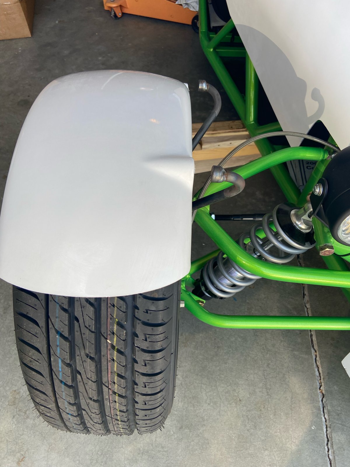

Hey all, getting to the finish line here.
A question about the front fenders . . .
We attached the brackets and the arms are too far away for the tire to line up properly. These are stock SS cobalt rims that we are using. Any ideas? Did we get sent the wrong support arms? Have we attached them in the wrong place?

I would assume so. I’d probably try to bend each of the arms a bit to see if I could move them closer. I believe there is a right and left side for the brackets. Double check to make sure you have them on the correct sides.
Blue Man
That’s what I’m wondering. We ordered the staggered set with the small fenders upfront and the large fenders in back and I wonder if they sent us the wrong mounts for the front.
I sent them a message about it yesterday with Photos. I’m waiting to hear back.
Blue Man
OK, so I talked to DF and they said that they make the brackets for more of an offset for custom wheels?
So they said if I run stock wheels, I need spacers and they are sending me some.
