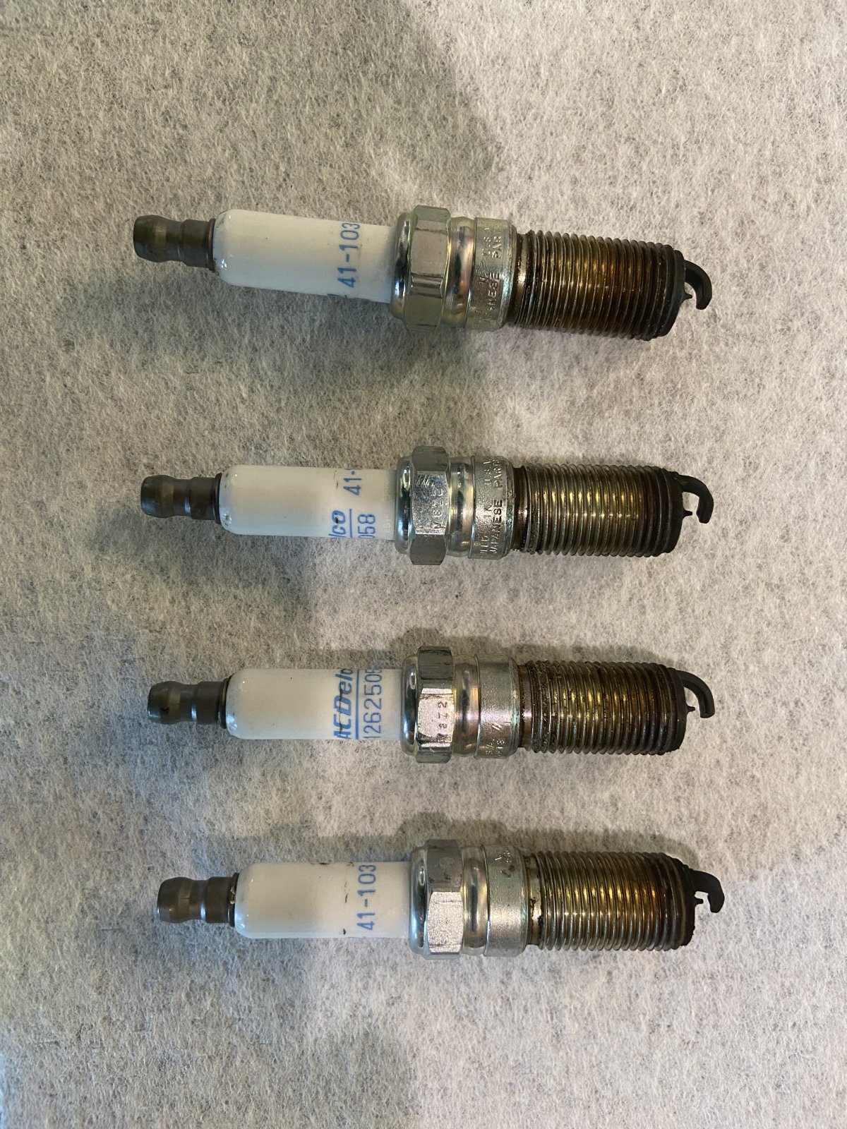

I replacde the spark plugs and cleaned the throttle body. But that made no difference in the way it runs. At higher RPMs. It runs Nice & Smooth, but it won’t idle. It backfires and runs rough and dies.

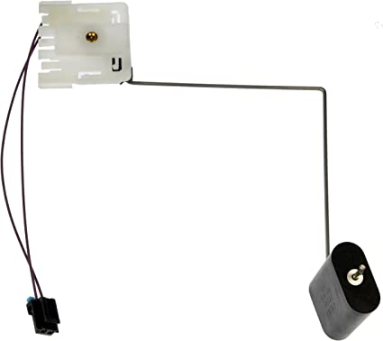

Do you have the correct fuel sender? Reversing the wires won't change the resistance, but flipping the sender over (in relation to the float) will.
For the standard American version sender (240-30 ohms), you will have between 232 to 252 ohms @ empty, and 28 to 36 ohms @ full. For the standard European version sender (0-180 ohms), you will have between 0 to 2 ohms @ empty, and 171 to 192 ohms @ full.
Sensor is a more accurate word than sender.
The Cobalt fuel sensor is inside the gas tank, included with the fuel pump. It consists of a float attached to an arm which is attached to a potentiometer (variable resistor).

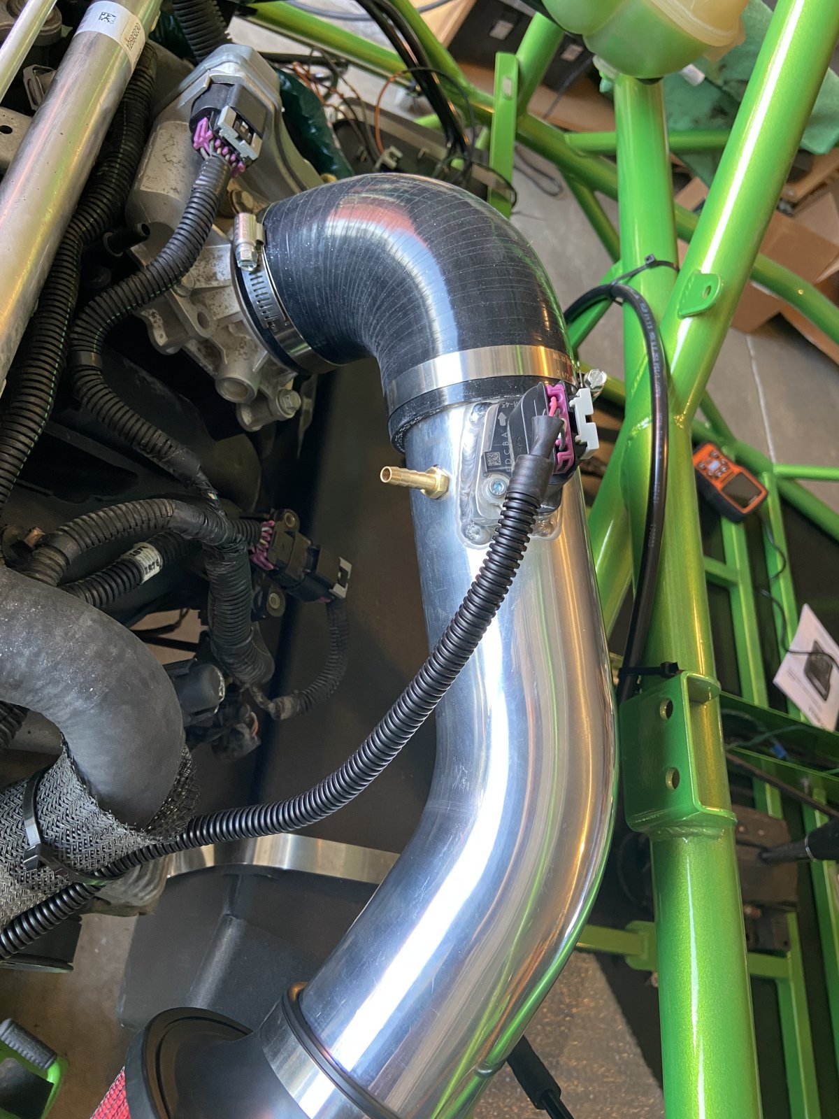

So when I got home from work we tried the car again. We put on the air intake system and put the maf sensor in. Then we took the brake booster hose and plugged the end. We started the car, and it idled!
it idled pretty consistently at about 900-1000 RPMs for about 30 seconds and then it would dip a little bit sputter a little bit and then come back. so it wasn't perfect but it stayed running for about three minutes before we turned it off. Then we ran it for about another two minutes before turning it off again. It’s the first time that car has run in probably 27 months.
any other suggestions?

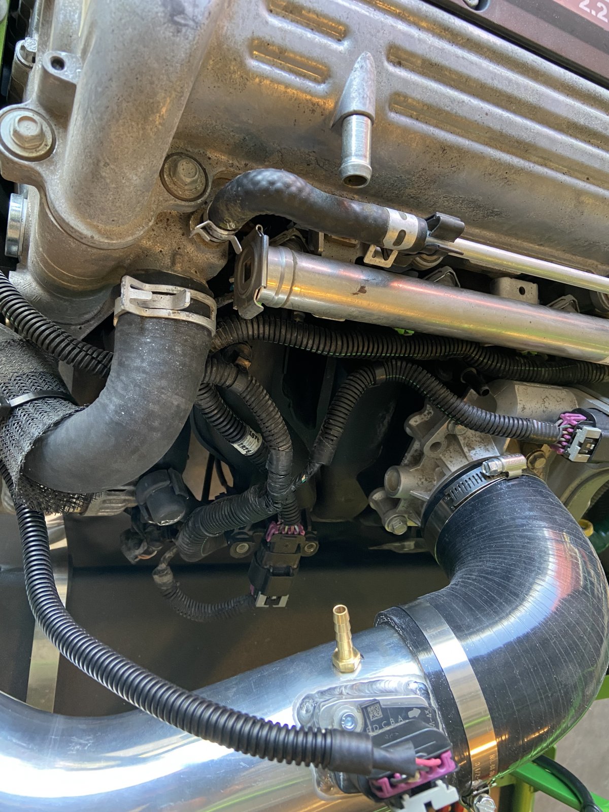

The air intake has the place for the maf sensor but also that second air intake. What is that for?
does it connect to the port coming out of the valve cover?
and here is our fancy job of plugging the brake booster hose.
Yep, the bronze fitting in the intake tube gets connected to the open port on your valve cover in the second photo. You should get the hose run to the front of the car for the brake booster if you plan to drive it at all.

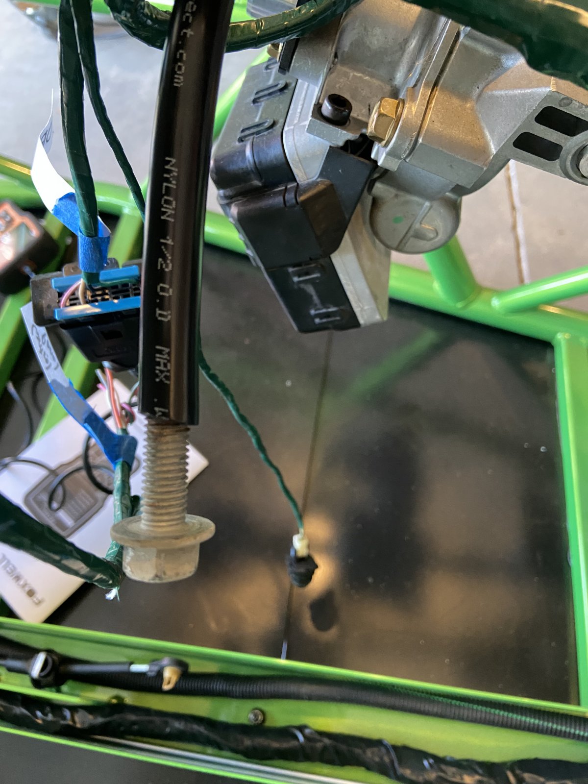

AND speaking of brake booster hose, any instructions for moving and mounting the brake reservoir?
Use some sort of thread sealer on the brass fittings into the aluminum block. Mine weeped until I pulled it back apart, cleaned it, and reassembled with some blue loctite. In my experience, a pressure bleeder is the easiest way to bleed Goblin brakes, especially on the first fill.
Use some sort of thread sealer on the brass fittings into the aluminum block. Mine wept until I pulled it back apart, cleaned it, and reassembled with some blue Loctite. In my experience, a pressure bleeder is the easiest way to bleed Goblin brakes, especially on the first fill.
I put a breather filter on the port coming off the valve cover and then 'sealed' the intake port with silver air ducting tape.
I completely agree with the pressure bleeder. That thing is the stuff! Easiest way I've ever bled brakes and clutch lines. I've even recommended it to people on other projects that were dreading doing their brakes.
Unfortunately, not really. The photos posted got me through it all. It's not that hard to do once you get it figured out. Until you do, it's a bit tricky to visualize. I did use Red Loctite on all the brass fittings. Here is some photos I took of it all during my build, I hope they help you. If you need more, I'm sure we all can accommodate.
And that’s a pretty big size difference in the two ports. Will one hose fit both?
It will, you just have to crank that hose clamp down uber-duber tight. I have seen some others use stepper connectors to get there. I guess you could go get some tubing at the store and run the proper diameter all the way as well, if you're super concerned with it.
