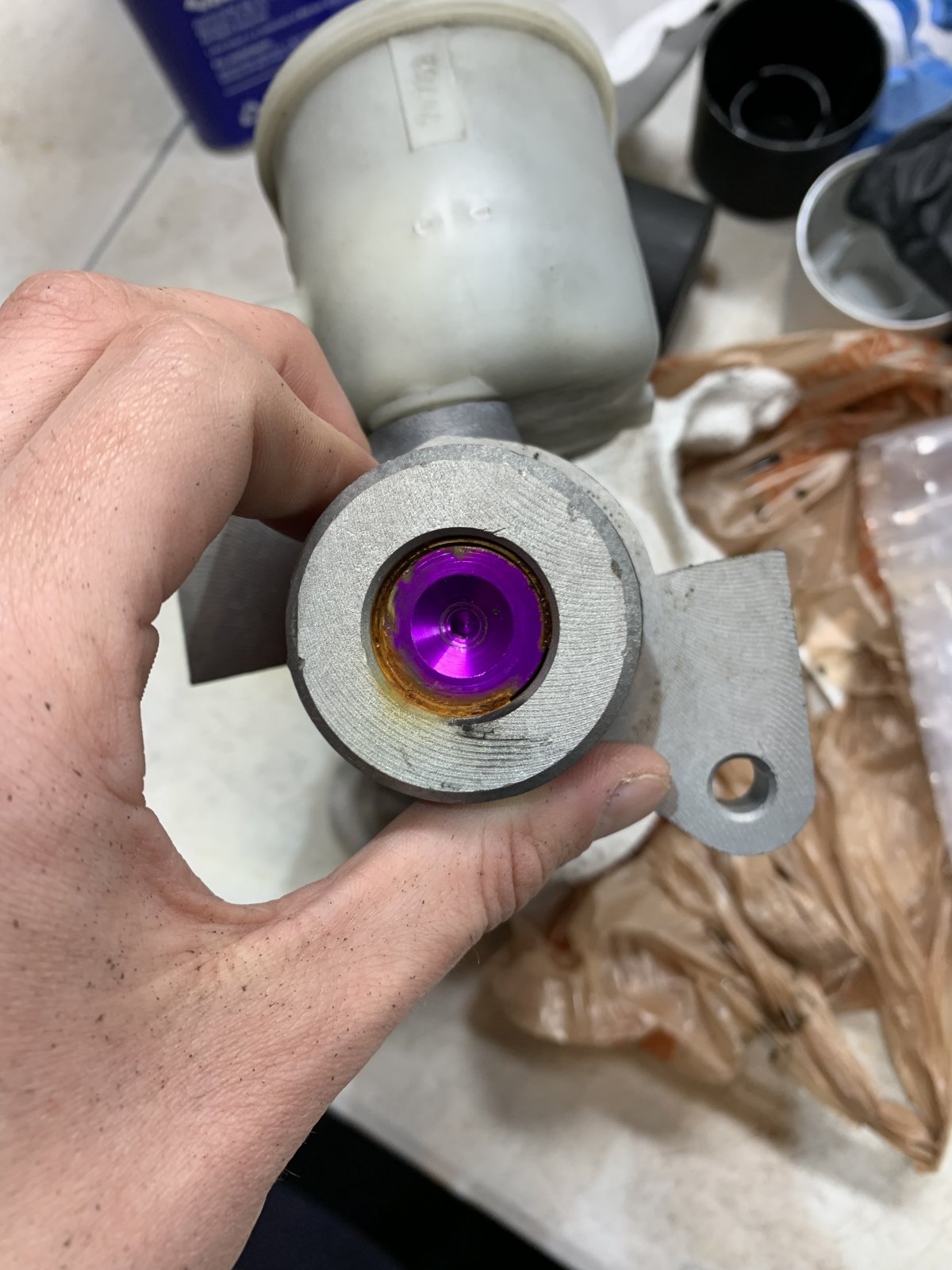

Getting ready to install the brake master cylinder and brake booster and noticed some rust around the ring where the booster connects to the master cylinder. Any concerns about this?

Yep. I would push the plunger in and wipe everything. If anything looks real bad, remove the c clip and remove the piston. Clean it all up and put it back together
