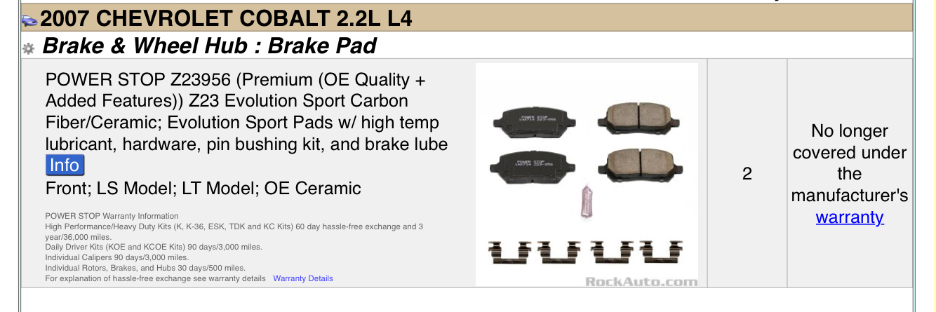

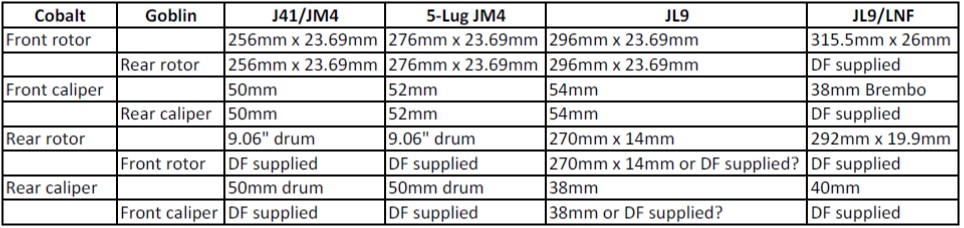

I ordered the same set, but I guess I forgot to turn my brain on that day because I thought it was a full F+R set. I discovered that yesterday when installing the brakes on the front of my Goblin, and I wasn't sure if Cobalt front pads = Goblin front or Goblin rear. I went ahead and tried, and they fit fine. So today I was looking for rear pads, only to discover a very limited option set... but you're saying that these "front" pads will work on both?
