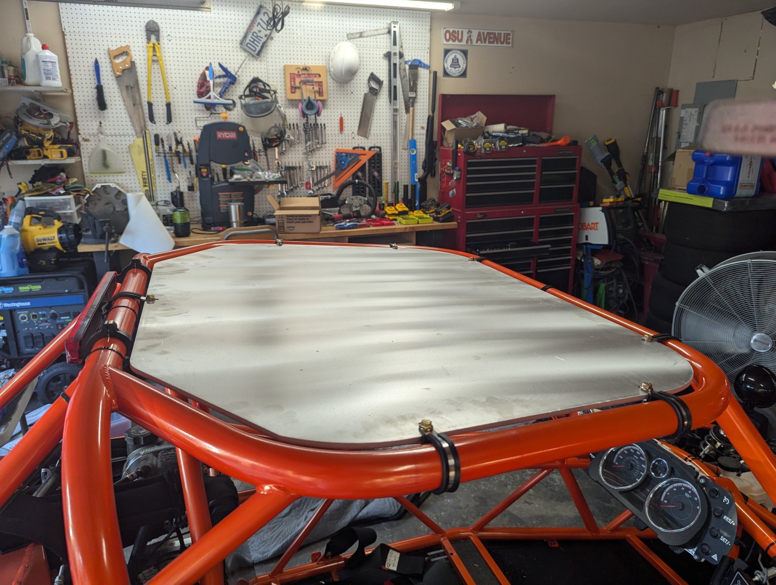

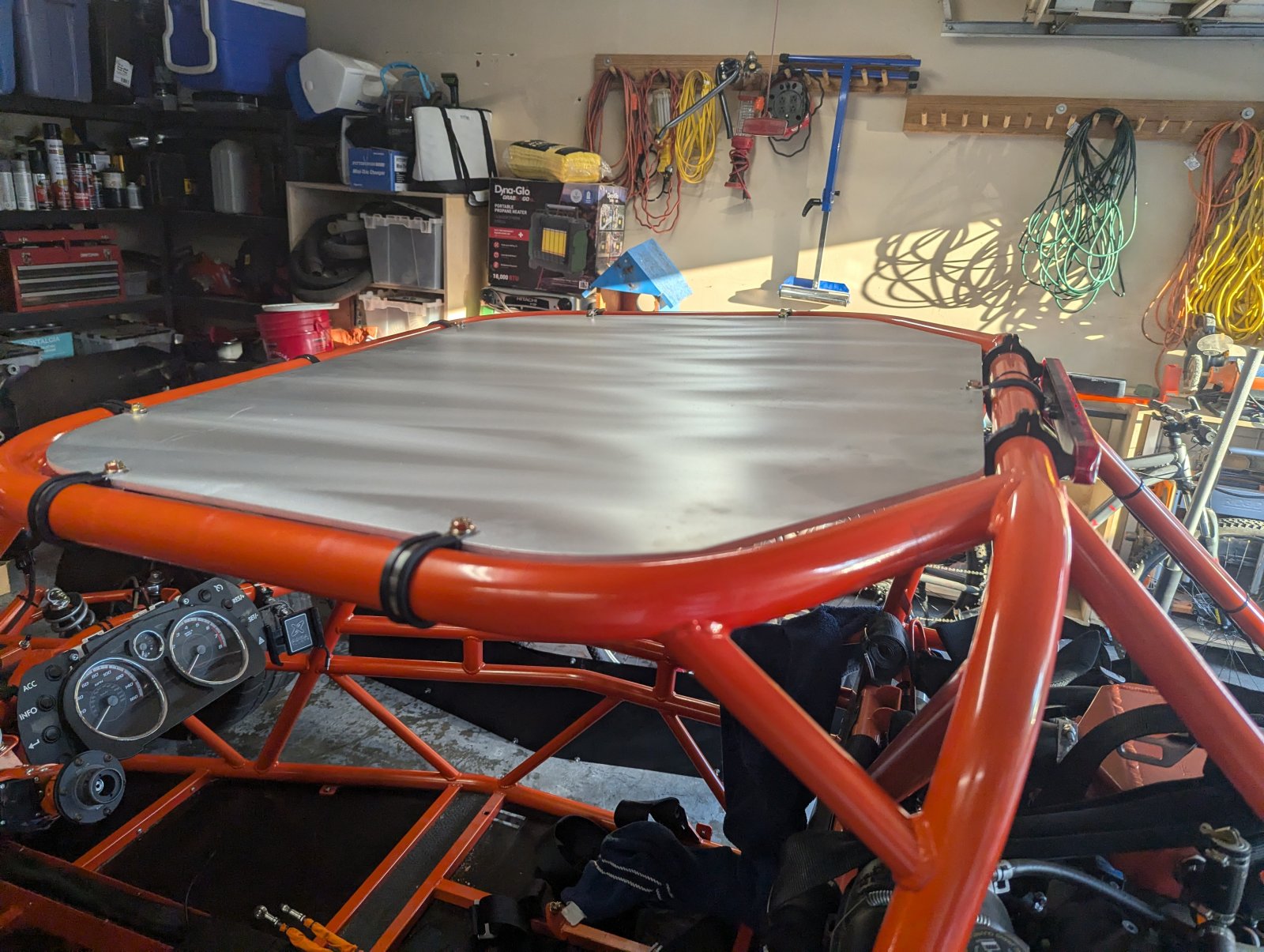

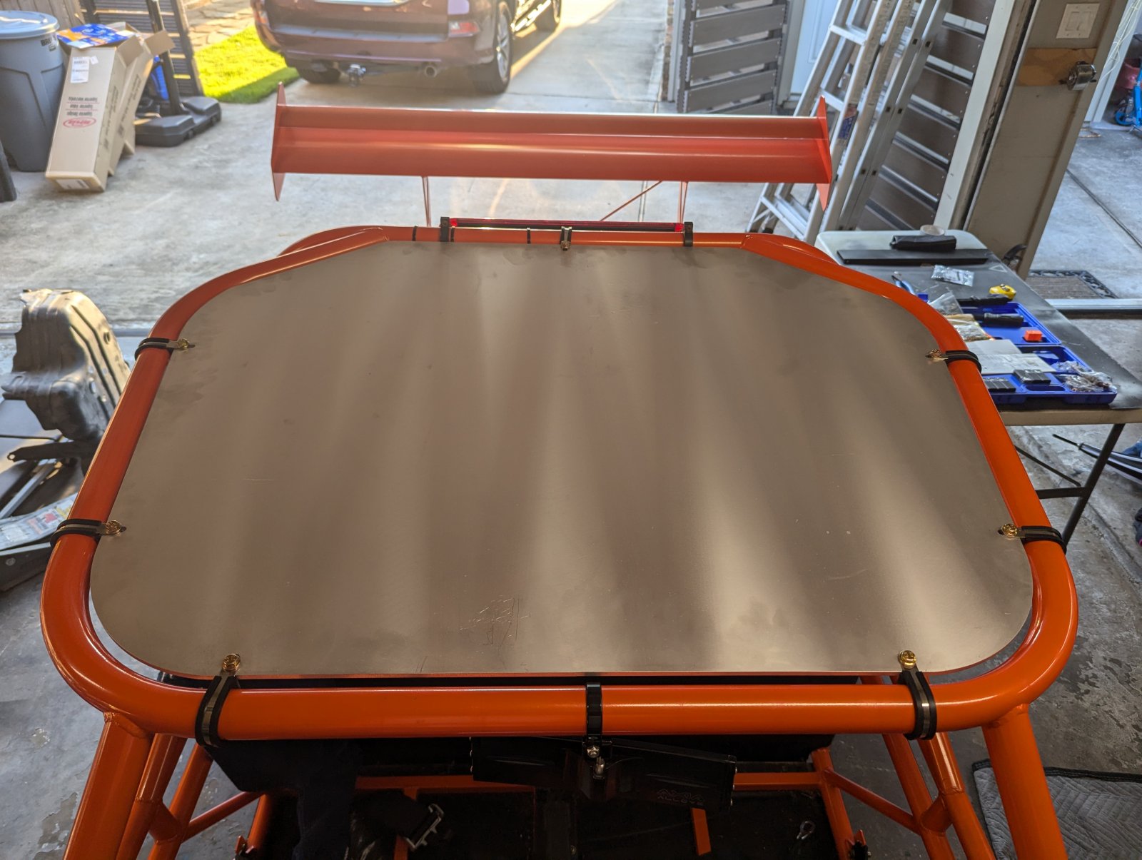

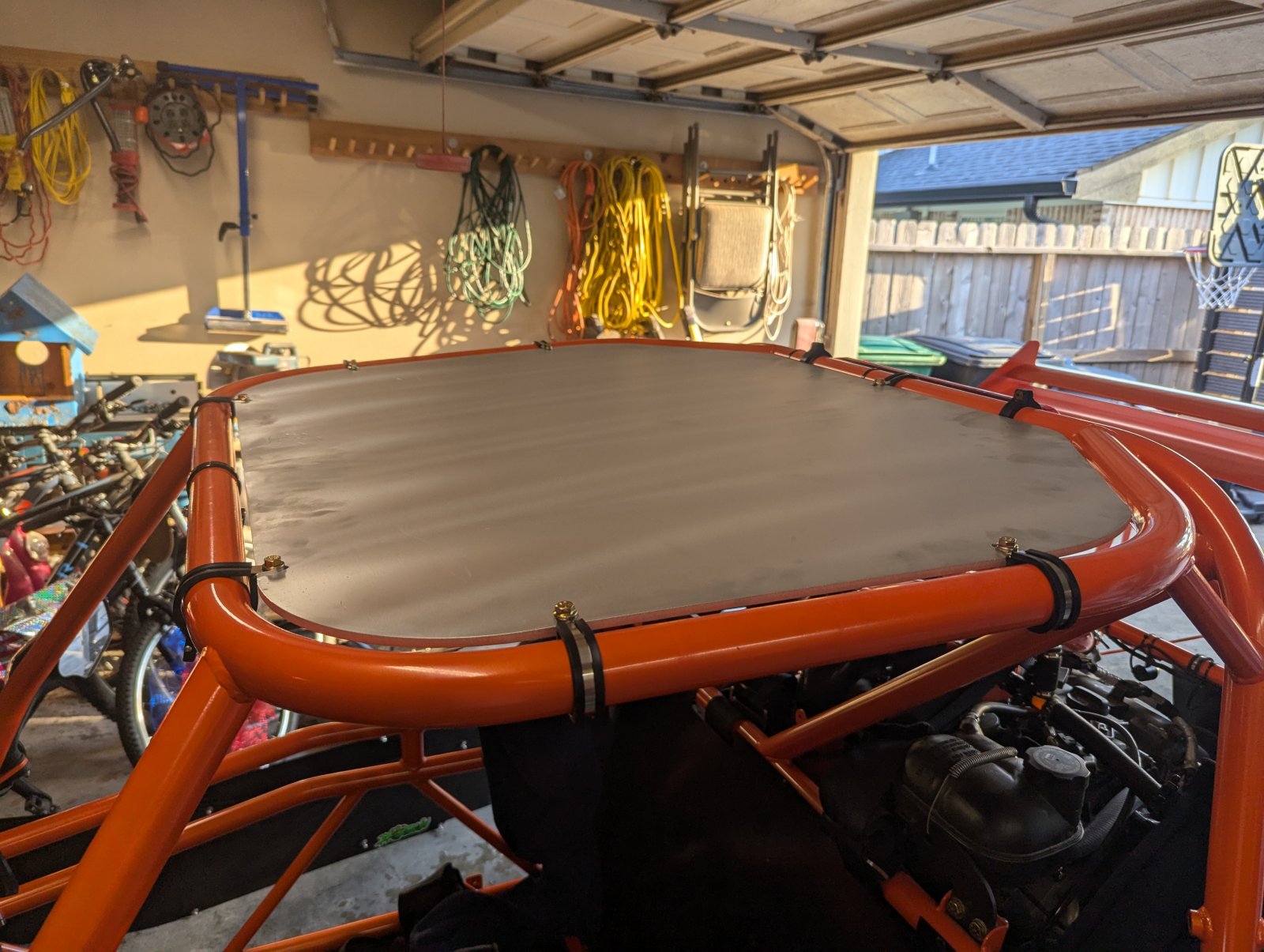

Wow, 9ish months since my last update.
Been working on the Goblin to take care of various items before Goblinfest. Getting the DF shifter installed and the rear suspension upgrade installed along with numerous other items that have been bugging me.
Shaun, the guy that made the front splitter group buy, made a roof for me.
48646
48648
48649
48650
Going to get it powder coated the same as the frame. I believe Shaun will be putting these up for sale soon. Mine is 1/4" thick but production ones will probably be 1/8" thick.
Brett
