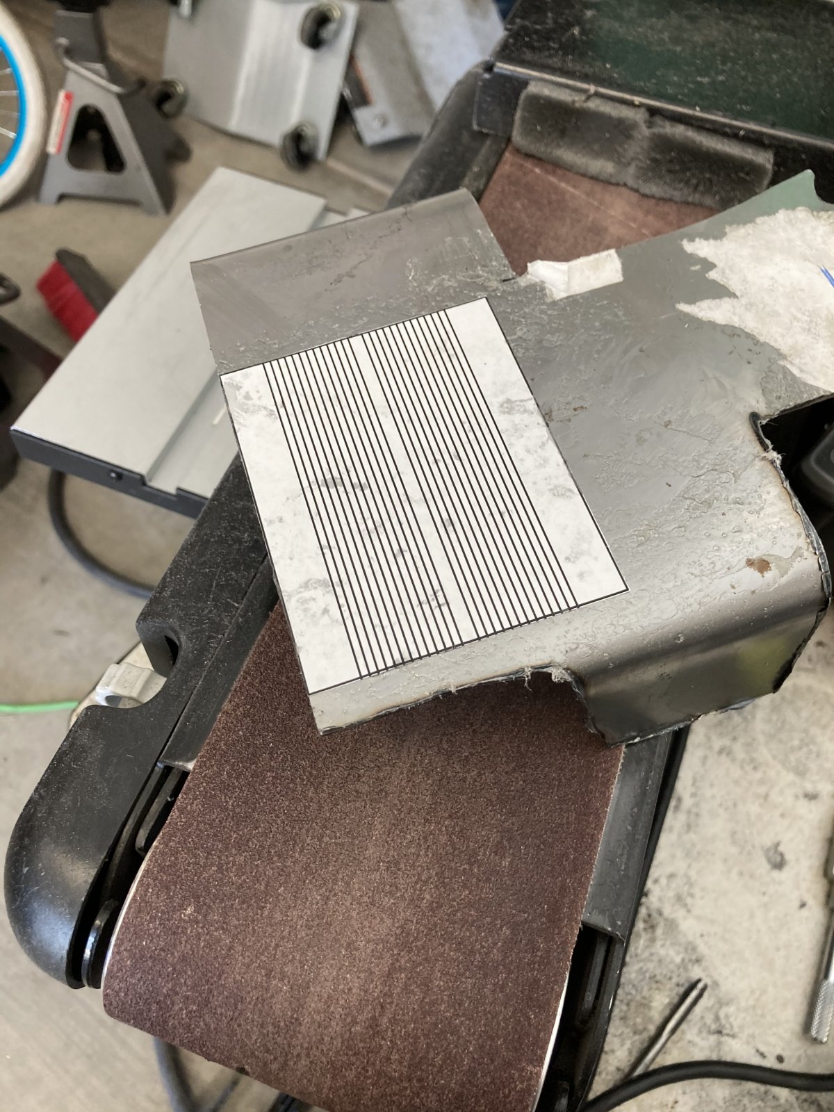

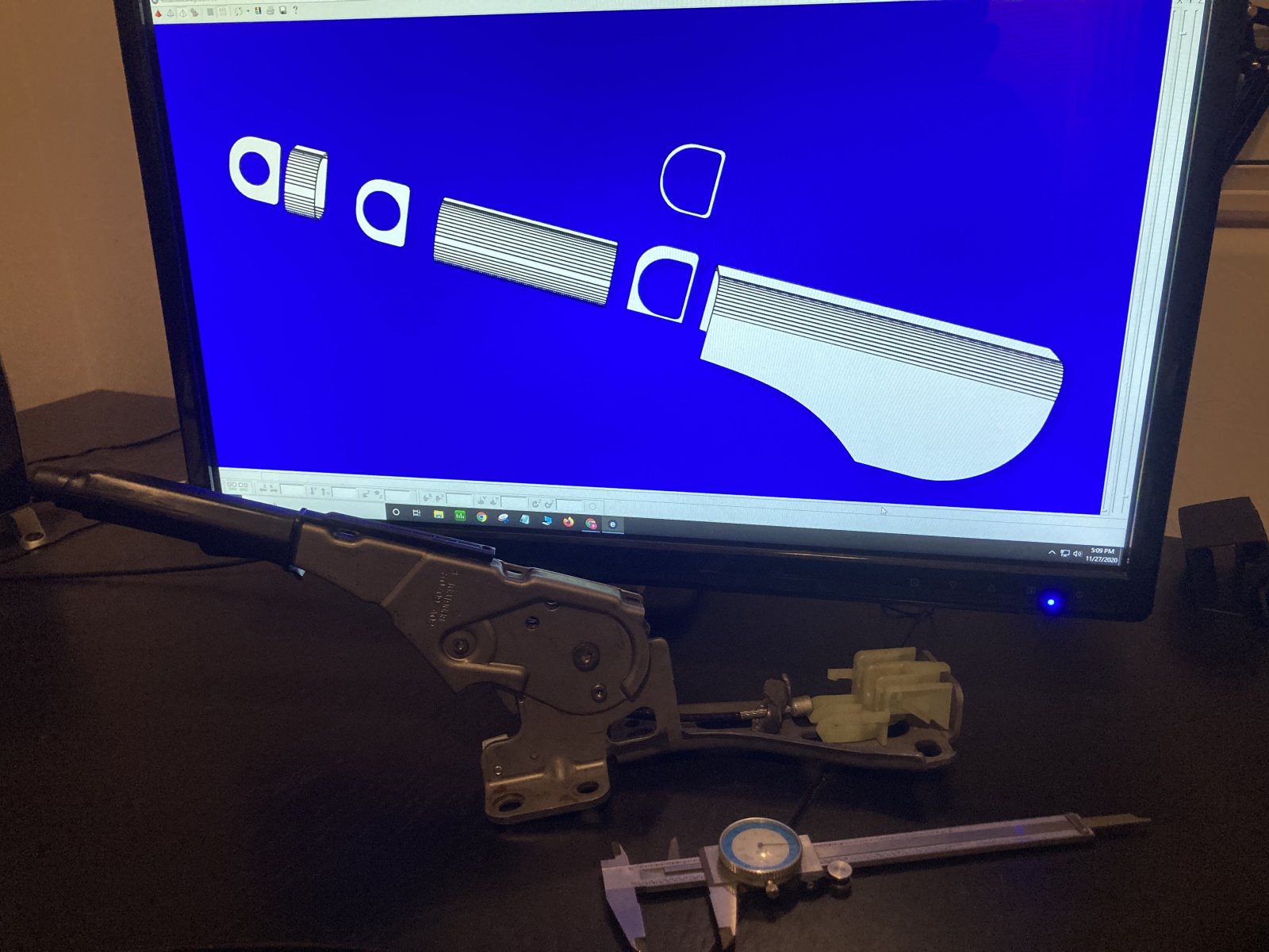

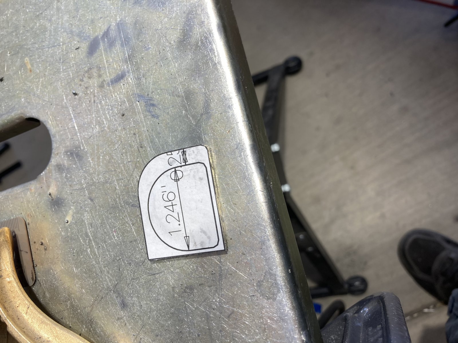

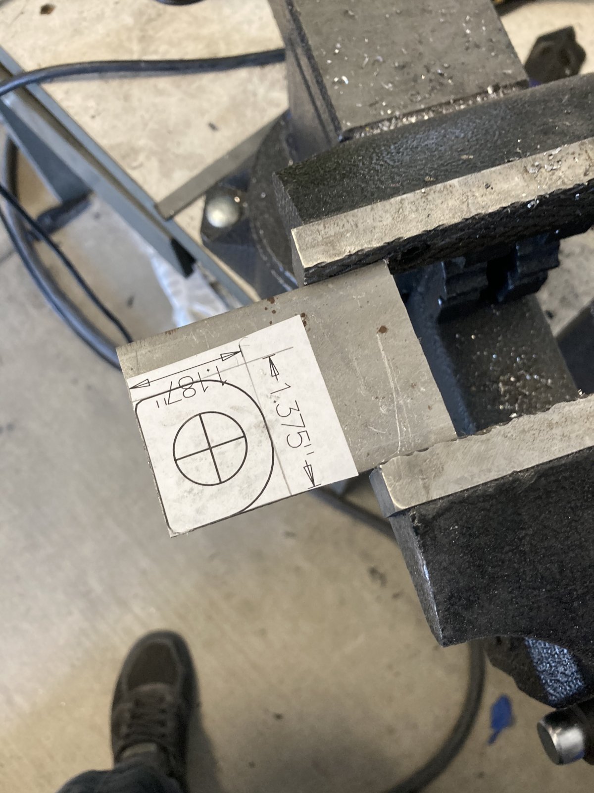

I will CAD a part, print it out on paper, and spray mount it to cardboard. Being able to have at least a cardboard piece allows you to see fitment and aesthetics three dimensionally. Then, if any changes are due, you can mark right on the cardboard. I seriously need to find a cardboard distributor that sells a cardboard stock with similar thickness to 16/18 gauge steel.
Classy
I ask people I used to work with for 4x5 foot sheets of cardboard I use for that, thickness isn’t correct, but it is mighty helpful not having creases and a large canvas is very useful. I have made frames out of wood to see a design and play with it to make sure it works.
All that being said, I have no experience with sheet metal, but I do have a metal brake, I could easily adjust it and fit a pipe or something to it to roll edges instead of hard corners

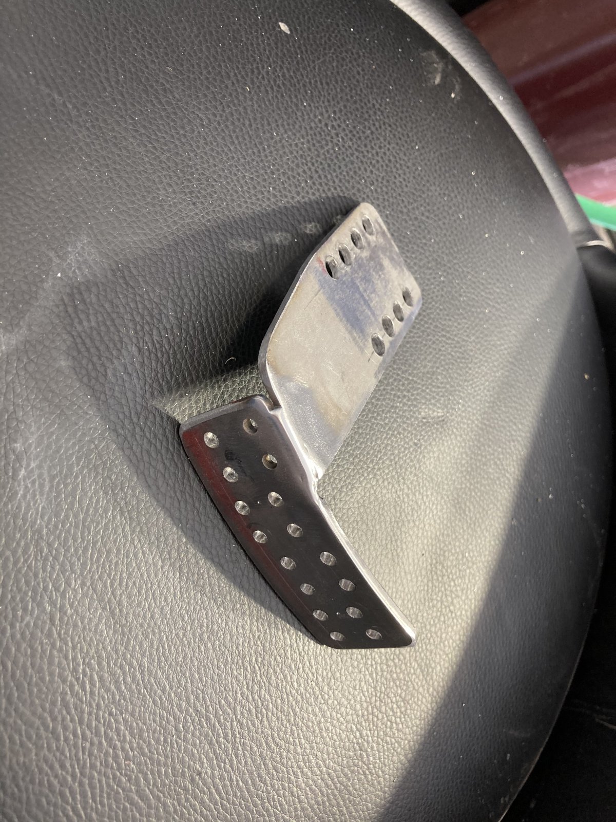

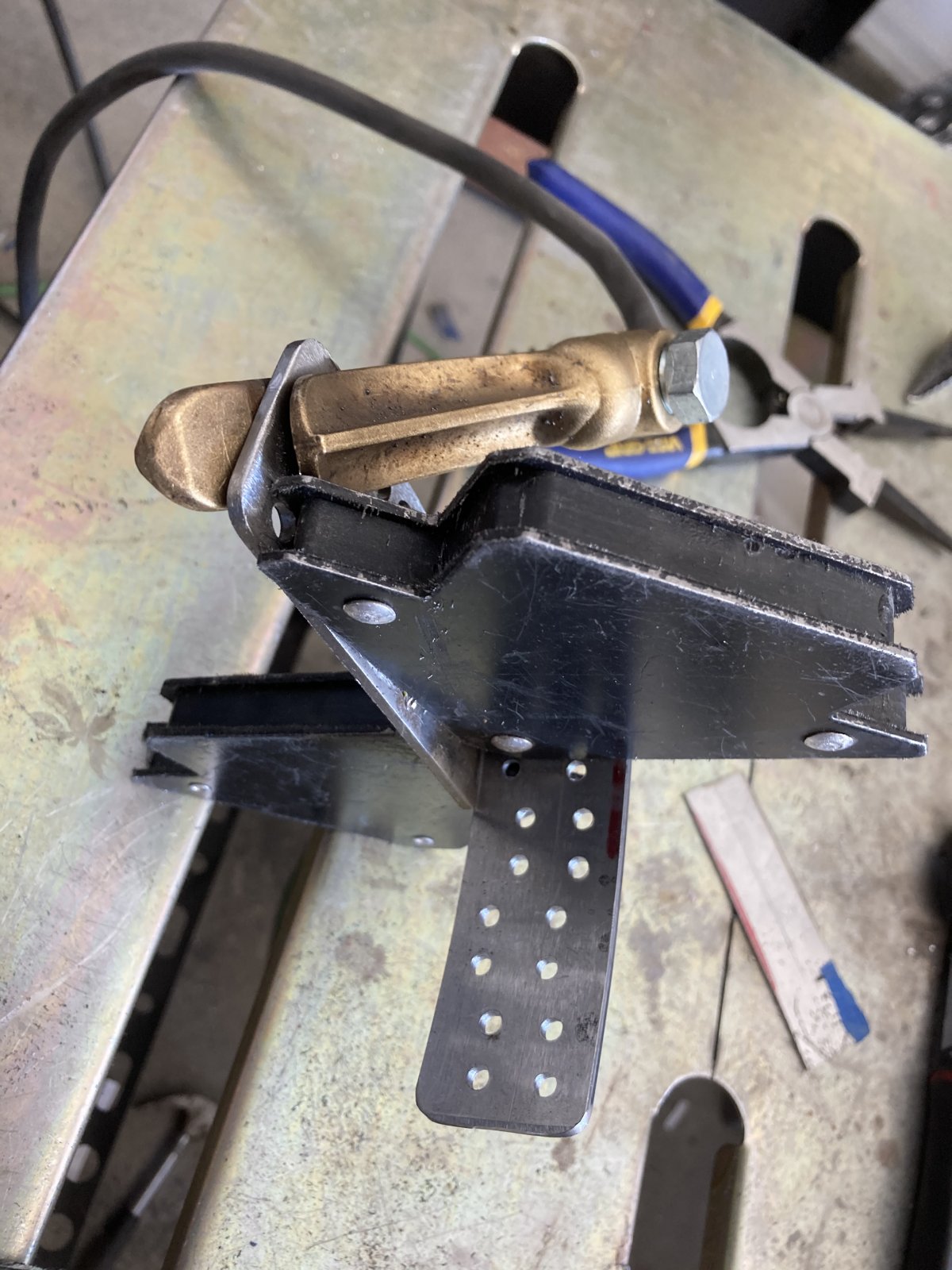

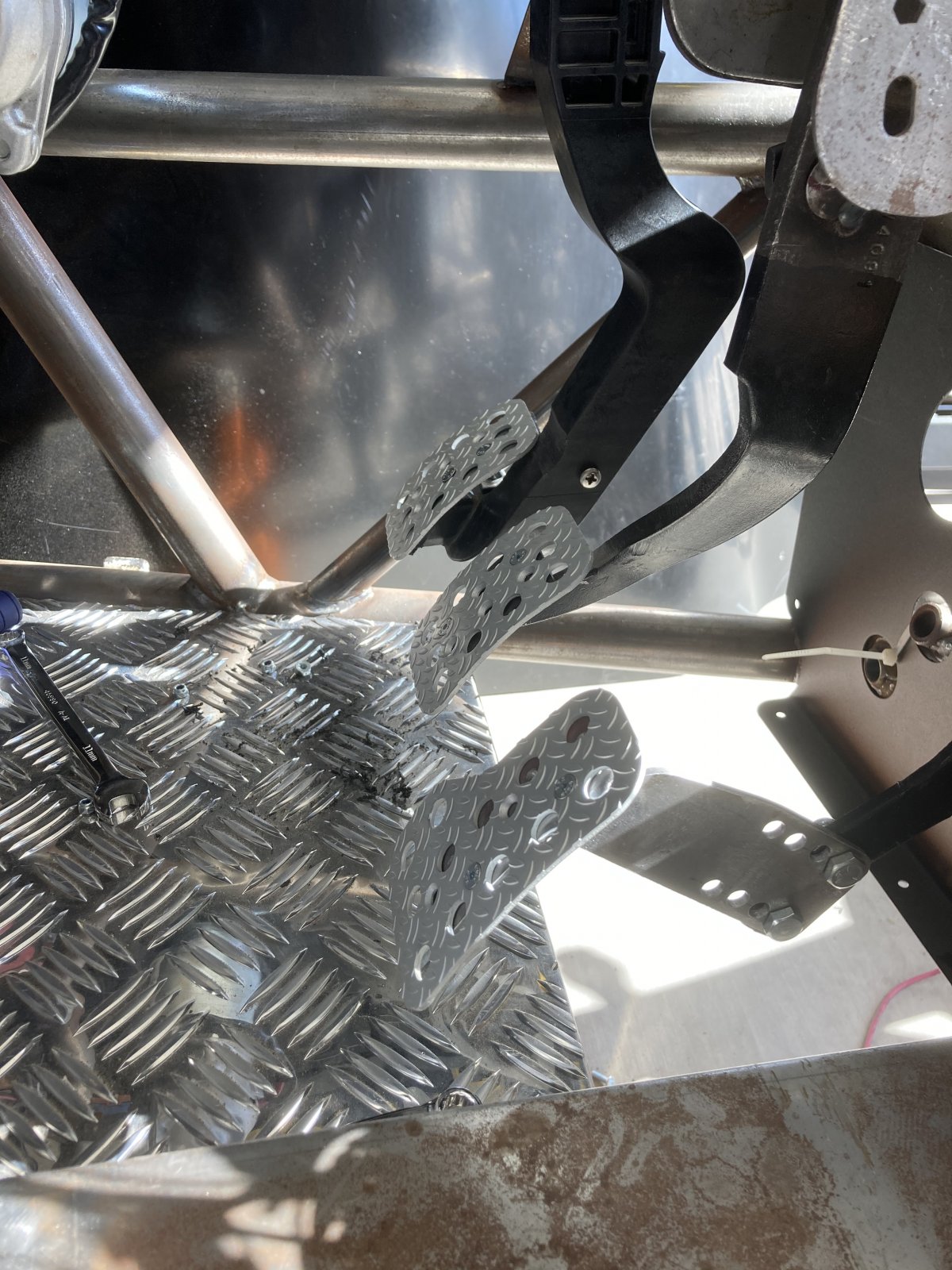

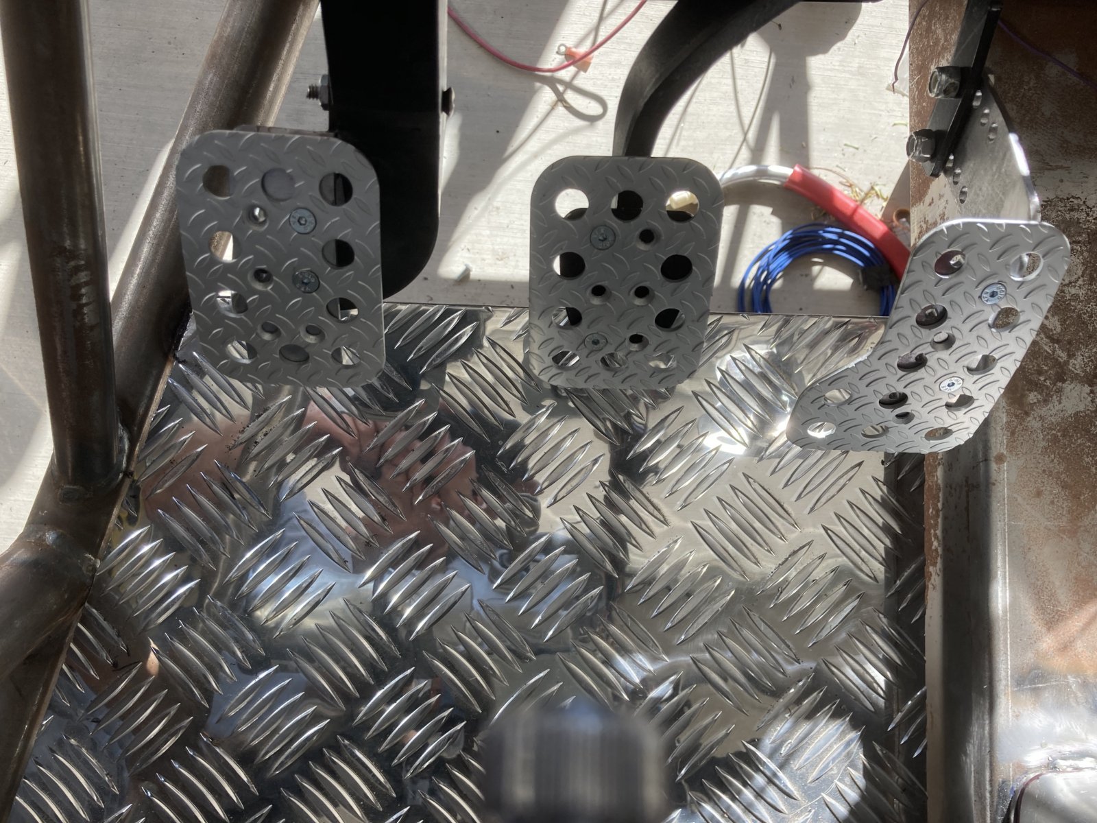

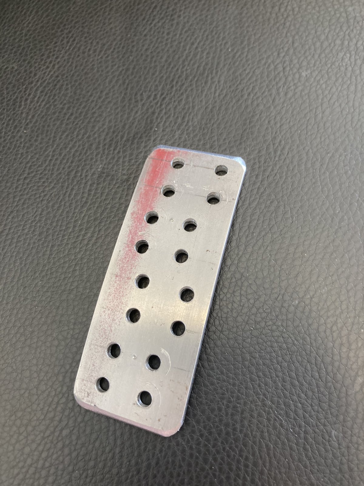

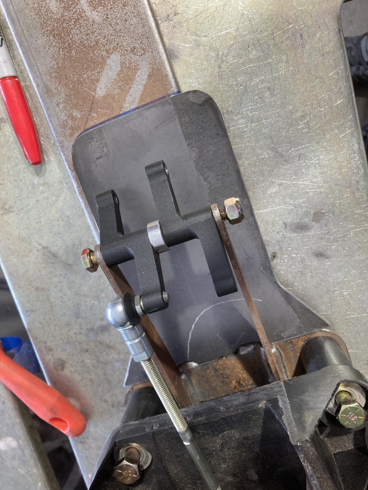

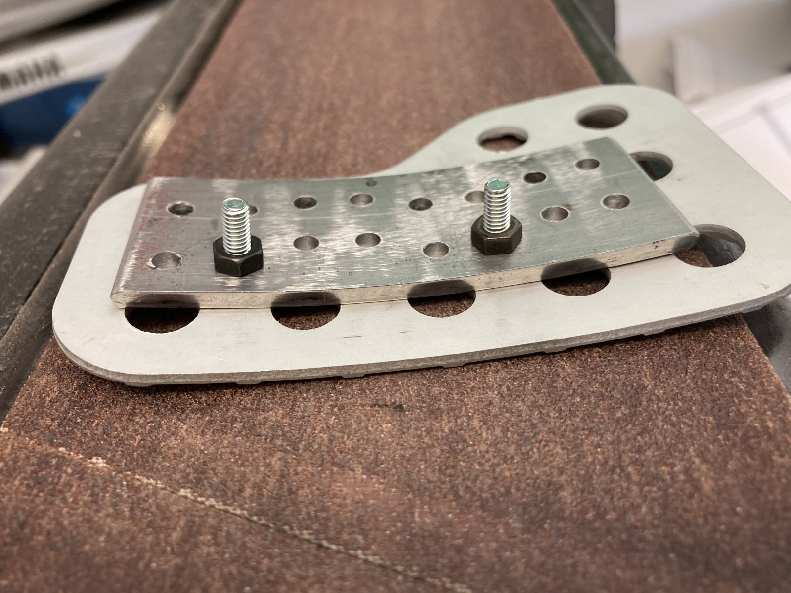

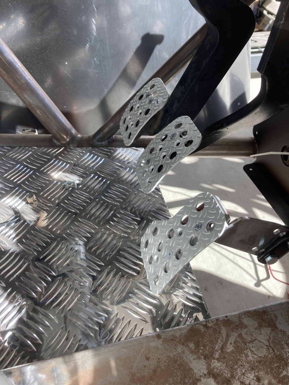

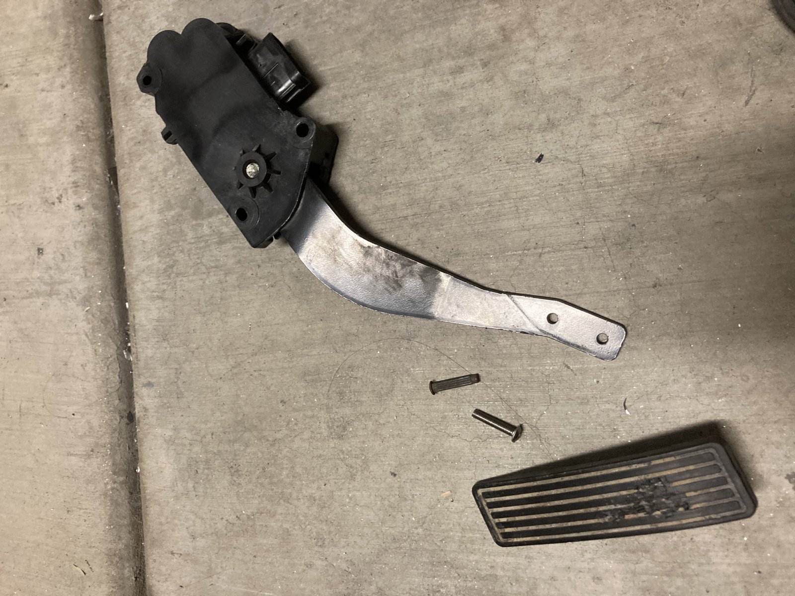

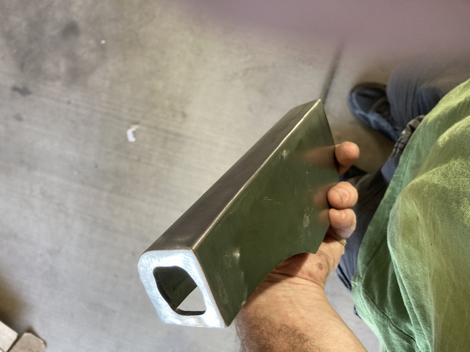

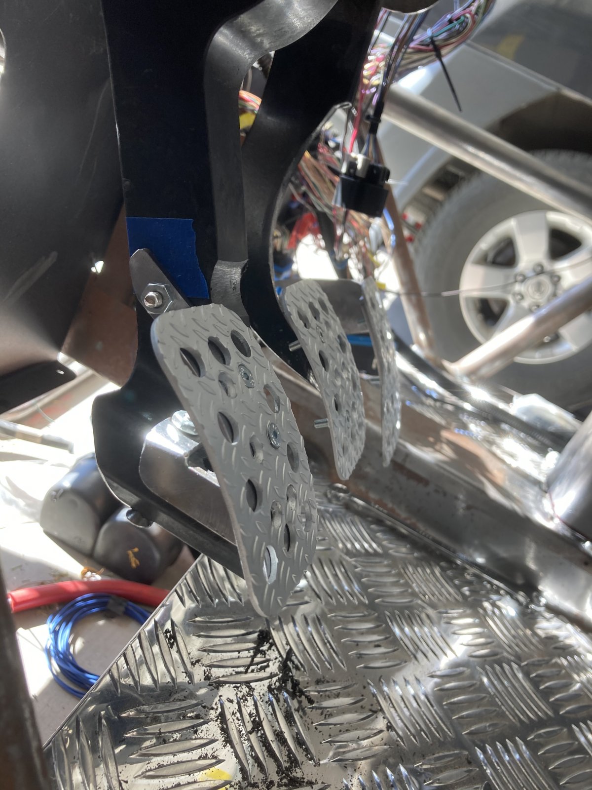

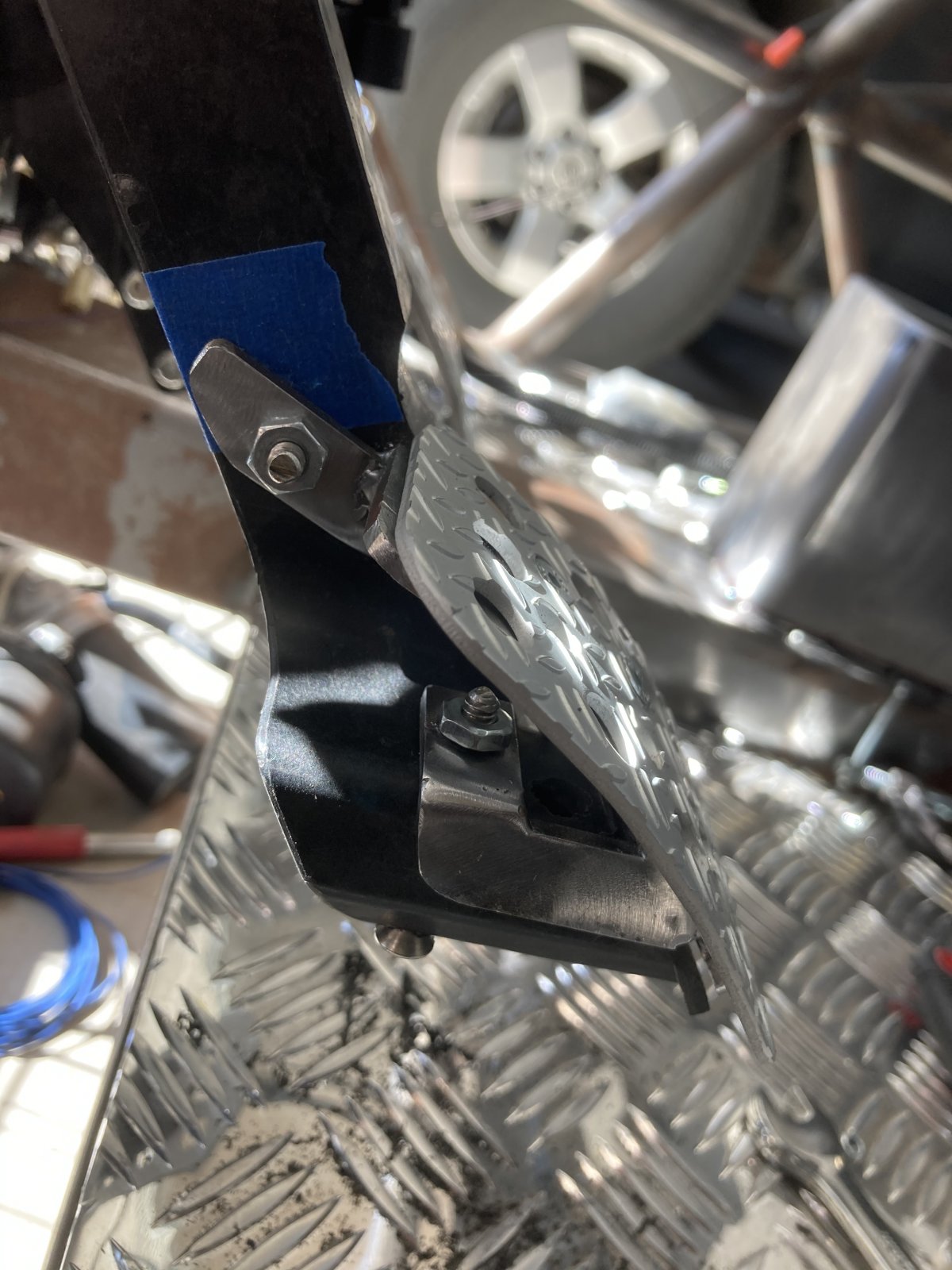

I didn’t think I’d get much done today. and built a bracket for the gas pedal.
MUCH better position, angle & throw now. It can be fully adjusted up, down, in and out, or left/right for spacing with the brake pedal. Also drilled 3 position mounts for the brake pedal.

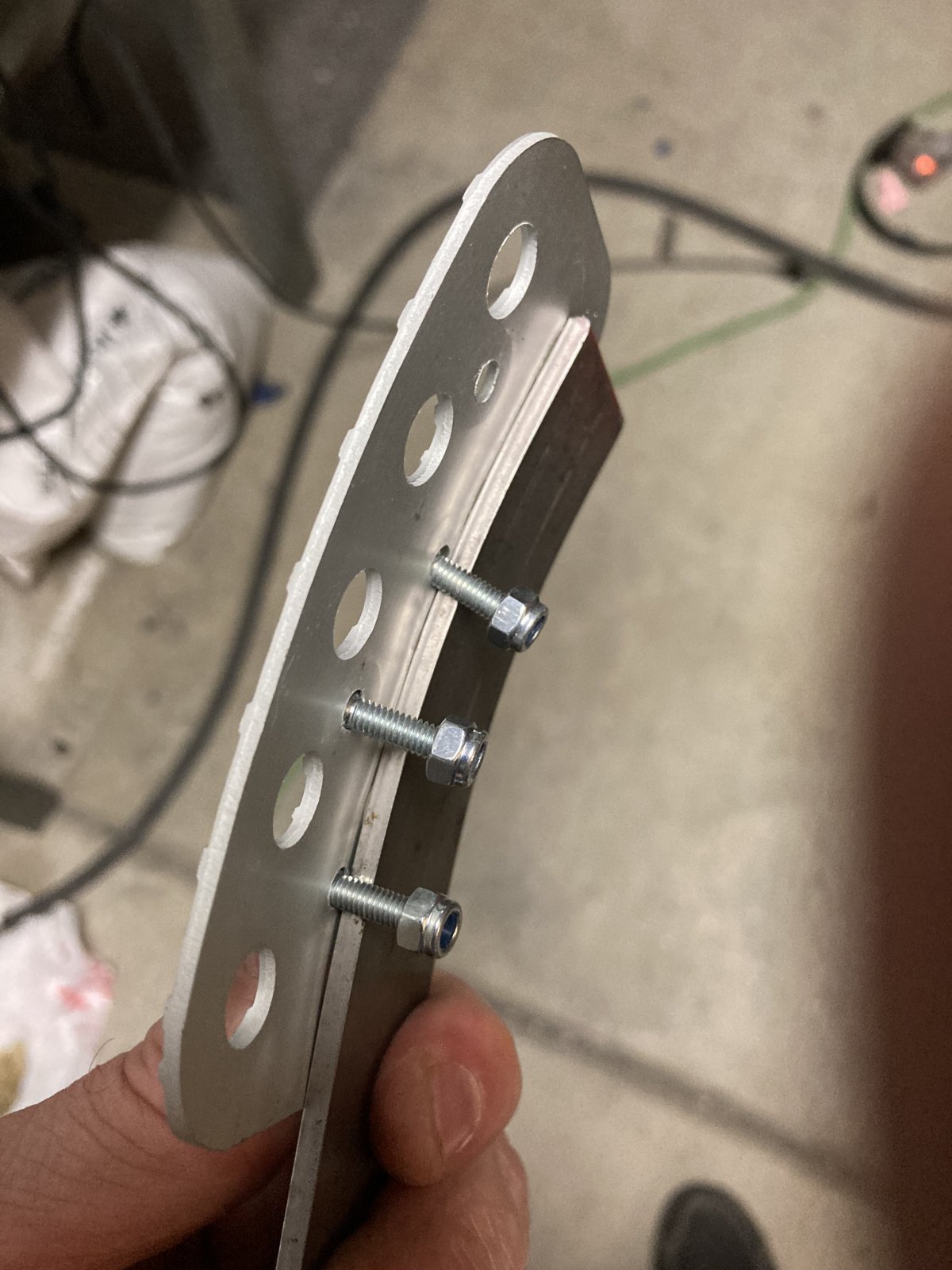

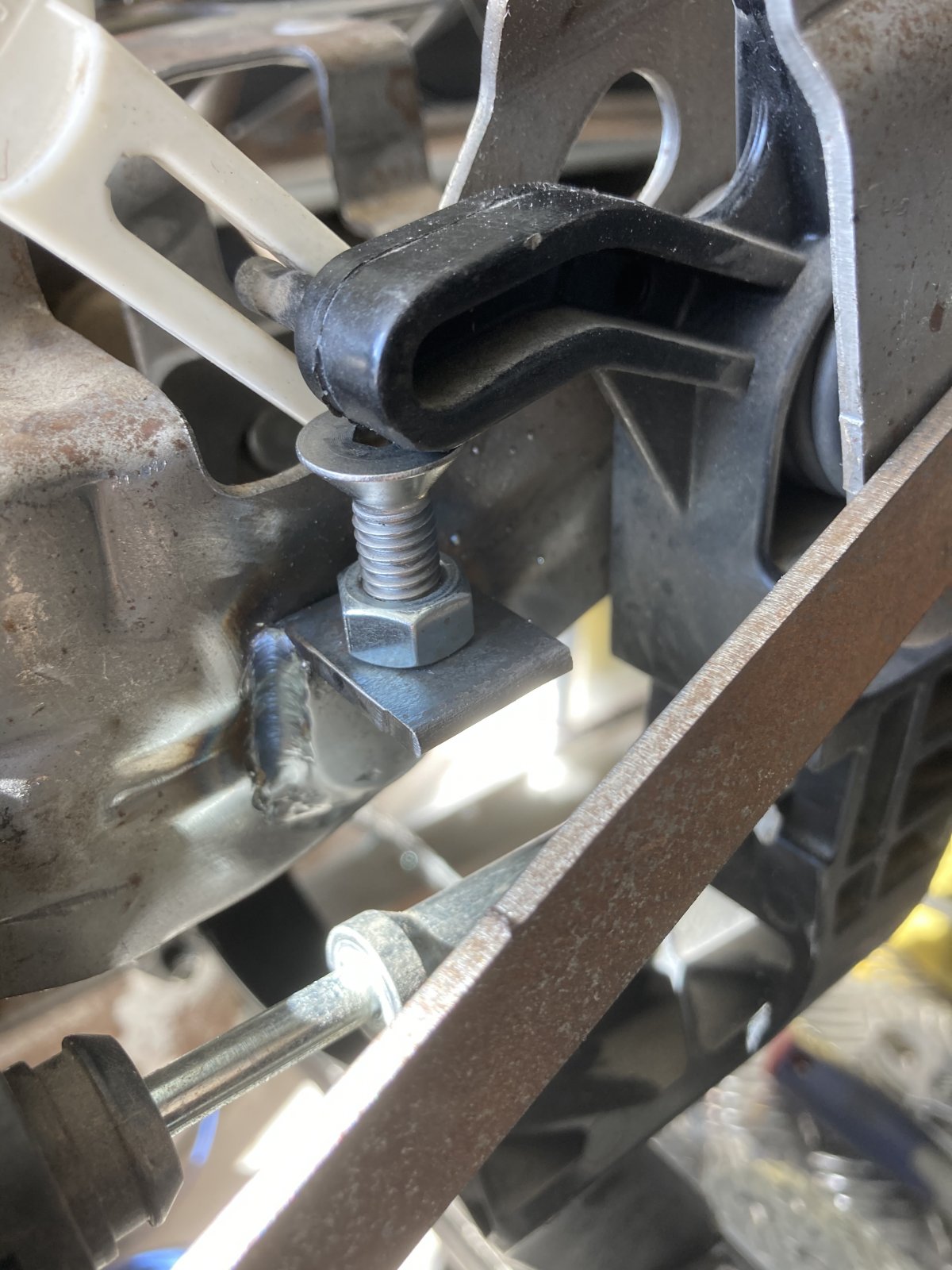

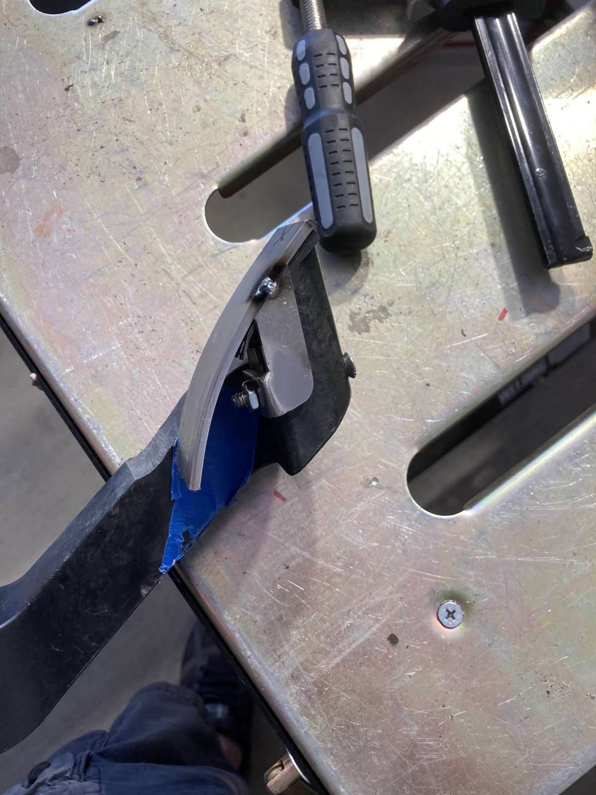

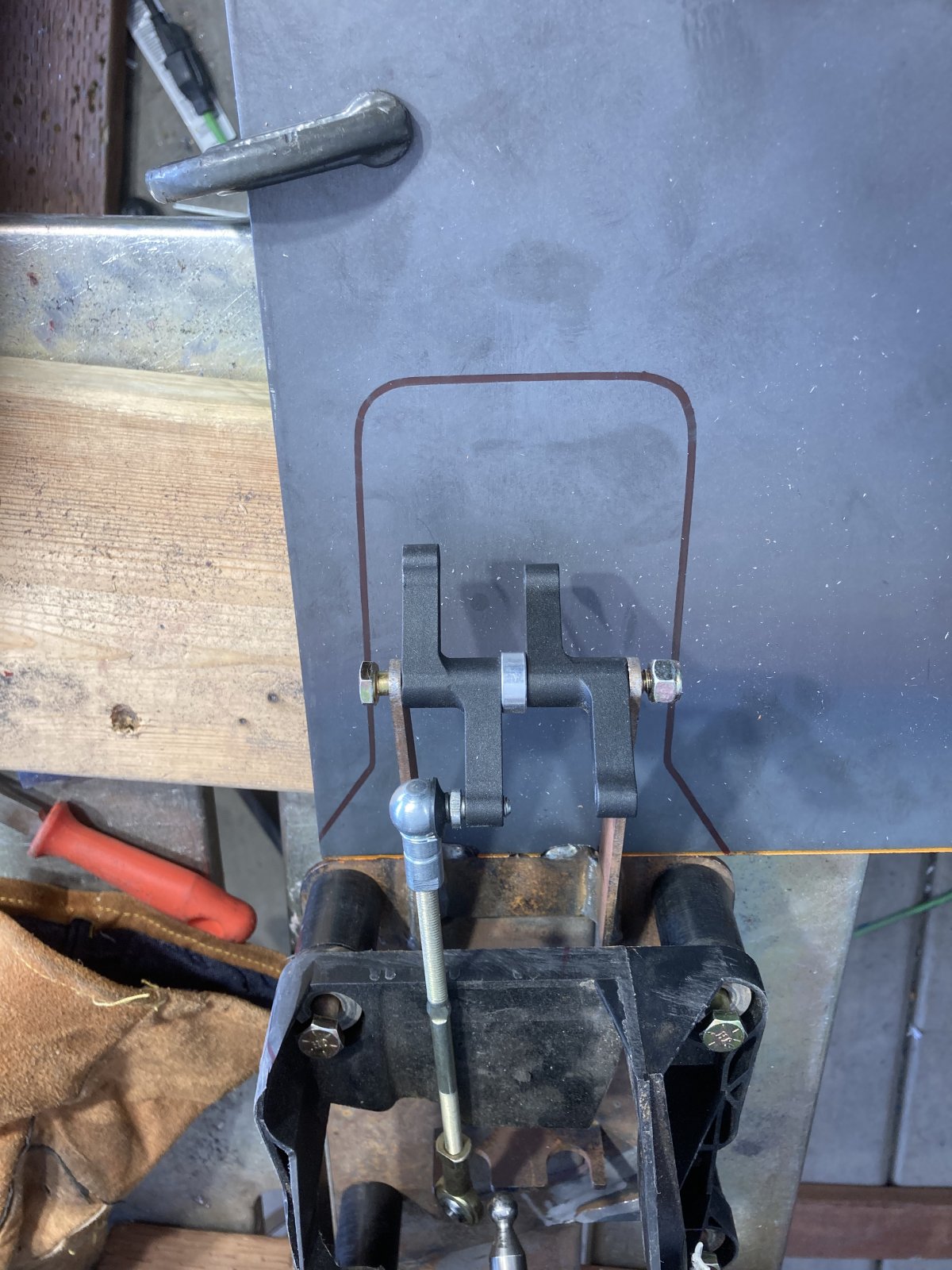

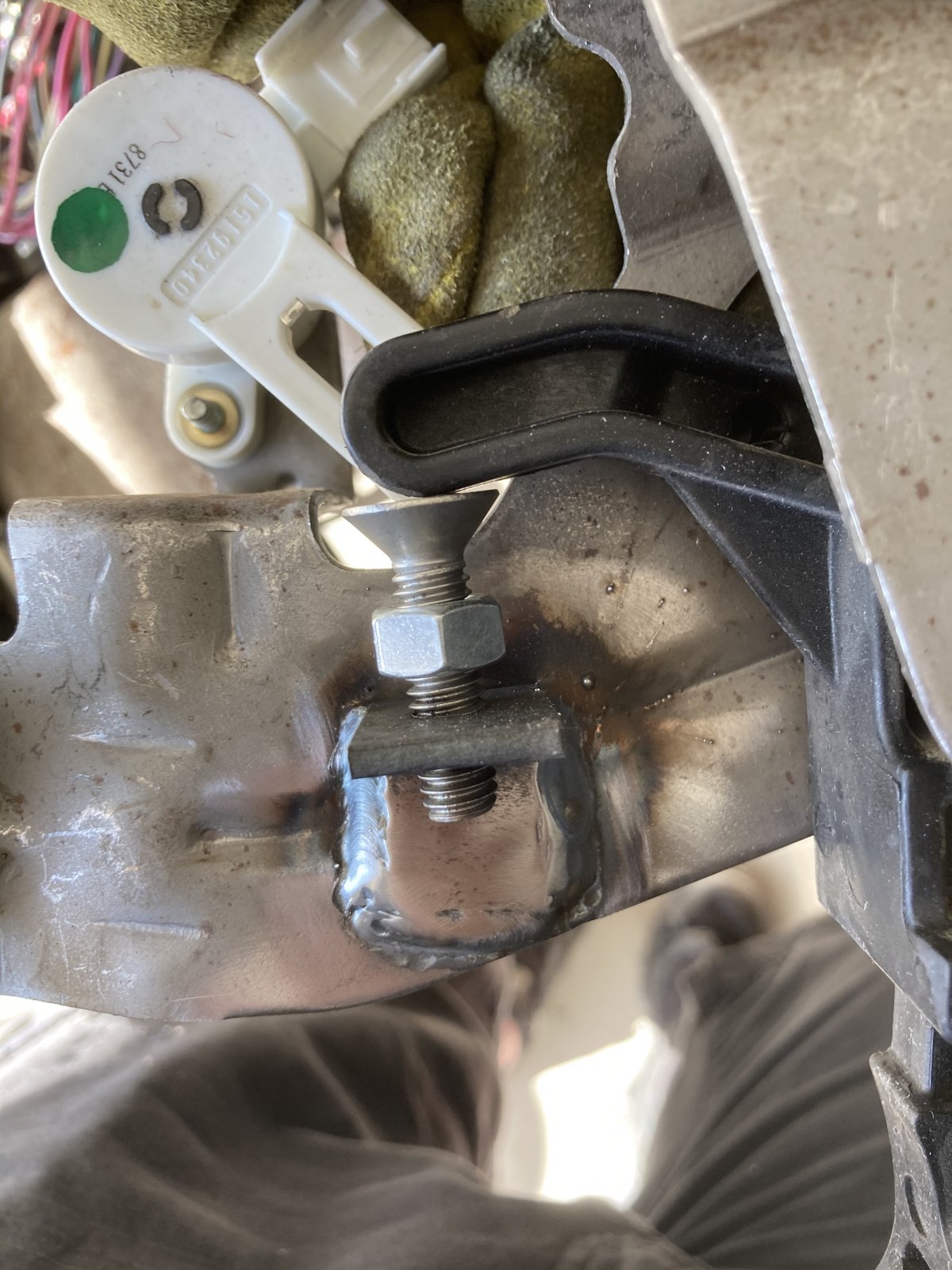

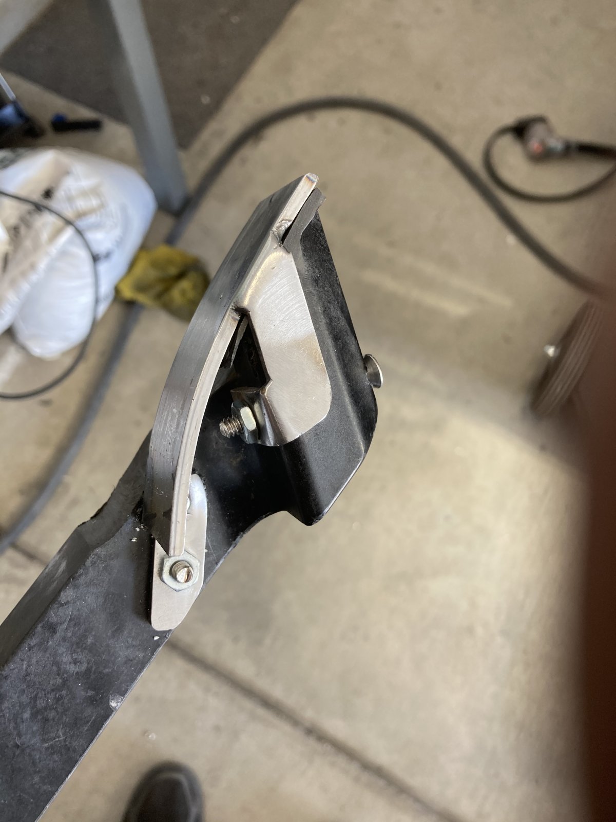

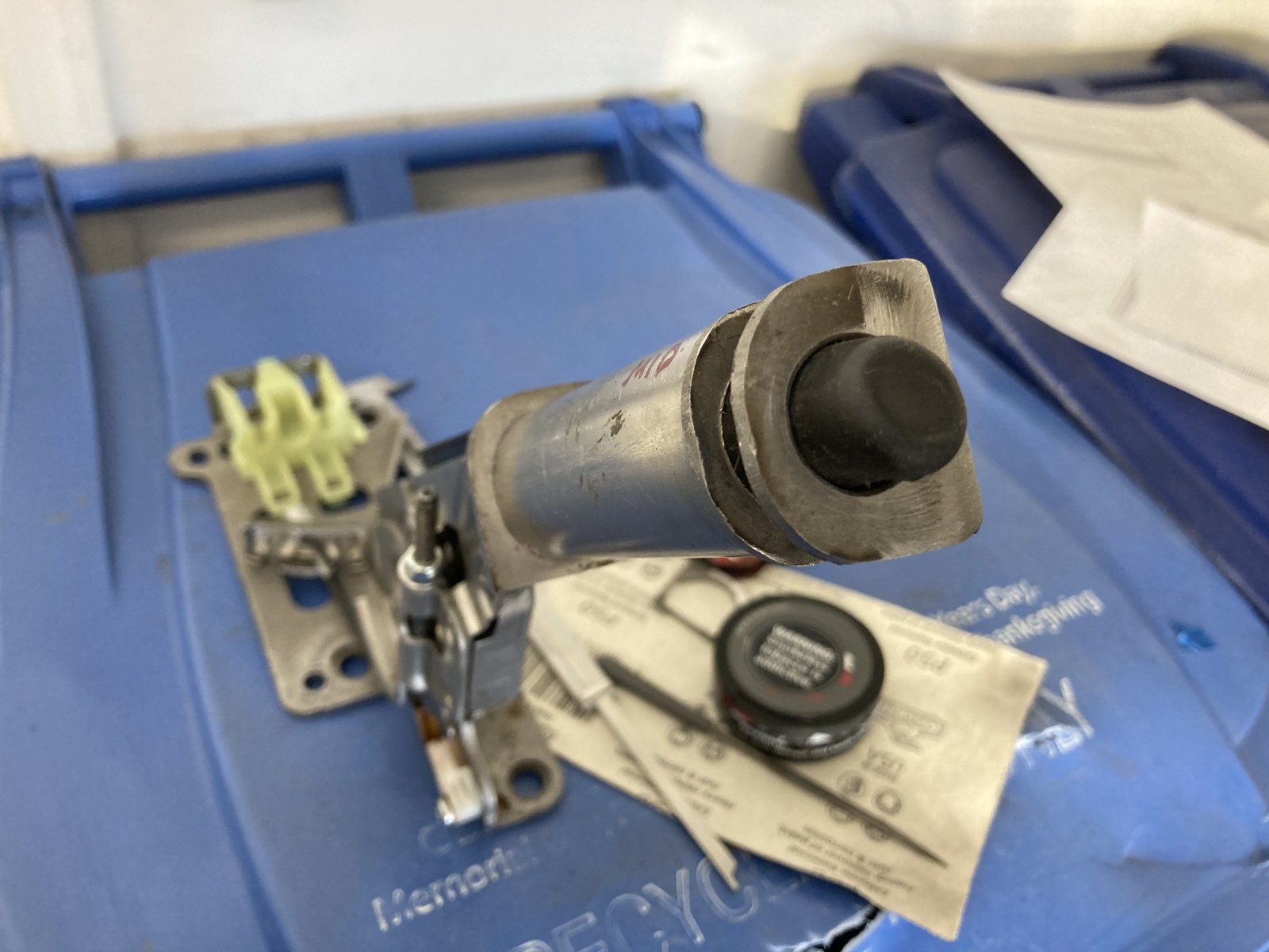

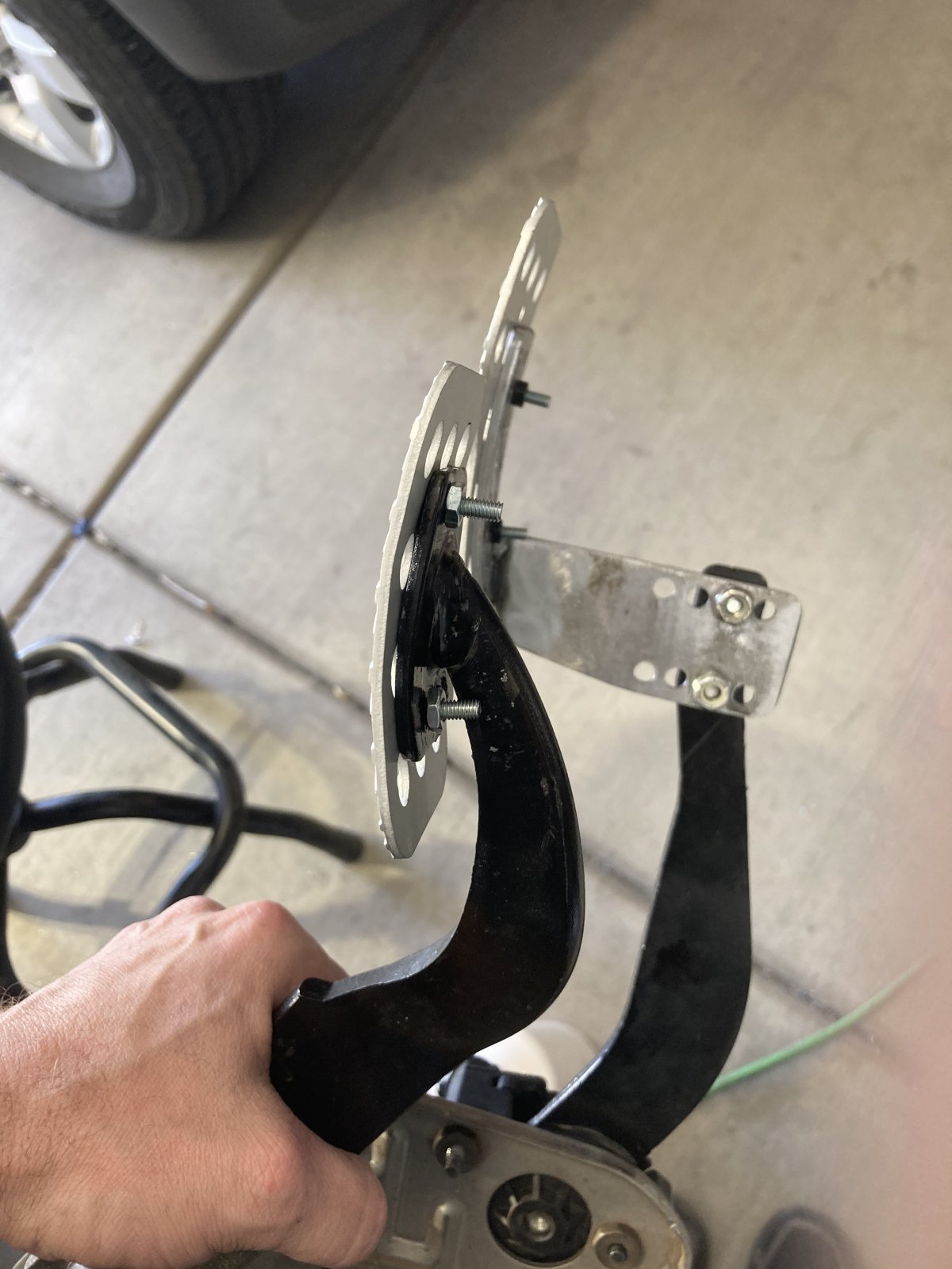

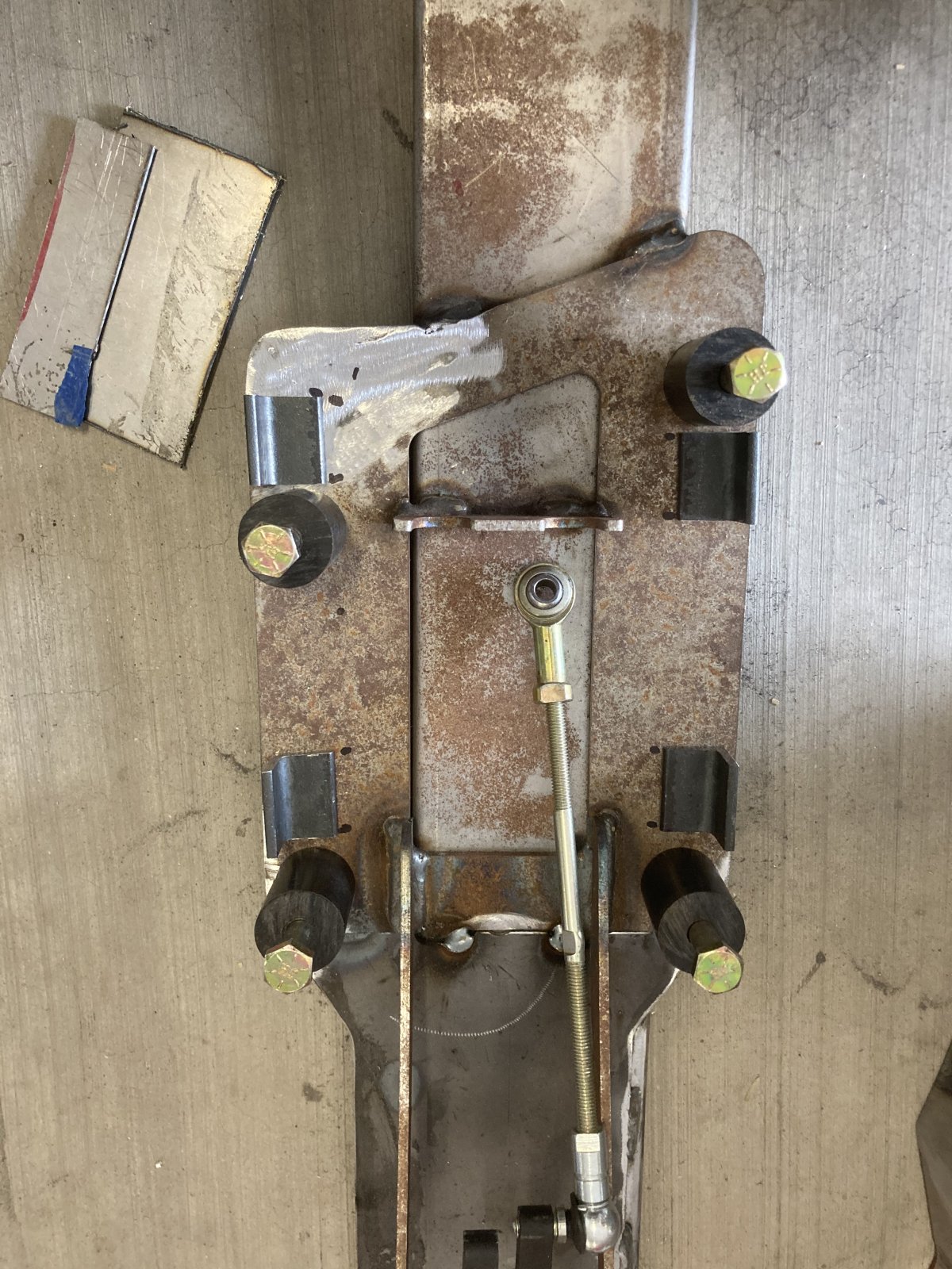

I’m not to fond of this GM clutch pedal assembly. It was almost as if it was designed as an afterthought. Clutch pedal is way too far out and positioned down too low.
I decided to modify it similarly to the gas pedal. Was a bit more challenging as it is made of plastic.

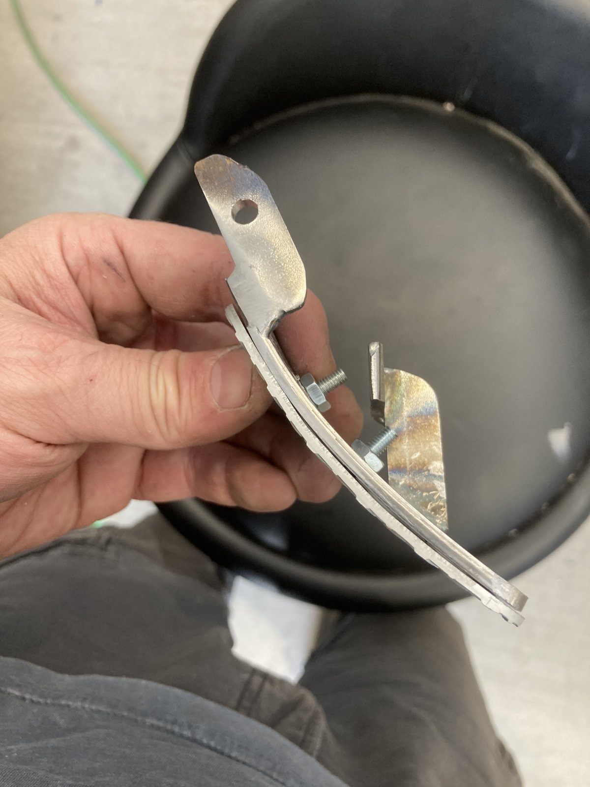

Fabricated up a bracket to mount the pedal higher up (which I also made adjustable side to side.)
I also designed up a travel limiter. This allows me to set the maximum pedal travel manually, and match the travel of the brake and gas pedals.

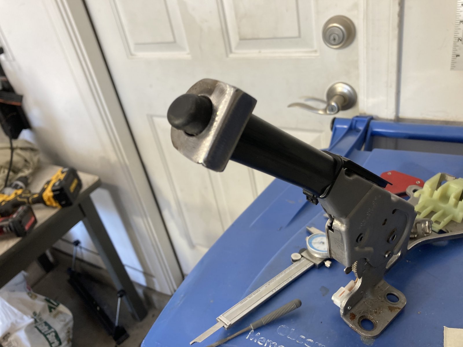

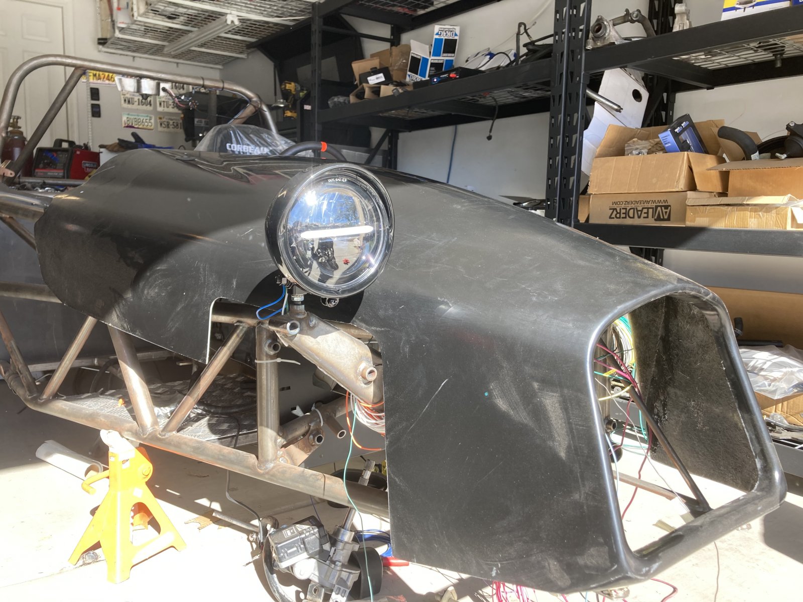

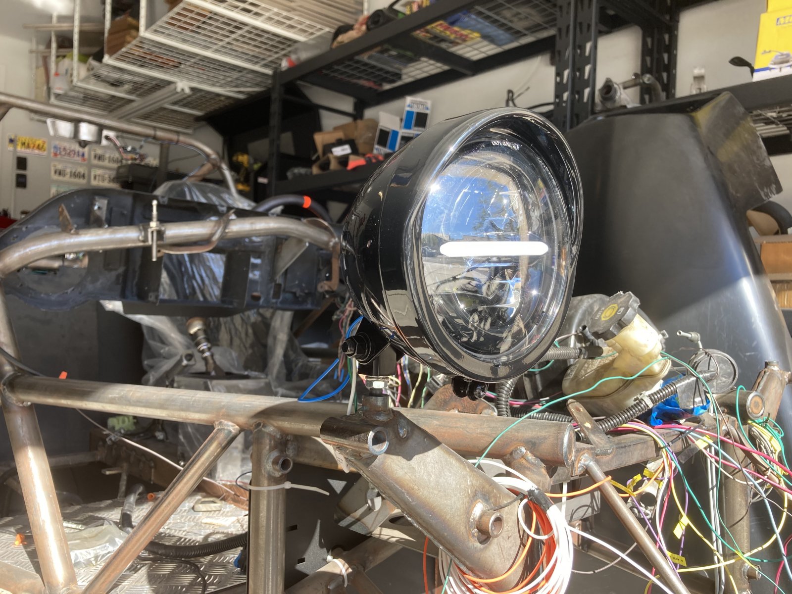

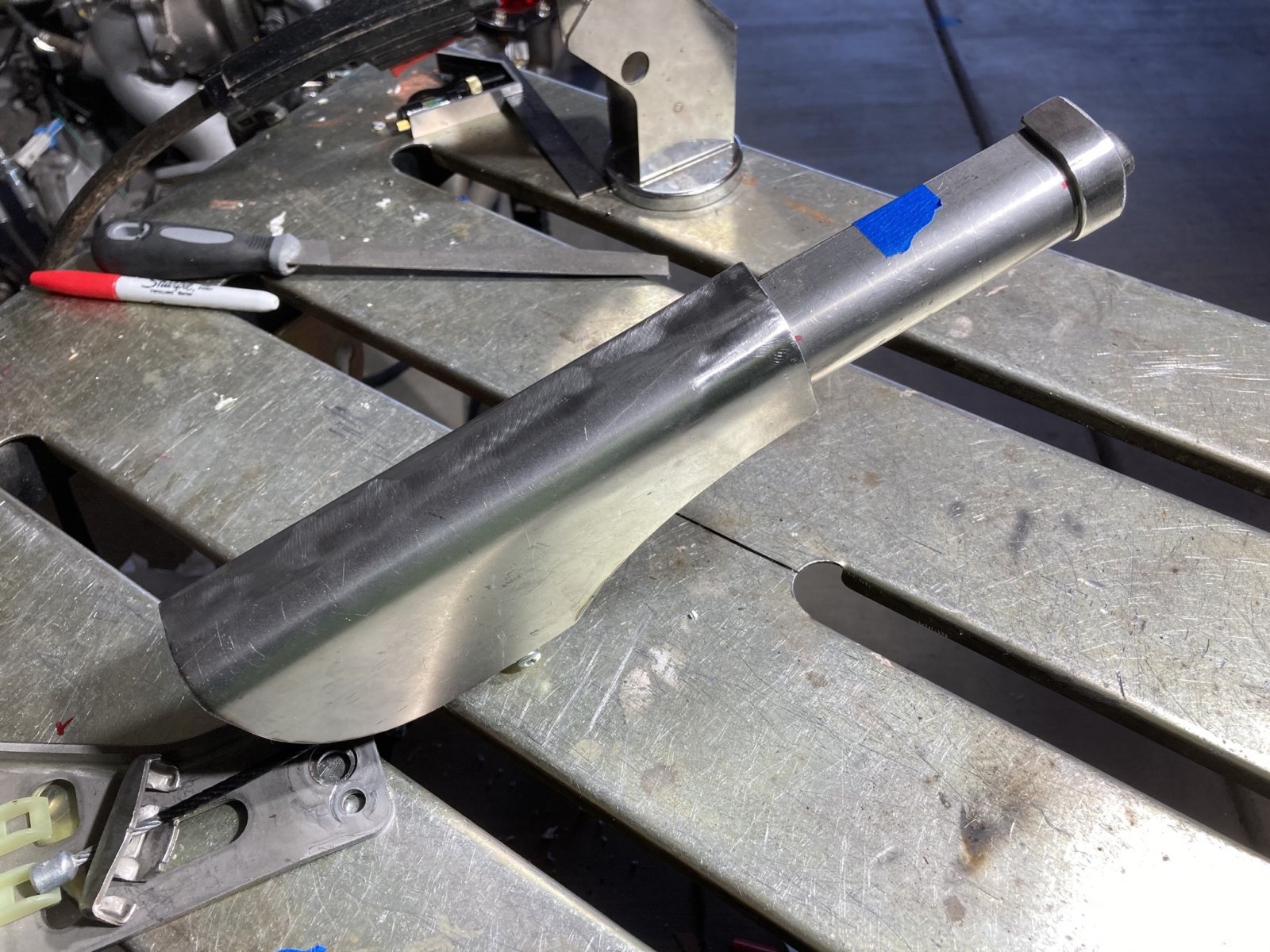

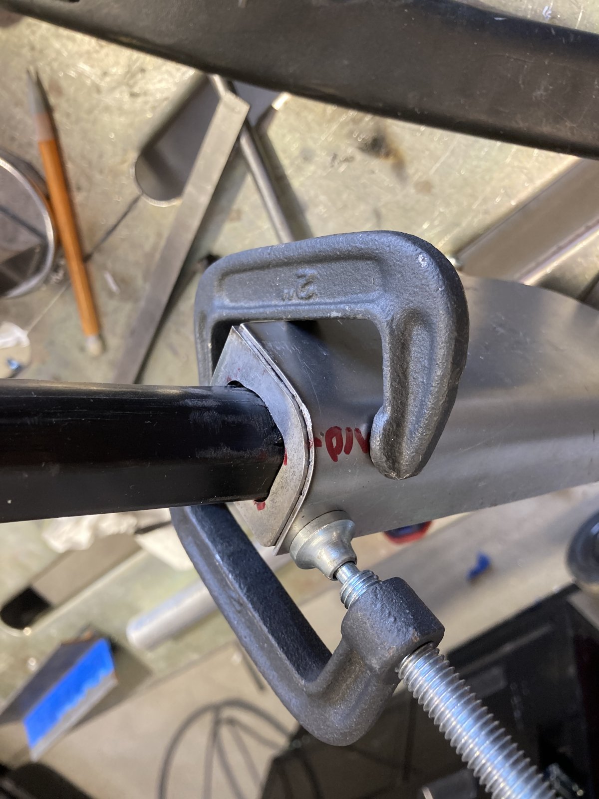

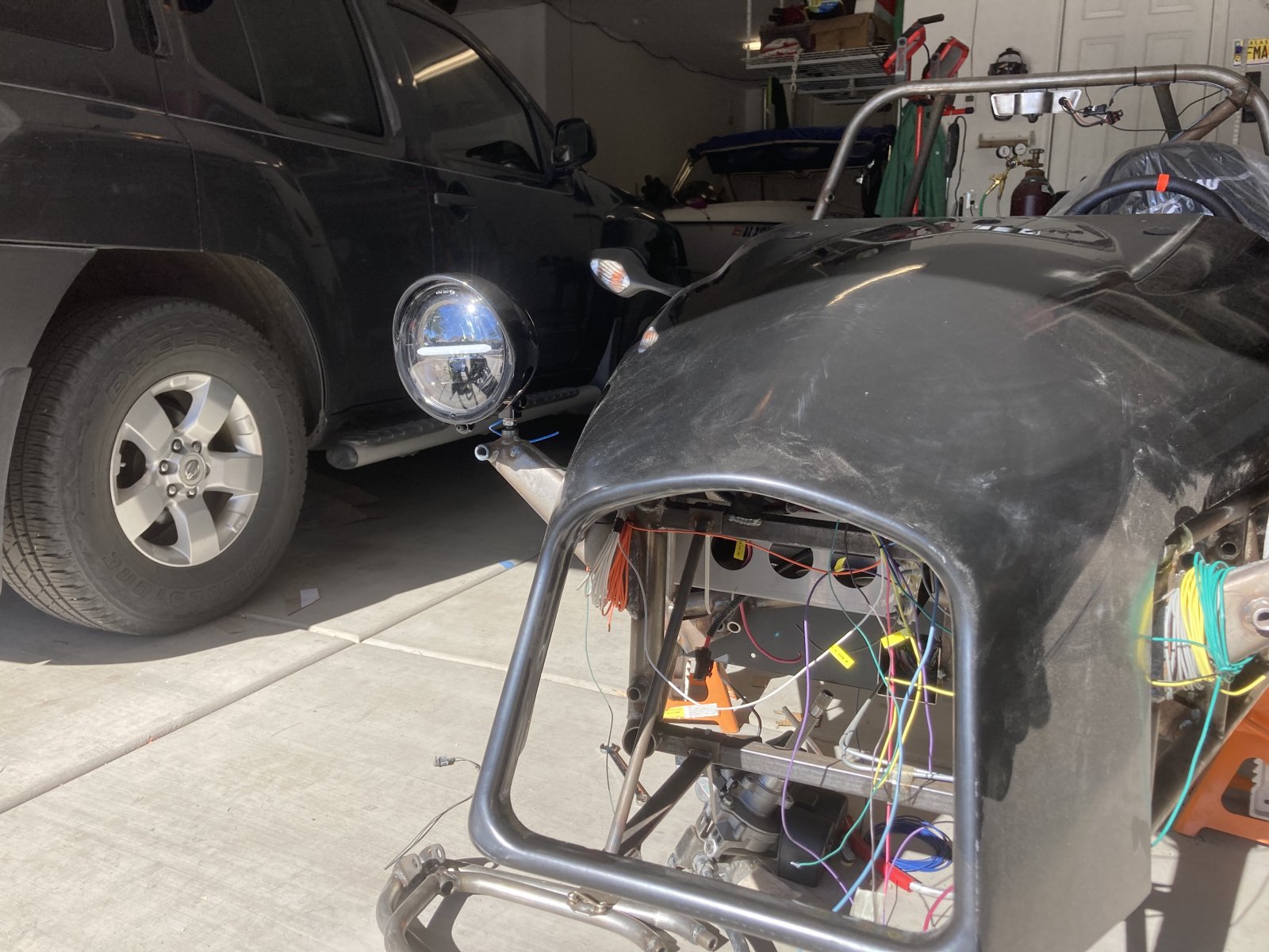

I got one of my headlight buckets in. Not sure where the other one is. Mounted one of my bulbs. Super happy with it.

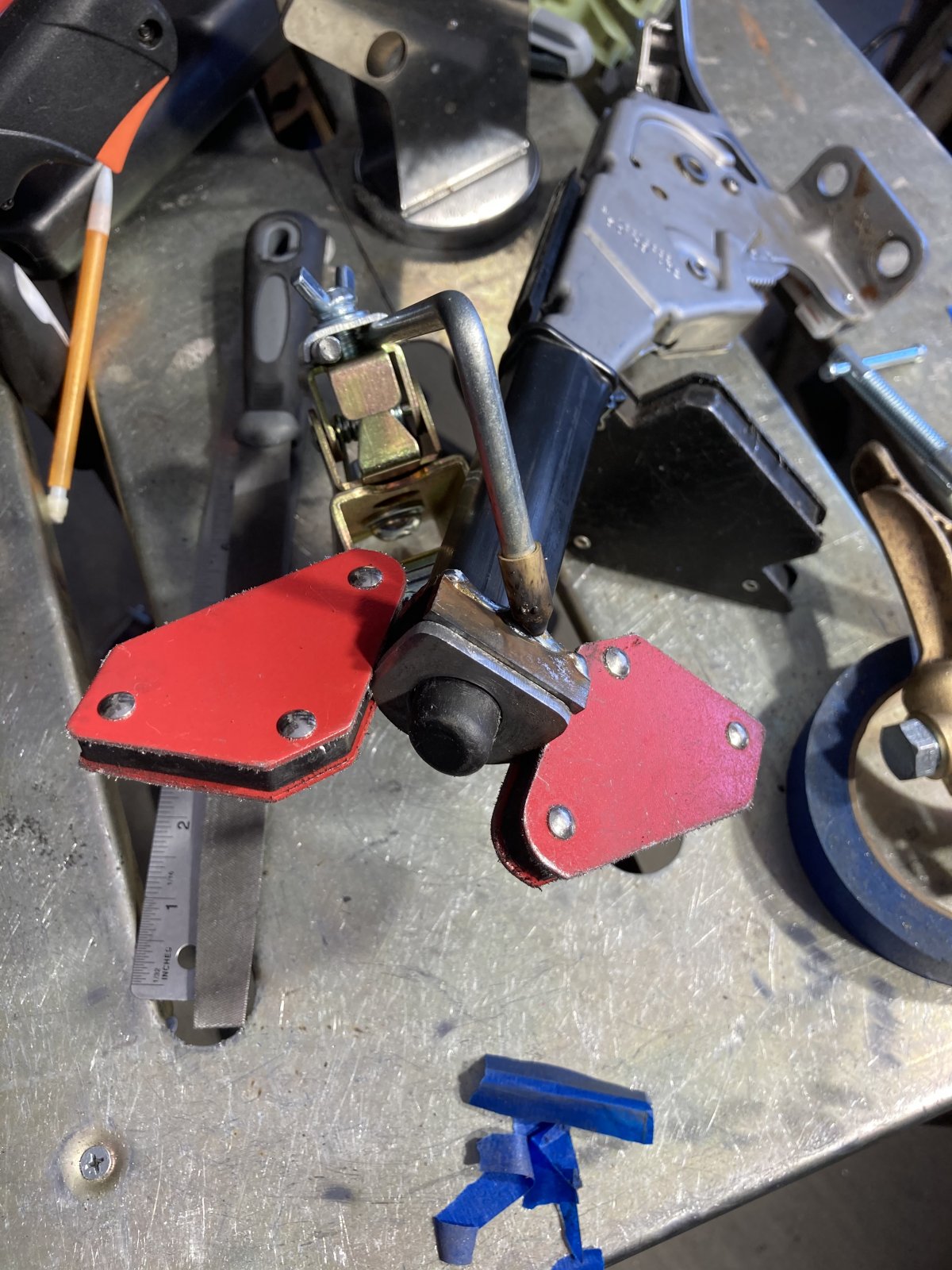

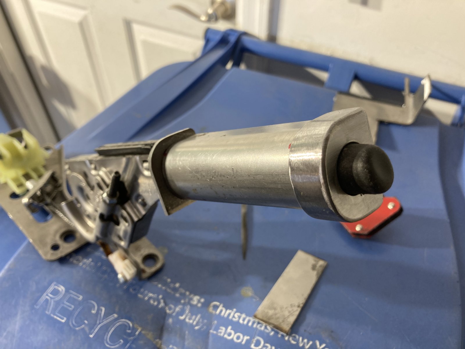

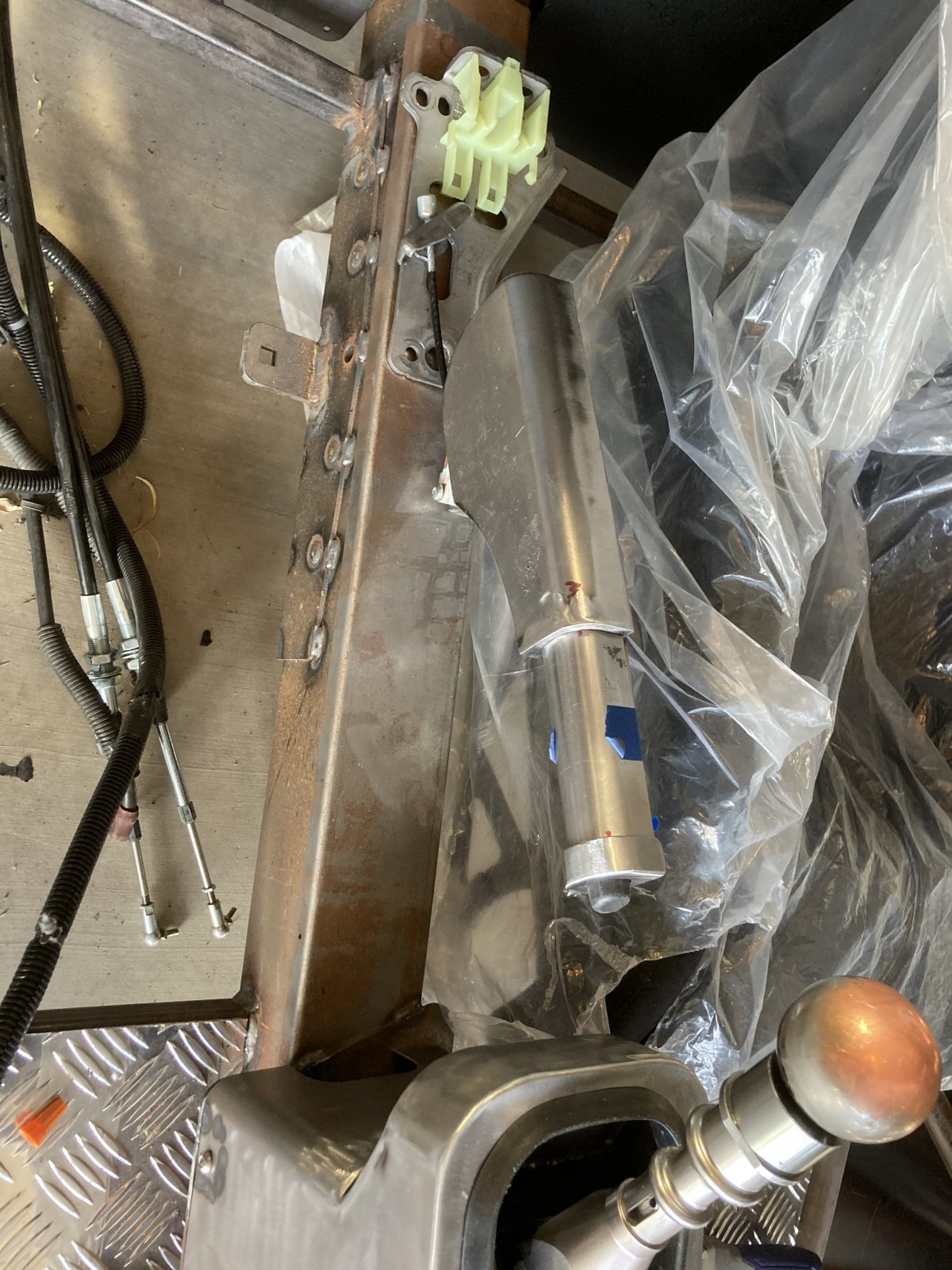

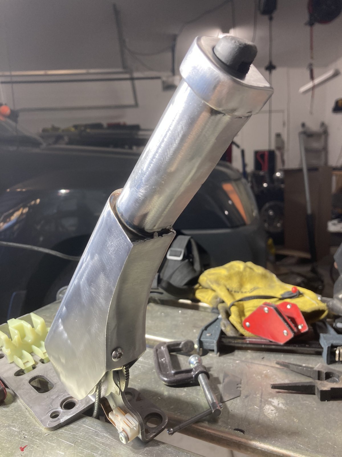

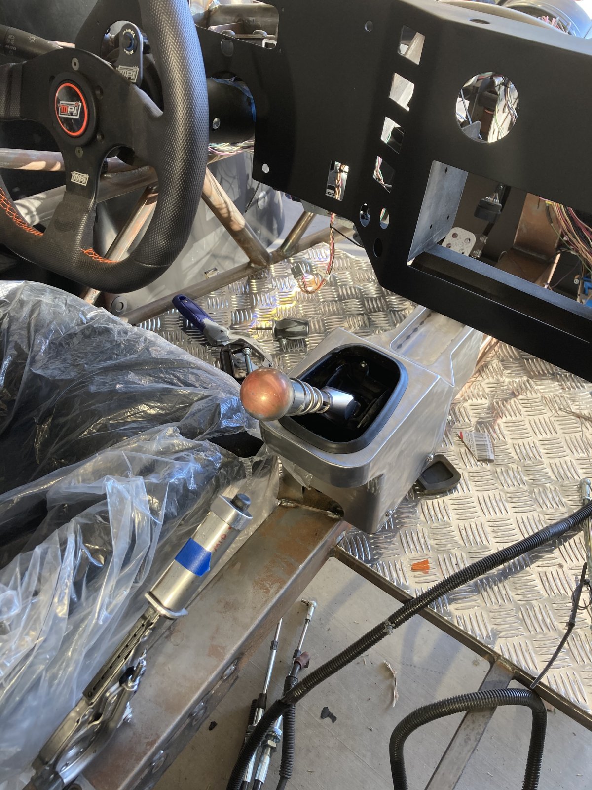

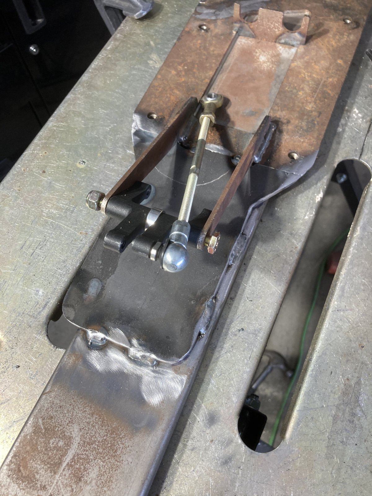

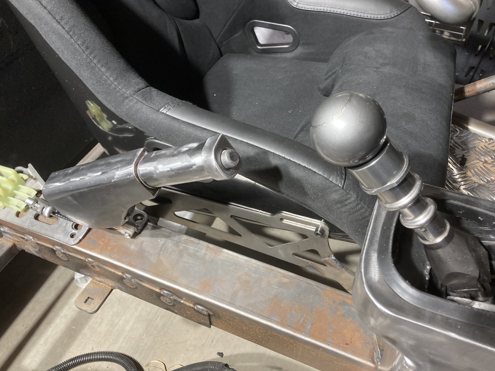

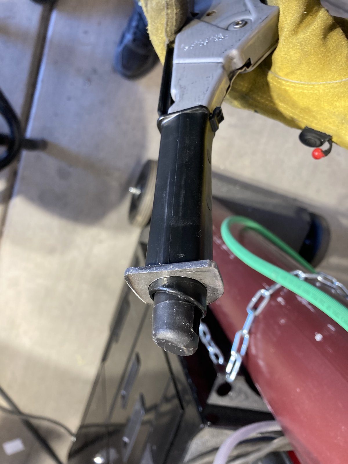

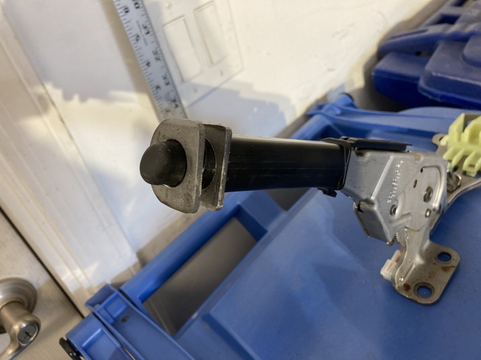

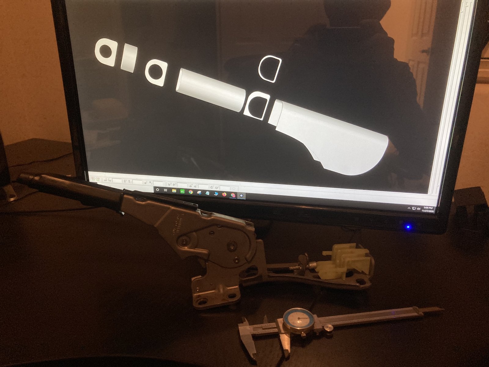

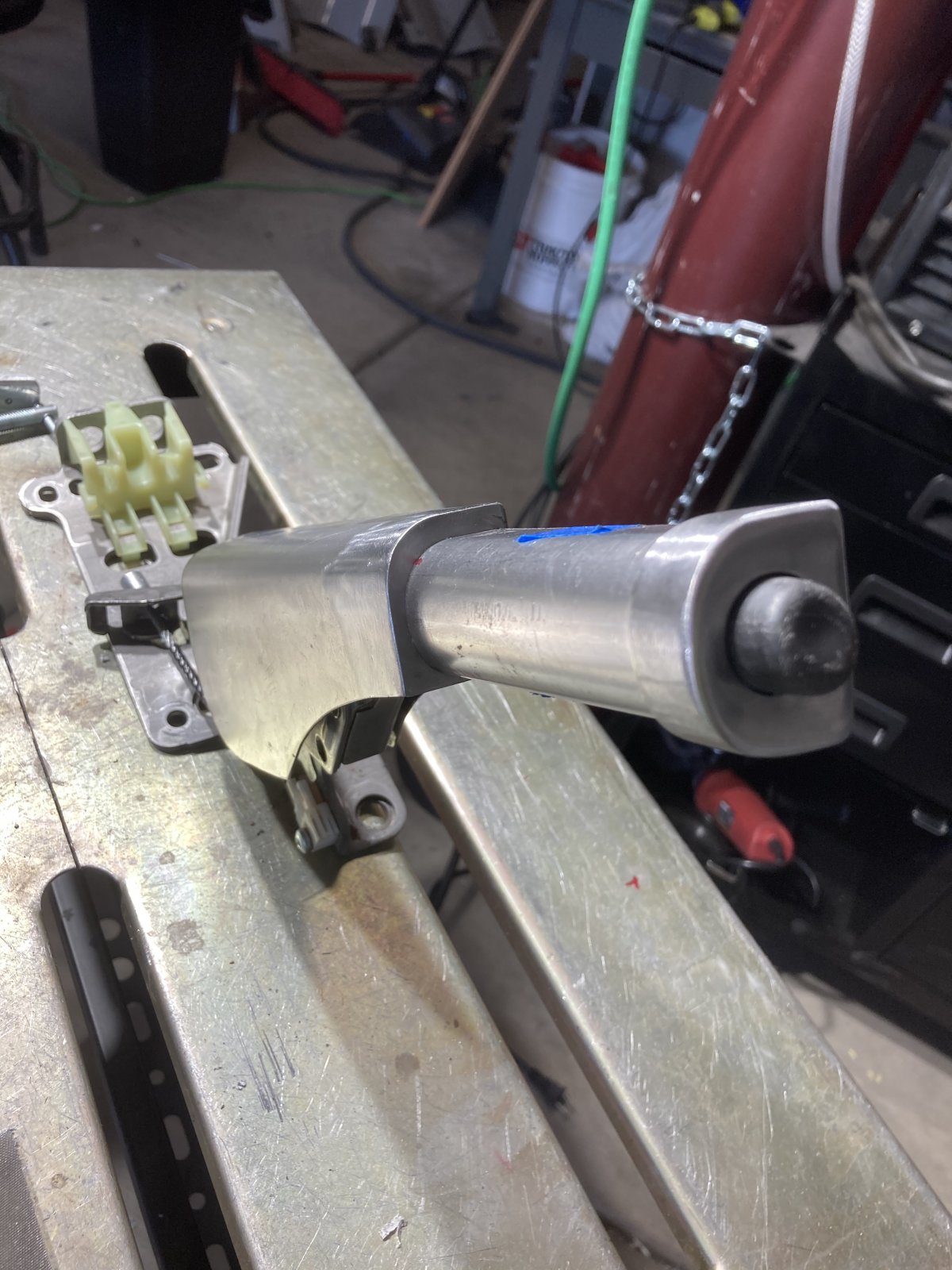

Finished up the e-brake and added a retaining bolt for the cover.
Installed my new weighted shift knob.

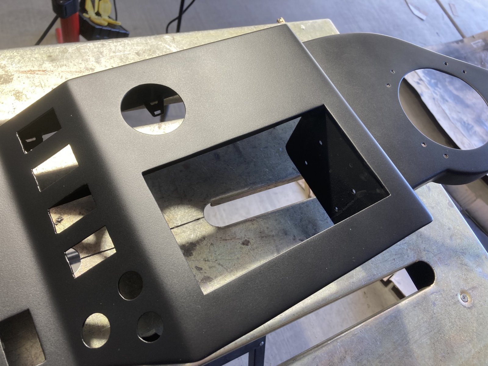

Last weekend I shot a two-part clear matte urethane on my dash. Turned out pretty good. Will give it a week or two to fully cure.

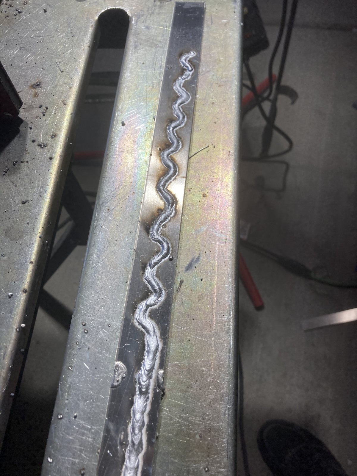

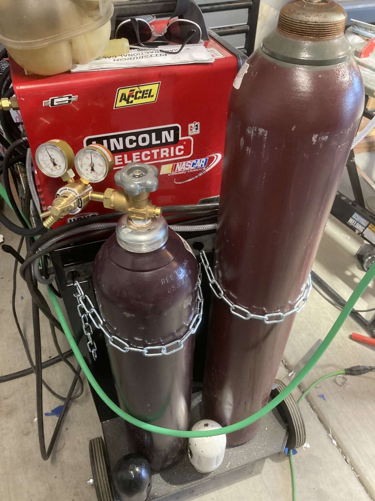

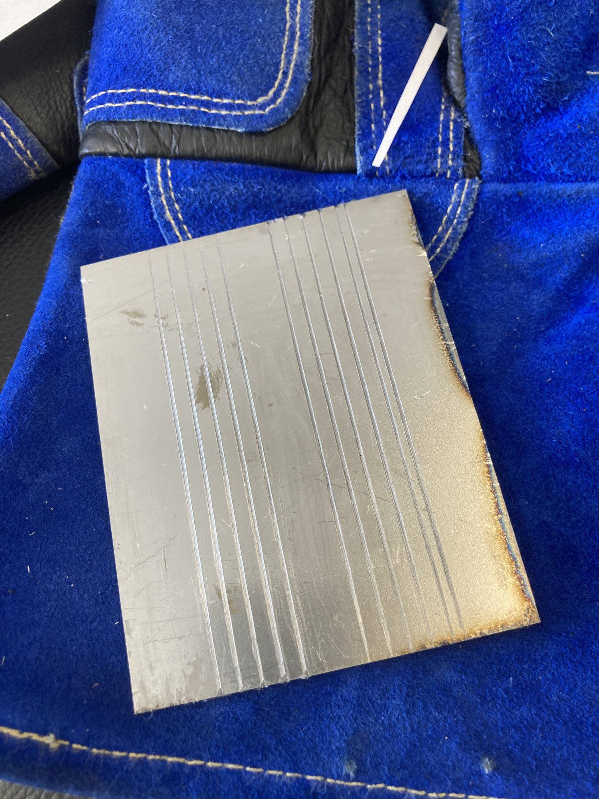

I picked up an 80cf bottle of Argon today and a bunch of .100 aluminum sheet. I was able to get my welder dialed in.

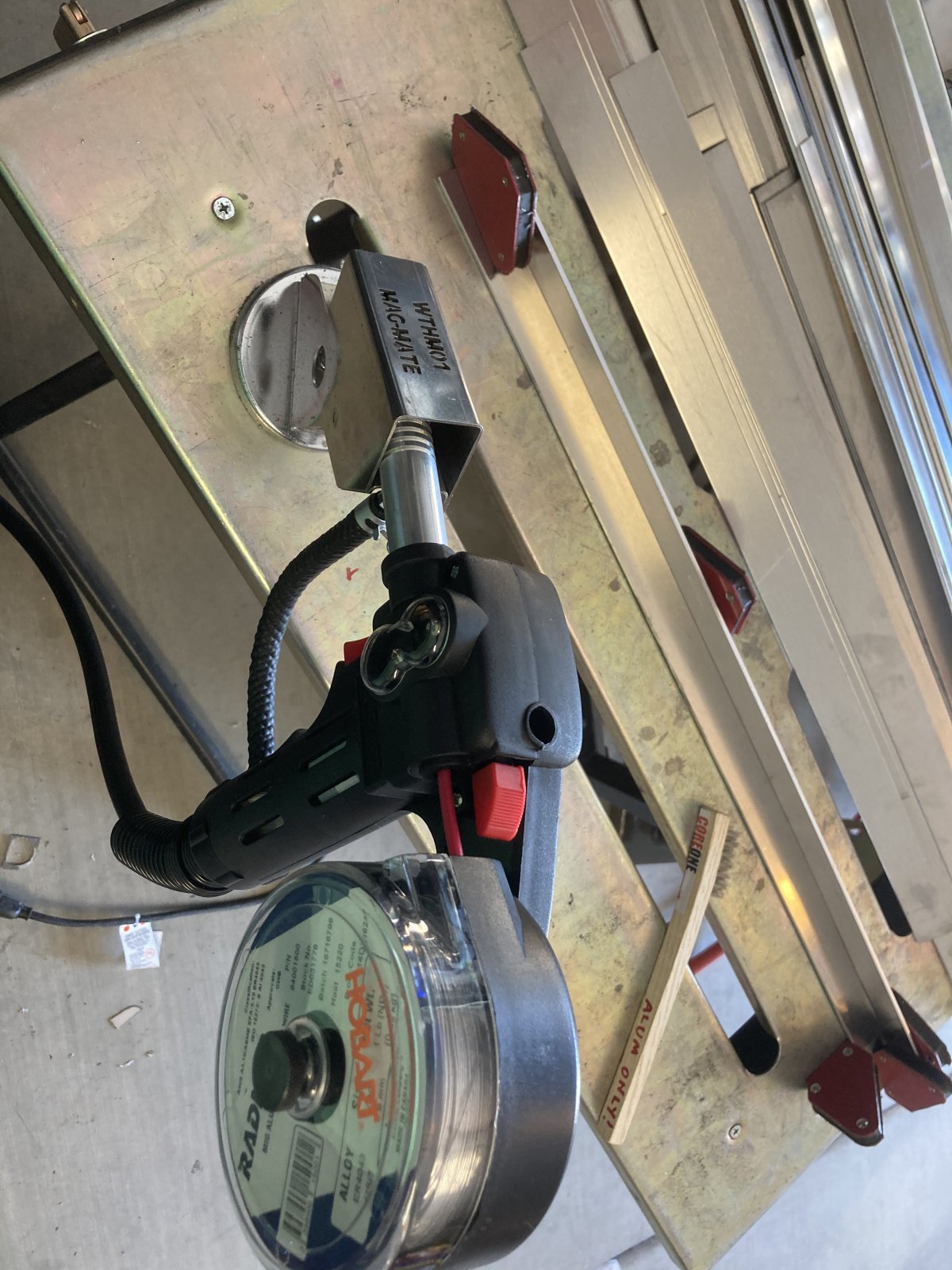

I need to invest in a spool gun... not being able to weld aluminum is killing me
Honestly, I would just buy a TIG. The spool gun is nice, but still limited to higher thicknesses and a bit of effort to get set up right. I would say a spool gun is great if you are doing lots of heavier gauge production stuff, but for thinner aluminum sheet and detailed stuff, TIG provides way more versatility once the learning curve is overcome. I think a TIG will probably be one of my next purchases.

I’ve been trying to convince my wife that I NEED to sell my other welders and buy an ESAB Rebel EMP 205ic. One machine to do it all.
That is a nice unit.
My wife gave me the go ahead last night. She said make sure I get a good quality TIG welder that will last. I was looking at the Alpha TIG 200x. I will definitely keep my two MIG welders and probably buy another cart for the TIG. Its nice being able to just fire up a machine thats already set up and go.

Yes, meant the 201. I run my little 100 Lincoln with .023 for all things 18 gauge, and the Hobart with .030 for all things bigger than 18 gauge. I have them both running off the same tank and I hardly ever have to change a setting. Makes things pretty easy.
