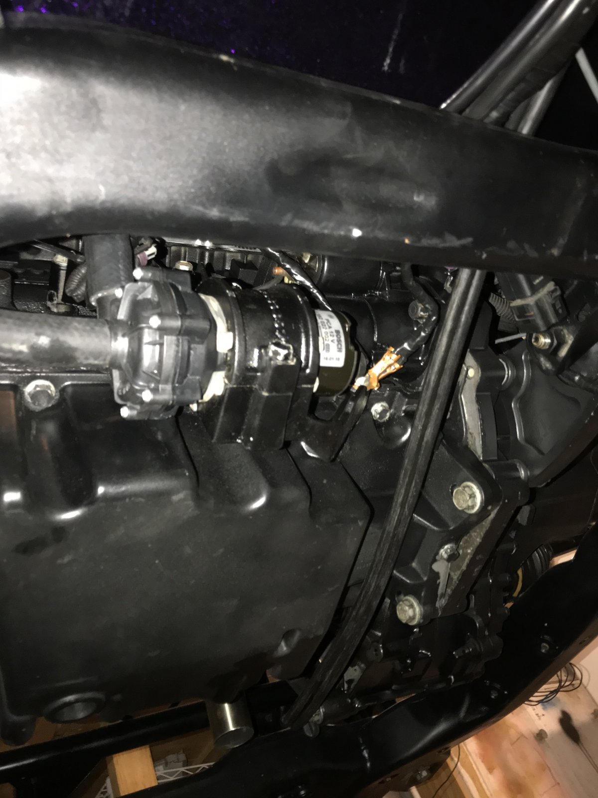

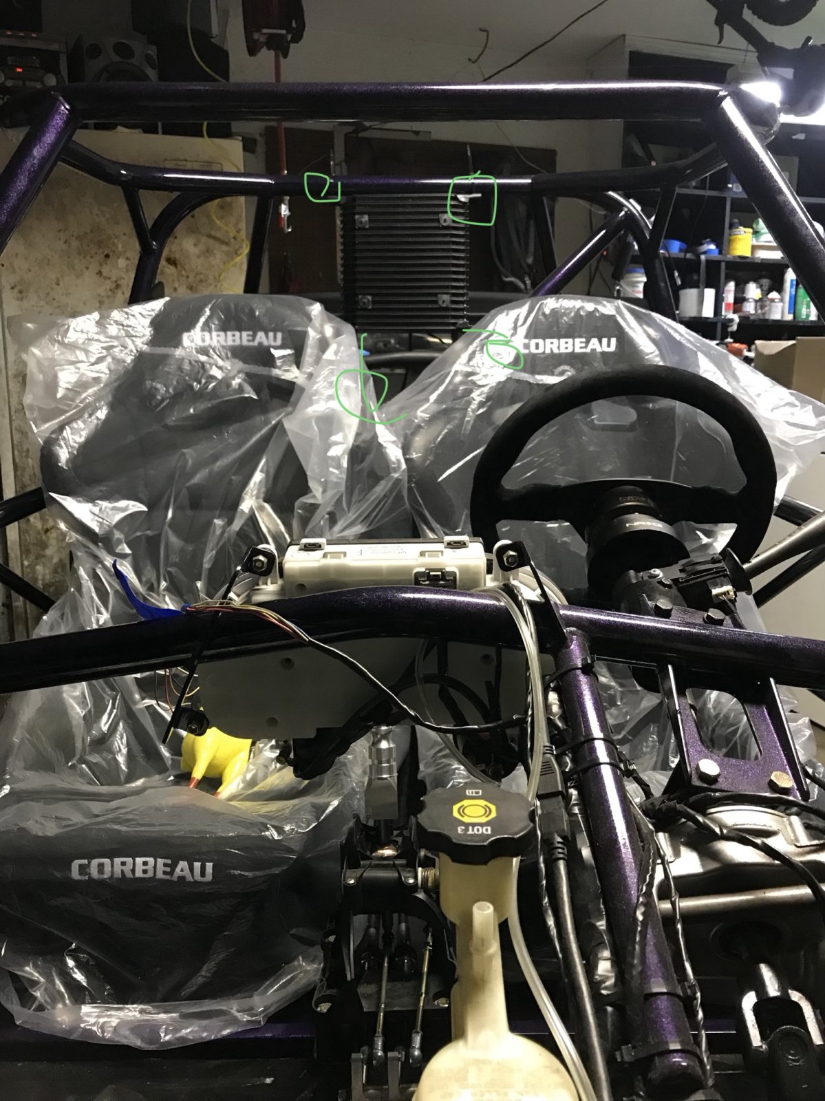

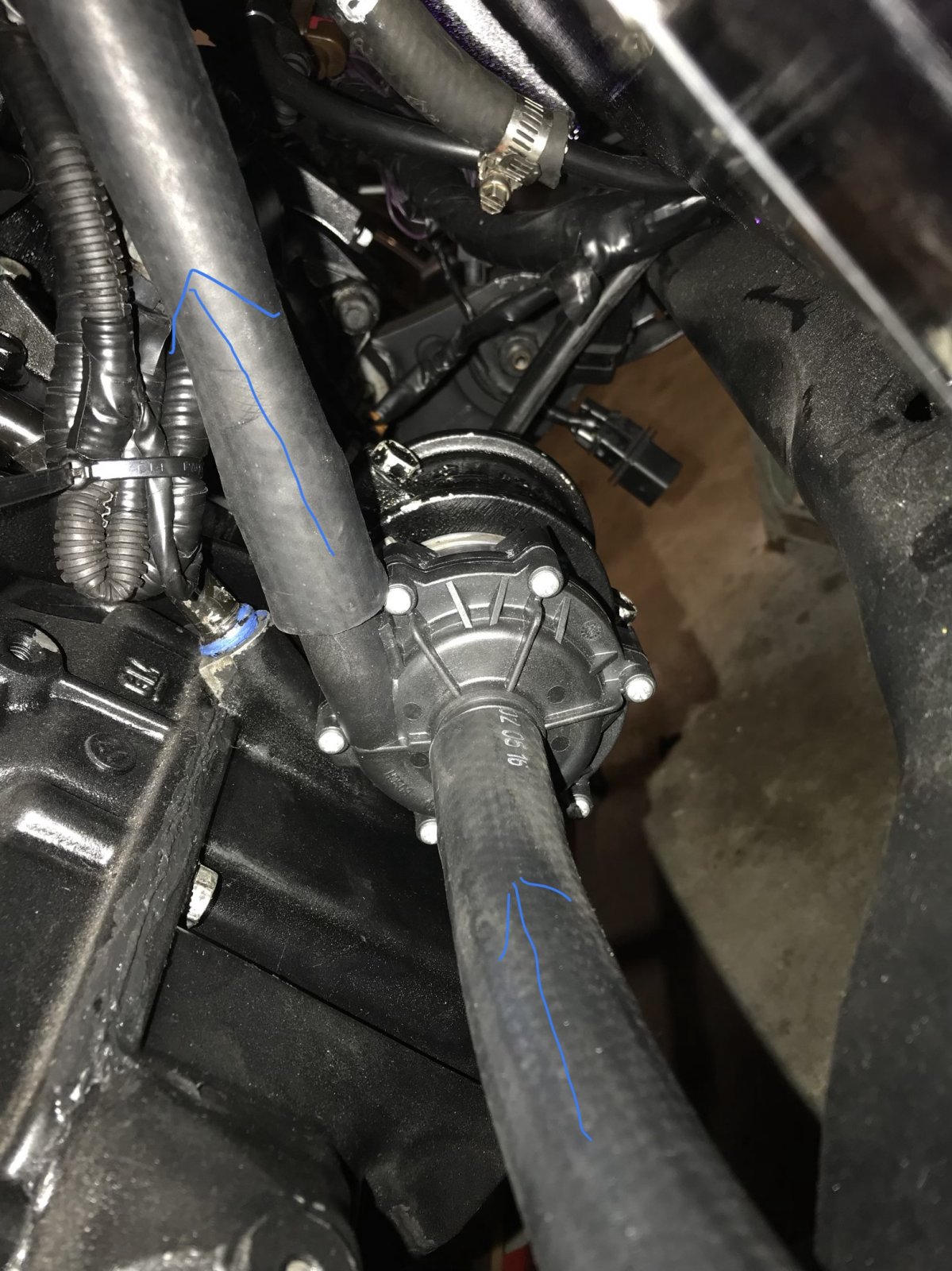

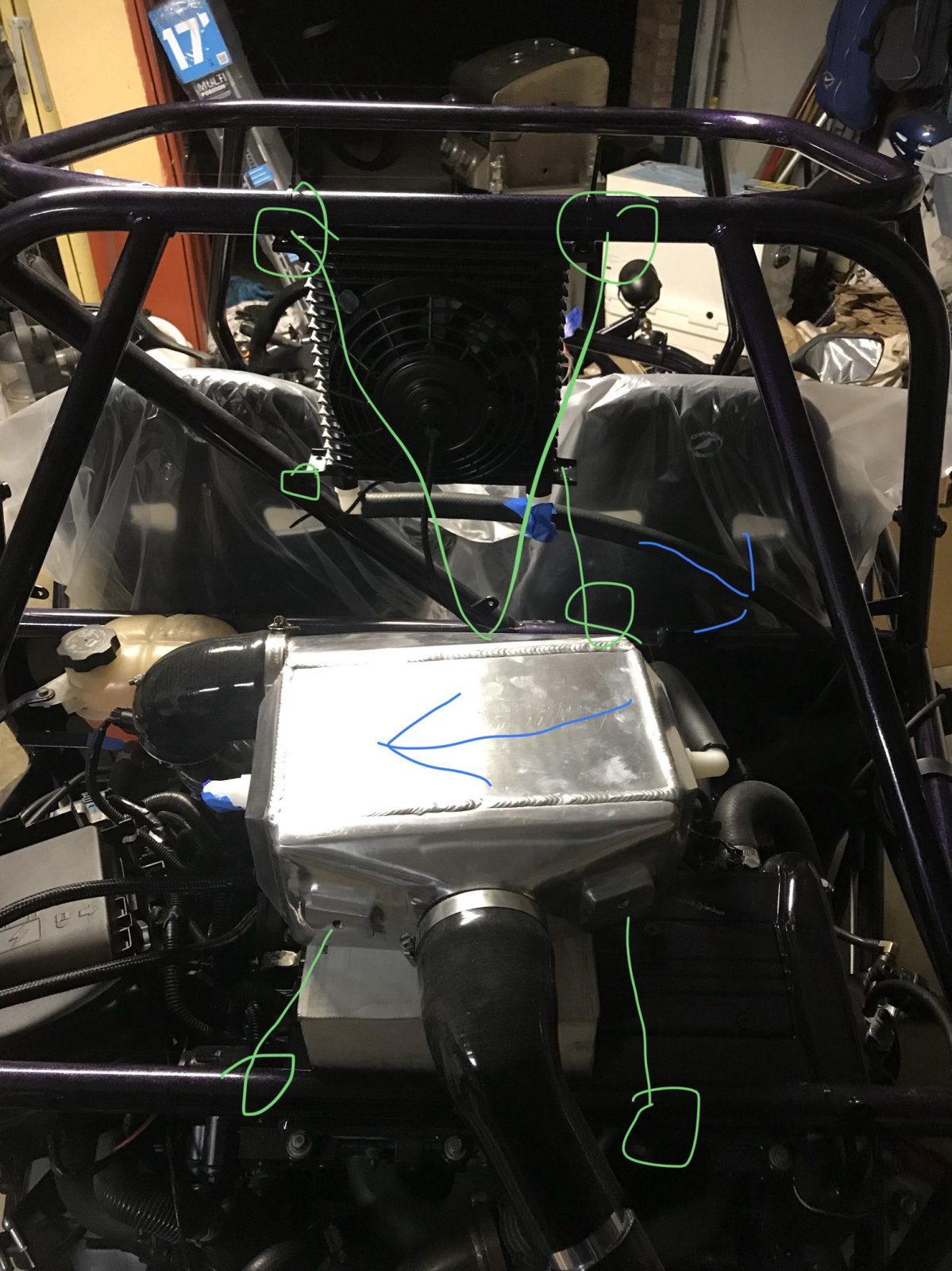

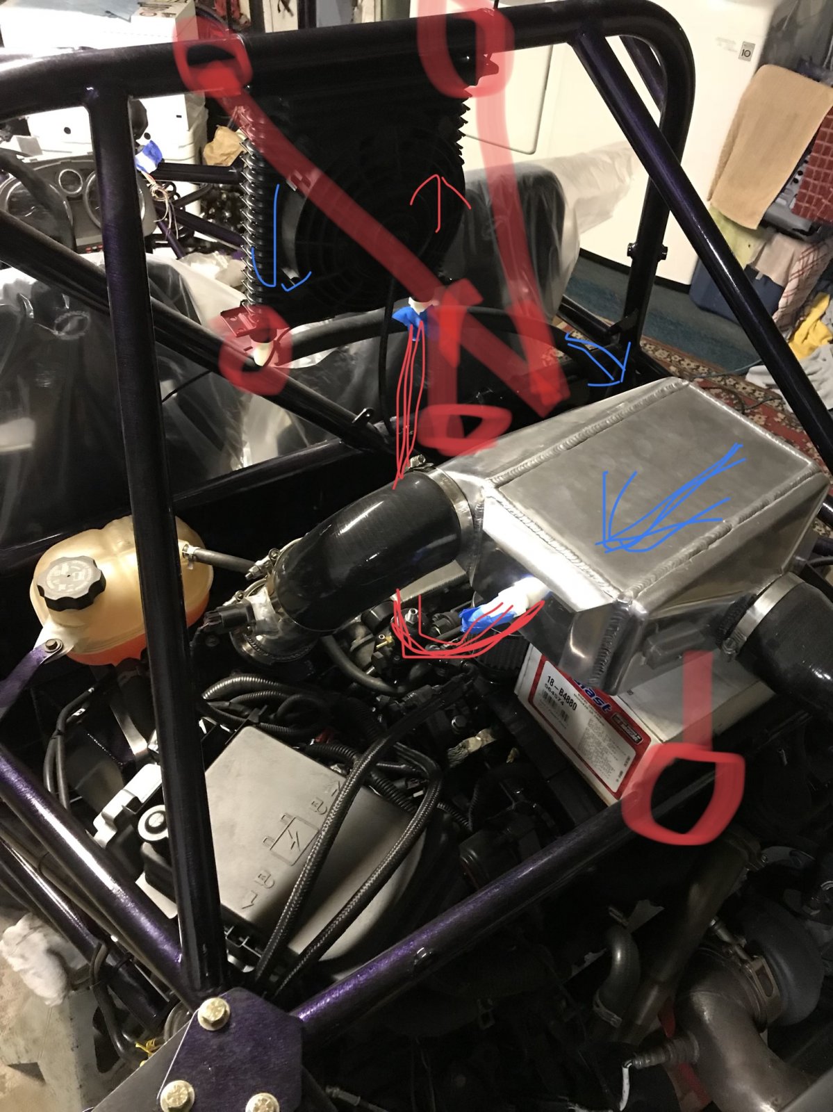

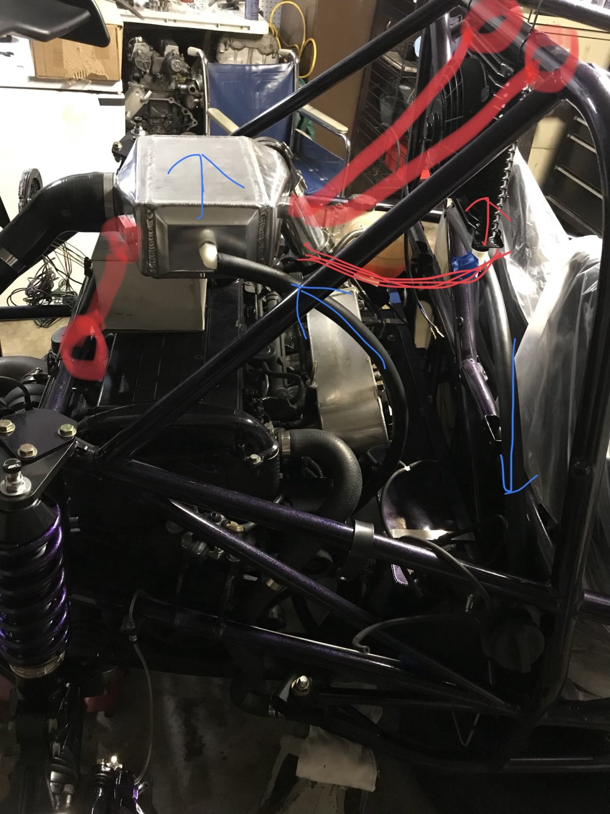

Well I’m not sure where to mount this heat exchanger. I mounted the intercooler pump in the stock bracket I got from a friend so I guess from there I’ll just put it right in the middle mounted from the top roll bar
If anyone has any ideas let me know

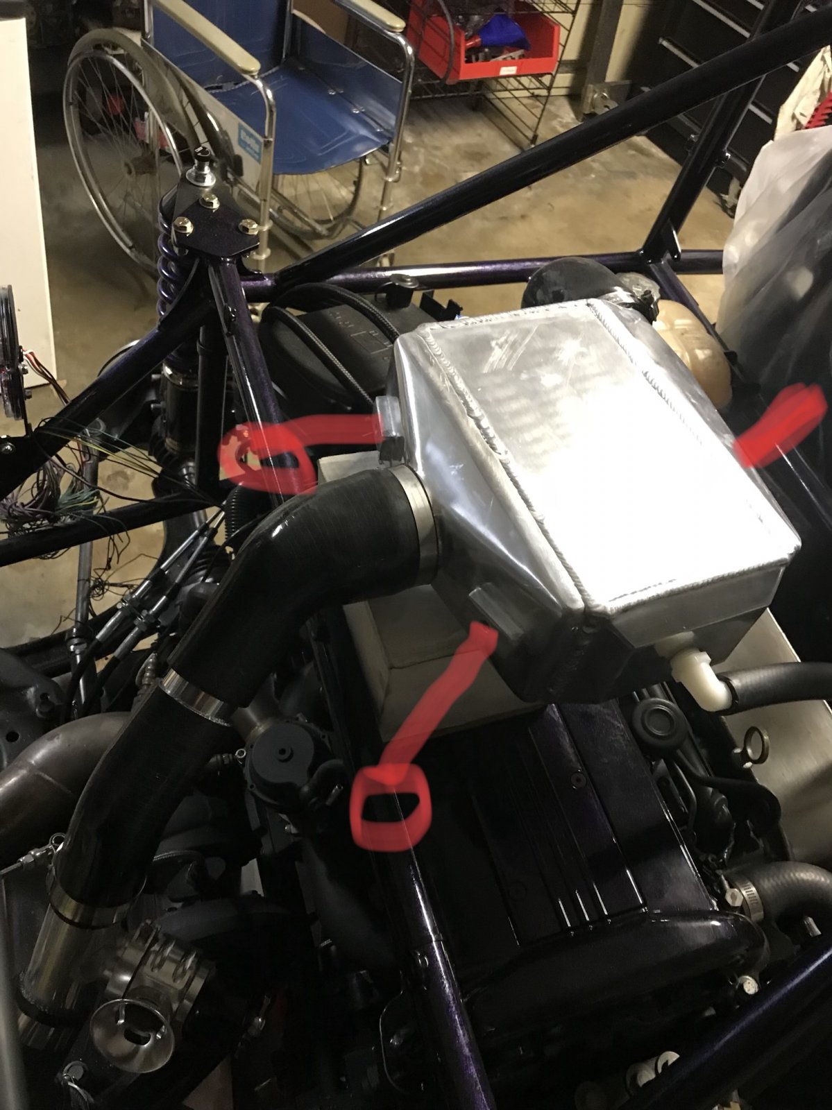

I need to make some brackets for the intercooler and for the heat exchanger I drew on the pictures so you guys can see where I think I will mount them. I will get something like a coated clamp to go around the frame then bolt on some flat iron or somthing.

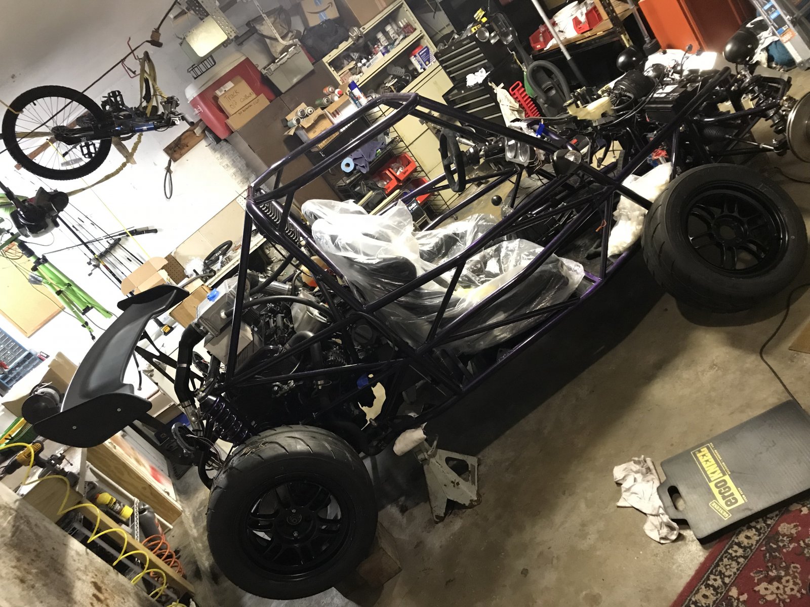

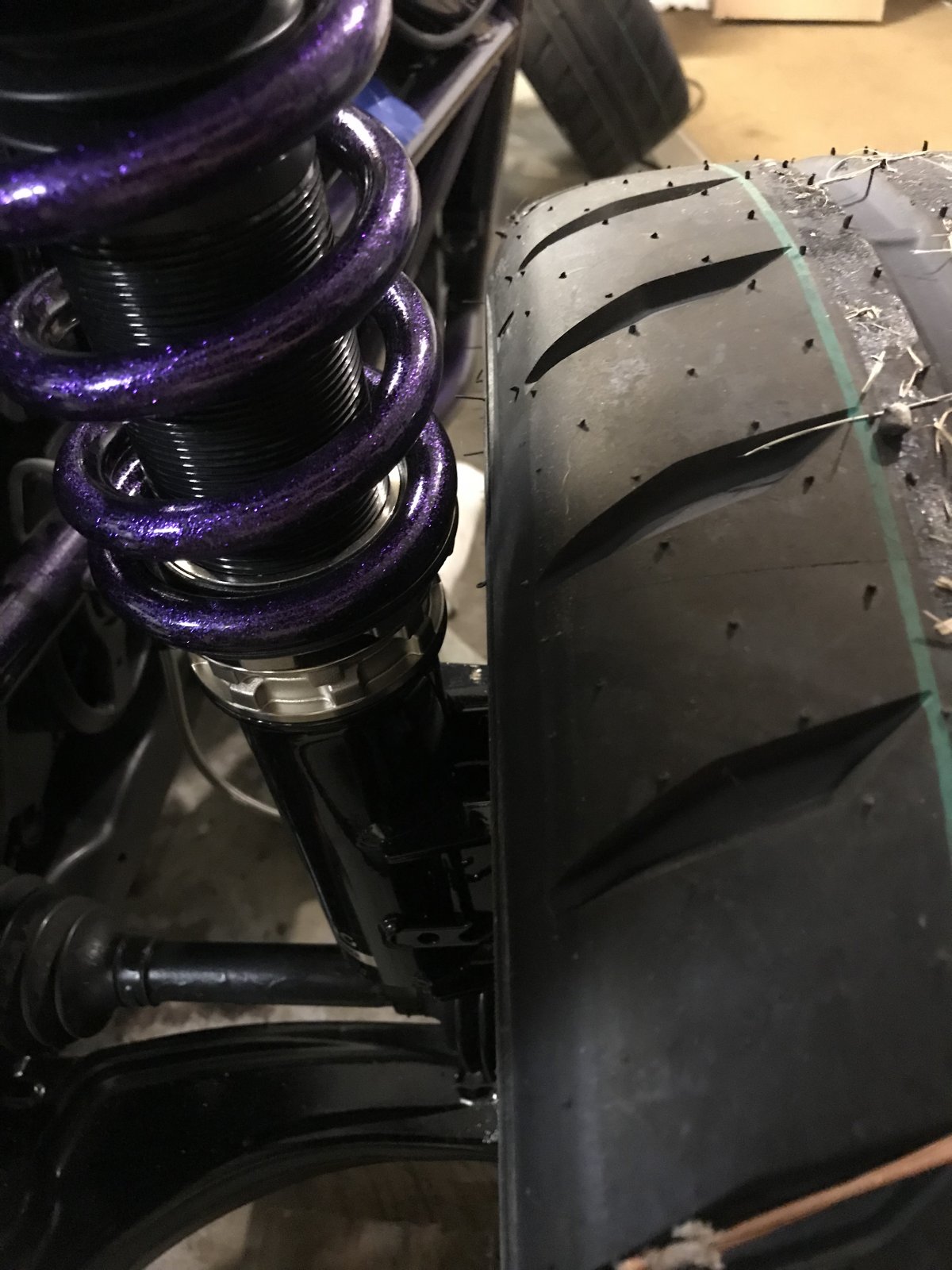

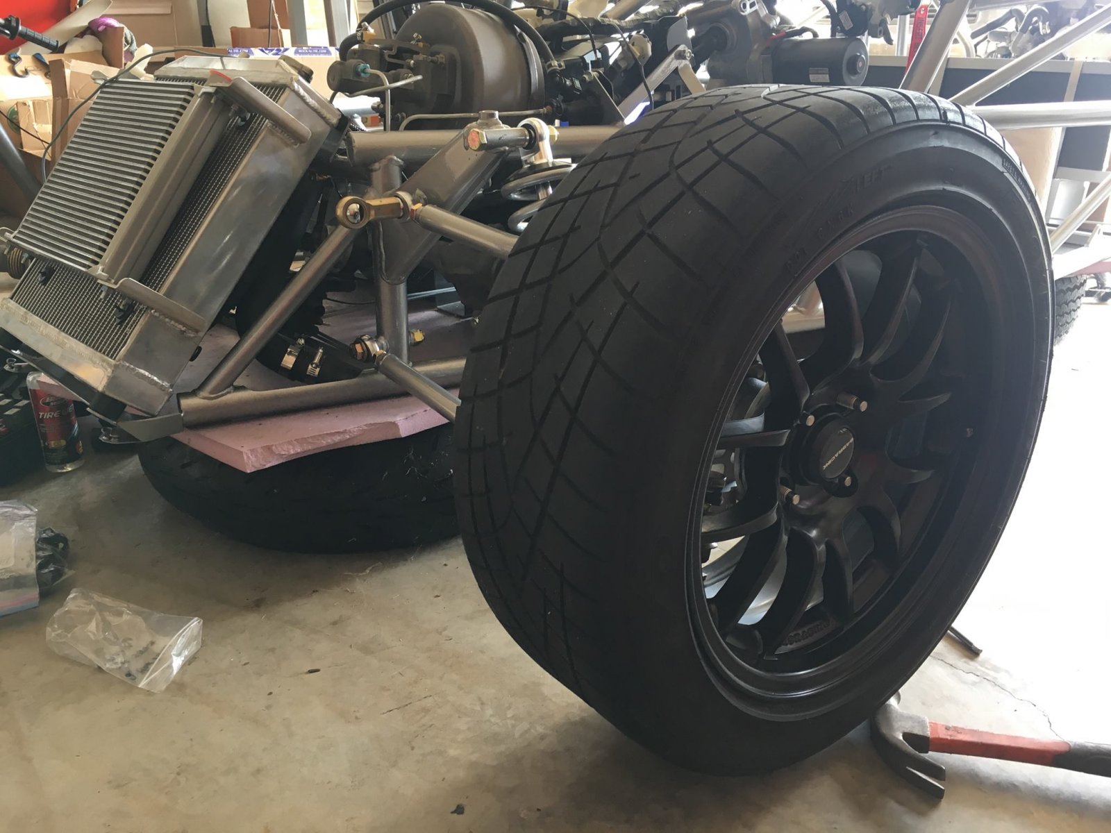

Test fit rear wheels to see how close the alignment is and how close they are to the coilover

Agree with Rich you should have 3 cross braces on the rear spoiler wing. (Has anyone had any issues with cracking of the wing or supports?)...
As for the mounting for the heat exchanger cooler...

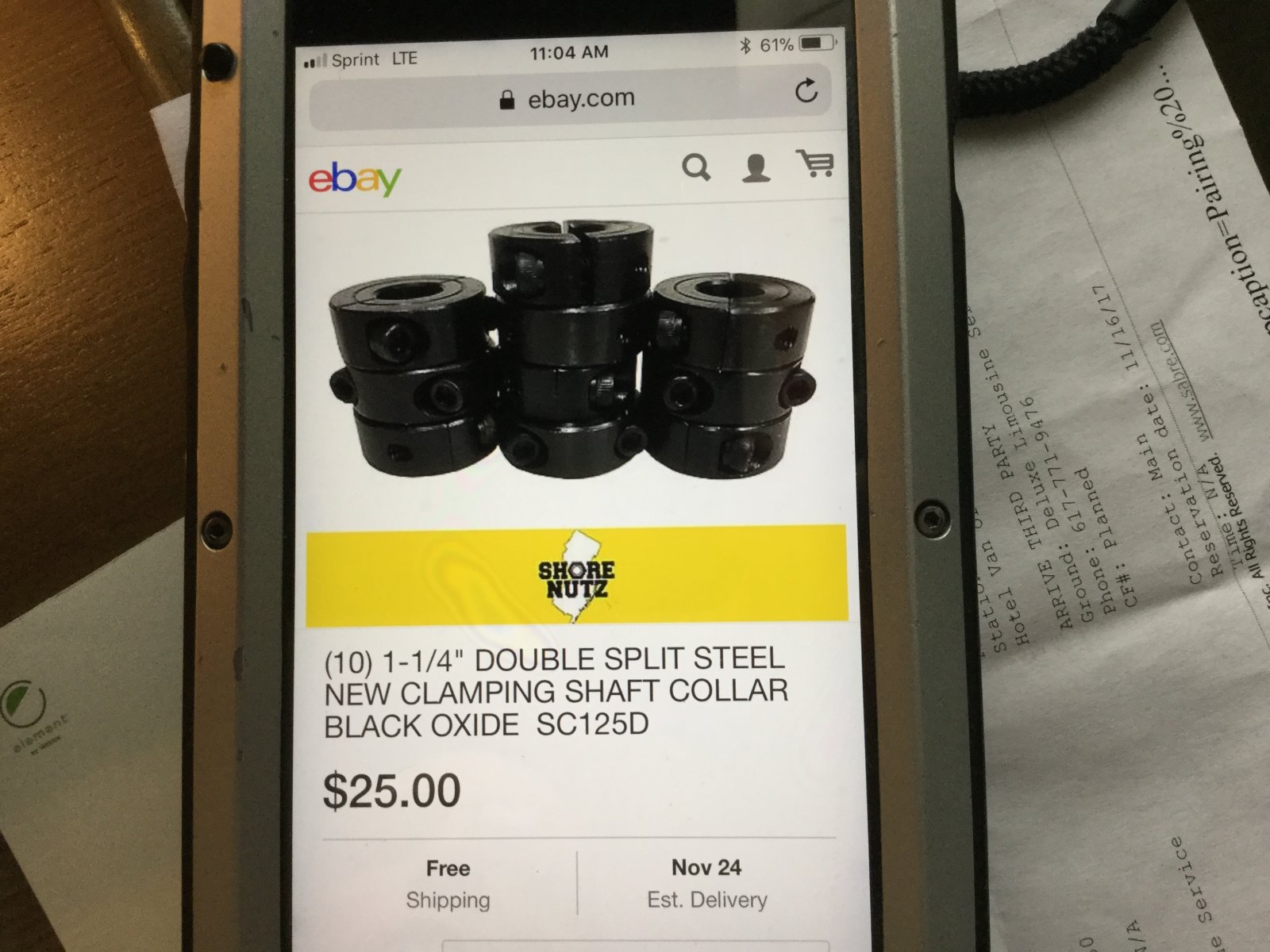

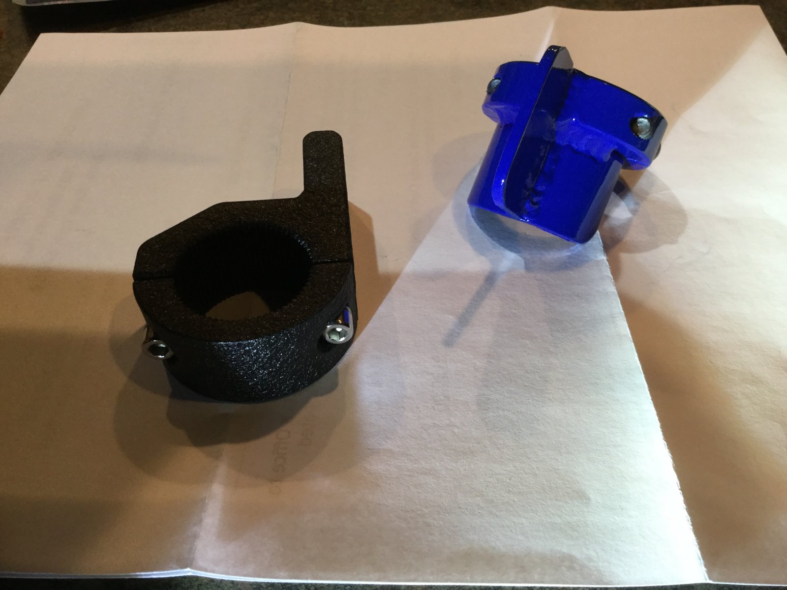

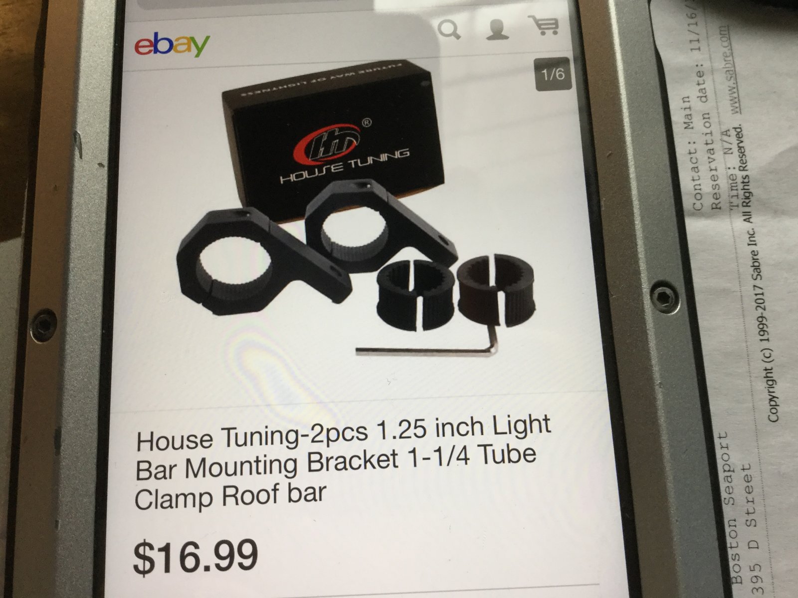

here are the only split clamps that I found (reasonably priced) to fit on 1 1/4" tube.

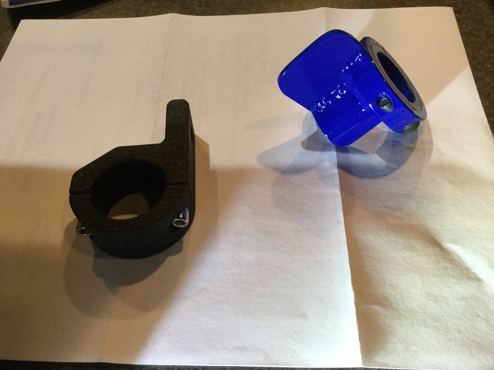

I like these a lot relatively small but you have to weld up a mounting tab to them. (So a removable tab you can use on powder coated frames).
These are the ones that I am using on my intercooler (they are aluminum kind of big and bulky but actually look pretty good with my cooler -which is also large).
So I think that you could make up a simple frame between the front and rear tubes (that is actually removable) keeping it relatively close to the engine.
Speaking about removable are you going to use the rear engine cover? Just trying to see if anyone has looked at making an alternative cover while I like the look of the original, kind of a pain to take on and off even to just check the oil.
View attachment 2250 I like these a lot relatively small but you have to weld up a mounting tab to them. (So a removable tab you can use on powder coated frames).

No I will not be running the engine cover. But those clamps look awesome and definitely somthing that I will use thanks man
