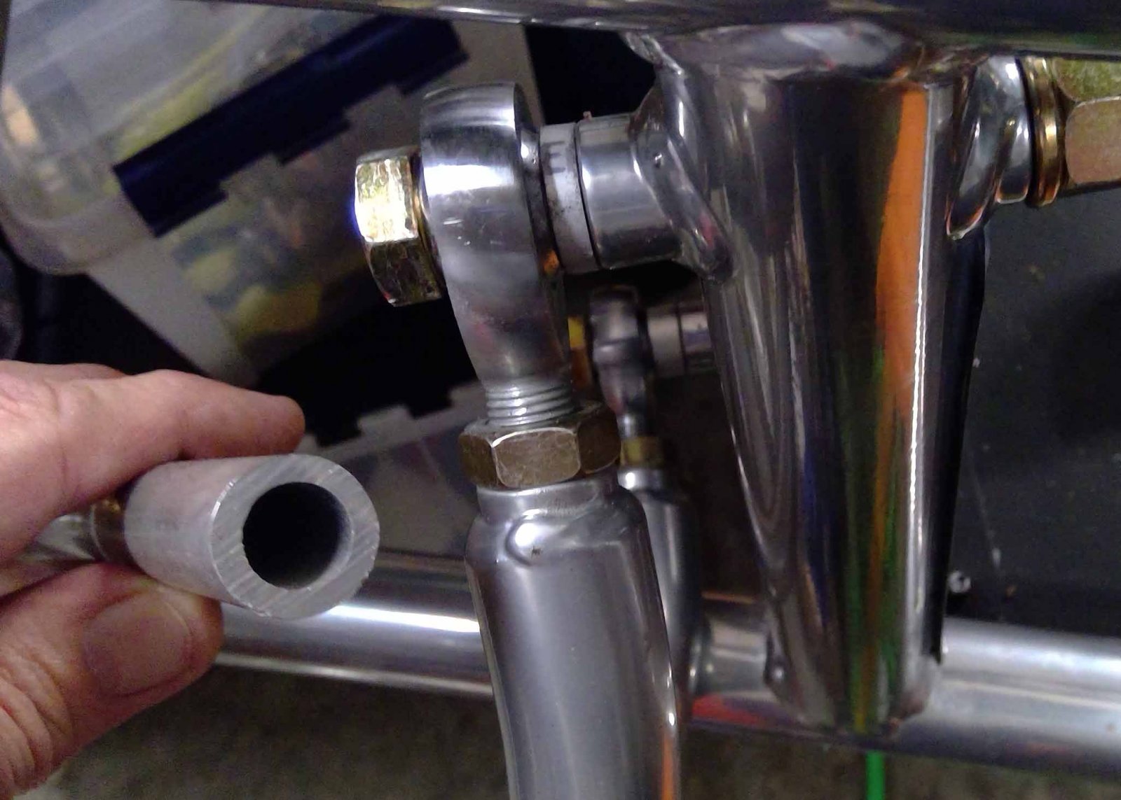

To avoid putting extra side load on the bearings, I ordered a short length of .750 OD x .125 wall round 6061/T6 tube on eBay and cut spacers to fit gaps. That was probably just an overabundance of caution.
I like that idea. I think I'm going to make spacers as well. To me, that much preloaded tension could be an issue down the road. (No pun intended)
It's unneeded stress on the welds and rod ends. Plus, pulling it apart could cause the control arm to twist, out at the kingpin rod end, changing the intended geometry. Could possibly make it a constant variable geometry change when hitting road bumps, cornering loads, etc., twisting one direction then the other.

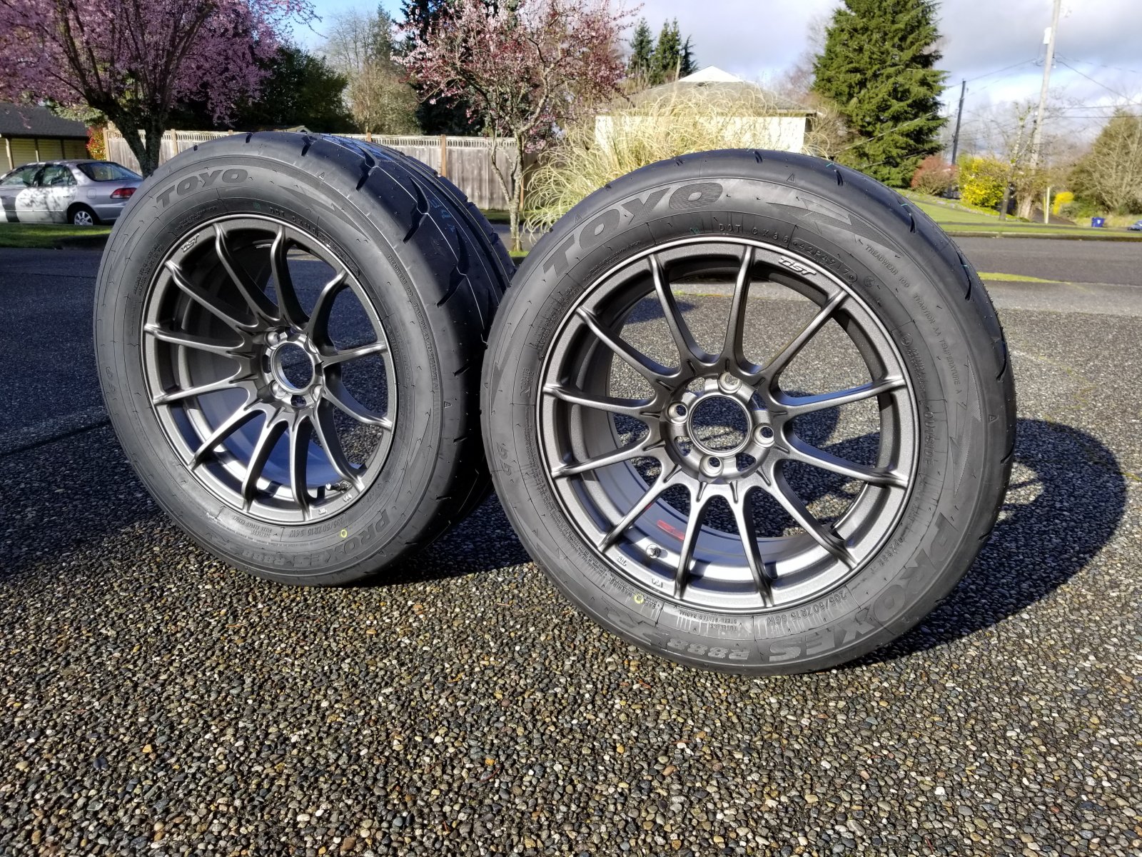

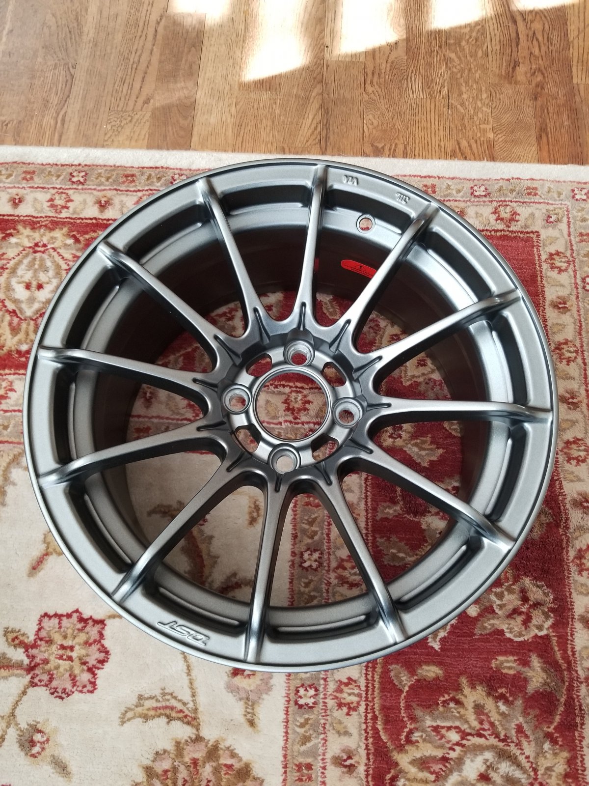

Wheels just came today!

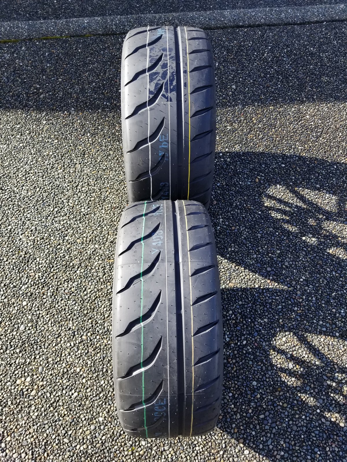

Tires are in too, getting mounted Saturday.

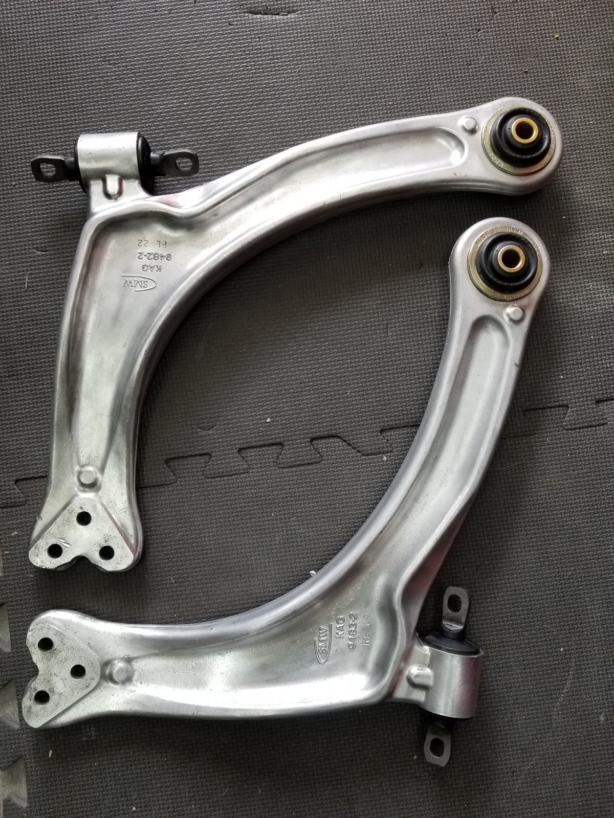

I would be more worried about changing the tested geometry of the frame than the tiny bit of tension created when tightening down the arms. About everyone’s A arms have required stretching a little, I think when they weld them it causes them to pull in.
Did you already get an alignment done or did ya do it yourself?
I'm not on the ground yet, so no alignment. I'm pretty sure any change in the geometry will be minimal since the spacers maintain the same mounting axis. I had considered cold-setting the arms. Depending on which control arm moved, spreading the arms would have a similarly minor impact that would be corrected during an alignment.

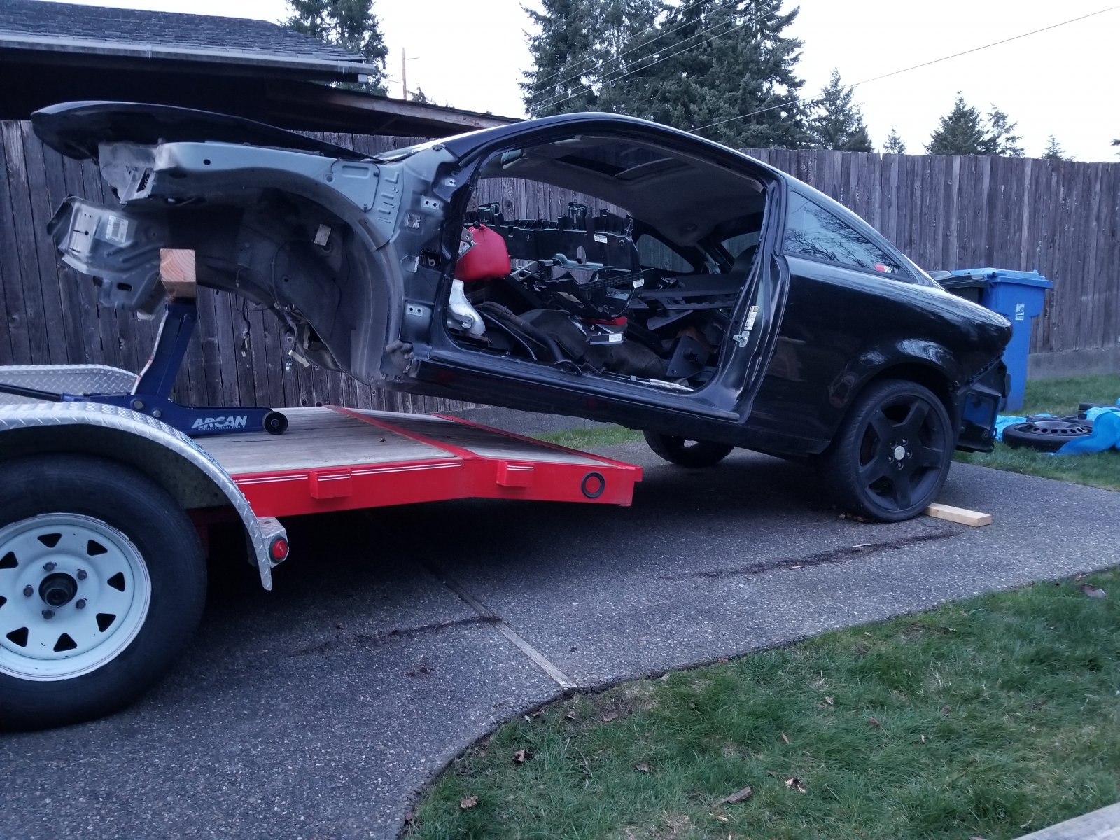

Well I just got done with the sketchiest thing I've evet done, besides going to that Regge concert back in the early 90's.
But it's on and done. I would've taken more photos but OSHA would've flipped!:D
BaltimoreHokie
I was close to trying the same thing. I decided to just have a company come take it for free. I didn't want to mess up my trailer, rent a new one or spend additional time taking the shell to the scrap yard.

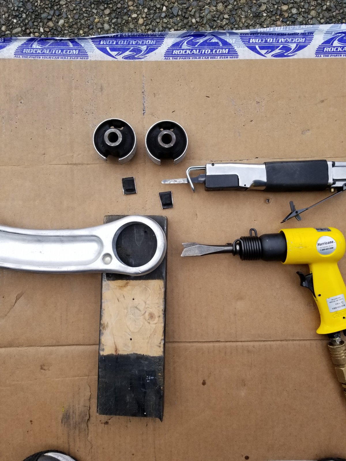

It's amazing what you can accomplish with a good vise and a welding clamp.
New bushings installed!
