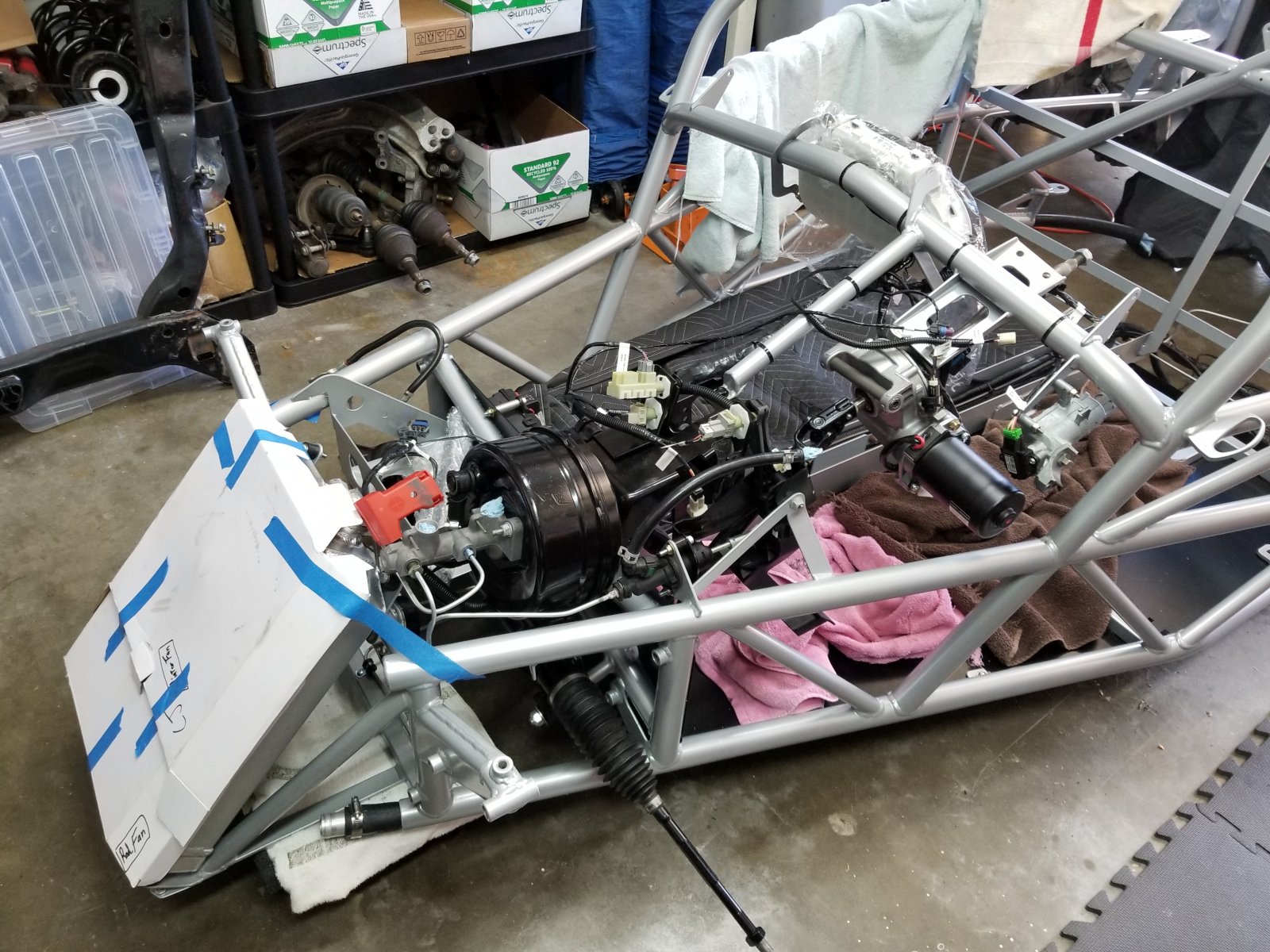

Got a little more done this evening.
Finished wrapping the wiring harness. Do I feel confident all will work as planned? Sure, why not, what could go wrong. Right? o_O
Got rid of the sheet of OSB from the garage and can finally see the chassis again!
Started installing the harness into the car and left off at plugging in the throttle plug and securing.
I did notice that my grounds in the harness tunnel ended up short of the ground lug. I have a ground strap that I'll probably end up using to make that ground work.
I couldn't get those grounds any further forward as the wires were too short.

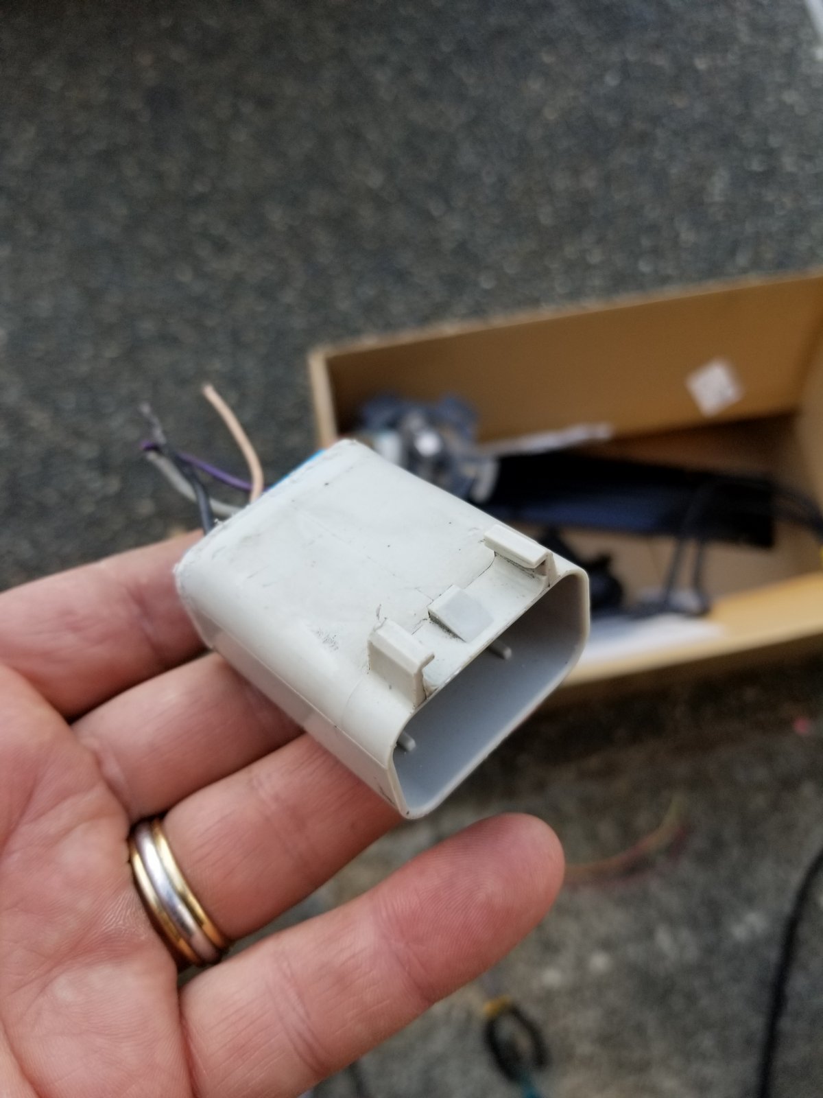

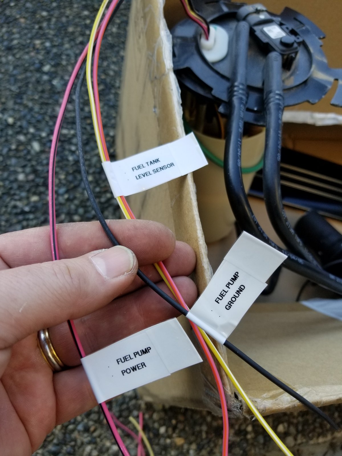

I think I'm going to try and reuse the existing fuel pump connector.
Tested the wiring from the pump which was red/black and black wires which is power and ground.
The other two, yellow/white and pink/red, fuel level sensor.

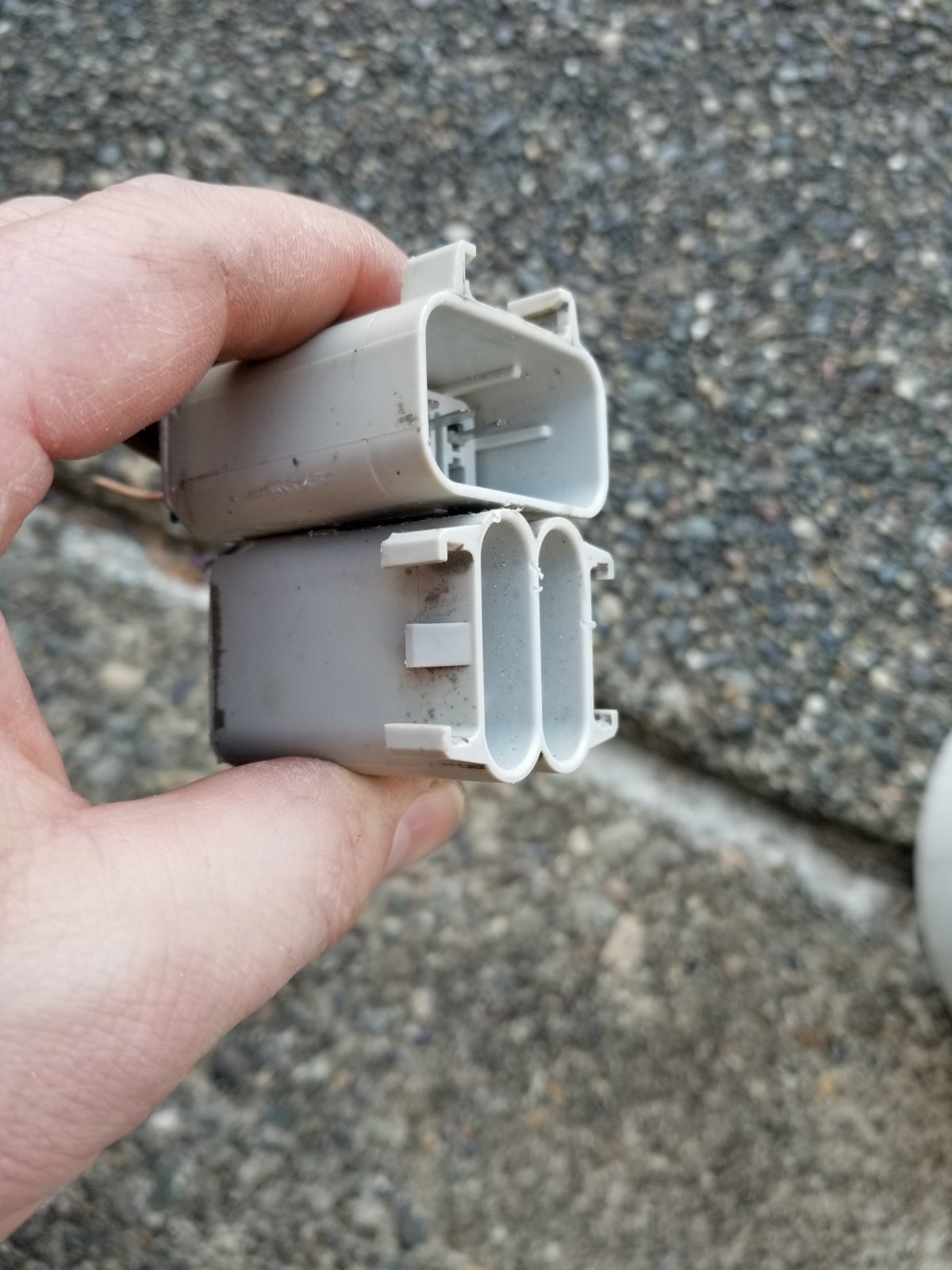

Used a mini high speed grinder with a cutoff wheel to seperate the evap wiring plug.
What worked better than the cutoff wheel on the plastic connector was a mini saw blade set with a mandrel. Then cleaned it up with the high speed grinder and a fine tooth grinding bit.
Now to solder the female plug wires back to the fuel pump harness and the male plug back to the fuel pump.

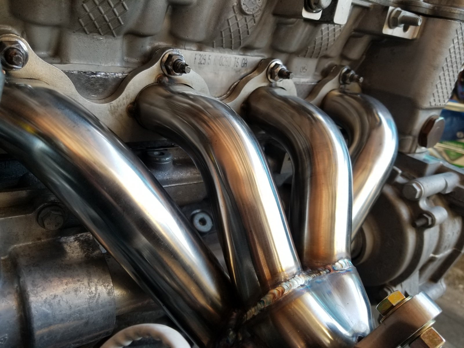

Had a little time the other day a removed an old part and put something on shiny and new! ZZP shorty header.
Definitely use a rust busting/penetrating liquid for nuts. Recheck all stud torque, I only had 1 that didn't back out to some extent during nut removal. Applied antiseize on stud threads prior to nut installation.
Another thing to watch for is when installing the exhaust gasket. On mine, the exhaust gasket ports top edge hung down into the top of exhaust port. The bolt holes for the gasket are large enough that holding it up allows the gasket to clear the port. A little tricky to do while installing the header but it will work.

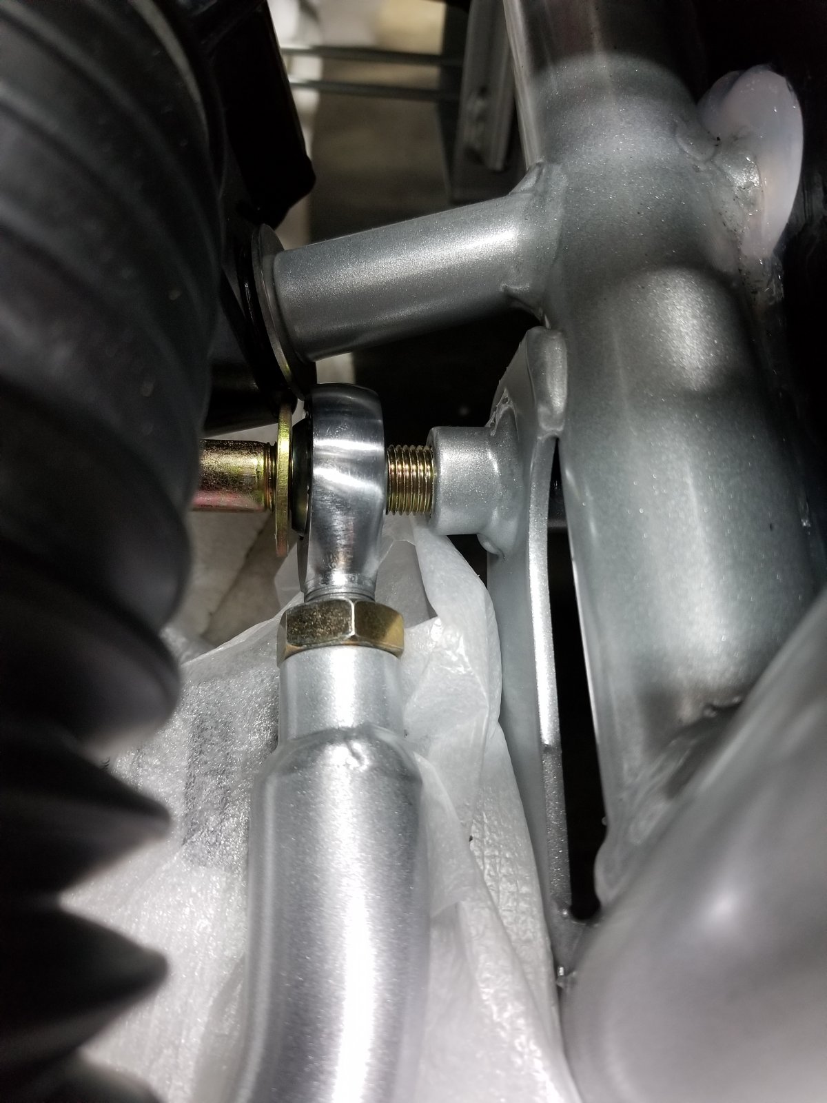

Is there supposed to be a spacer between the rear control arm rod end and the frame pick up point?
I have a about an 8mm gap.
The upper control arm, rear rod end has about 2mm gap.
Am I missing something here?
Plus I'm missing a nut. Not a personal observation, but one 1/2-20 nylocks to mount the control arm. Errr.
No spacer, when you tighten the bolt it will pull it the correct position.
We will ship you a couple of nuts. Goblin nuts.:rolleyes:

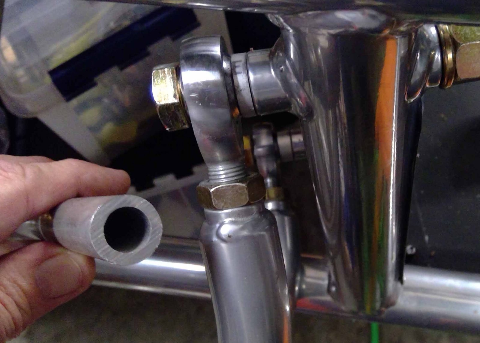

I have about an 8mm gap...The upper control arm, rear rod end has about 2mm gap...
To avoid putting extra side load on the bearings, I ordered a short length of .750 OD x .125 wall round 6061/T6 tube on eBay and cut spacers to fit gaps. That was probably just an overabundance of caution.
JSATX
I would be more worried about changing the tested geometry of the frame than the tiny bit of tension created when tightening down the arms. About everyone’s A arms have required stretching a little, I think when they weld them it causes them to pull in.
