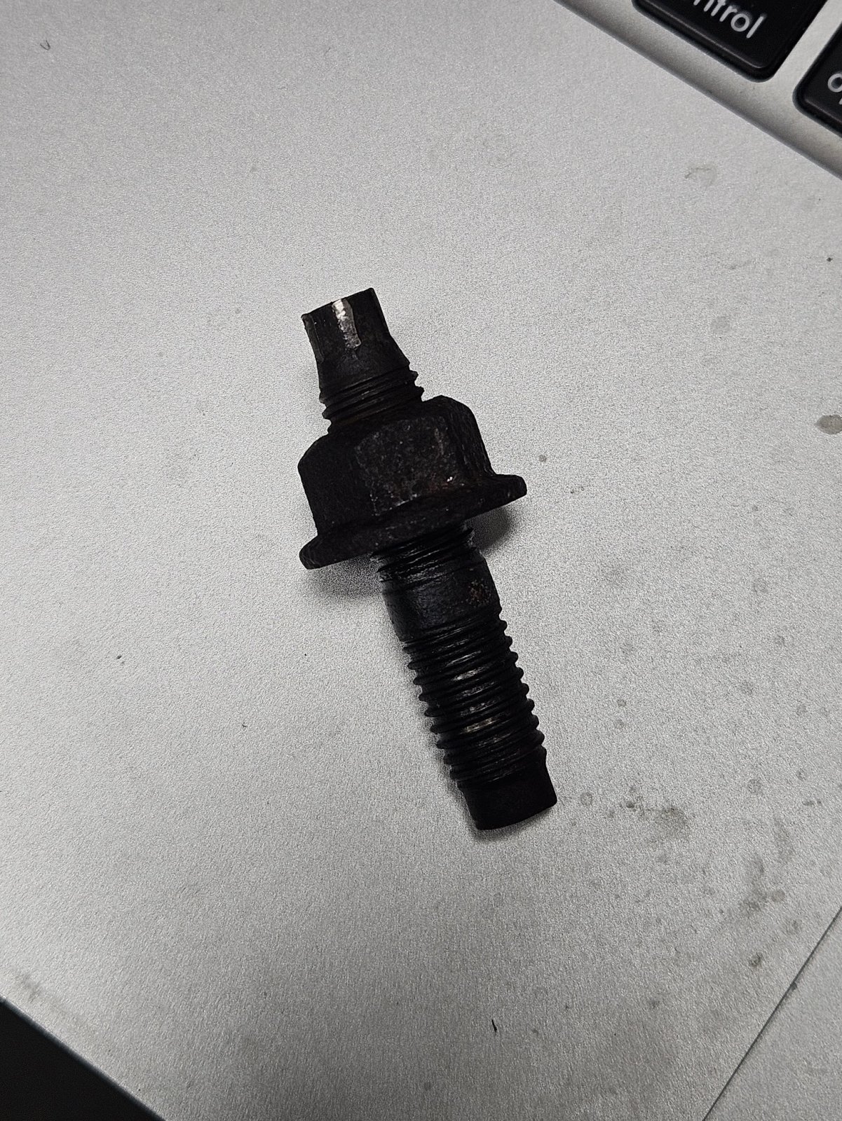

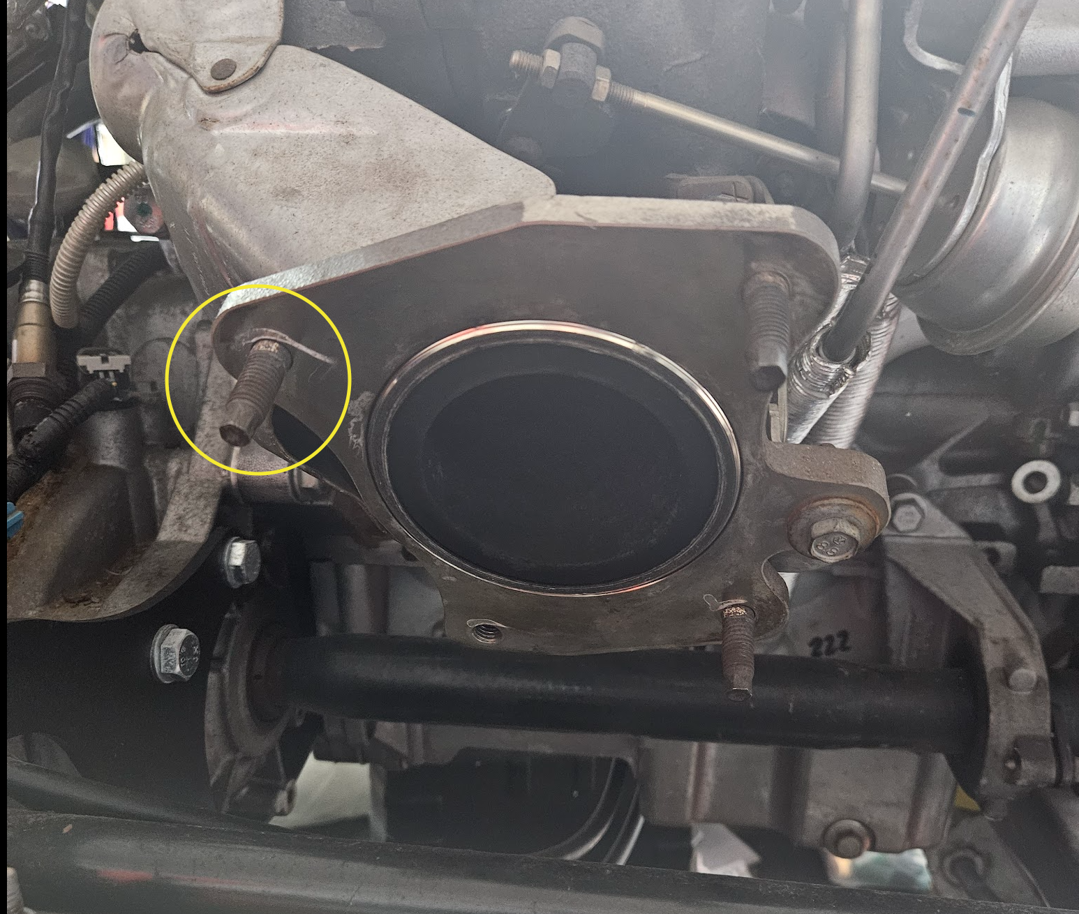

Nothing is ever easy lol....I've got what I think is an exhaust flange bolt stuck tight...Kroils, PB Blaster, fire..nothing will break it loose. What is the correct name for this nut/bolt combo? I need to grab one tomorrow assuming it's a common part. Go easy on the n00b, gentle reader...
44767
44768

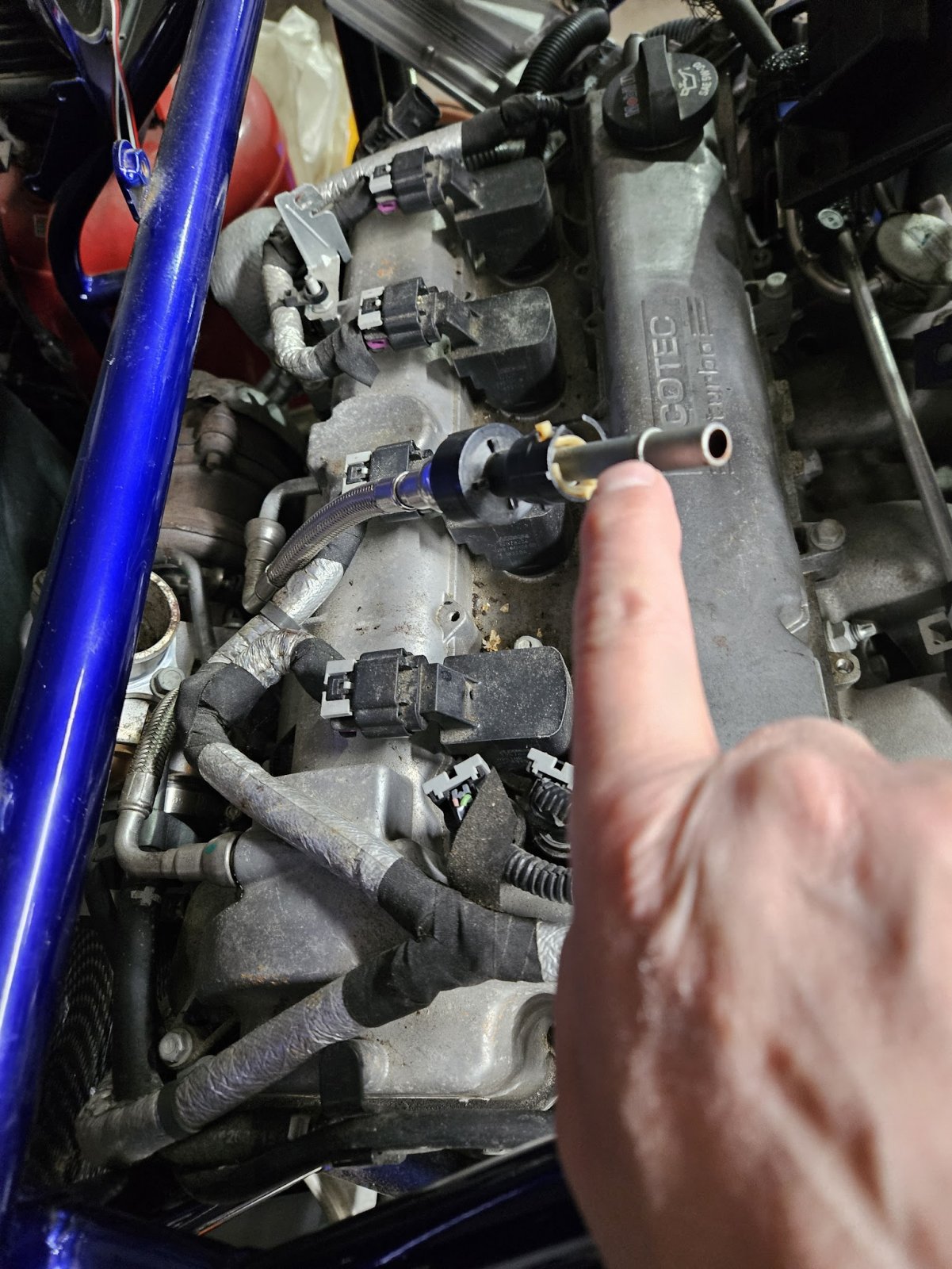

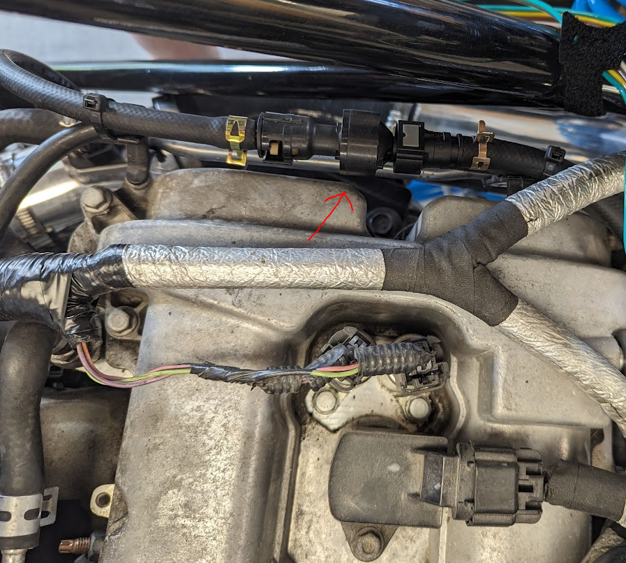

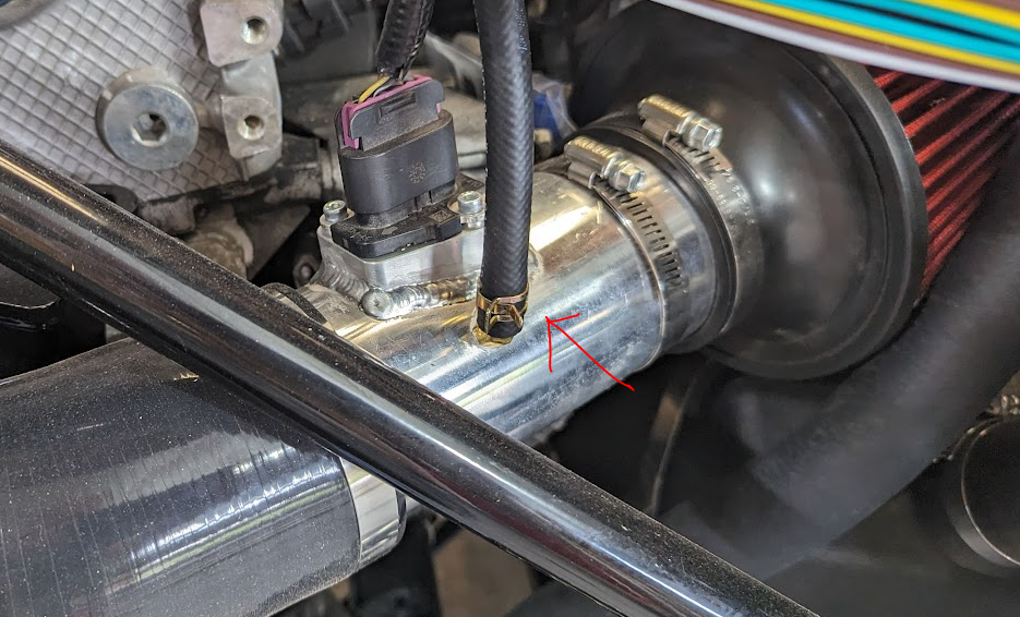

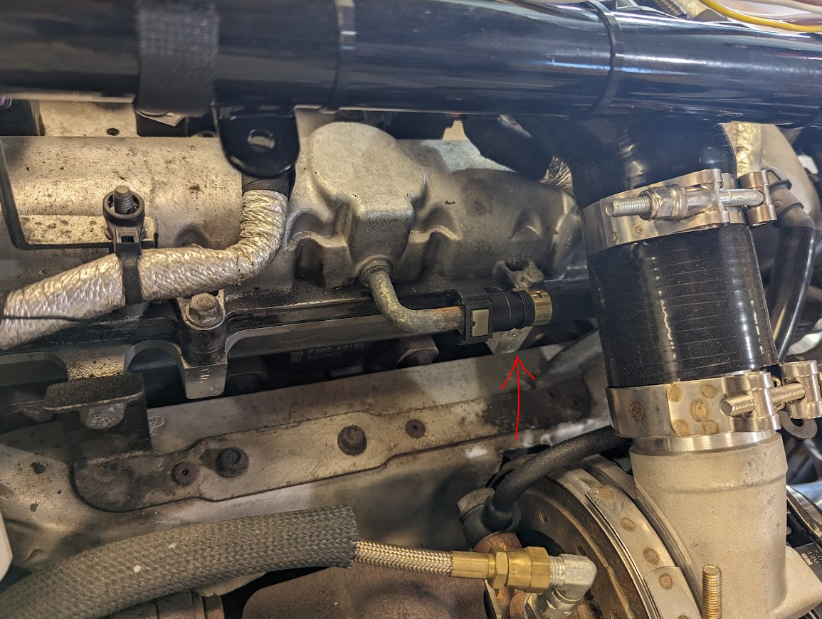

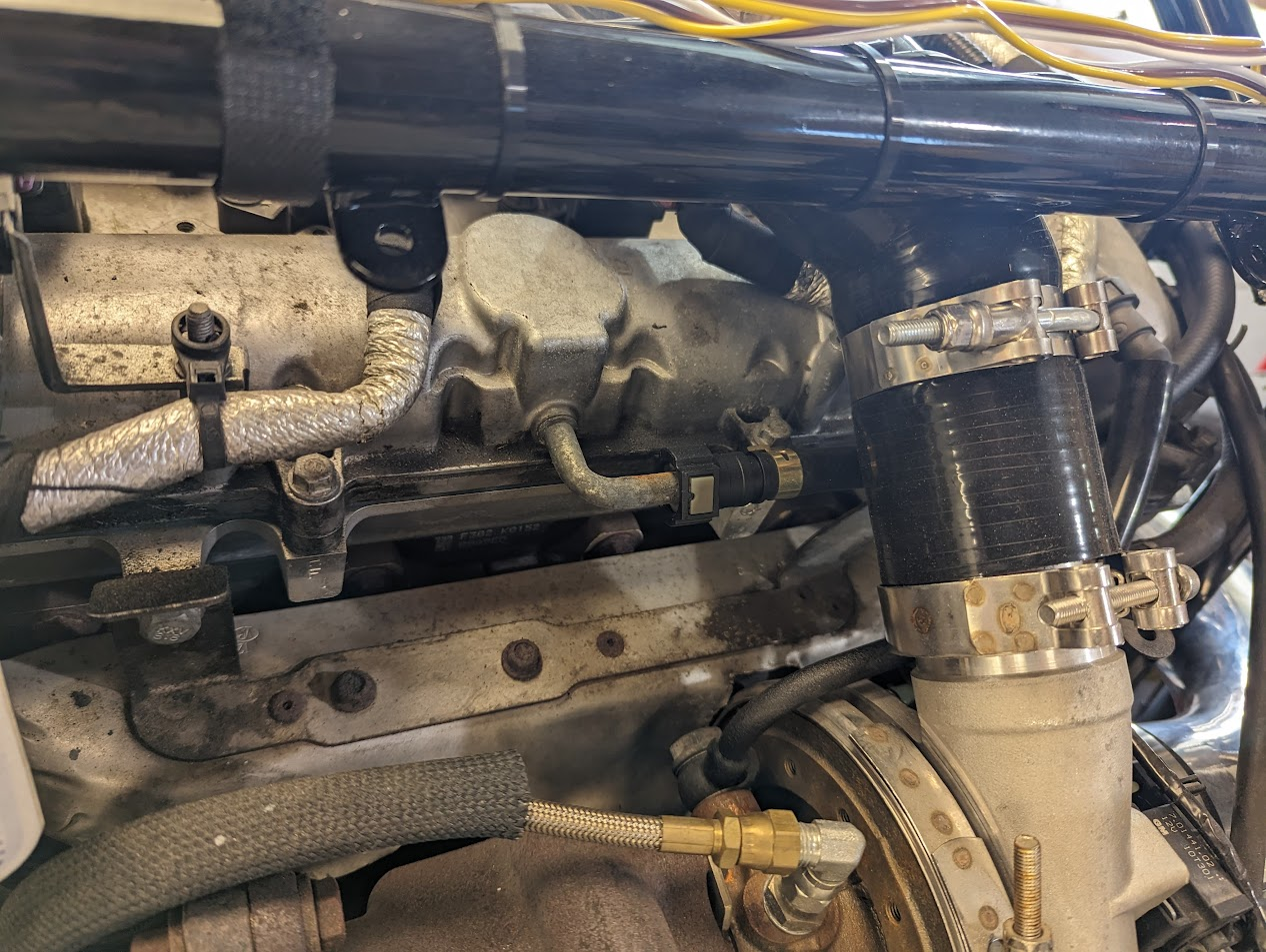

Also, what is this and where does it connect?
44771
44772
View attachment 44767View attachment 44768
View attachment 44771View attachment 44772

If the nut is stuck on the stud just thread it back in when you install the muffler. It is called an exhaust manifold stud which should be 10mmx1.25 thread pitch. I don’t remember for certain on the pcv hose

Yeah I sorta wondered if I could just tighten that down stuck nut and all...sadly I've stripped the end of it trying to break it free, so off to AutoZone I go (those guys think I'm hysterical, and I probably am...). Thank you for the manifold stud spec!
Not sure about the pcv, there's something similar in the valve cover already, I'll take more photos later. Thanks again!
11609870 is the GM part number for that exhaust stud. I ordered a set of new ones off of rockauto.
This is a vent that gets plumbed to the intake tube near the MAF.
I got rid of the braided line and ran some rubber hose.
