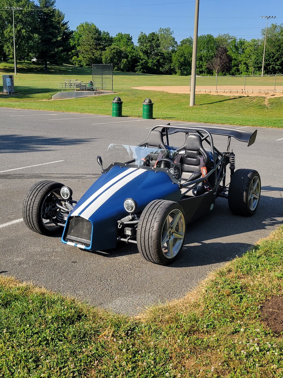

The Nittos never seemed to get very warm. I'm hoping the narrower ones will get hot quicker.
Plus, the wide tires in the front do not like the roads around where I live. Large trucks have created grooves in the lanes and these wide tires were always trying to track them. In and out, in and out, in and out. It was annoying. I'm hoping this helps some.

Ive definitely heard/read about our cars not being heavy enough to get the wider tires warm enough to work properly. Just curious, it helps me make my decisions come spring time when I need to purchase my tires and get on the road.

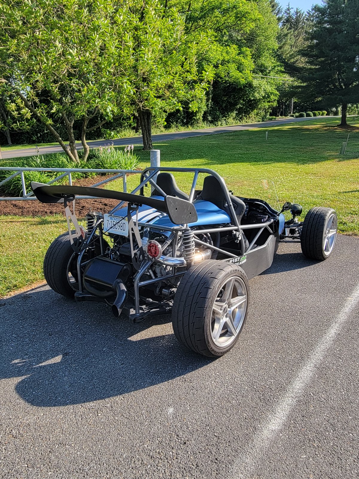

I got some miles on the new tires this morning. Went to the local cars and Coffee. Temp was low 50s. Not horrible. I remembered gloves this time! lol.
I'm liking the Mustang rims.

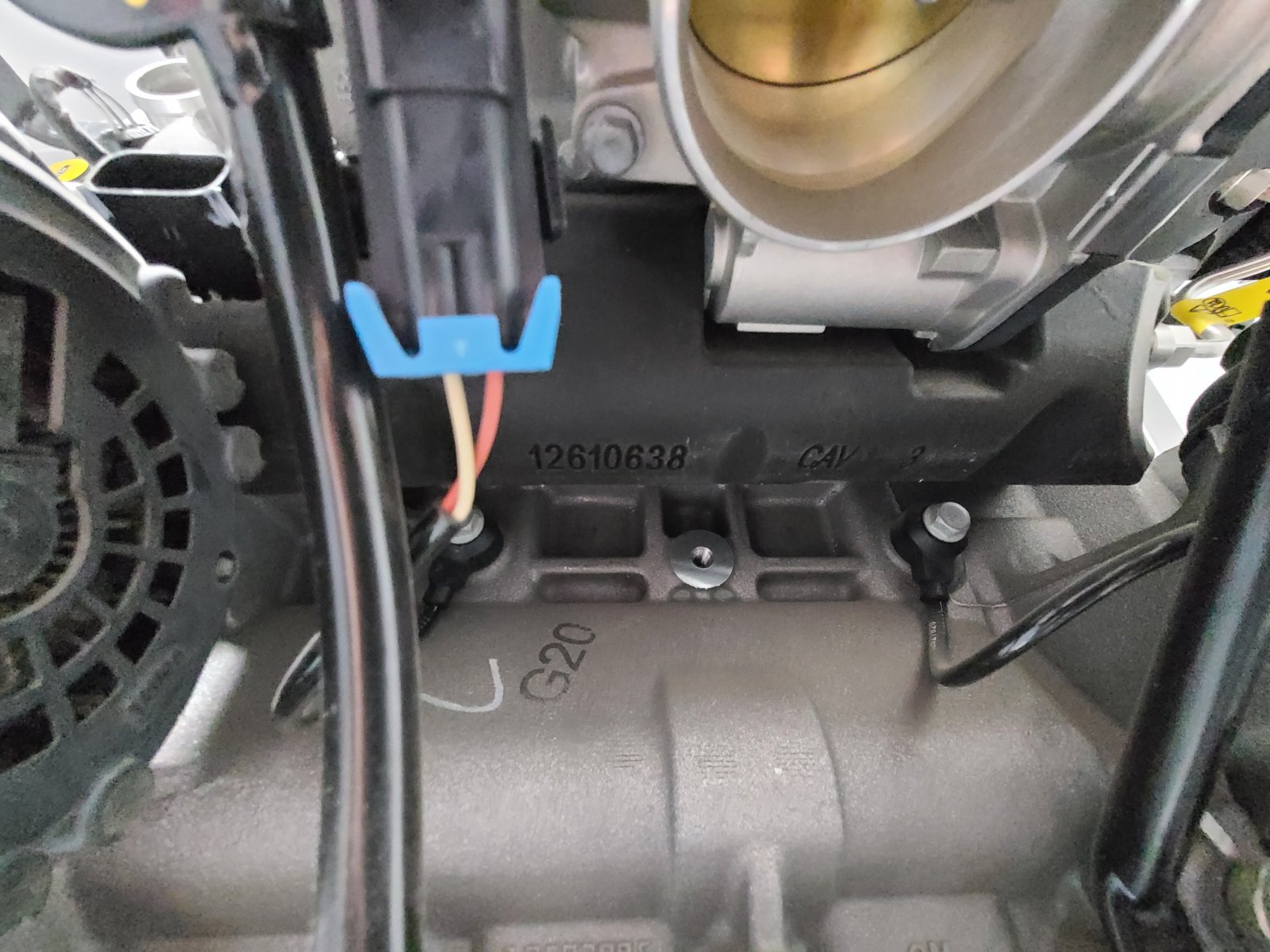

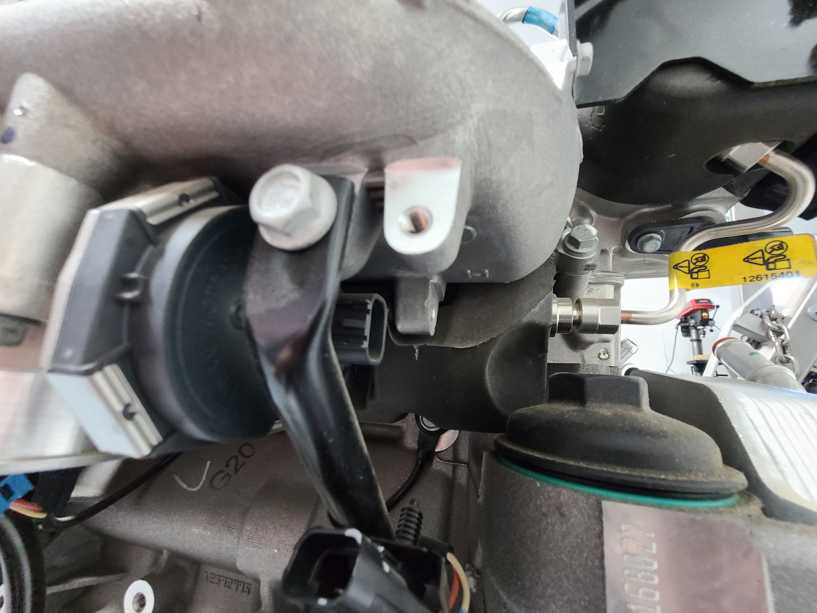

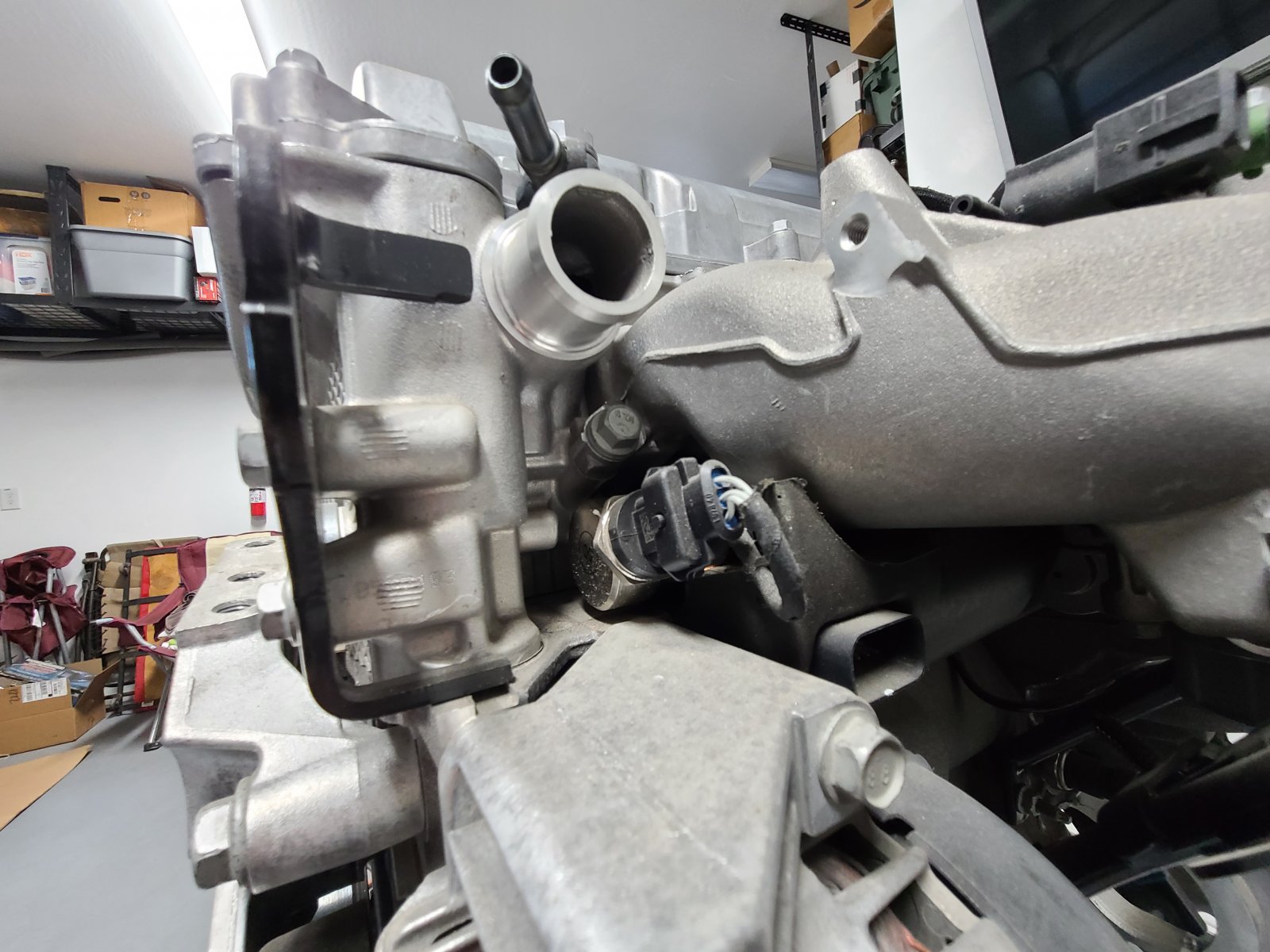

Yes. Right above the intake runners. The fuel rail holds the injectors and they press fit into the head.
EDIT: I misread and answered incorrectly. See below.
LNF/LDK DI injectors mount directly below the intake manifold, which is what I believe you meant to say. Im not trying to be a jerk, just wanting the correct info for the DI motors to available to the other readers. :D
Fuel injector rail is behind the foam sound proofing on the LNF and the throttle body.
The high pressure hardline connects to the fuel rail on the transmission side above the oil filter.
The fuel pressure sensor and injectors common connection is above the alternator just below the radiator coolant outlet.
