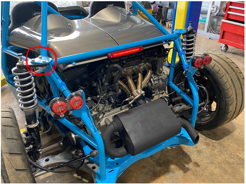

I snuck up to the paint shop last week to have him look at the fiberglass. Dropped parts off on Friday. Picked them up today after lunch.
The side panels were off for these quick pictures.
I ditched the Nardo after seeing the paint sample in the PPG book. This is a Subaru metallic bronze that has more of a grey tone to it than brown. It's fairly close to the gunmetal type metallic on the rims. Close enough for me. I chopped the back lip off of the engine covers last week before I dropped them off. Didn't have time to throw them on for pictures today. I'm going to rivnut the side panels on. I have the crimper already. Amazon is dropping off the 10-24 rivnuts and BHCS's tomorrow. Sounds like a weekend project!
