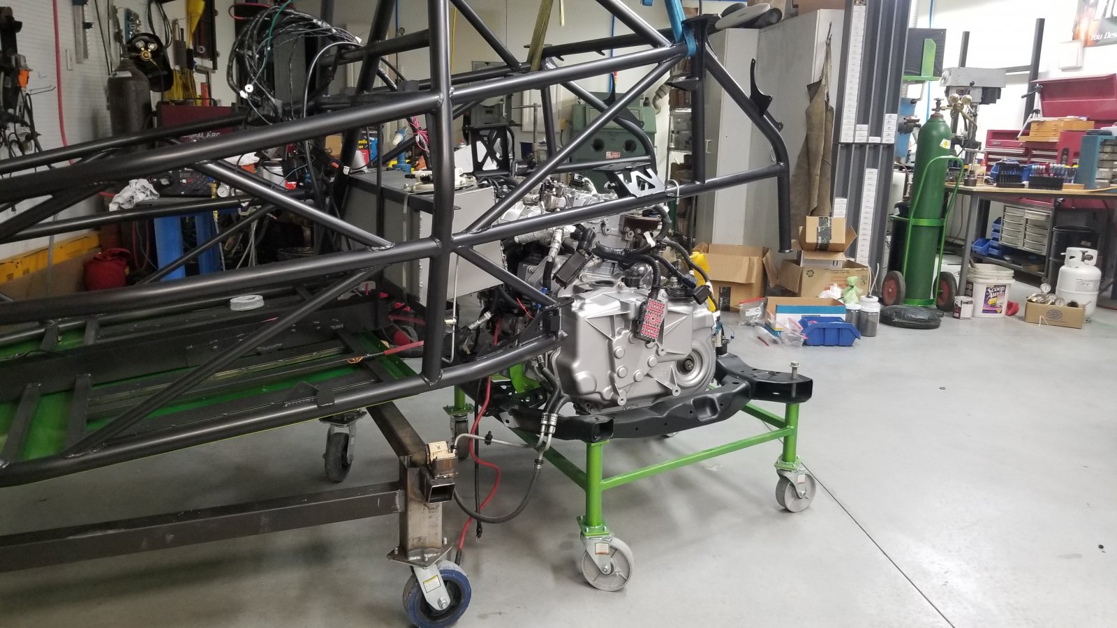

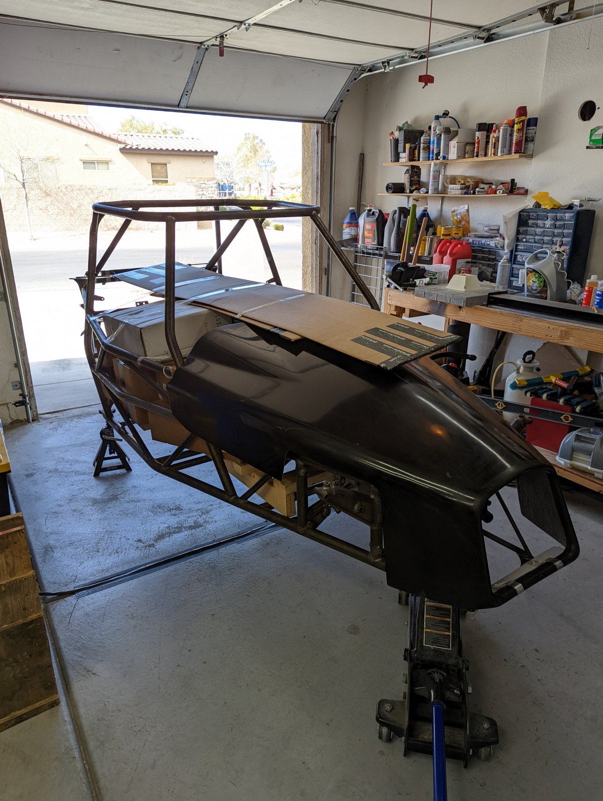

We built these two carts, one for the chasis and one for the motor. If you want, they are available to borrow. I will need them back, but they are just sitting here now.

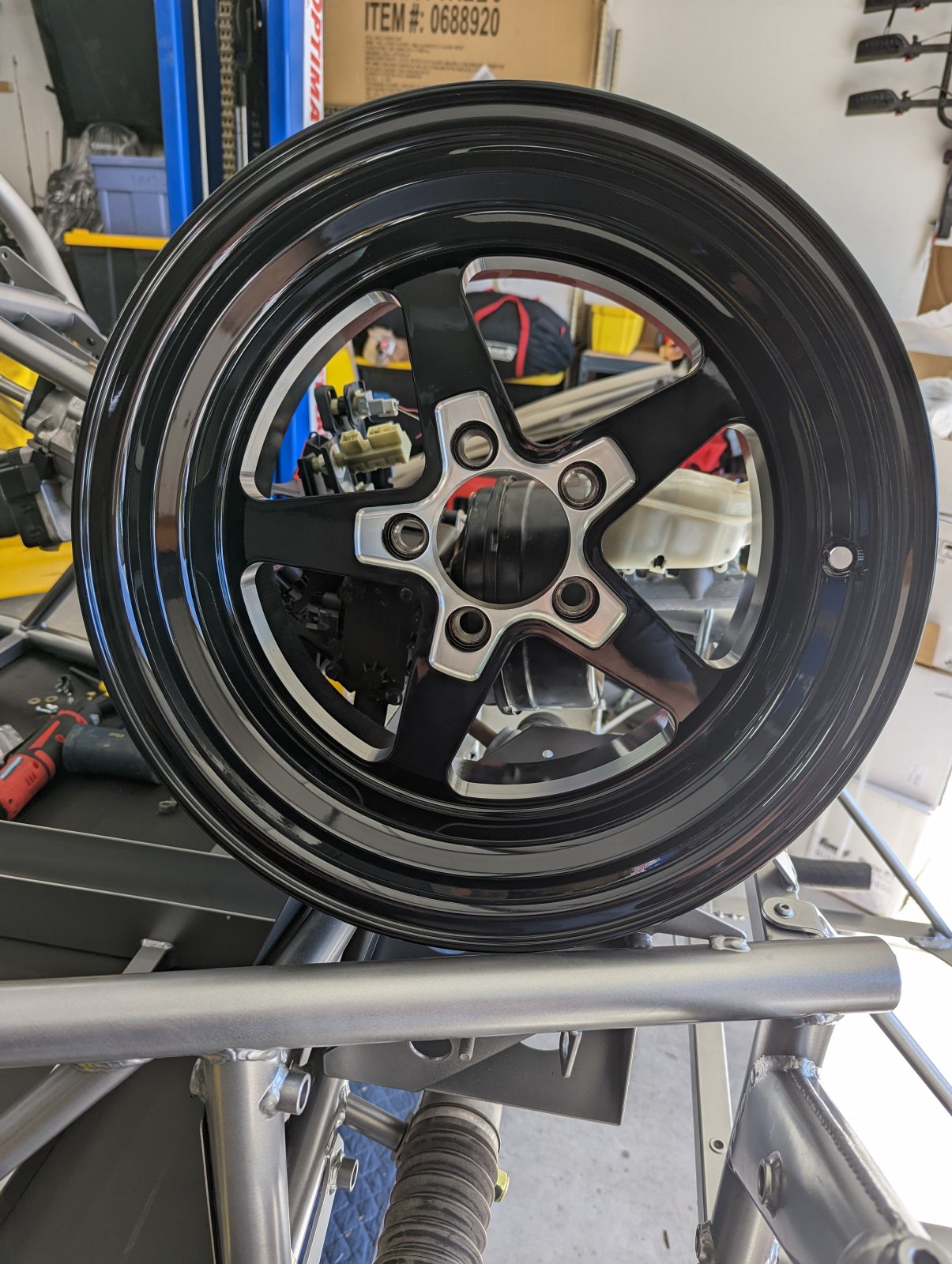

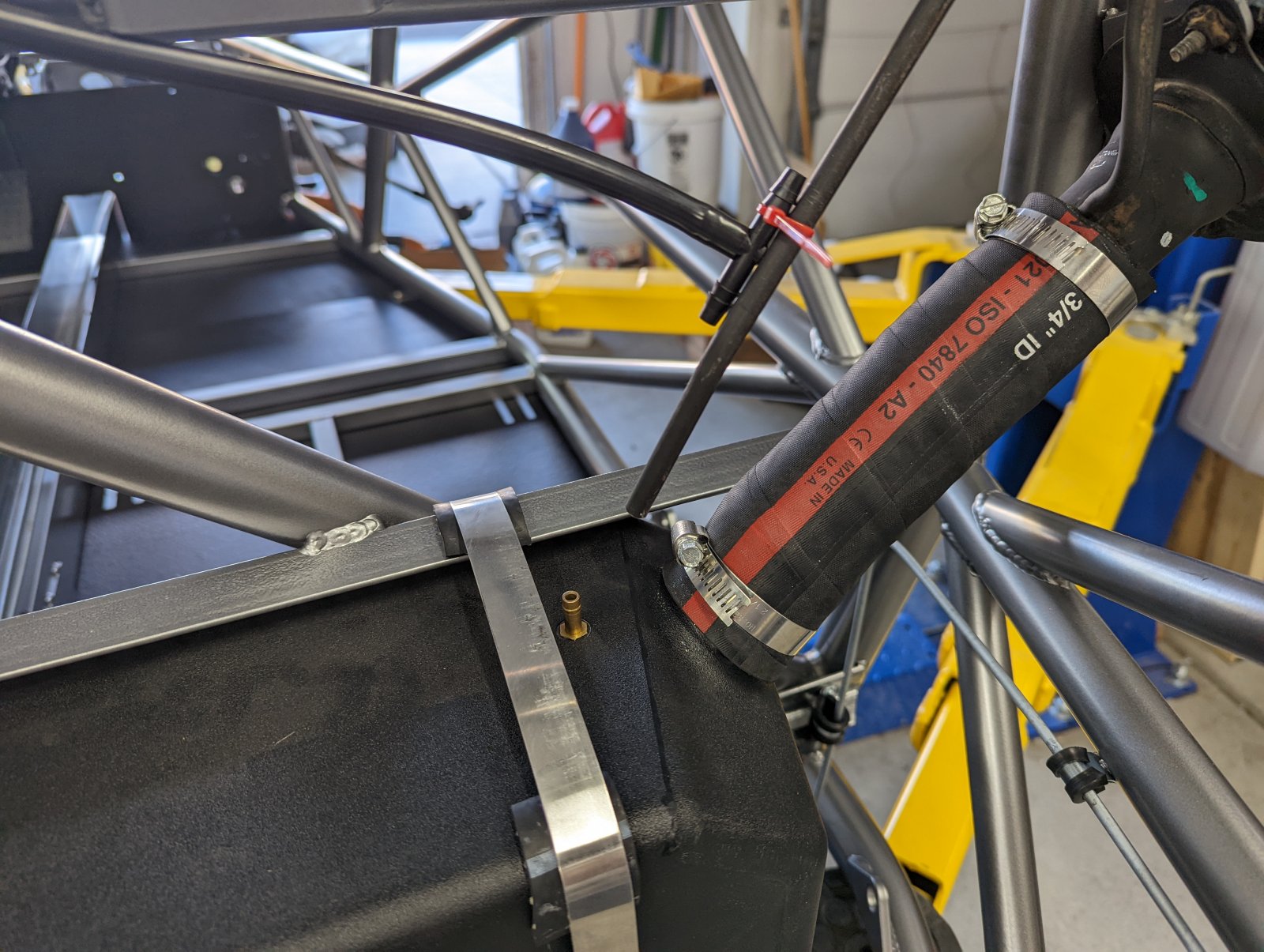

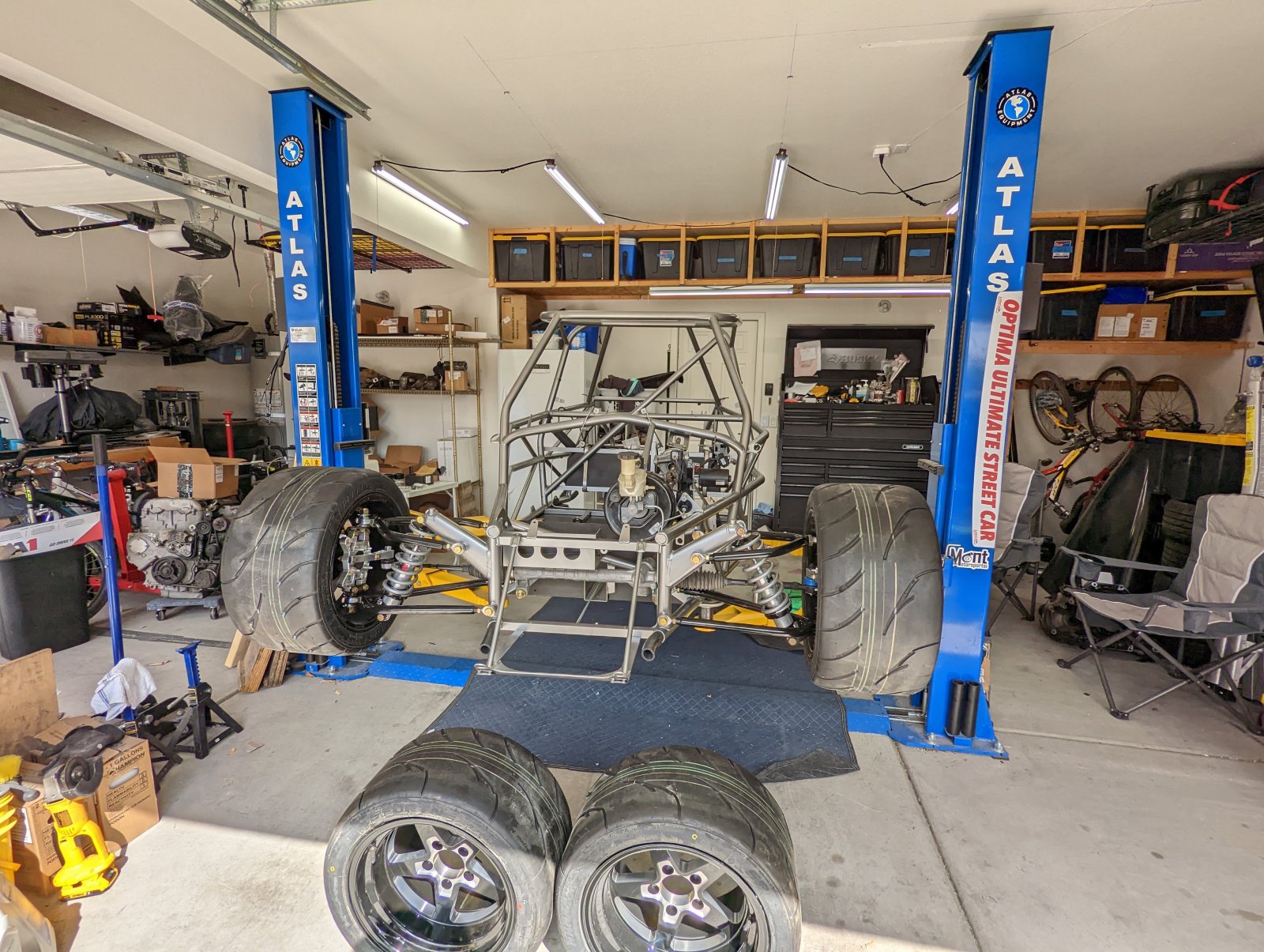

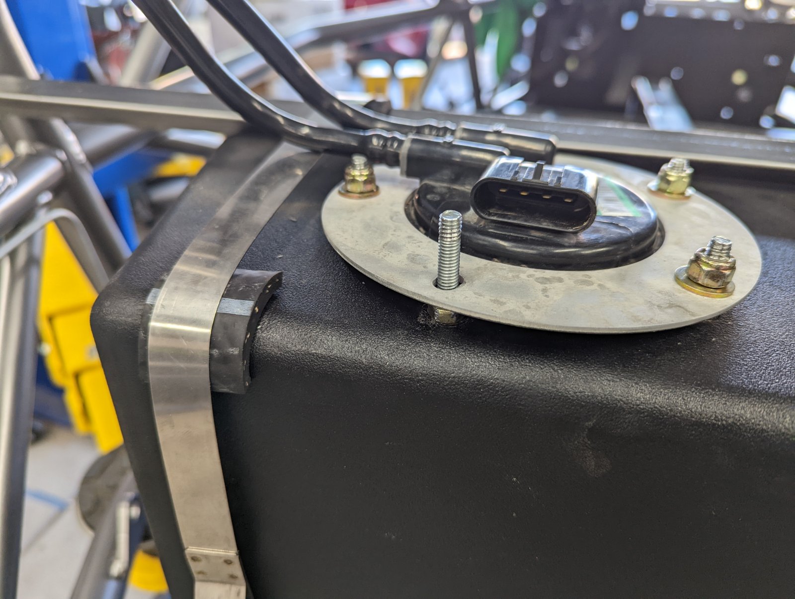

Finally got a chance to work on the Goblin yesterday with a buddy of mine. Going together pretty easily. Only issues so far include a stud spinning on the fuel tank, and I can't for the life of me find those little hoses that connect to the breather tube on the fuel tank. Here are some pics of the progress along with the new Summit Racing wheels (15x10 114.3) that showed up yesterday too. Hoping to see the Nankang AR-1 tires (275/35-15) in the coming days as well. I have a short video on Instagram that my buddy shot - here is the link to that as well.

OH man, I'm really liking the wheels.

Remove the fuel pump and tighten the stud - thru bolt to the inside of the tank actually. Easy-peasy! :D

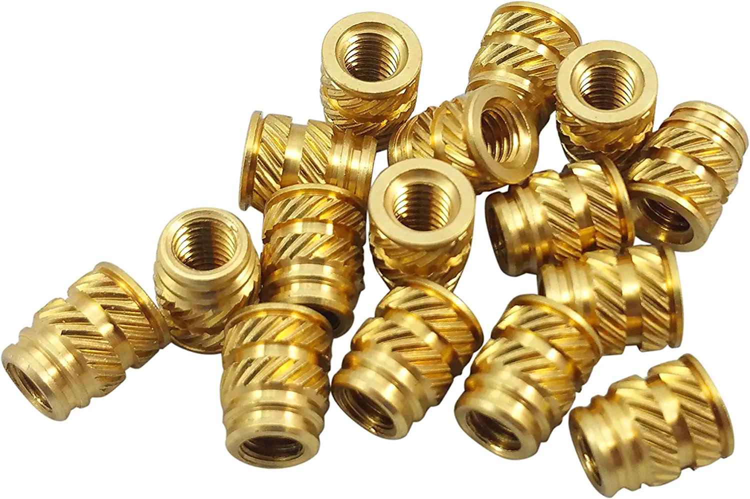

Yeah, about that. Sooo, new style tank is plastic and not the aluminum style. Personally, I like the plastic version because I plan on running E85, but it has pressed in threaded inserts. To make it more of an issue the nuts that came with the kit were the wrong thread pitch and were cross threaded when a buddy tightened them down. So now I have two inserts that spin, one of which still has the stud loctited in it. Stopped for the day, don't want to be frustrated with the project.

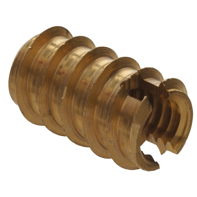

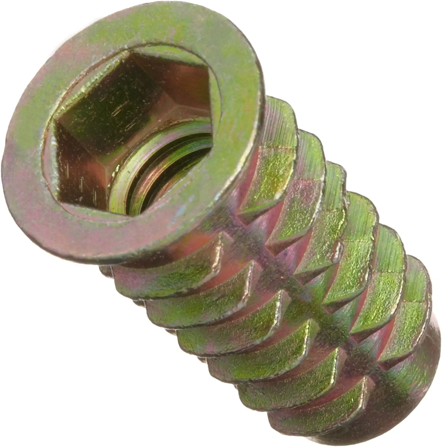

Epoxy back in some new Wood Insert Nuts? Of course you will need the right threads, but they look something like this:
35568
35569
Or better yet, Threaded Heat Set Inserts for 3D Printing
35570
C
View attachment 35568View attachment 35569
Thanks for sending me those. I was considering epoxying in ones for wood. Having someone else suggest it gives me confidence it will work. Gonna heat up the ones in there and see if I can pull them out

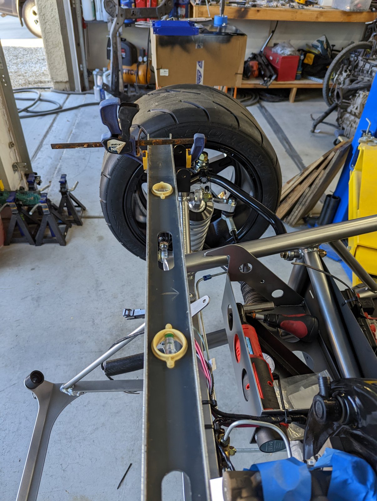

Good day today. Got the front suspension all put together with a buddy of mine. Only issue was the new steering rod end I bought....but a cutoff wheel and some angst helped remedy the problem. Here is a pic of those skinny front tires I bought. Gonna spend the next week cleaning up the garage and a couple other little things on the car, then onto finishing the front end.

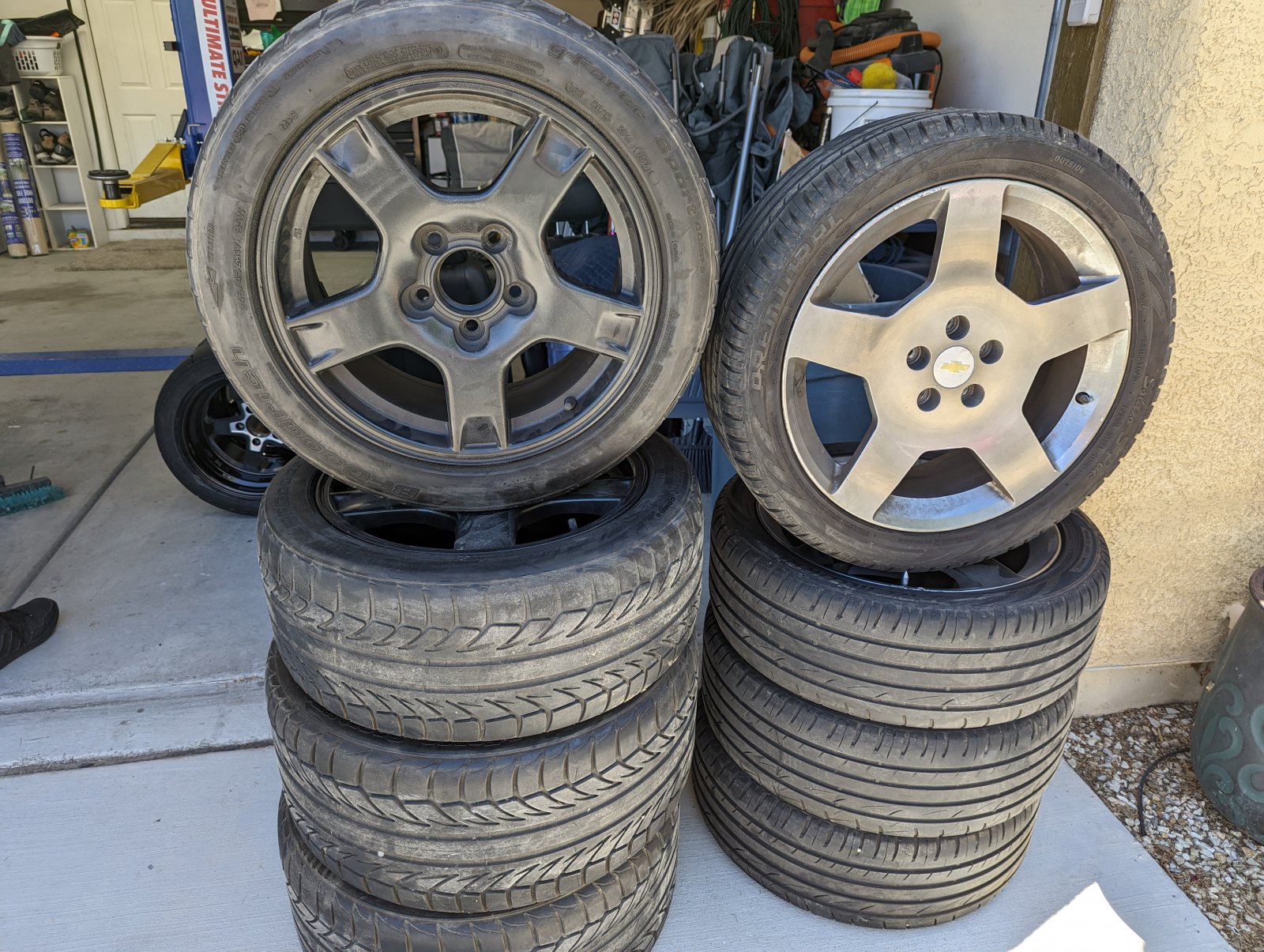

Anybody want these? Cobalt SS wheels, and some old Vette wheels. Gotta pick them up, free to good home as long as they are gone this weekend.

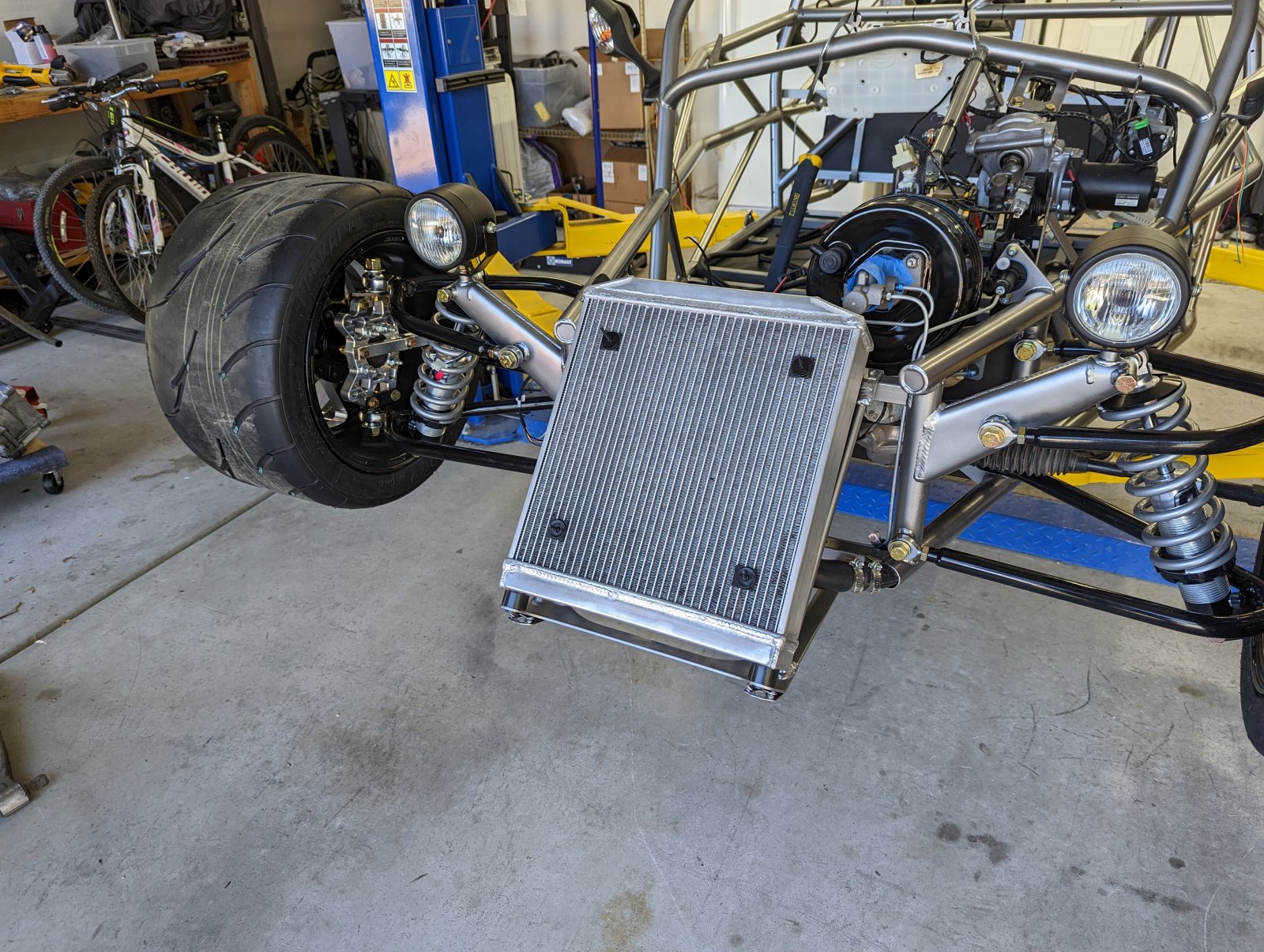

Headlights/mirrors, and radiator assembly installed thanks to my buddy. Big thanks to Adriana for getting me the missing fan so quickly!!!! Also, as a tip - I used my old metal level and some clamps to make sure the headlights were both pointing straight forward and parallel. Worked awesome.

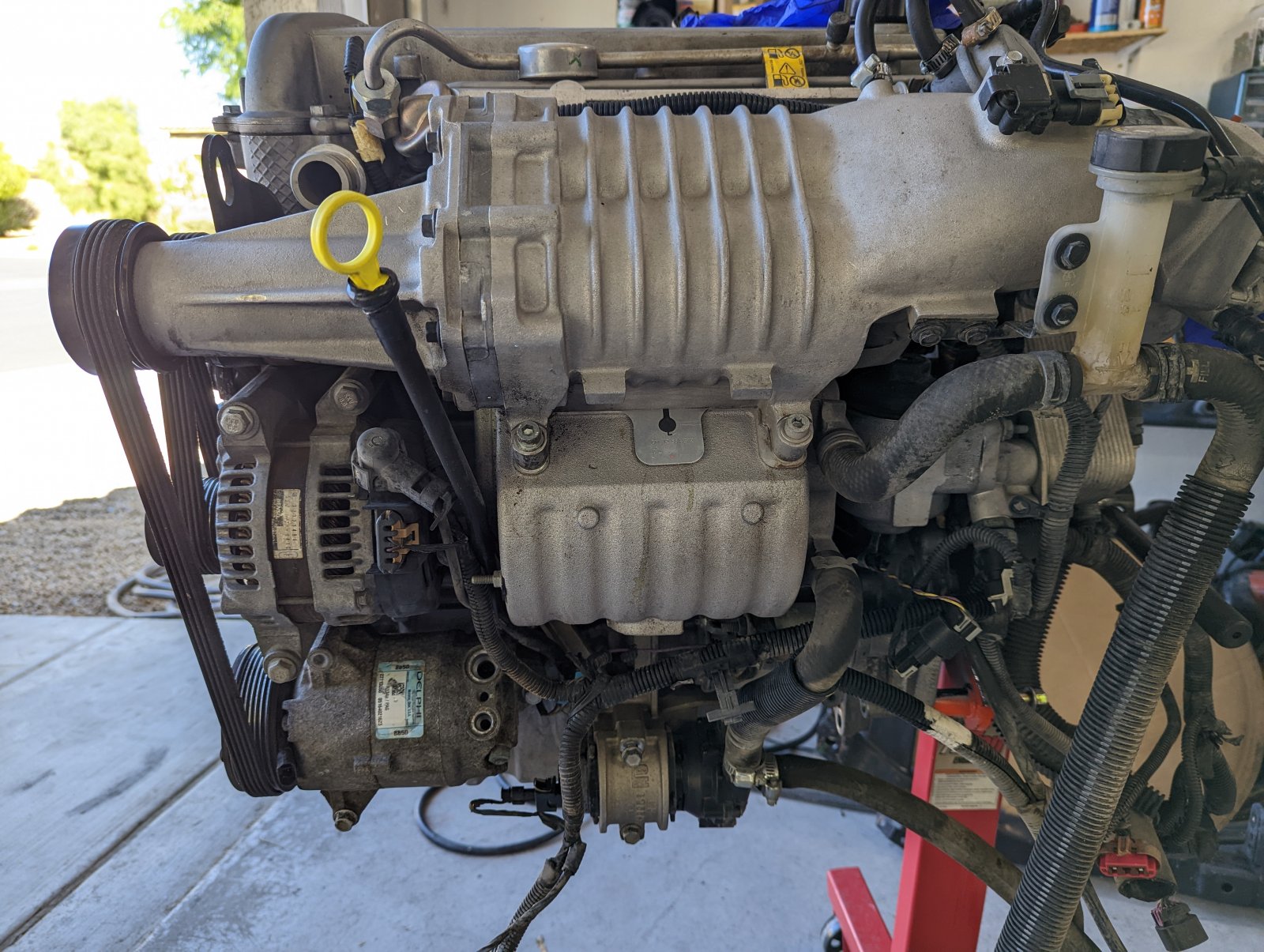

Additionally, I finally got the engine off the floor and onto an engine stand so I could pressure wash it. It came out pretty nice.

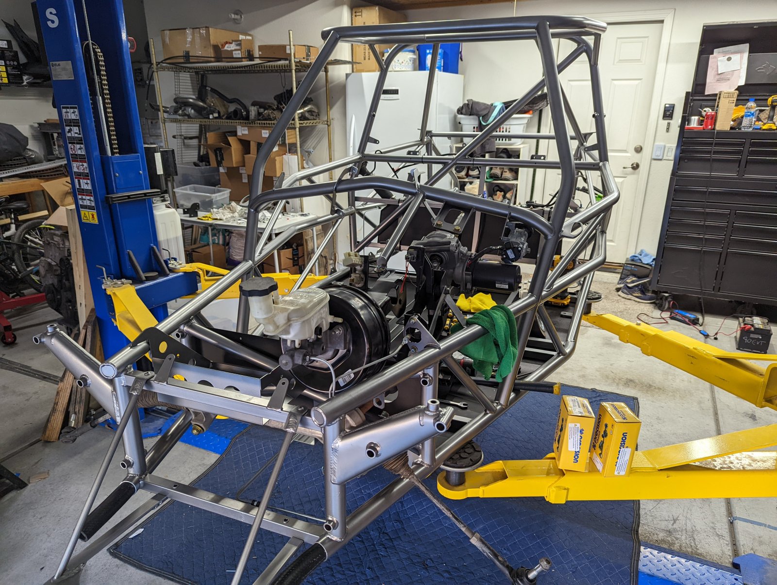

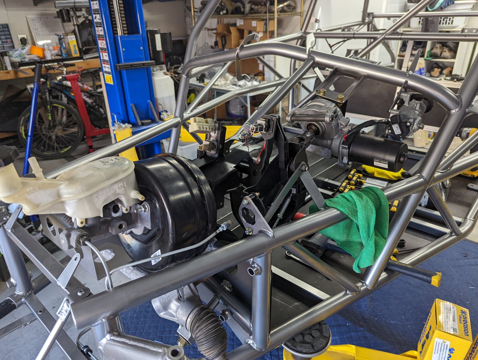

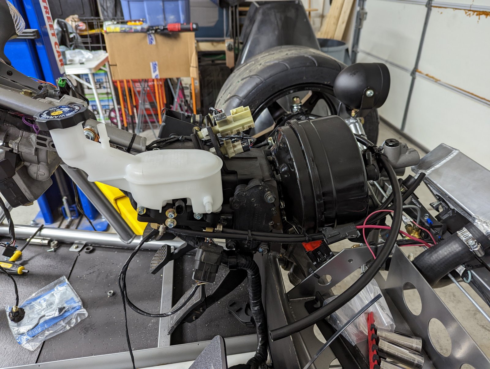

Finished wiring the headlights this afternoon and relocated the brake/clutch reservoir. Threw away the 45 degree elbows, ordered some 90's to replace them as well as some other hardware to reduce lines etc. Not impressed with how this is all plumbed together at all....just asking for leaks and issues. I am also going to design a bracket that raises the reservoir and slides it back towards the gauge cluster. Once I have it all finished I will share the file so everyone can use it.
k.rollin
I had leaks from the barbed remote reservoir fittings, where the nylon tubing slid over the barbs. A couple of -4AN lines took care of the leaks for not much money.
C
