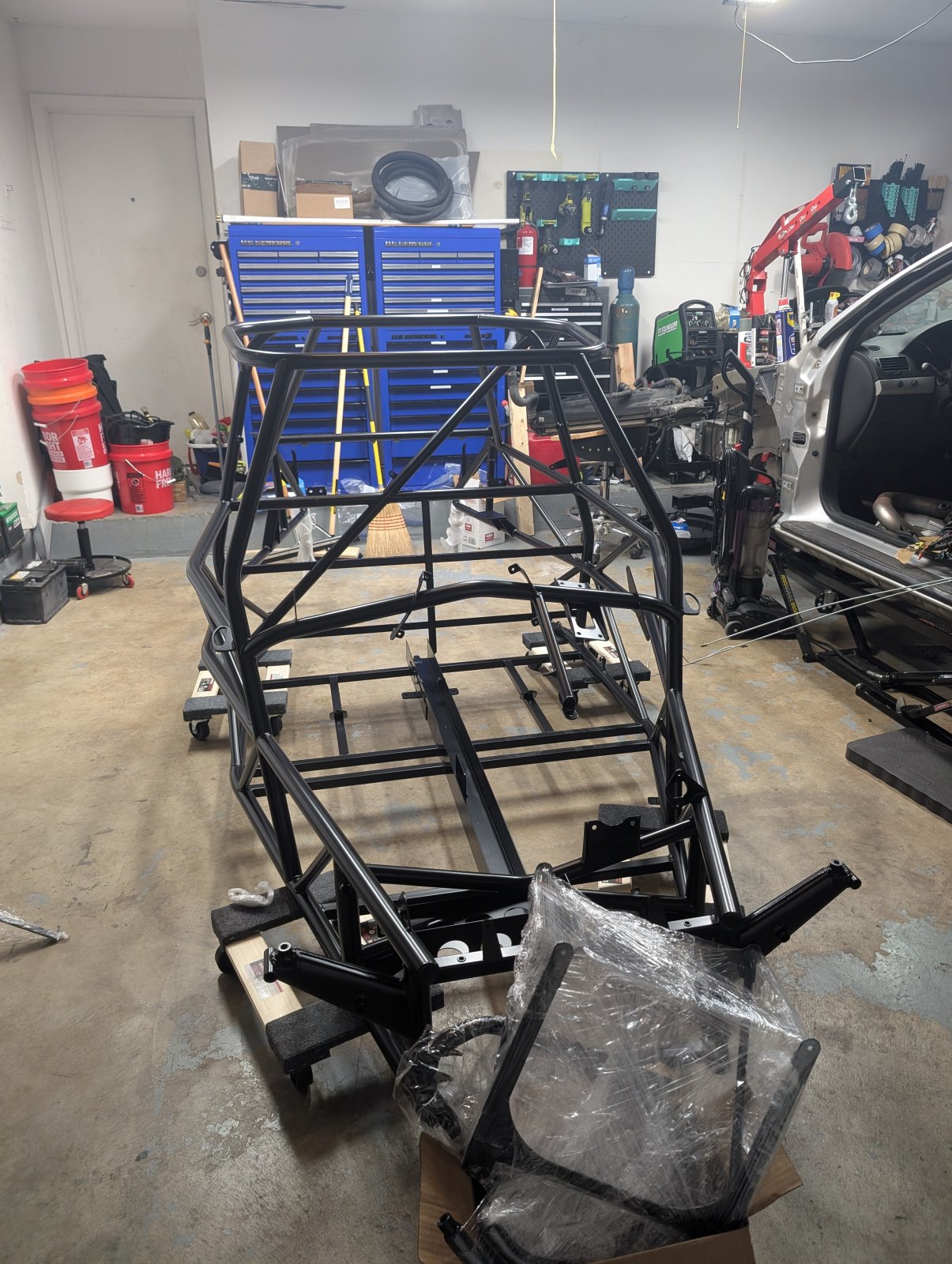

Yeah I'll attempt it all with no cutting just to save the added effort, if the quick jacks can get it high enough to roll out on it's own I'll go that way. If not it's nice to have the option to cut it free.
All of this is now probably getting delayed somewhat because the powder coater just called and the chassis is ready to pick up tomorrow, so I need to scramble to get the other half of the garage ready for it tonight.

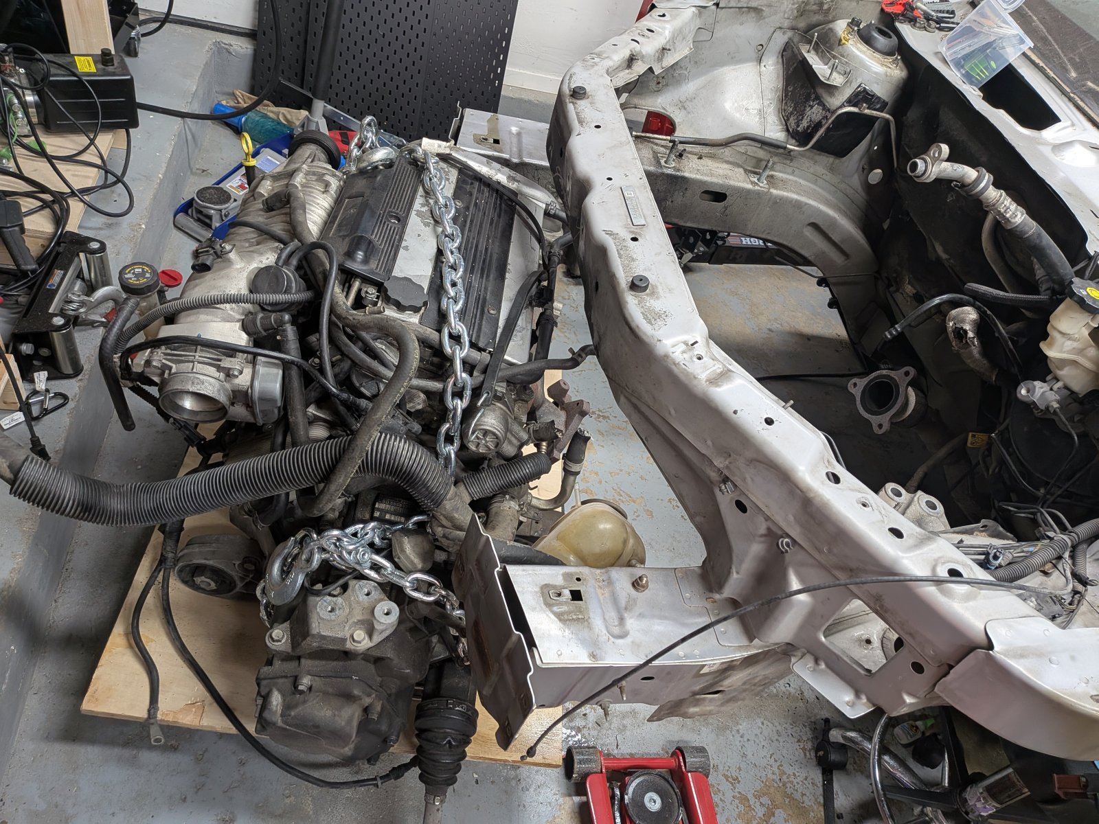

Well, we're back after an extended delay. Surgery recovery took longer than expected and a wall of other projects popped up.
Finally got the powertrain dropped last night, and think I only broke one thing in the process, so pretty good by my standards.
Next up I need to finish removing everything possible from the donor and figure out how to get it out of the garage to free up space.
54229
J
I also need to figure out some sort of stand/bench to get the powertrain onto so I can work on it.
In the downtime I decided to scale down my plans a bit, I'm shelving the tube subframe/F23 swap for now and am just going to get the car up and running on the donor subframe with the F35. All I plan on doing on the powertrain for now is the ZZPerformance's timing chain kit and their high output intercooler pump.
I'm hoping I can get it up and running (and street legal, which I suspect will be the hard part) by March. I have a bit of a stupid plan to run it in SCCA's Targa Texasland next year. We ran that in my Camaro this year and it was a blast. I think doing it in a Goblin would crank the challenge level way up, which sounds fun to me.

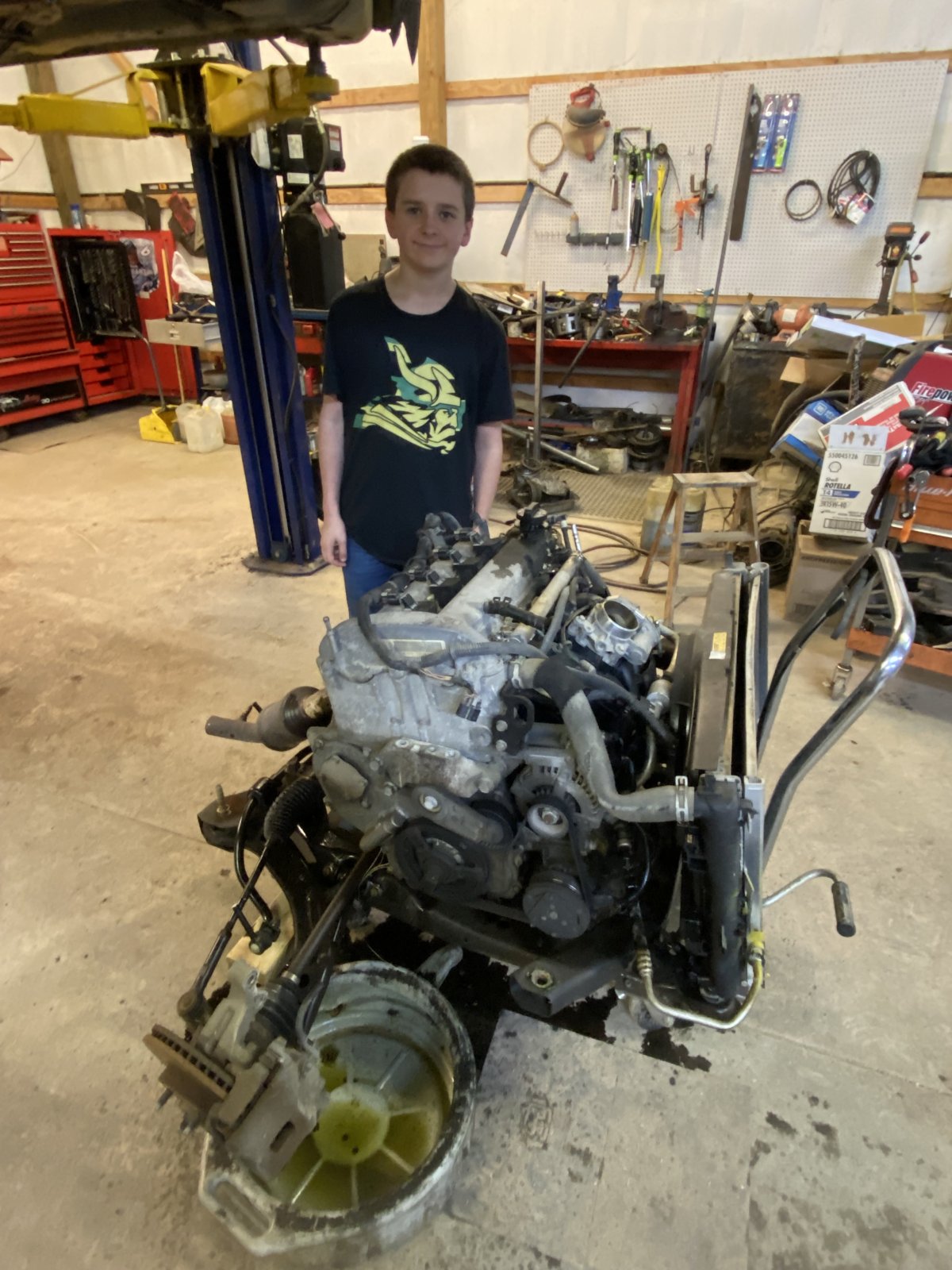

I have a hydraulic lift table from harbor freight that I used as a powertrain table for the wife’s Goblin
J
I don't, I was planning on getting one, but as I was debating swapping to an f23 transmission, and the subframe is specific to the transmission, I'm holding off for now.
J
That looks like the perfect solution, do you happen to know if you have the 500 or 1000lb version?
Trying to get an idea of what the whole powertrain weighs is a bit of challenge
Markm
I have the 1,000 lb version.
