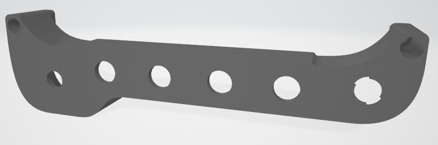

Would you be willing to share the lower button panel with the ALS and ignition holder?
index.php
index.php
index.php

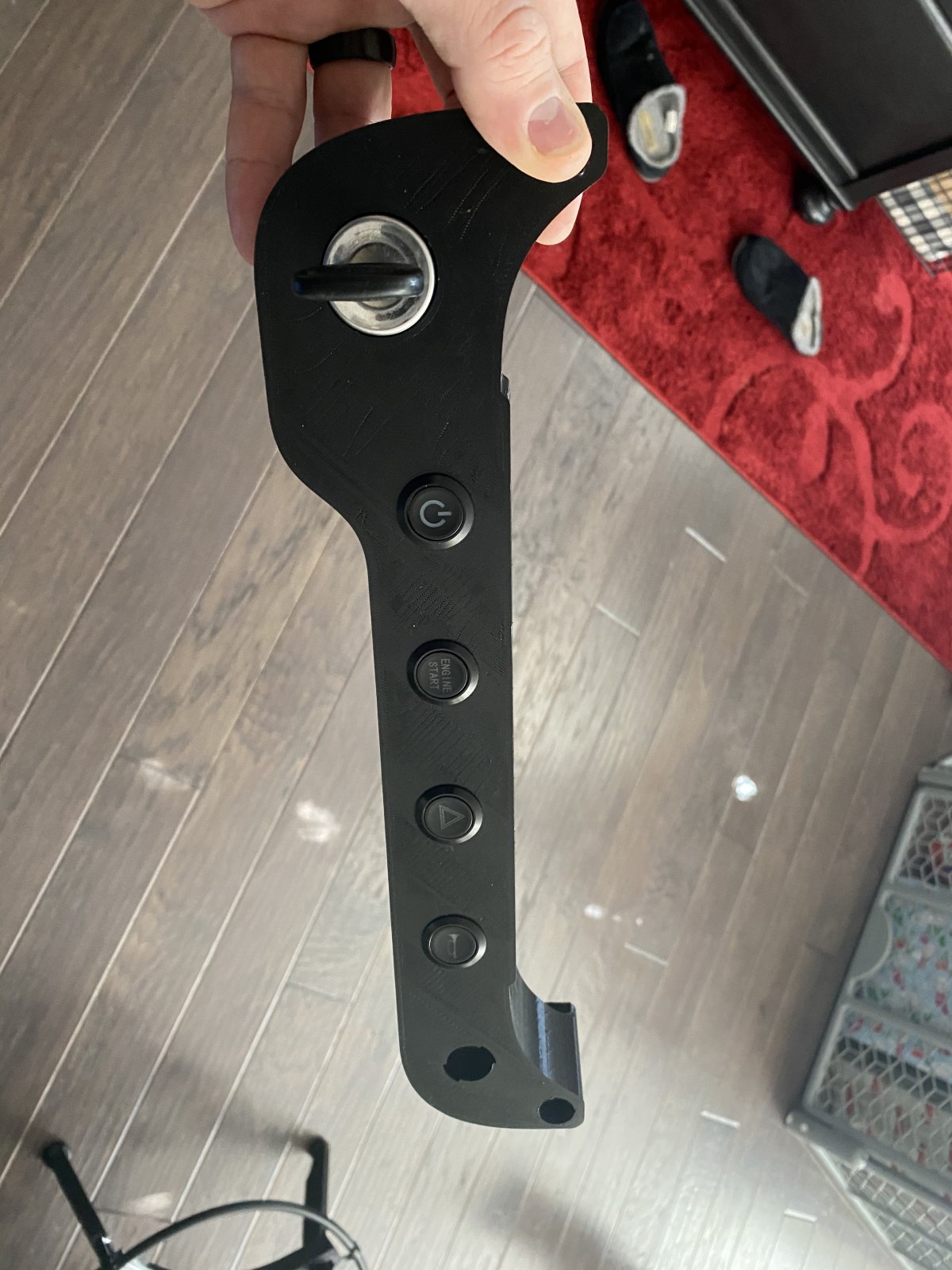

Here tis (re-uploaded model into original post)
It has
  • Four 19mm buttons (For example, I'm going with ON/OFF, ENGINE START, HAZARD, HORN)
  • ALS
  • LNF ignition cylinder and VATS sensor
  • The key itself is only used to satisfy VATs and is not functional as a keyed ignition source without modification
I have not test this on any other cobalt models, and I only have access to a LNF models so I don't know if the key cylinder changes between models or if it works for non-vats stuff. It's a very snug fit and I spent a boat load of time making the lock cylinder smooth af. Pretty happy with it, I should have my buttons this weekend so I can finally take pics of it fully assembled (been waiting for over a month from China order on some custom buttons)
I am using BradR's ignition bypass to make this 100%. He only made a few of them so YMMV in using this model.

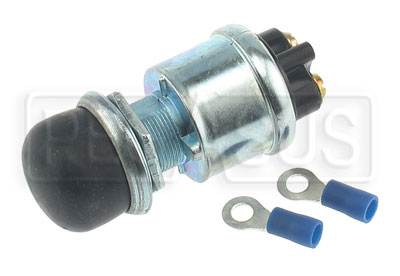

I was thinking I'd put a large push button where the key would go in that panel since VATS has been disabled. Would that work with the current design of the hole for the key shaft?
Mayor West
Not really, I would need to take some material out. If you have an idea of what size button you want to put in there I could remove some stuff.
Fozda
I was thinking I'd use this Longacre push button. We used one in our ChopTop RV and it held up very nicely in the elements. It says the dimensions are "Mounts in a 5/8" diameter hole. The rubber cover has a 1.1" OD metal ring at the base. Requires 1 3/4" clearance behind the dash panel. Projects 7/8" from the front of the panel. Maximum OD of the body is 1 3/16".
