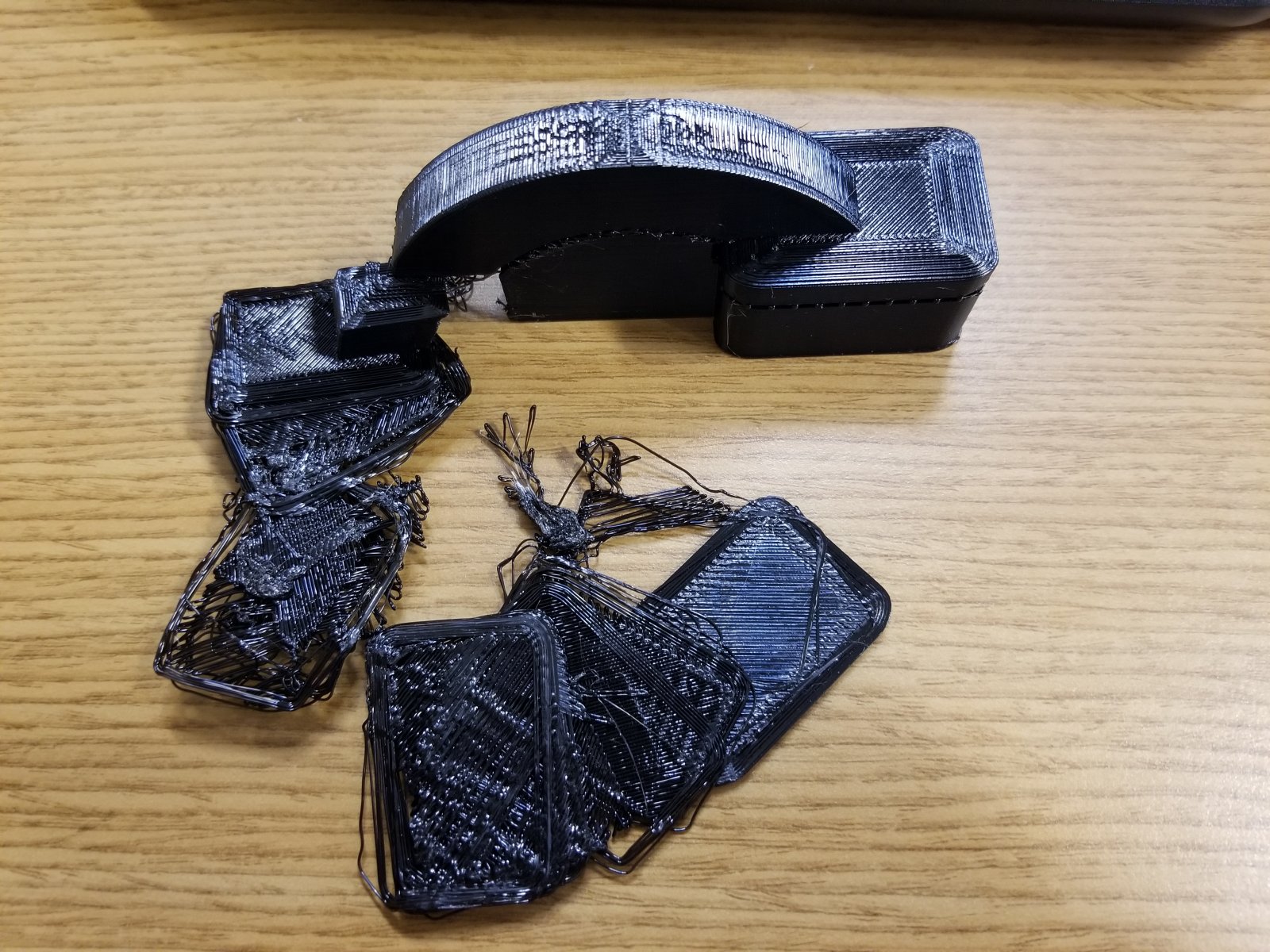

Glue stick on the print bed assists with success rates, unlike this one I did. Lol

With PETG, I'm using a glass bed. Tried the glass being extremely clean, glass with hairspray, glass with glue stick and would have poor adhesion issues like the picture. Especially with parts that have large surfaces against the build plate. (Corners lifting)
Currently using hairspray and elmers glue stick, which is readily available, with great success. Sometimes too much success, meaning it can be difficult to remove from the glass.
