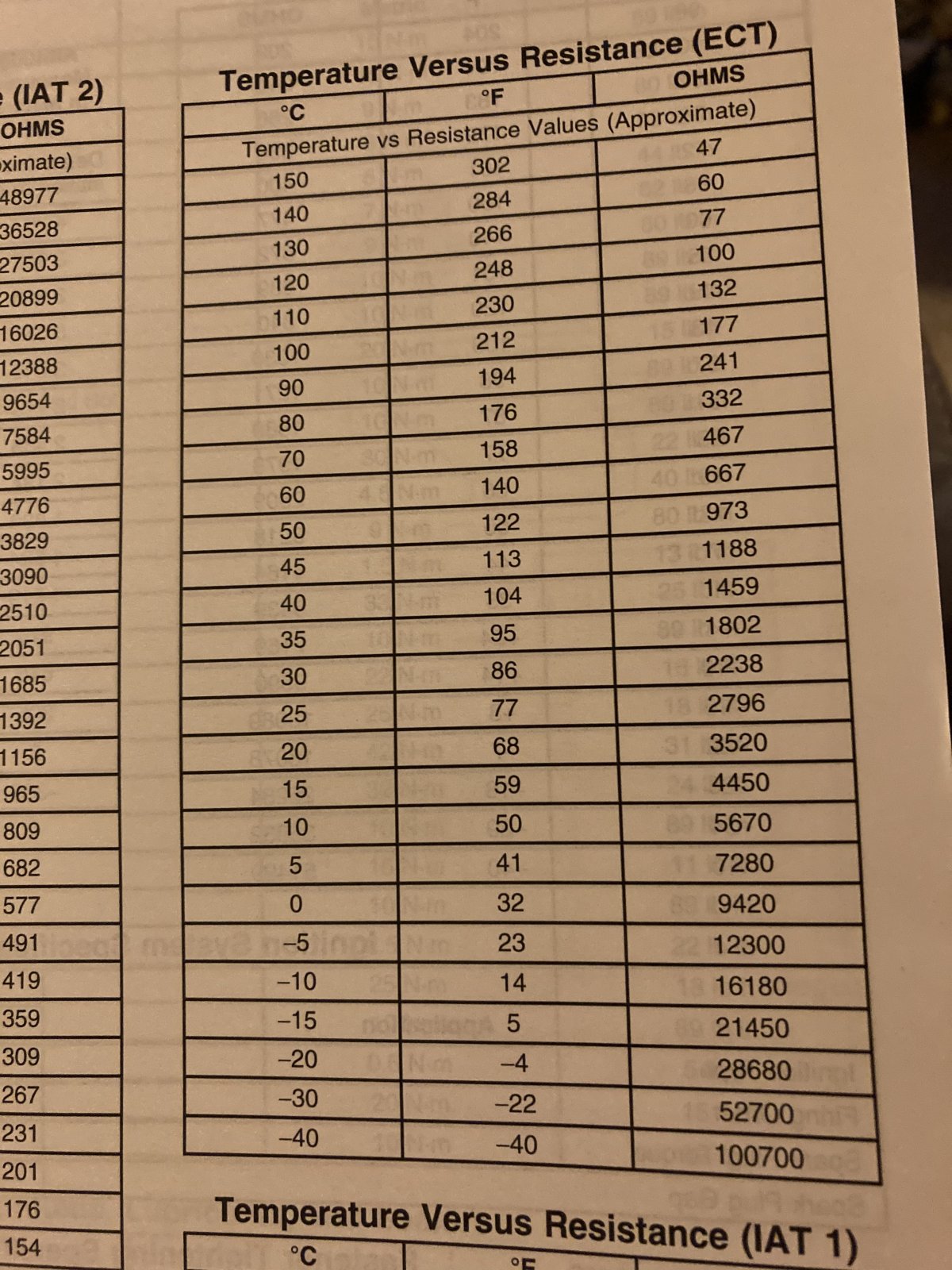

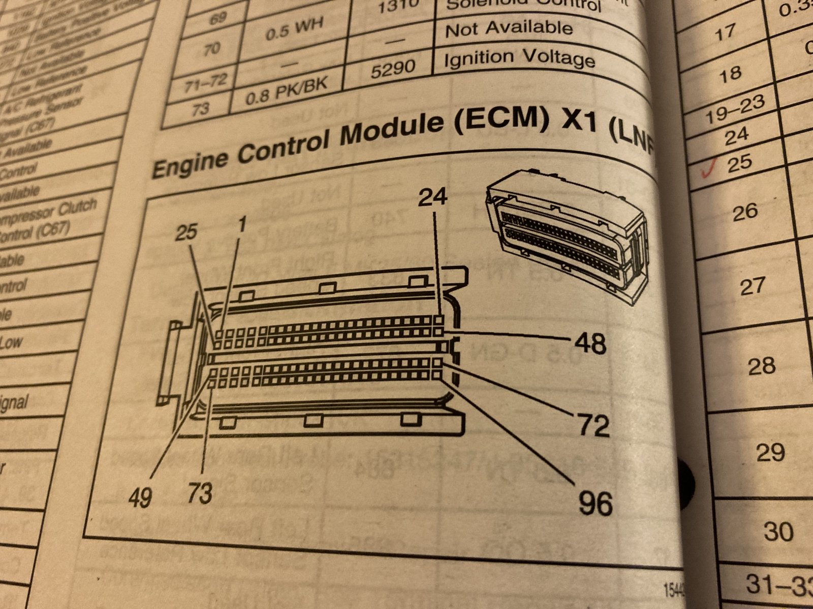

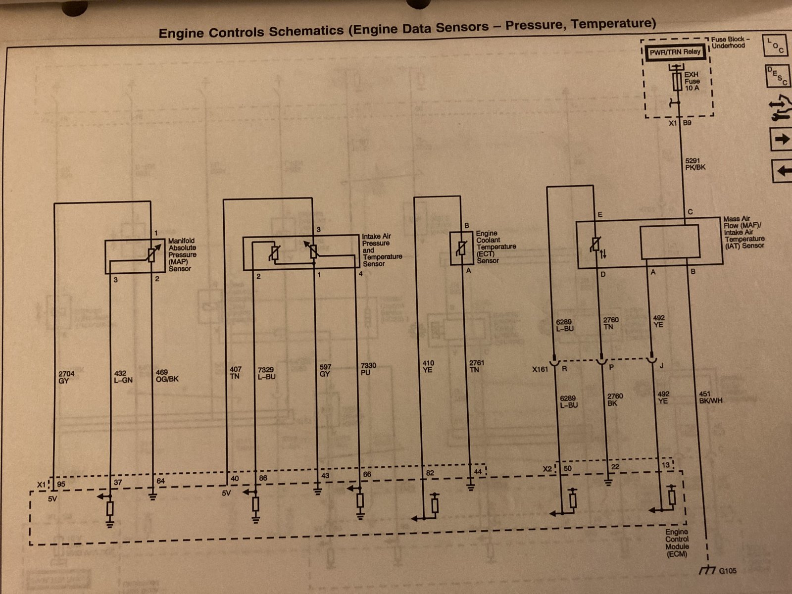

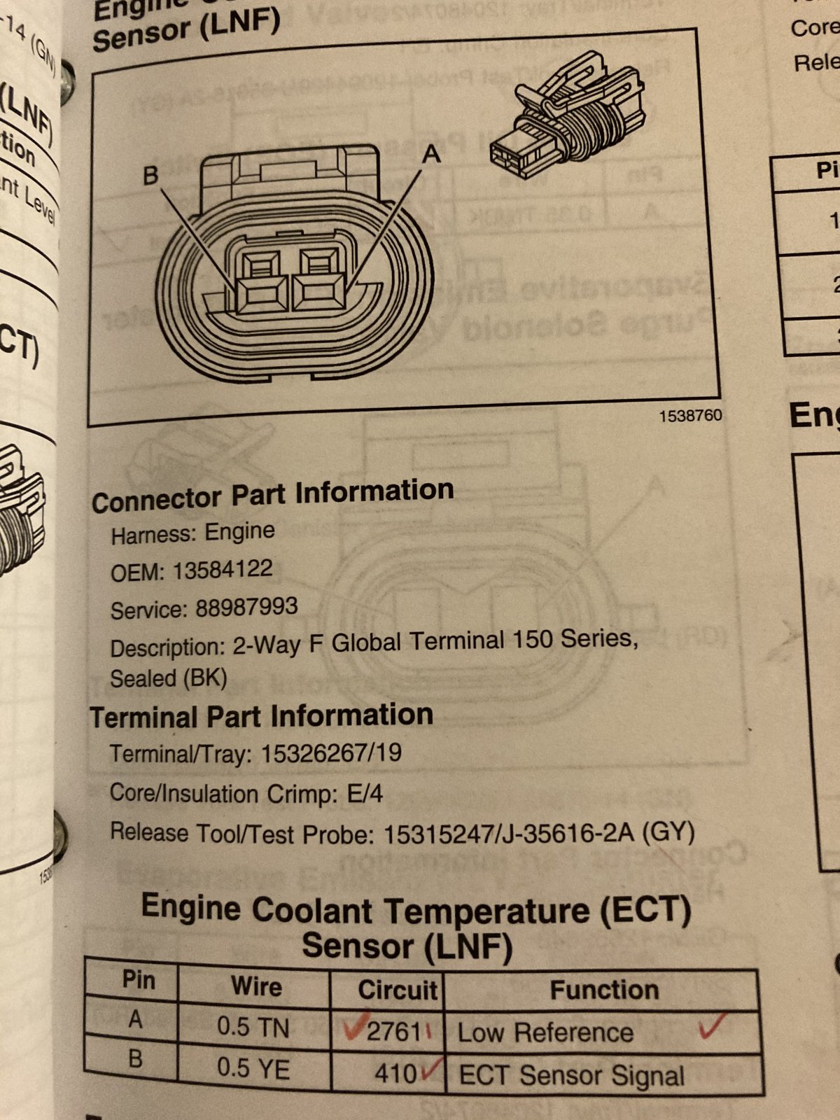

I get P0119 and P0128. But the engine and sensors are all brand new. Even the fuse box is new. I would say my wiring is probably goofed up somewhere. I don’t really have the expertise to know what to look for.
Since the first code is an intermittent signal, let’s start with the wiring diagram and few checks. Inspect the wiring from the sensor to the ECM. Especially the connector on the sensor. If that checks out good check the resistance across the sensor to the table included. If that checks, you should get pretty close to the same readings at the ECM connector. If I need to walk you through it a little more let me know.
