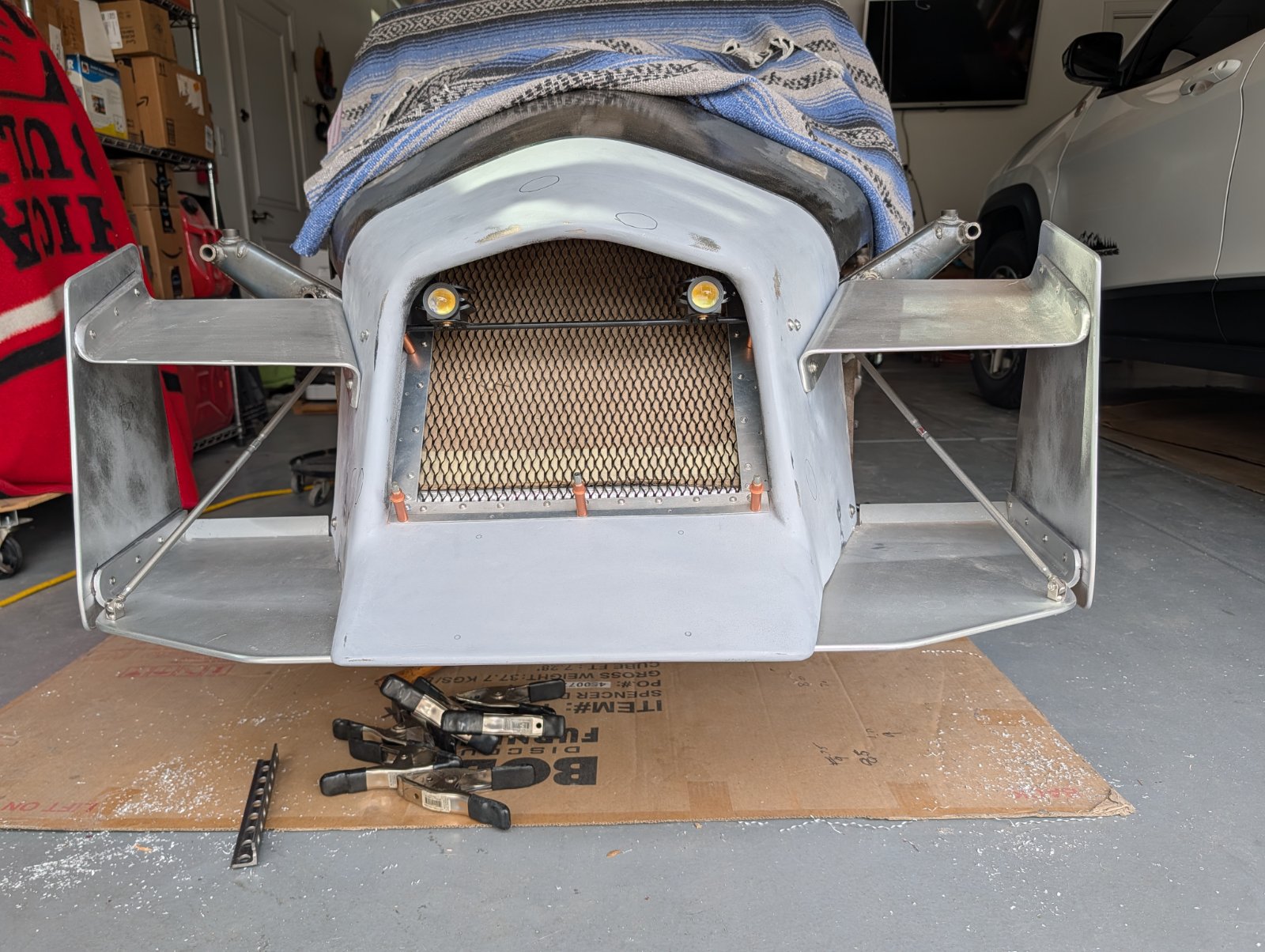

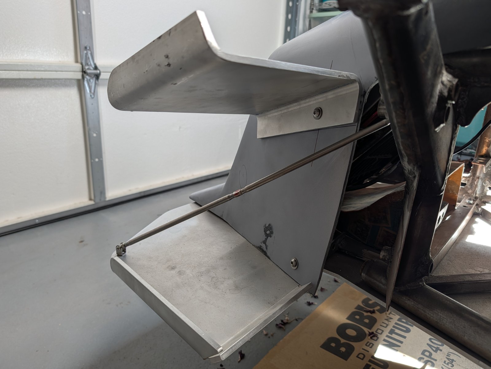

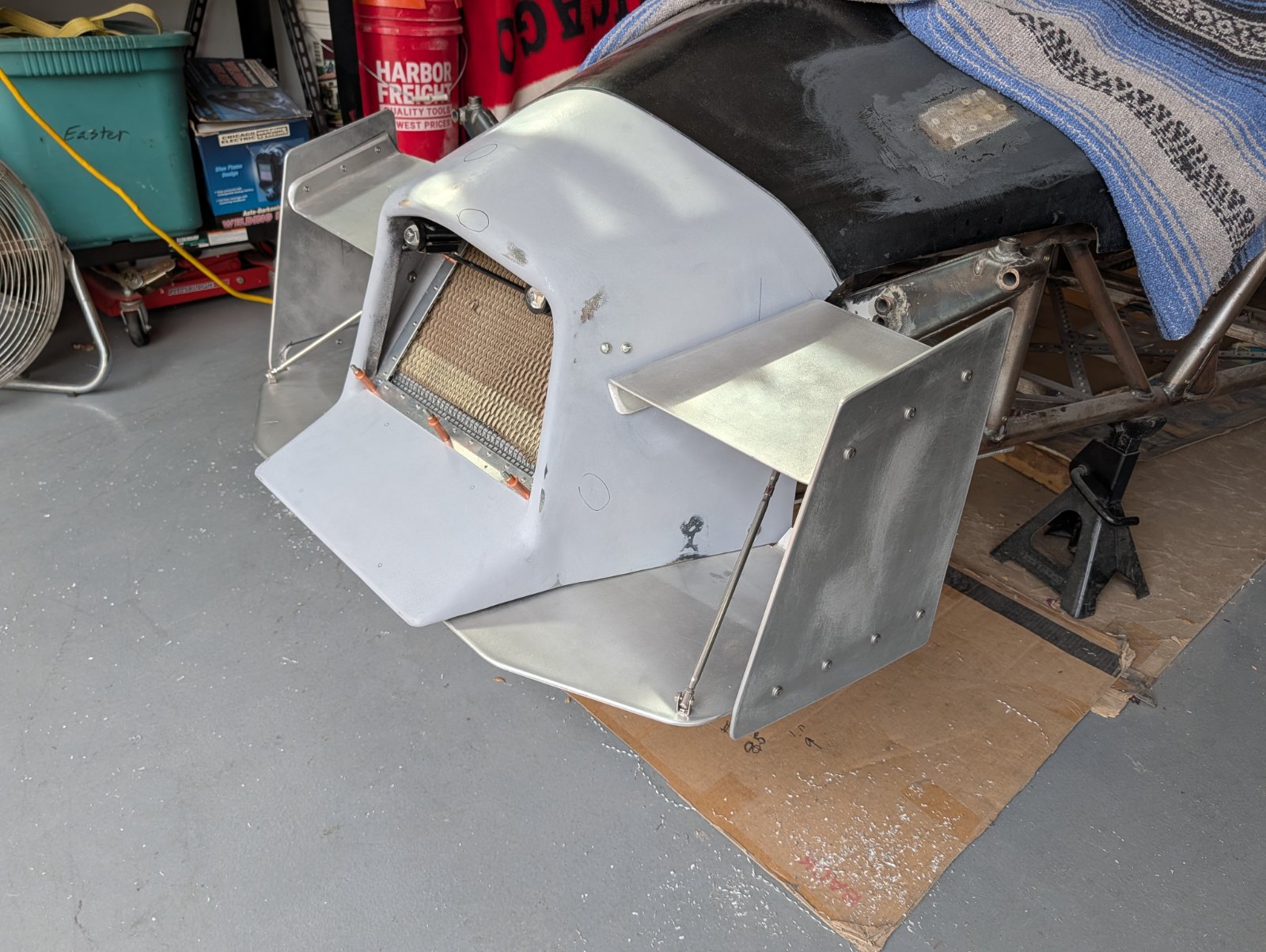

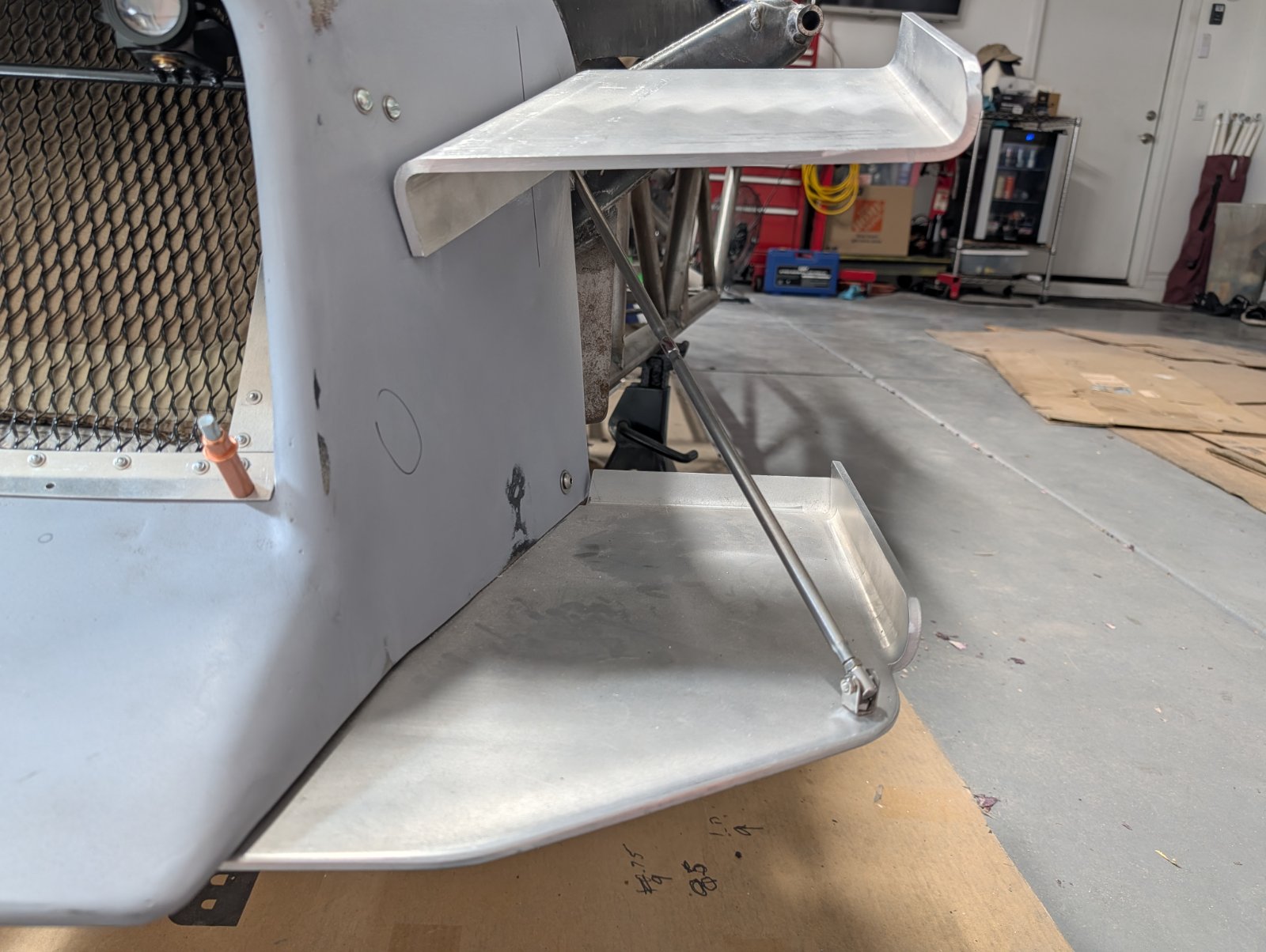

Ok, the project is far enough along that I can take the blanket off.

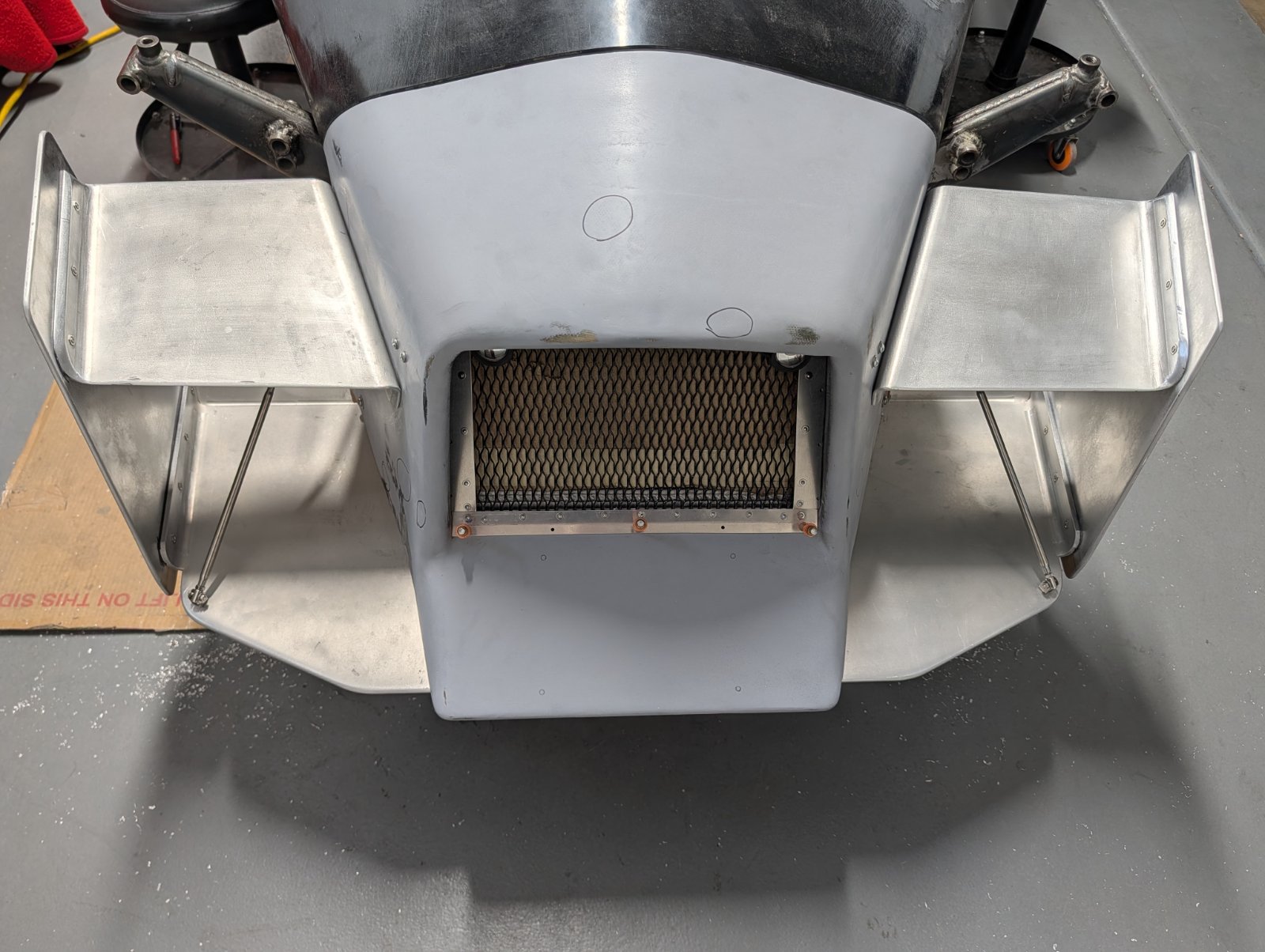

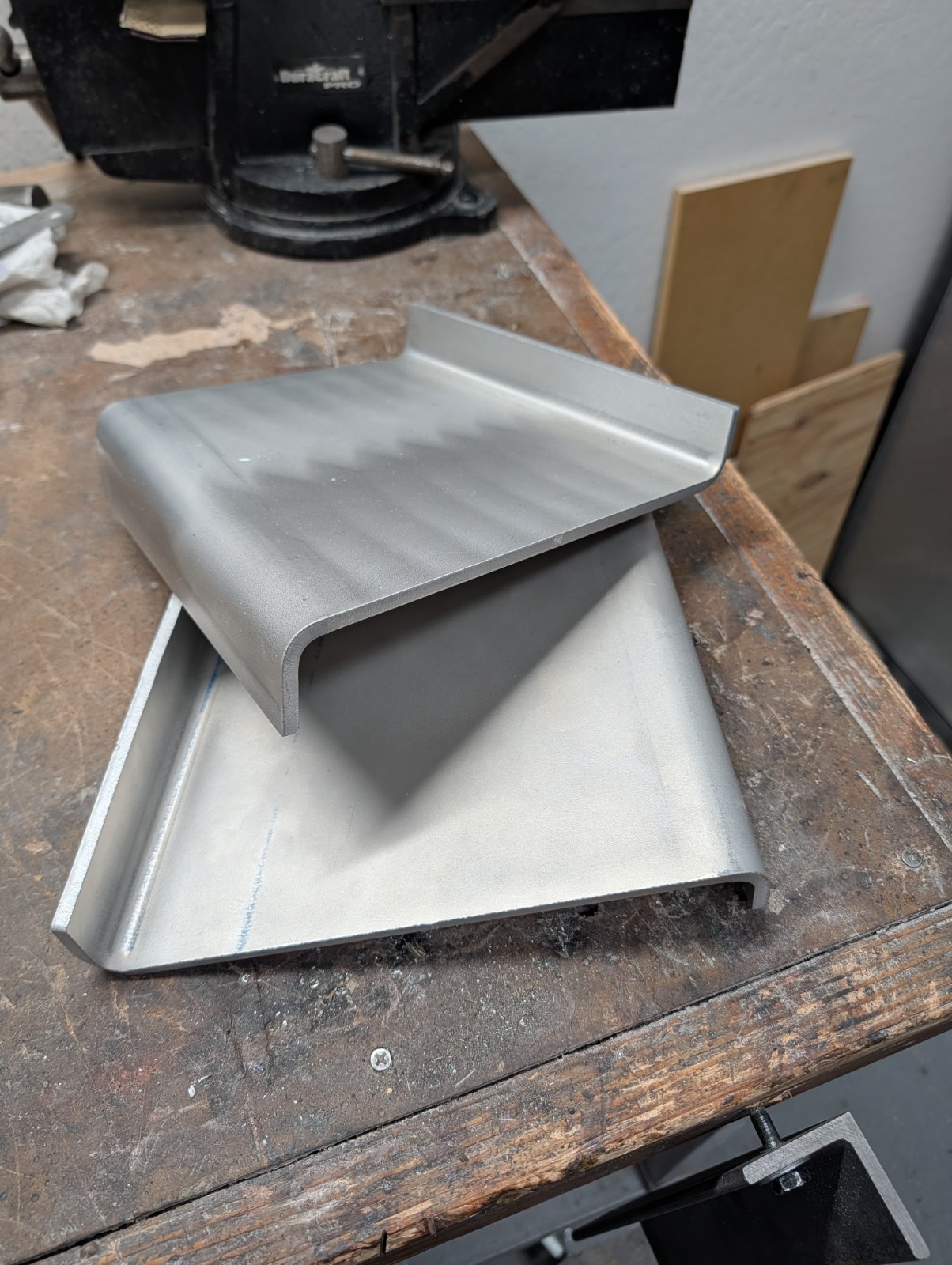

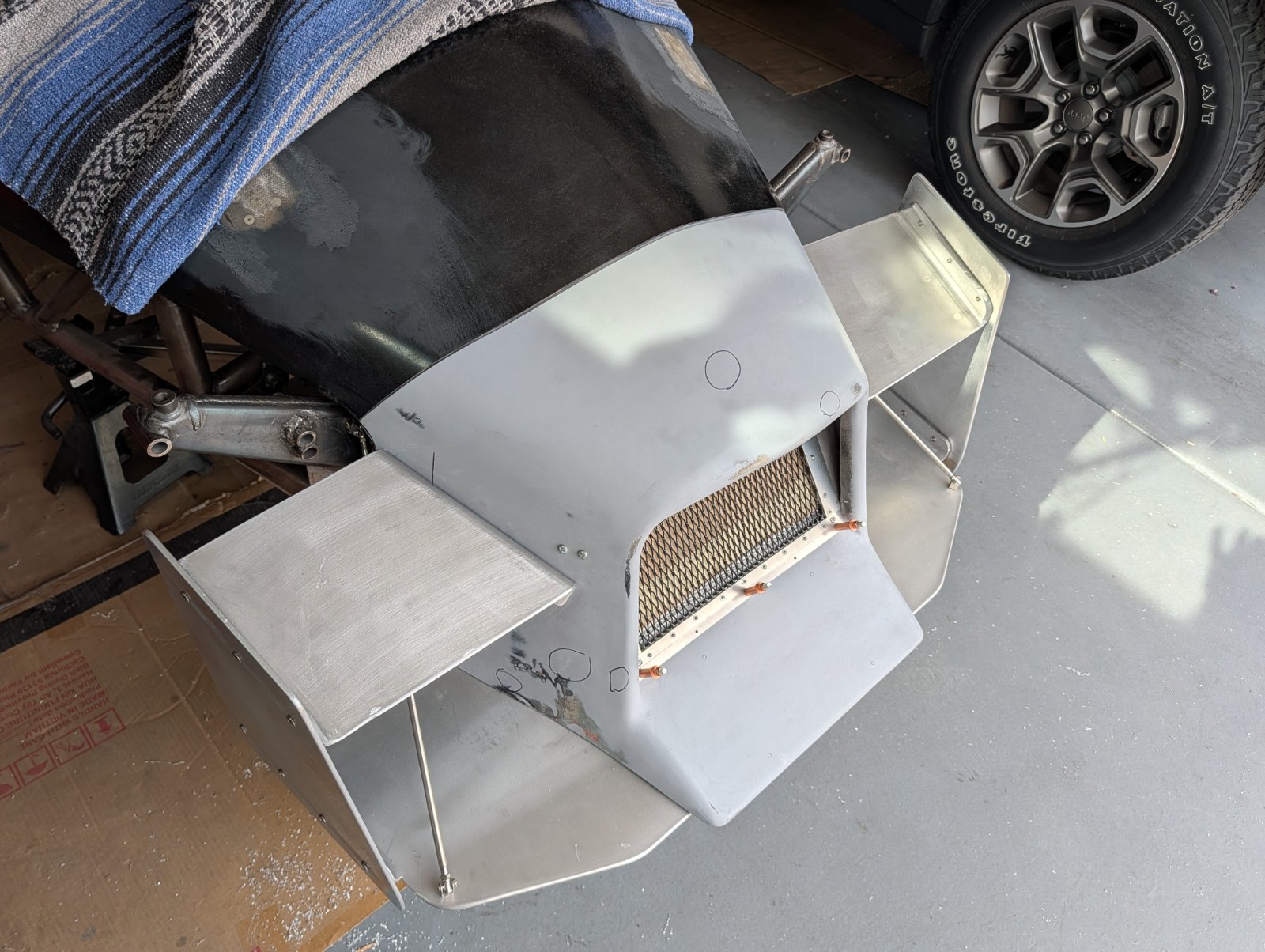

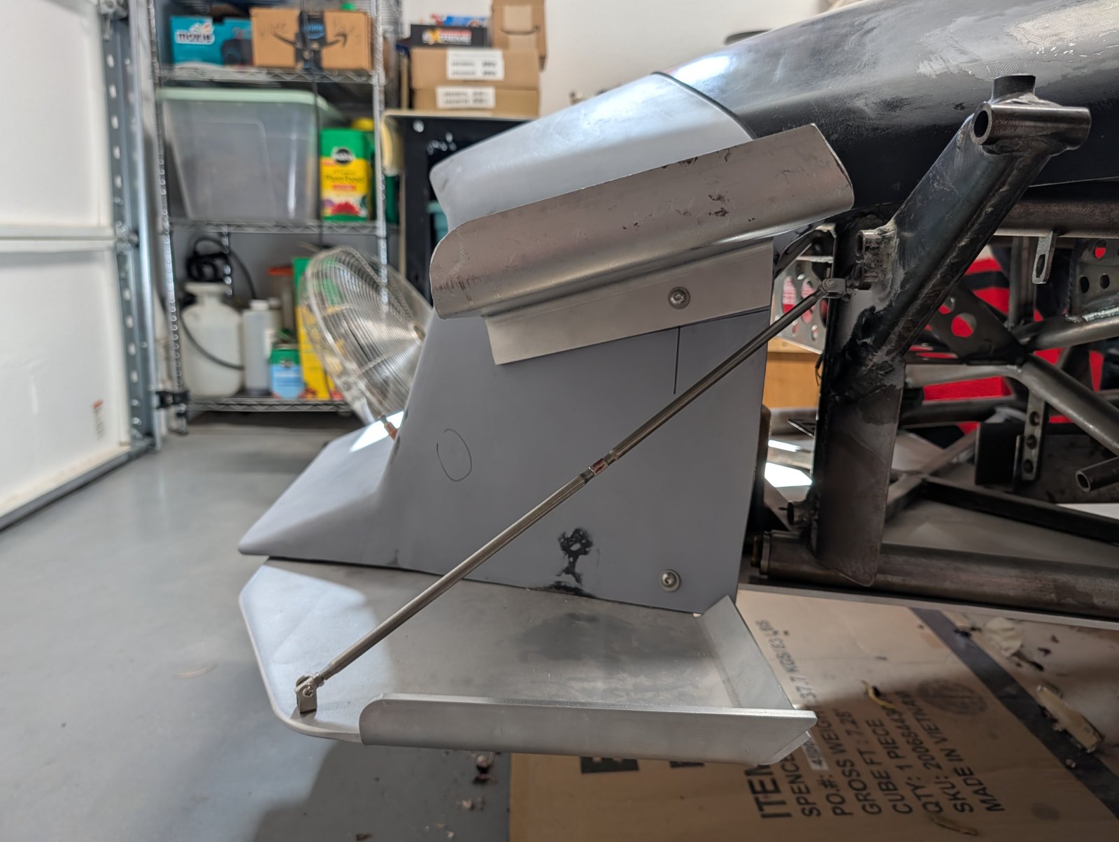

The canards are 1/4 inch aluminum plate with bends and angles on the inside edges to align with the compound angle of the side of the nose. They are the same width as the sides of the splitter. The canards and side plates bolt to the splitter, in case removal or repairs are needed.
