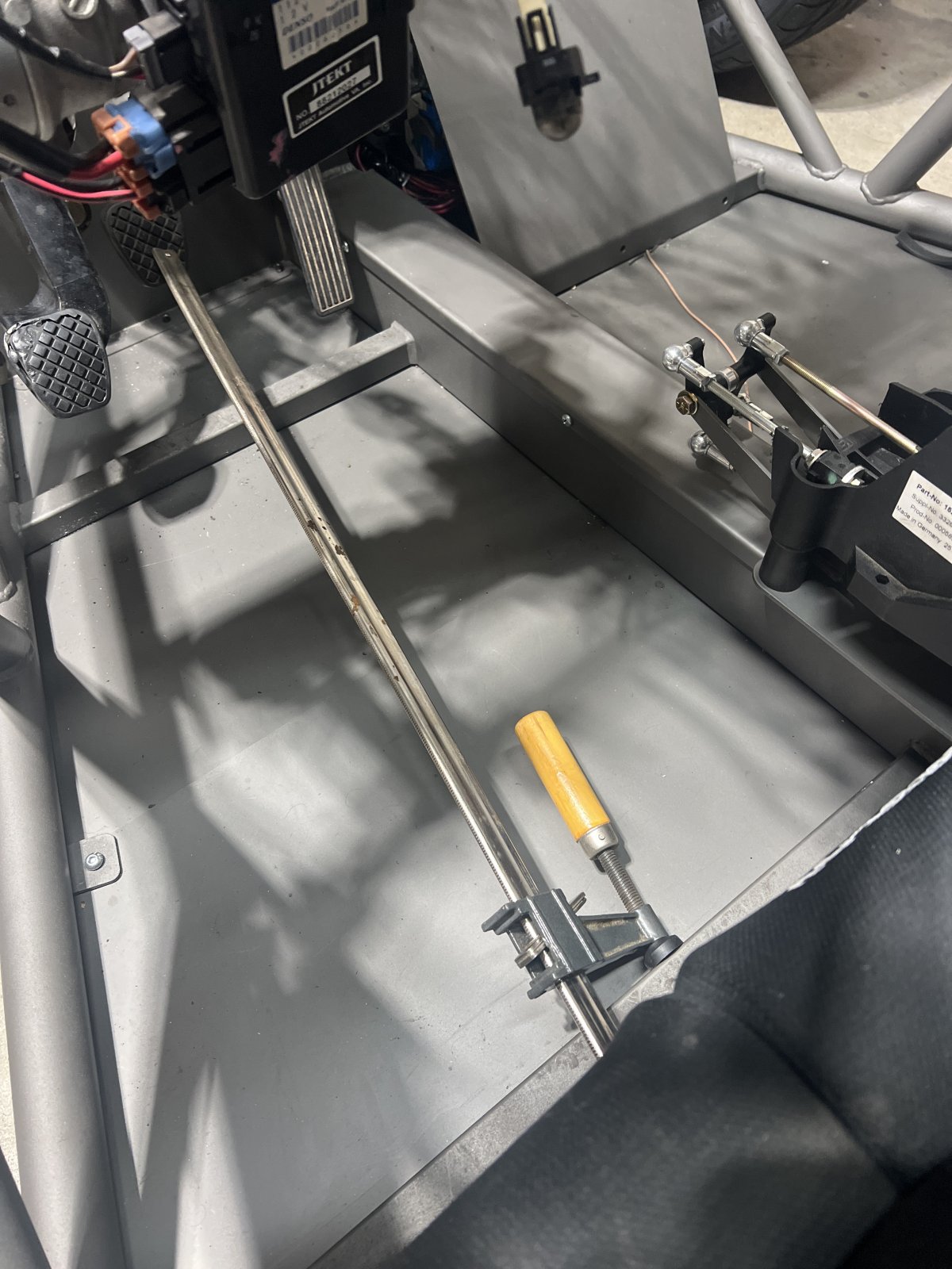

You must forgive my brake bleeding efforts as well Iam using a wood workers clamp. No secondary person to pump brakes and hold or brake bleeder.
I'll second the pressure bleeder. I can do all 4 brakes in 10 minutes with it, and the clutch line from the master to the bleeder. Nothing will get the clutch slave without pumping, but the pressure bleeder keeps the clutch line packed with fluid during the process. Vacuum bleeding works but I don't think it's as easy.
