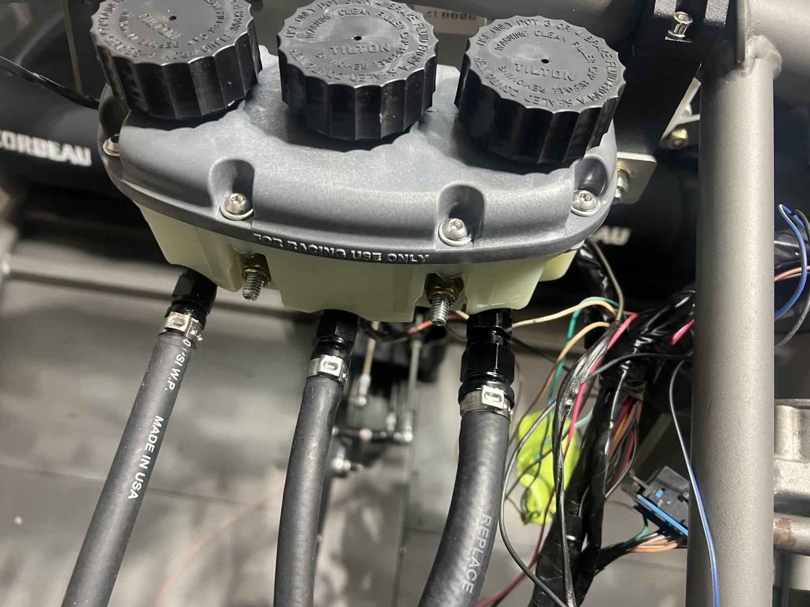

So I used a bleeder bottle same thing no rear brakes and fluid starts squirting from rear reservoir to front. I replaced master with a dorman it was even worse . The three chamber Tilton reservoir made diagnosis easy since the brake front and rear brake system is separated individual reservoir. Talked with Chevrolet parts department the ac delco master cylinder is discontinued.anyone have # off the Wilwood master cylinder? What’s required pedals as well?
I also use the Tilton 3 reservoir setup, which has been great with my Cobalt donor master cylinder.

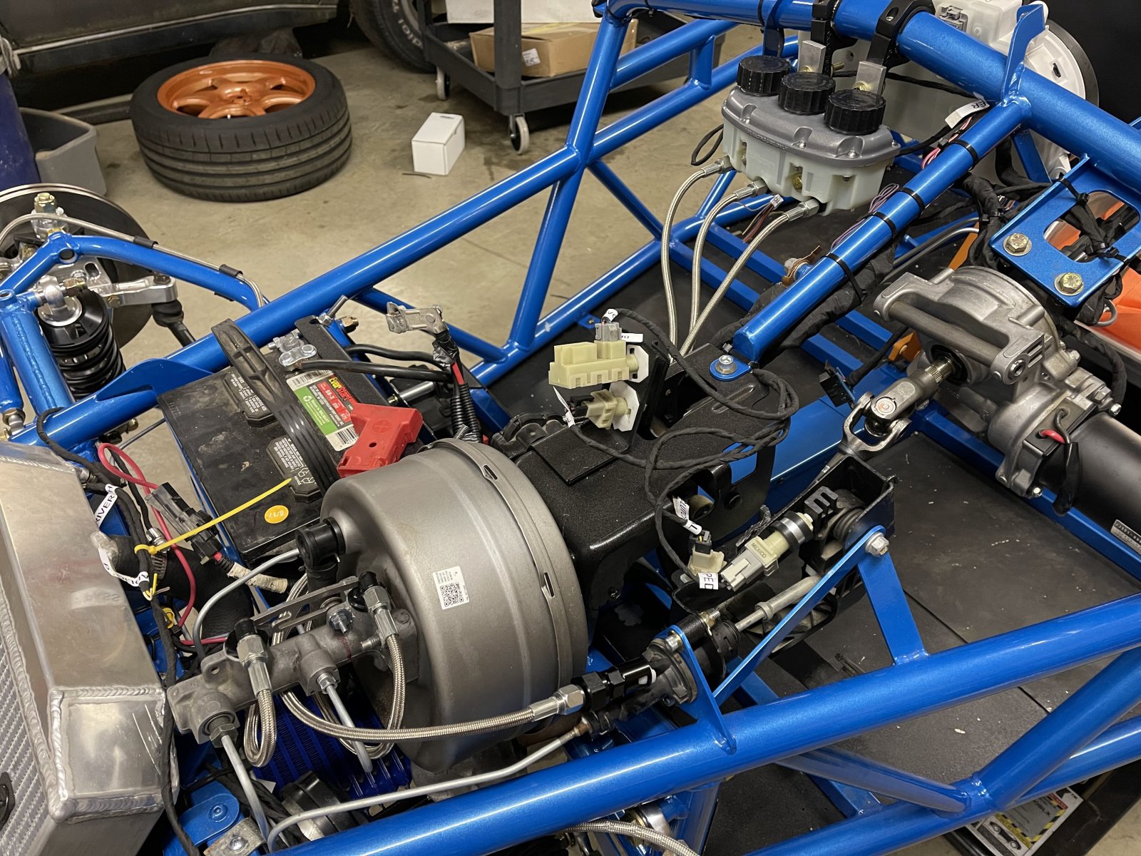

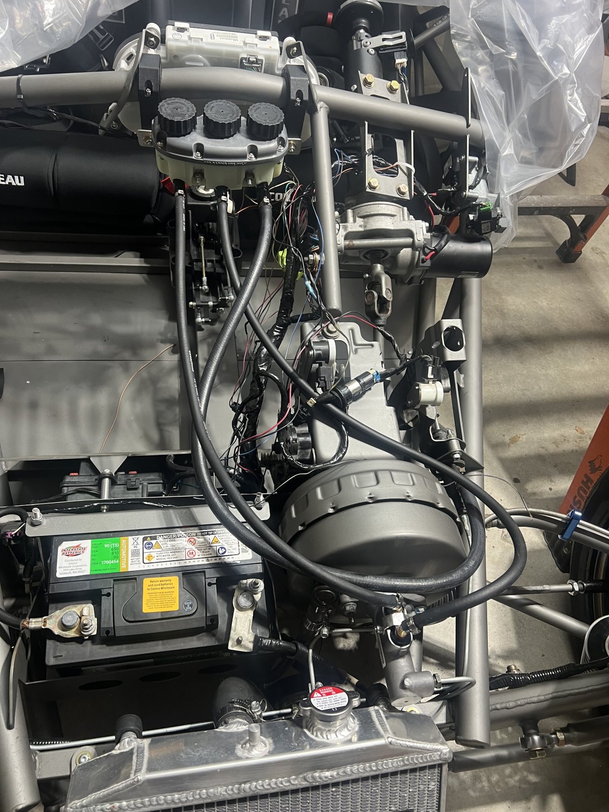

How'd you make that work out?

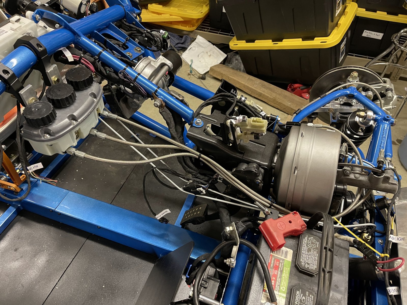

Went with Tilton 72-578, with the -4AN fittings on the front. Couple bar clamps, and used some aluminum flat stock to make a mount (and even mounted a battery disconnect behind it, sitting right behind the dash). Pre-made -4AN lines back to the brake and clutch master cylinders with appropriate fittings. Hopefully these 2 photos show everything well enough.

D&dgoblin69
Here my Tilton used aluminum flat stock with a couple of utv clamps and an4 fitting with barbed end and one an6 for the clutch. Picked up ear clamps at HarborFreight and epdm 1/4 and 3/8 at tractor supply. You will need one special fitting an4 to an6 to fit the clutch line

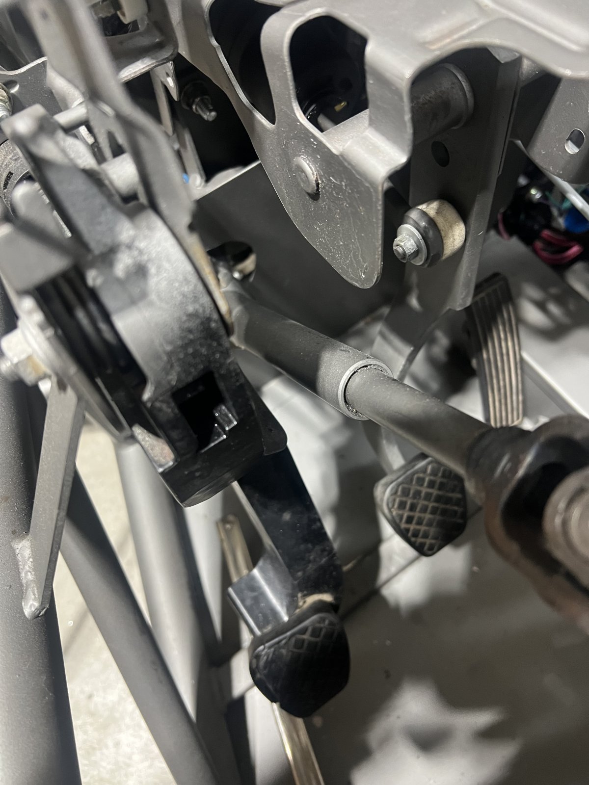

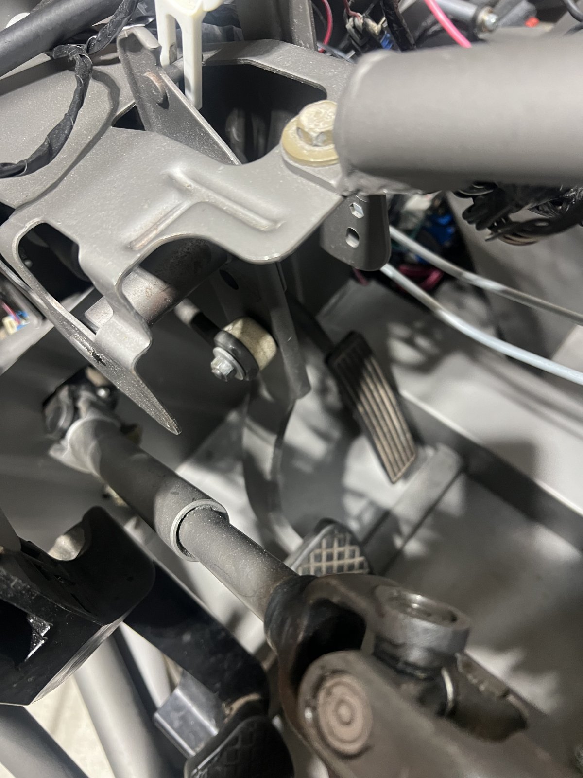

Have you made sure the master is completely retracted when in the rest position? Take your hand and pull up (toward you) on the lever, to make sure it’s all the way back. I remember a few having this problem that the lever sticks or in a bind and pushed just a little on the master making the rear impossible to get flow. Hell, loosen the master from the booster to see if anything changes.

Calipers from the donor I’ll text fit them tonight. I talked with Tilton reservoir they said each of the 3 chambers are separated so there’s no way for fluid to cross over so when I bled the rears and it squirts from the front breather cap that means it’s bypassing the master cylinder.

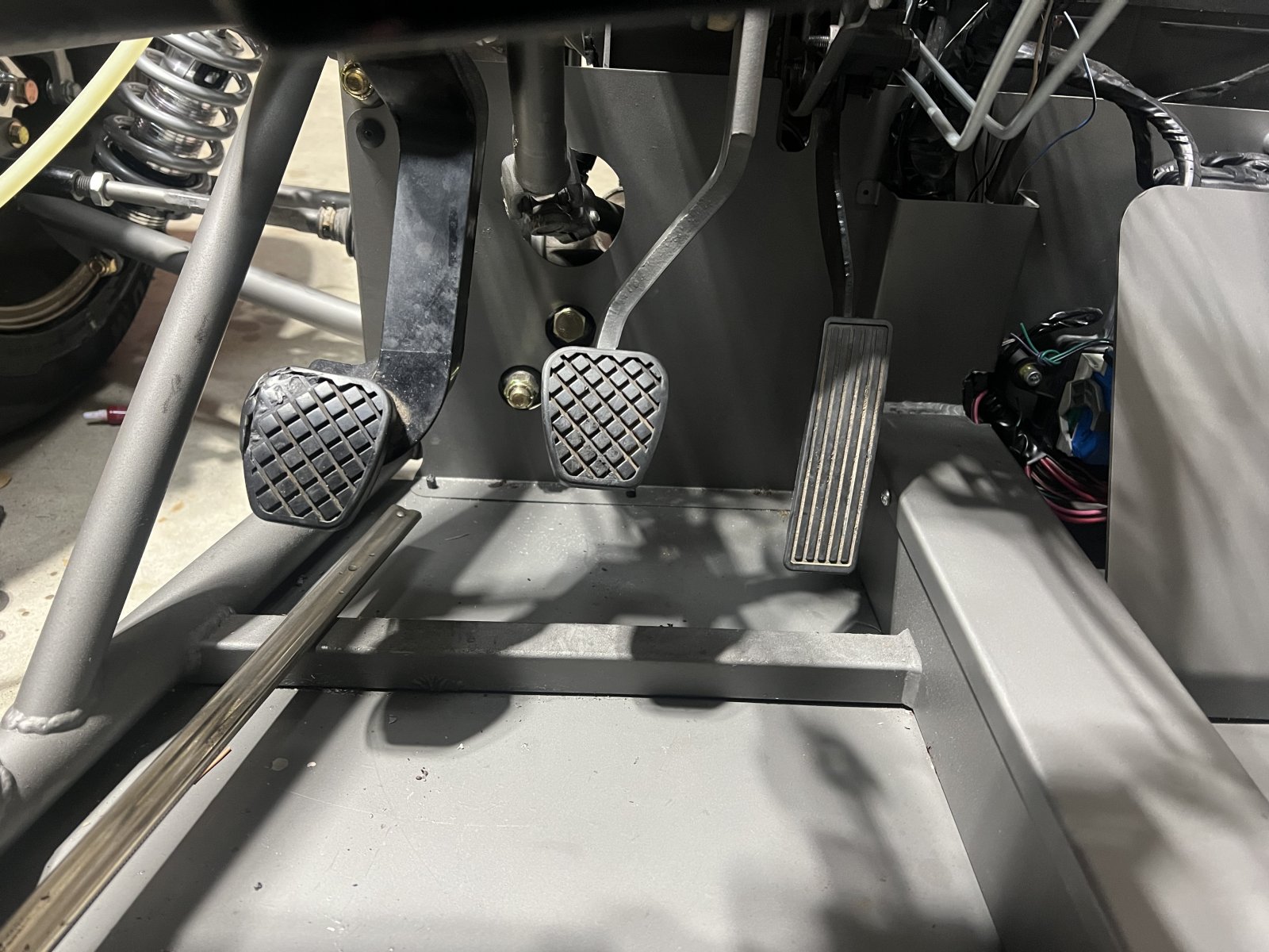

I had an issue bleeding my rear brakes too, I don't remember exactly how it unfolded but I think my issue was a wire that I didn't realize was preventing the pedal from fully returning. Pedal return is a good thing to double check.
D&dgoblin69

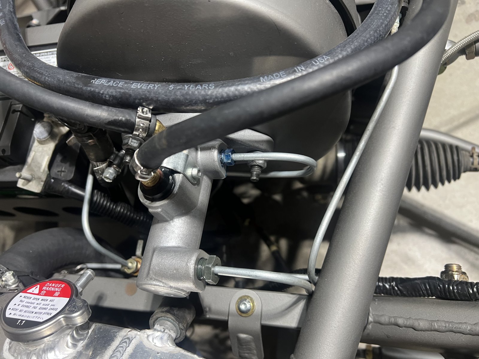

I went to check pedal return yes it returns with what feels like spring pressure. Pedals good. I have a brand new bad leaking dorman master cylinder. I went back out used my had on the brake pedal and brake fluid squirts out the front brakes.should get a brake best orielly master cylinder this weekend. I got the donor calipers ready

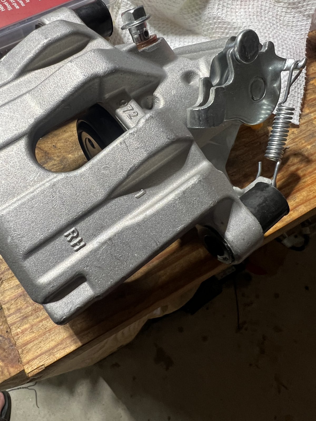

Ok I got the rear calipers supplied by dfkit to work. I forgot what I did lol no really if anyone ever does what I did then god forgive them.The brake caliper has a stamp rh in picture means right side and the other caliper has a lh for left hand. But since they’re built in China and they drive on the wrong side of the road it makes sense . This left an air bubble that could not escape because the bleeder was facing down. Common sense never kicked in.if you get the solstice parking brake kit they’re actually pretty bad ass when they’re installed properly. So if you see lh left hand side being drivers side you may need to put it on the passenger side and vice verse.
