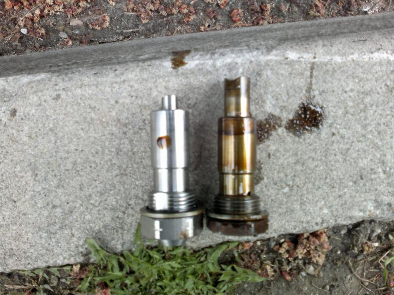

How can I tell whether what is there is the updated tensioner or the "old" tensioner?
How would I know if the Timing Guide bolt needs to be replaced?
Rttoys explained the Dorman bolt.
In the below pic, the old tensioner is on the right, and needs to be replaced with the new tensioner on the left. They can easily be differentiated by the exposed hex-head end on them. The old one is flat, while the new one is thicker and has a raised part in the middle.
If you need a better reason than the urging of a bunch of forum strangers to replace the two items, know that I had to buy two donor cars for my Goblin project, and check out the pics in these posts, from my first donor's engine:

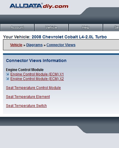

Perhaps I am a nincompoop, but my AllDataDIY login does not show me any connectors for my 08 SS/TC donor, except ECM1 and ECM2. Nothing about the BCM, or anything else. The wiring diagrams are there, so I've made due.
I've just signed up for my 09 SS/TC and I have all the BCM/ECM layouts.
it's in Diagrams > Connector Views > Body Control Module

Oh ok, yeah that's not good. I have mine for 09 SS/TC if you'd like to take a look but it's probably a lil different. Check my signature link for the BCM diagrams I have. The folder "09 SS/TC Pinout" is what you may want to check out.
