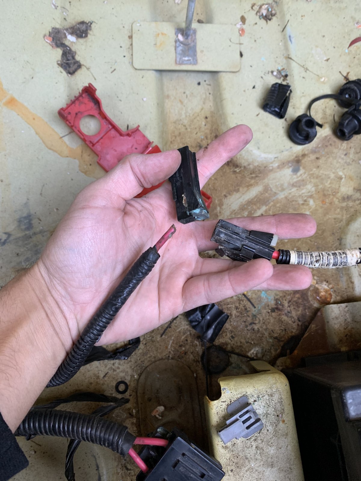

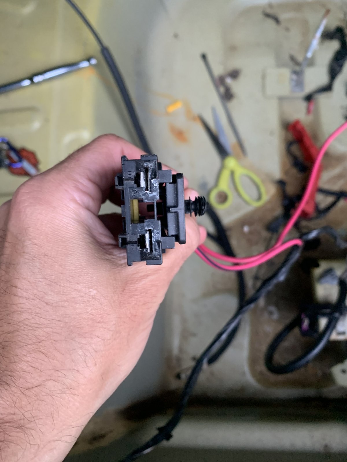

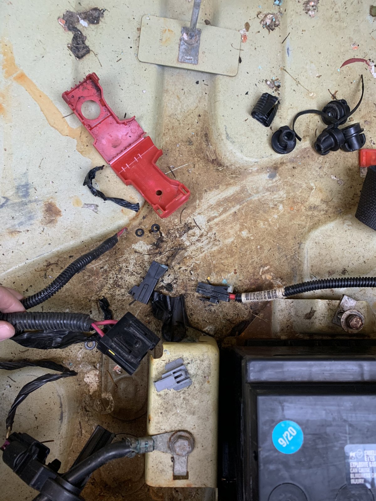

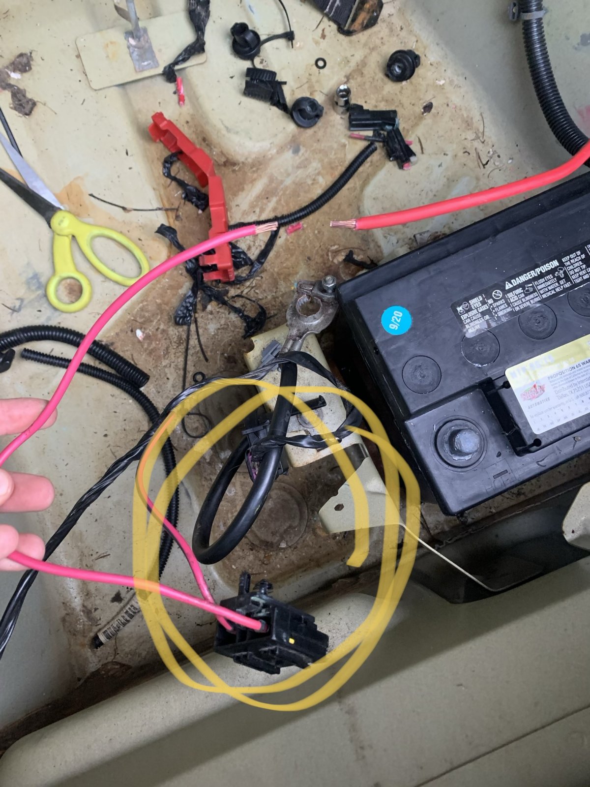

when looking around trunk this morning I noticed a connector was corotid off.
With this connector off there will be no power to the computer to start the car correct ?

Also what is this connector and why is it not connected to anything ?

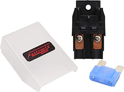

You know the pos cable needs an end and connected to pos terminal. That other 2 prong connector needs a 50 or 60amp (can’t remember exact) maxi fuse in it, from connector to connector. Mine was all messed up too, so I don’t have a pic of the stock setup.
I ended up buying this to replace the messed up wiring/fuse holder
