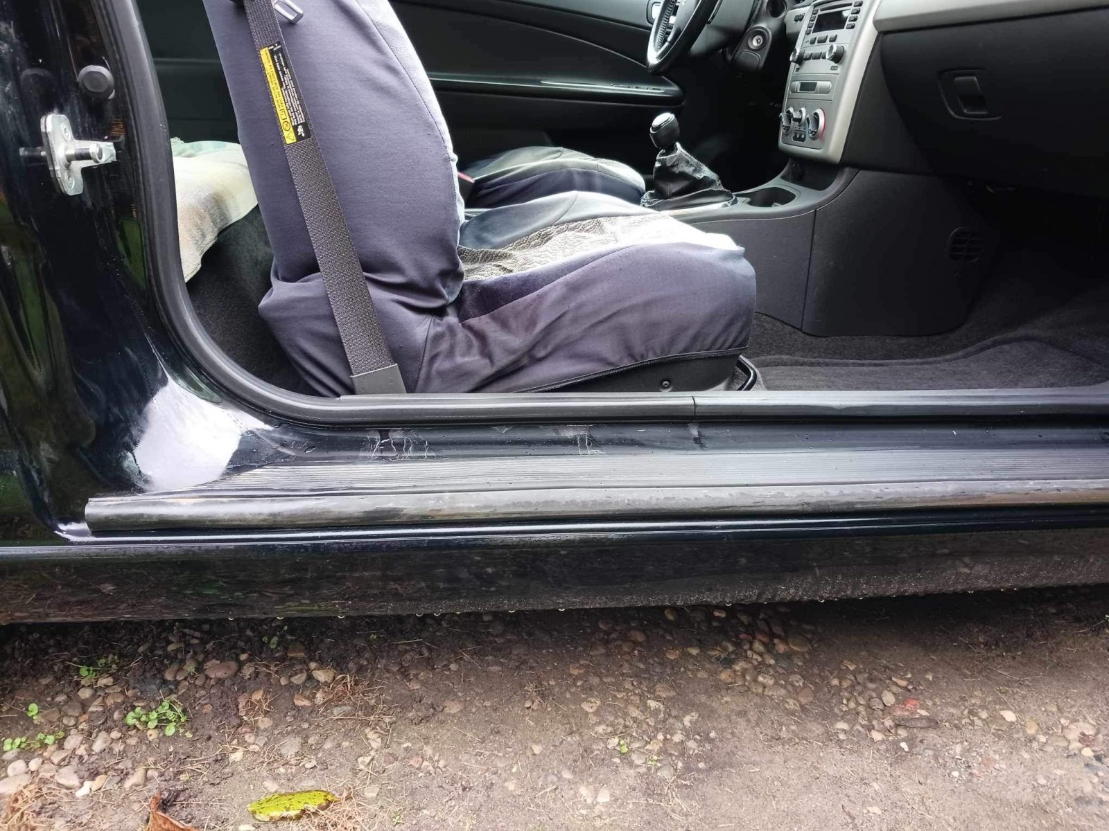

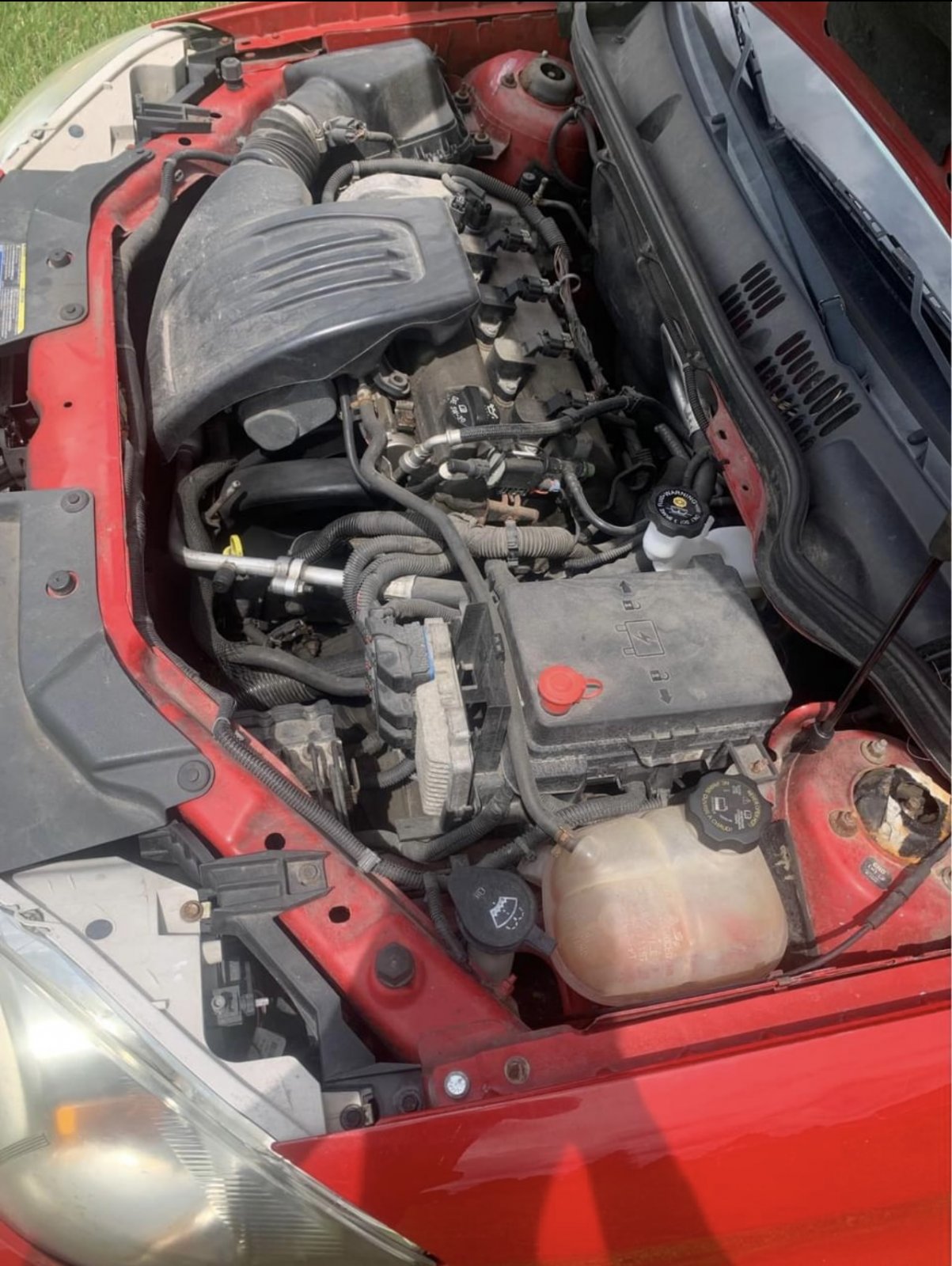

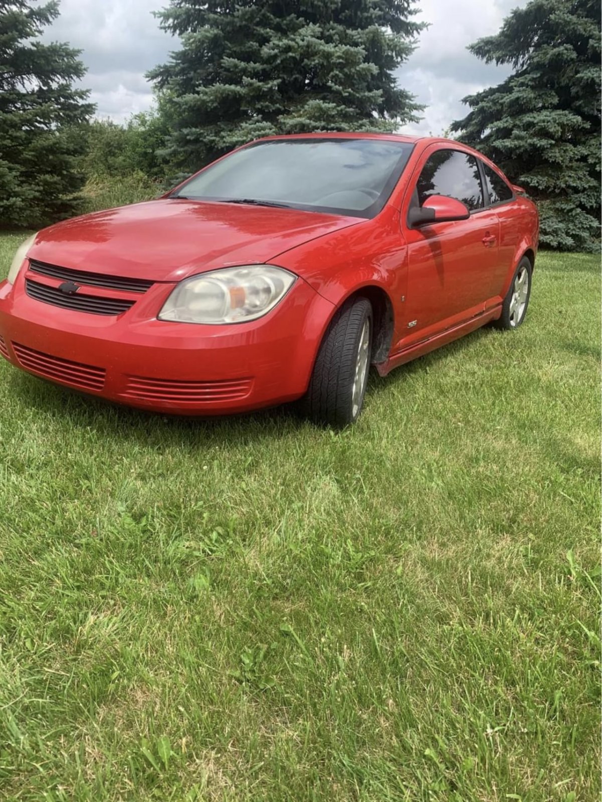

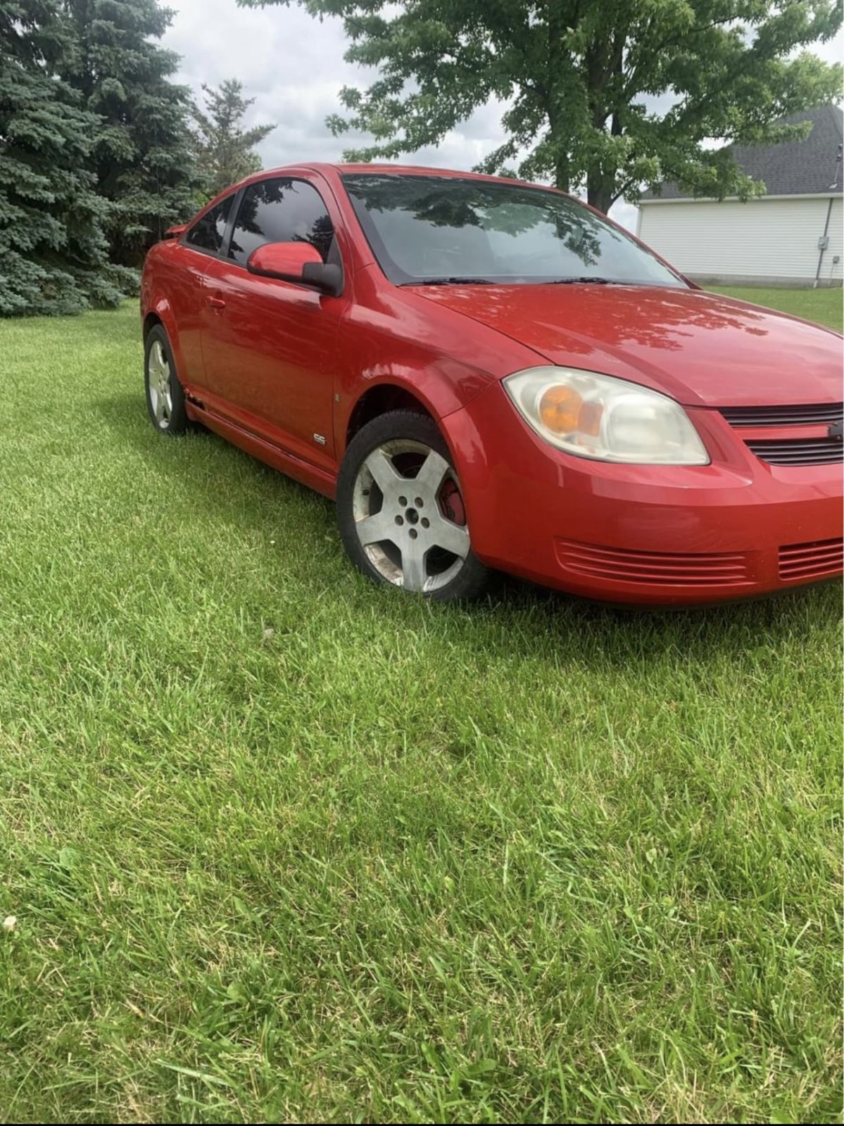

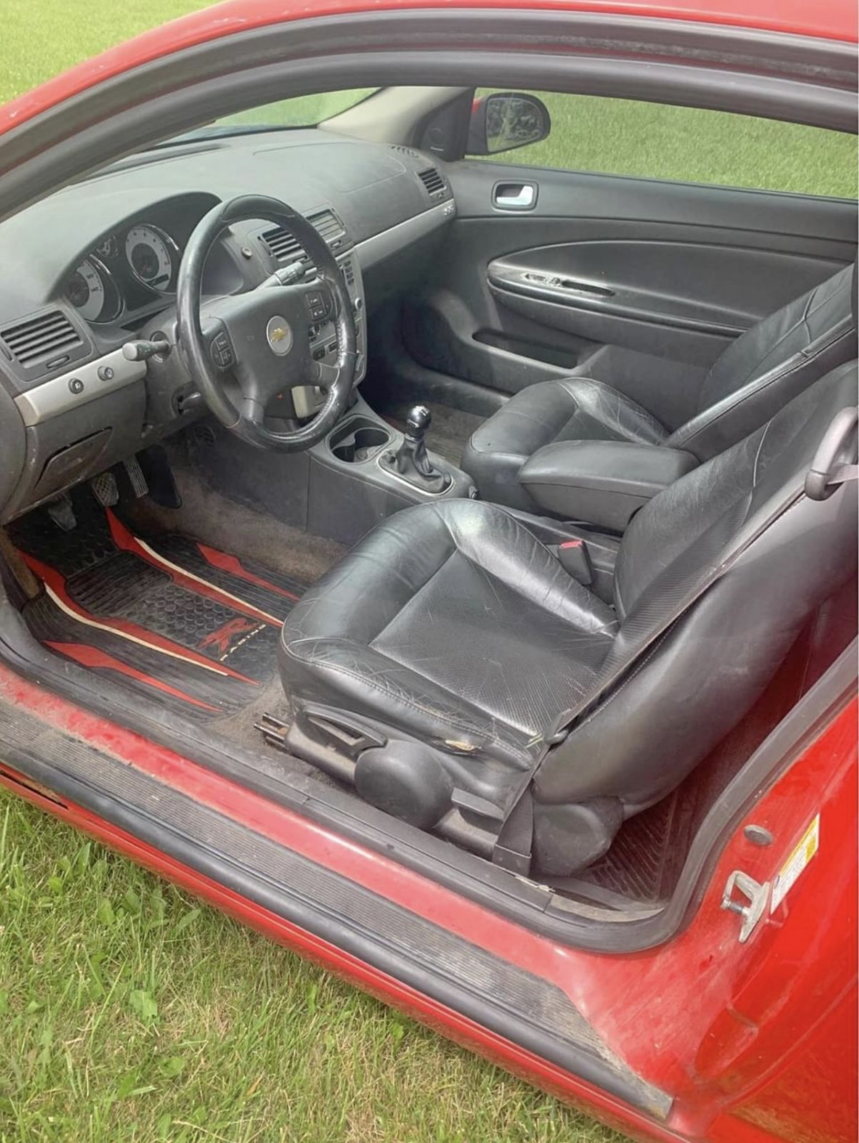

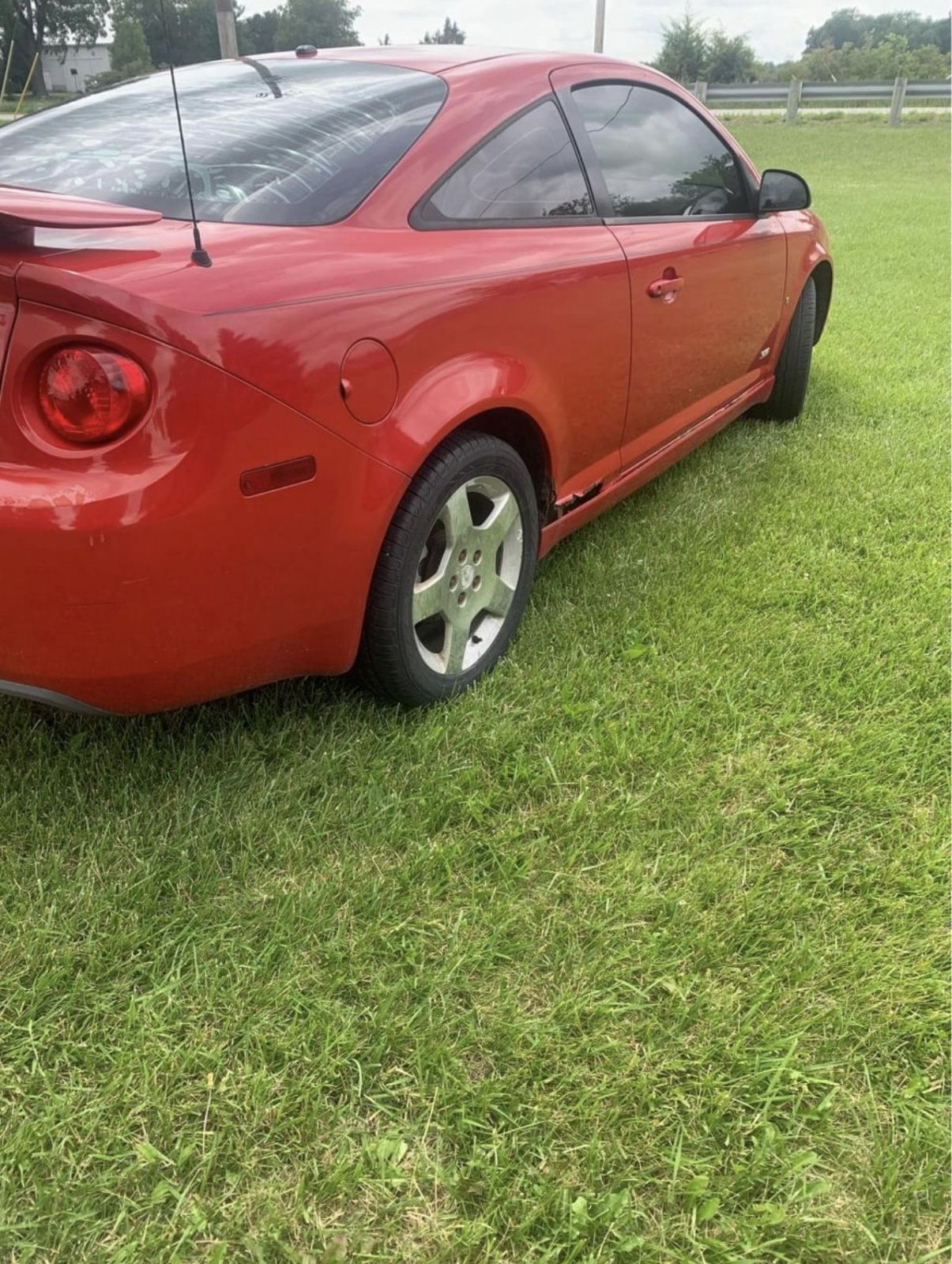

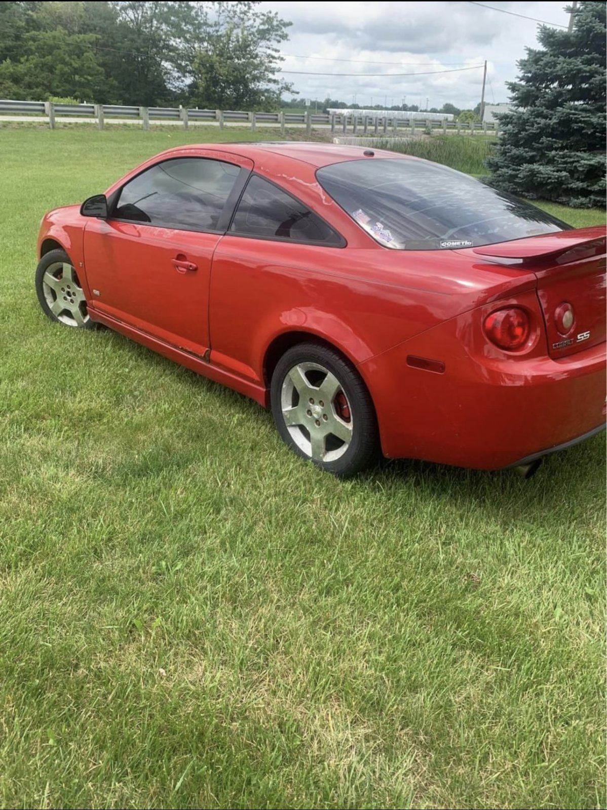

Hello all,
New here and have been looking for a donor for months and I’m having a lot of trouble finding what I want. I don’t want to deal with the auction sites and shipping so I’m looking as local to me (Ohio) as possible. I specifically want an 06-07 SS/NA for the 2.4 and the stronger internals (or so I believe through research). Thinking about picking this one up saturday for the agreed upon price of $2,500. It’s an 06 SS/NA with 146,305 miles. It’s a little more than I want to spend but looks acceptable for the build.
What is your opinion?
Post Description w/ attached pictures;
“Lots of newer parts, runs and drives great. Driver side cv axle is starting to click when turning, check engine light is for evap leak but doesn’t effect drivability”
Question;
After viewing the pictures and from experience, what parts could be sold to recoup some of the money?

But, to give you a more serious answer, that seems like a fine donor, considering your parameters. At that mileage, I'd consider tearing down the engine and giving it a refresh build. You'd probably save some money if you went with IAAI or Copart, but in this age of overpriced used cars, $2500 isn't so bad.
RGSkid70
Since it hasn't been wrecked, you could probably get a couple hundred bucks for various body panels, doors, etc. If you don't mind the hassle of listing each individual piece on marketplace. Seats look to be in good shape. You can either use them in your Goblin or sell them.

Ohio? Evap leak is probably the fuel/evap line pair rusting out. I'm pretty sure that is a SS rear bumper cover but the front looks like a standard replacement. It has no fog lights but I see a fog light switch.
Don't be surprised if you find the fog light wires taped up behind the bumper cover or even the fog lights themselves zip tied to something back there! A local had a G5 with the base Cobalt bumper cover(cheap repair), it glowed out the grill (sometimes?) at night, we found the right fog light zip tied to the sub structure. He left it there, he liked the glow, once he knew what it was.
Potentially everything not needed to build the Goblin can be sold. Some have better luck in different regions, I couldn't get rid of my interior plastic pieces but all other items went pretty easily. It really depends on how much nonsense from The Facebook Marketplace you can handle.

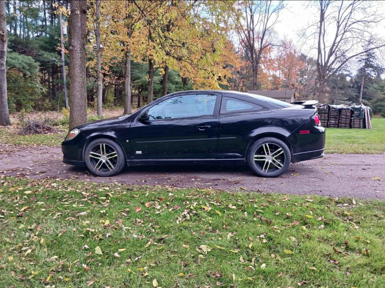

I would pay 1k more for the 72k donor for sure, especially if it isn't as rough overall. You could probably get quite a bit more for the body panels if they're straight and rust free.

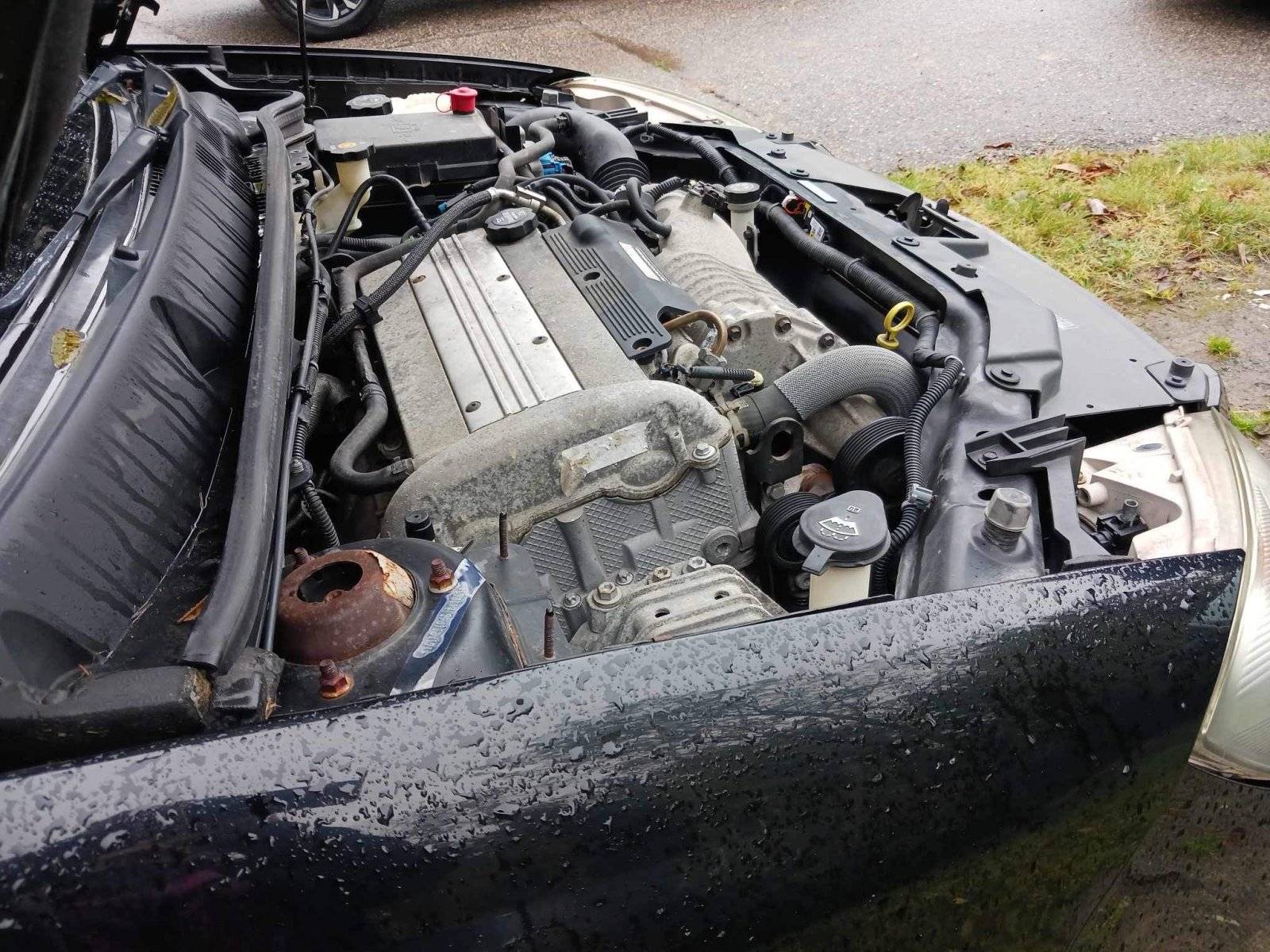

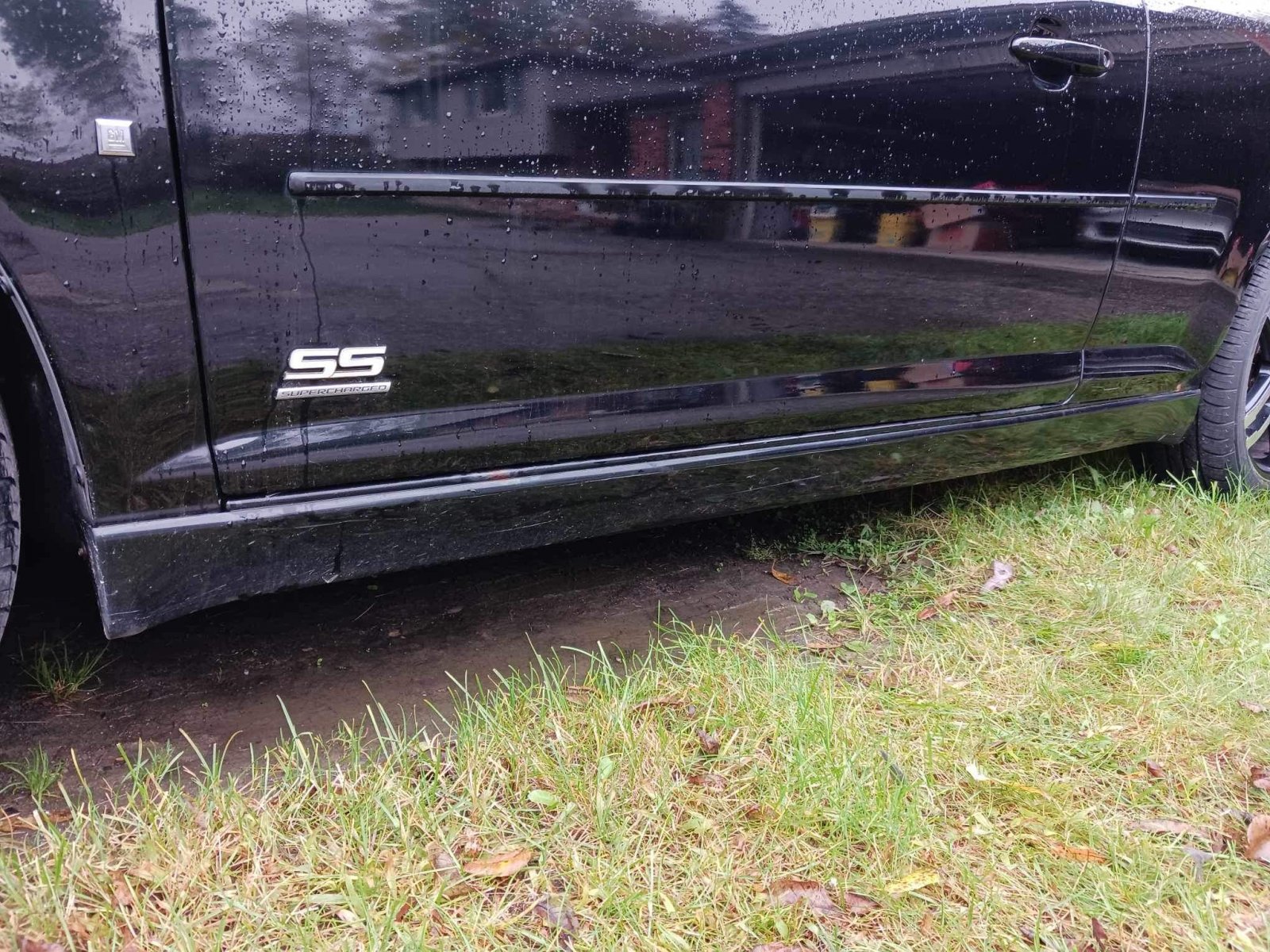

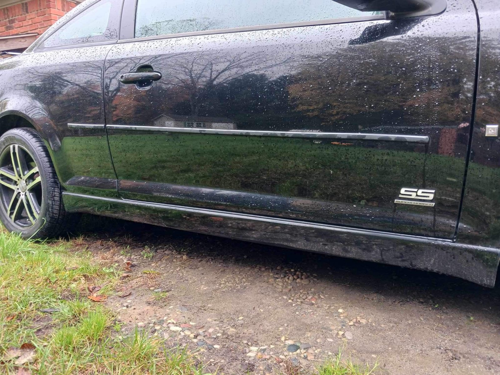

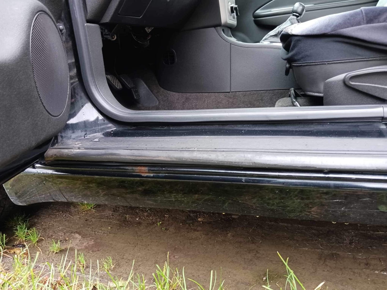

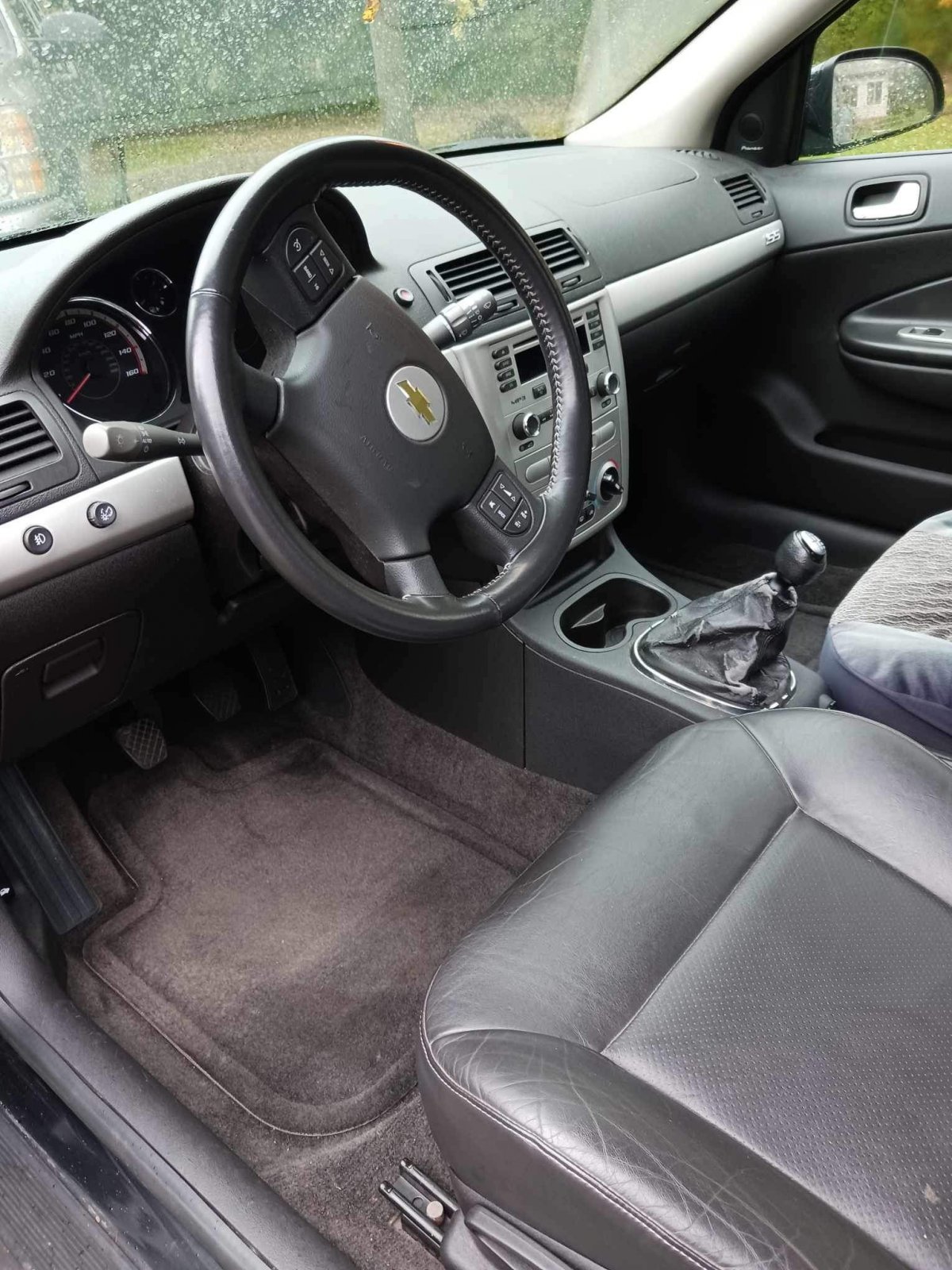

Seller claims floor pan is rusted and rockers are shot. Pictures I have now look great to me. It is in Michigan though and I requested pics of the undercarriage so I’m a little nervous. Once I get the video of it running I’ll haggle on price a little bit they seem firm at 3.5k. Lots of close up pics they sent me. And it even has the red cap on the fuse box!!
I got excited and think I misinterpreted you saying “Tell me about it” as in the car haha

The tell tale is the strut caps in the engine bay. Those are very rusty and they are 2 1/2 feet above the salty Michigan roads. Guaranteed the subframe is completely rusted and the rest of the suspension pieces you would need to use from the donor are very corroded. If the seller is stating the rocker panels are rusted you can bet they are nearly rusted through. Likely he is selling just before they start to buckle, which would drop the price for this car precipitously. The decision on this one is based on the low miles for the drivetrain, which is your biggest expense. The engine and transmission will surface corrosion and the suspension pieces will need clean up or replacement. I would definitely crawl underneath to check on this. Northern donors are destined to have extra expense for corrosion replacements.

Can confirm. I dailyed my Cobalt for years (in Michigan) before I found the Goblin. Rockers were annihilated. I did all new suspension, and even replaced the subframe because of all the rust.
