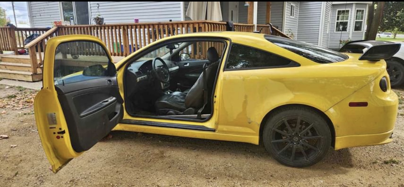

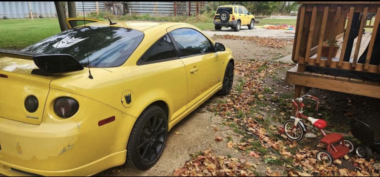

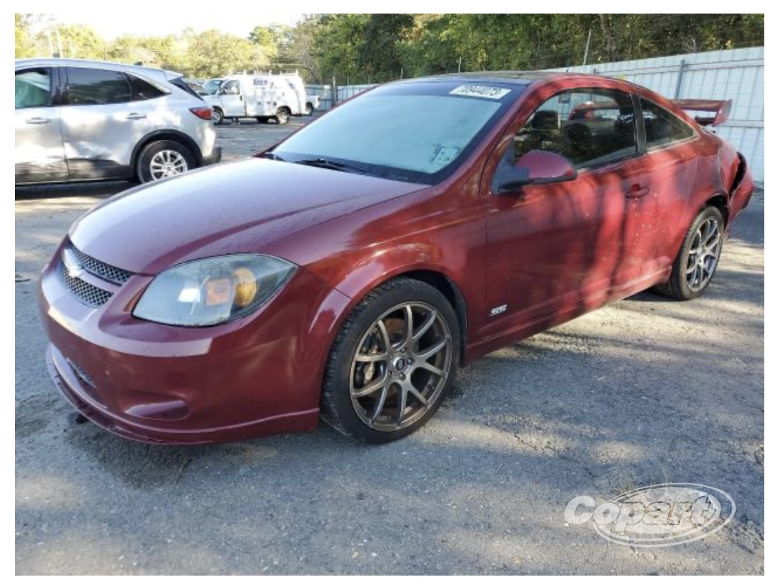

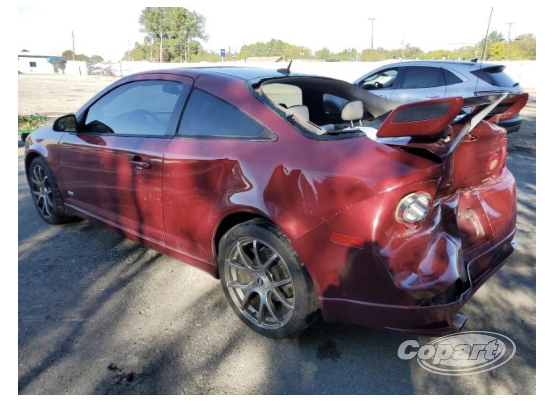

So auction tomorrow for the rear crashed 09 LNF with 95k miles. I just found an 07 SS/SC. It is located in Michigan but has lived in South Carolina for 3 years and has almost no rust. It has 127k miles and body is kind of rough but who cares.
Hypothetically winning the LNF bid around $550-$650 puts me around $2,500 with shipping.
LSJ is $2,500 and I may be able to talk them down a little. It is tuned by ZZP and has 60# injectors.
If both were presented in front of you for the same price, what would you choose?
I’ve been reading up on autocross and it interests me once I get the car built. Other than that the goblin is replacing motorcycles and will be a hobby for me to stay busy and have something I’m proud of to hit the back roads.
pictures of the LSJ (yellow) are not the best but all I have from the post.
