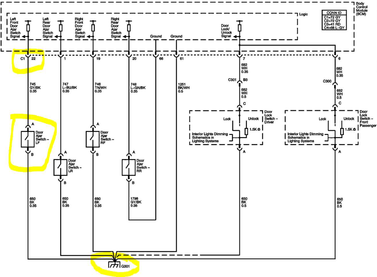

I'm planning on adding a toggle switch to make the BCM think I opened/closed the drivers door. My question is whether the door switch should be NO or NC?
I'm probably putting in a momentary toggle switch so I could just flip it around if I get it wrong the first time but I figure someone might know.

I agree, Normally Open. My Goblin doesn't warn me about a door open, and that door switch wire isn't connected to anything.
Depend on the model of your donor, that door switch does do something. On the earlier models, I think it just turns on/off the dome lights and may effect the security system. On the newer models it may effect, in addition to the others, the RAP (Retaineed Accessory Power) and keep it on for 15minutes after you turn off the car (because it won't ever see you get out of the car).

Just following back up on this, I installed the momentary NO switch between C1/22 and ground: works perfect. I can press the toggle at any time and the car thinks the drivers door opened, so when I turn the key off I can bump the switch to power off the dash cam and AFR gauge.

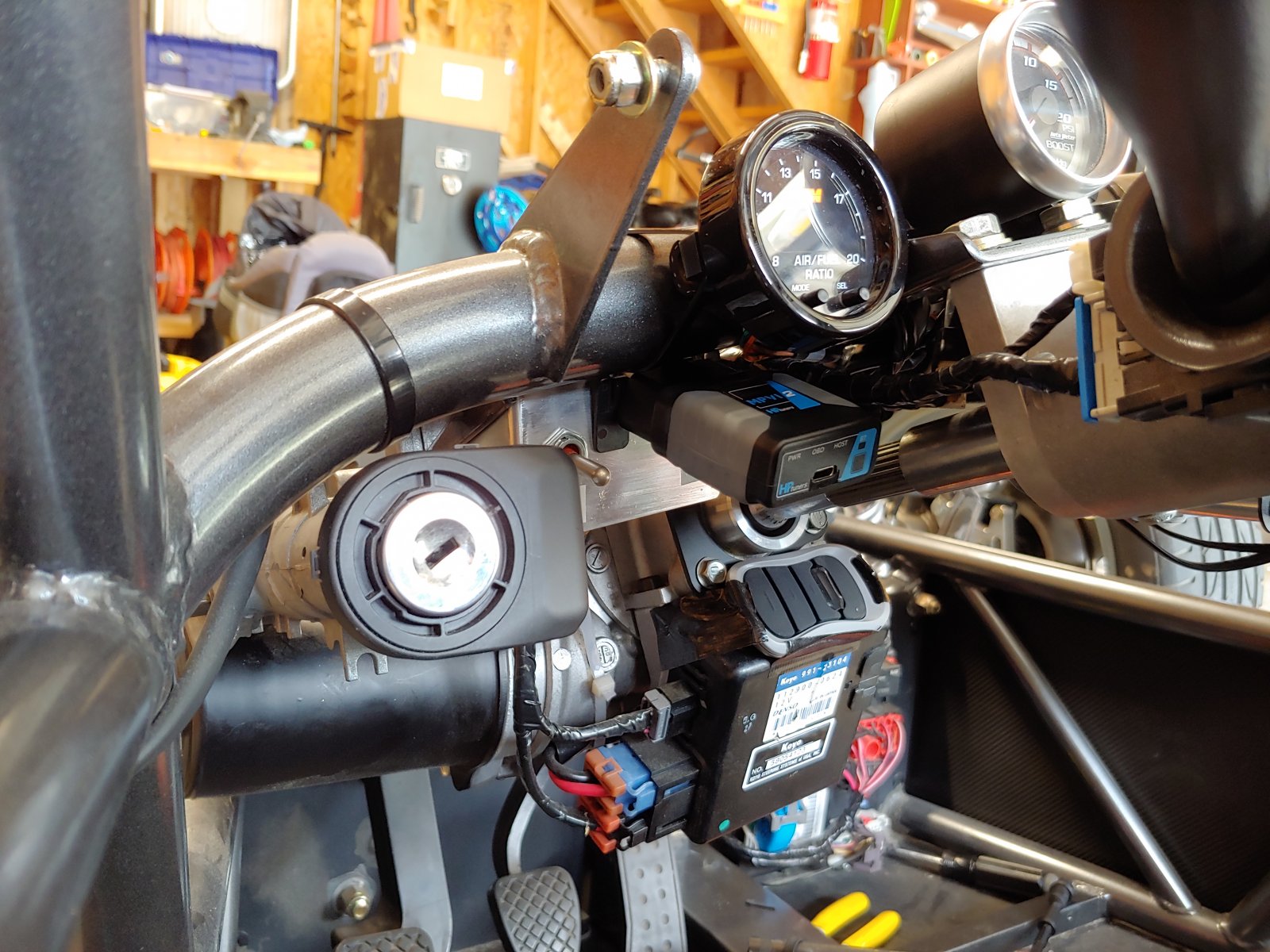

I mounted it on a small aluminum bracket I made that also holds the OBD2 port. Uses the 2 screws for the ignition to mount.
