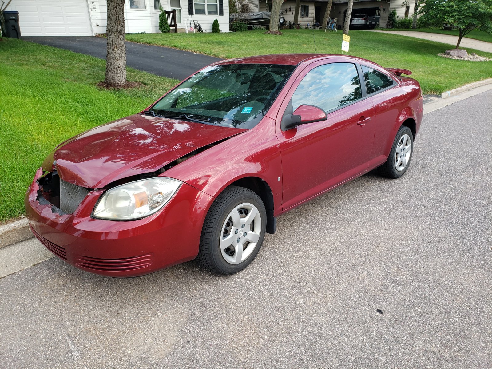

Hello, everyone. Just want to introduce myself. I just put in my order, chassis #182.
I've been following the Goblin for about 18 months and finally pulled the trigger. What sparked my interest was the Caterham Super Seven. After research, the Goblin seemed like the most attainable kit car around. My donor is a maroon 2009 G5 base model. I drove it from Detroit to Wisconsin, and it ran great, but has worn control arm bushings.

Greetings - hey der! Welcome to the forum. The eBay kit would work well for a base model build. It contains all the parts that you would need for the rear suspension on the Goblin - and they are all new parts! Good start to your build, the donor looks to be in pretty good shape. You should be able to recoup some of your cost by selling all of the good body parts, interior parts, etc. Don't forget to LABEL EVERYTHING as you disassemble the donor, keep all of the brake lines, clips, etc. and keep the entire parking brake system. Where are you at in Wisconsin?

I paid $850 for the donor with 96k miles. Bit high for a base donor, but it was exactly what I wanted and it made a 750 mile drive. I'll be reusing everything like seats and steering wheel. Hoping to sell some body parts, but this color seems rare. It is surprisingly not too rusty for spending a decade in Detroit.

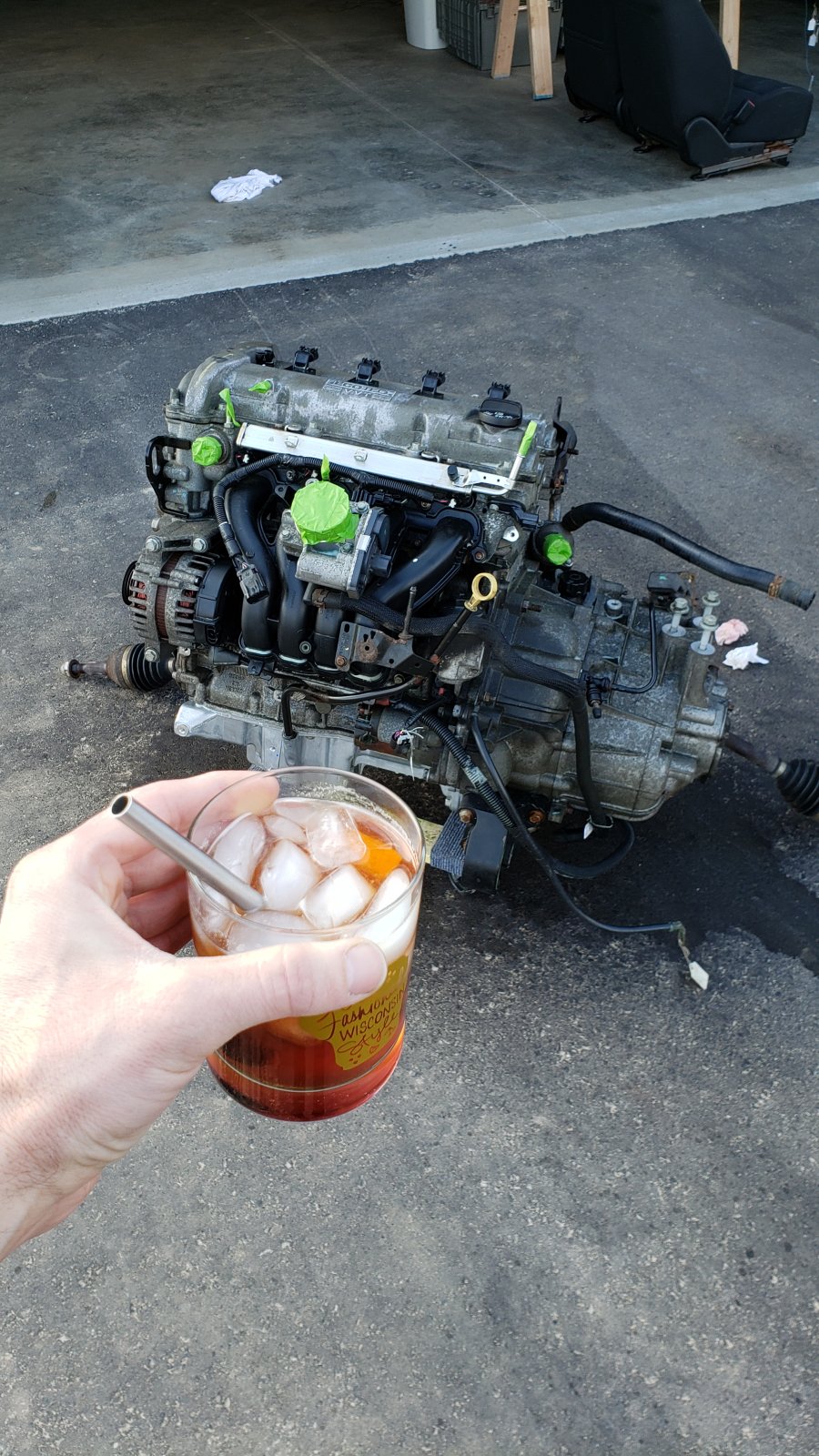

Donor is fully stripped and in my driveway waiting to be dragged away.

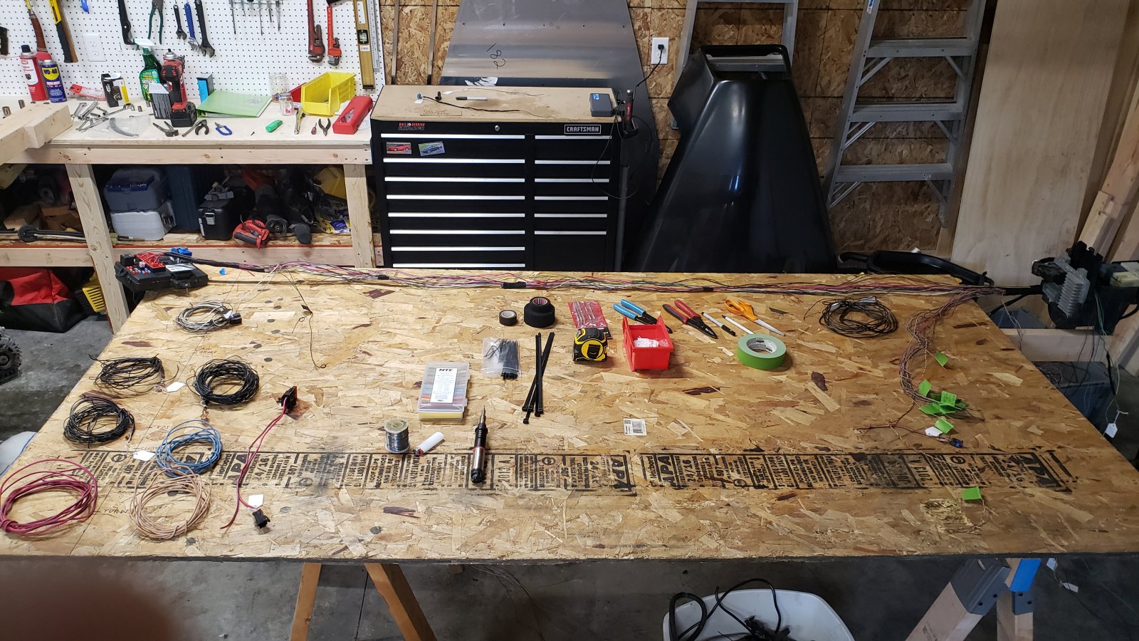

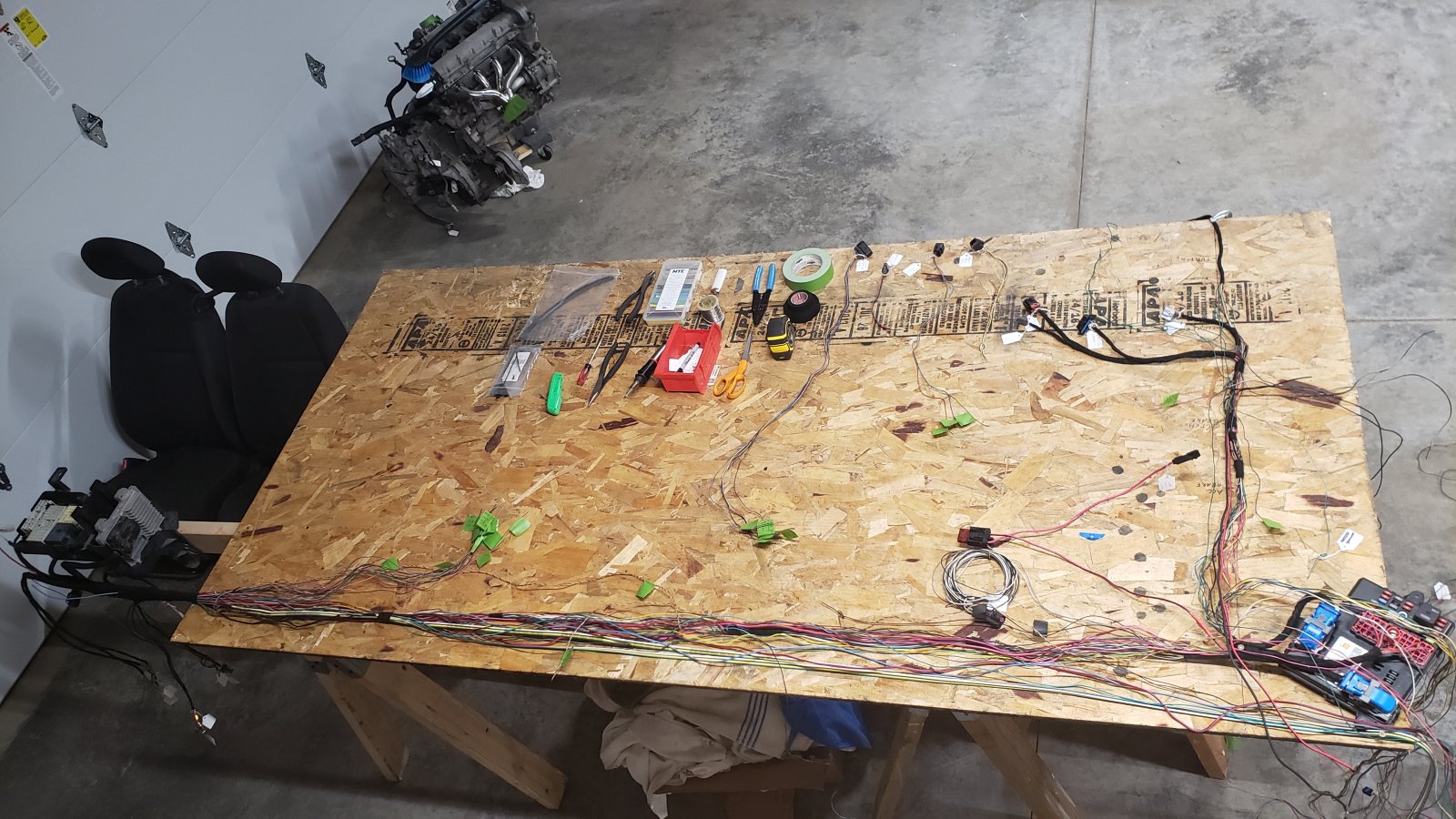

Engine harness is thinned and taped.
Body harness is thinned and part way organized.

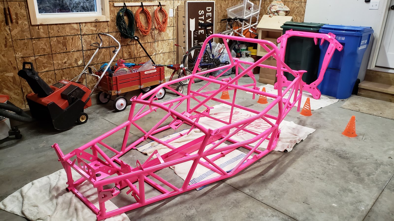

Chassis is at powder coating.

Harness is complete to the end of the newest video. It went great so far despite the differences between the video turbo harness and my N/A. I could probably finish on my own, but I'll hold out until the next video is released.

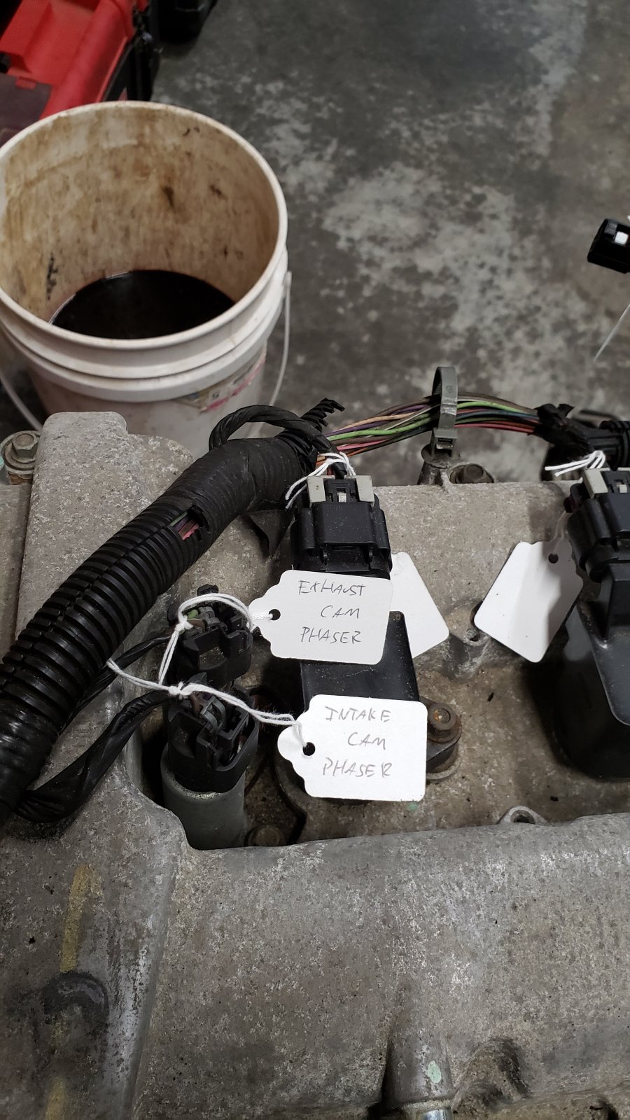

The labels I used are little white cardstock on a string. Cheap on ebay. Used almost 160 total.20200312_180709.jpg

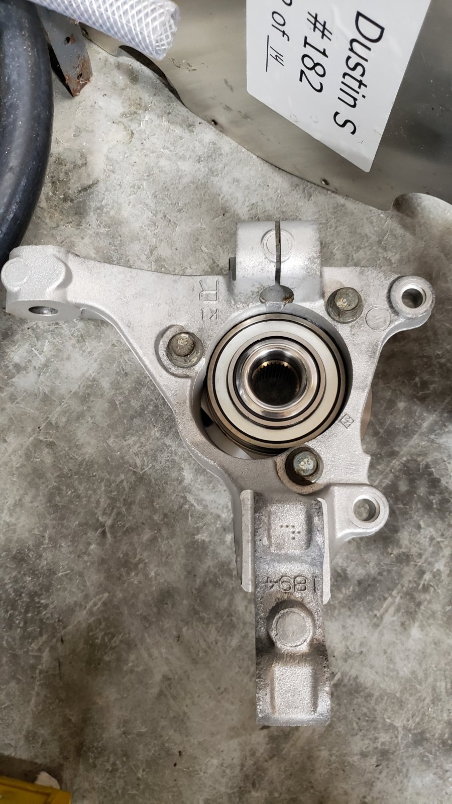

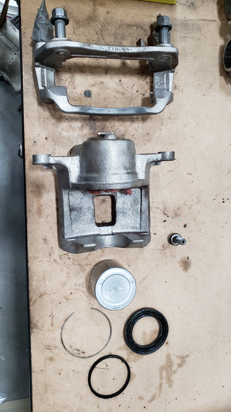

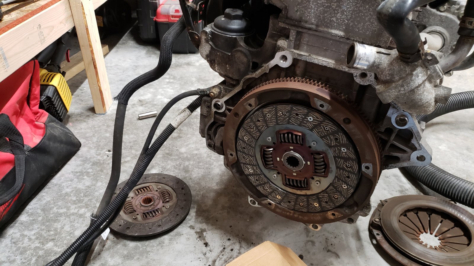

I decided to rebuild my calipers so I can sandblast and get a good coat of paint on them. I scrubbed the motor, but I won't do too much more to clean it up. I blasted my knuckles and they look great. Threw the new clutch on. Axles, control arms, brakes, bearing hubs and several other new parts are here.

Dustin, great work! And WOW your frame is incredible! It really pops and will surely be one of kind. BTW, where do you get the Devil's Lake State Park sign...or should I not ask. Was a favorite of mine for rock climbing and rappelling when I was much younger.
You have one heck of a start!!!!!
Takes a REAL man do do some pink like that!
That clutch plate is looking like it is begging for some road time.
The parts are looking great.
And the piece of fuel line for the straw is just rocking! ;)
I'm sure a lot of people are thinking you're crazy, but I think that frame color is awesome. If I would have gone with that color, I'd have done a lime green zebra stripe theme.
I know you're just getting started and a wrap is the least of your worries now, but I can't wait to see what you do with it.

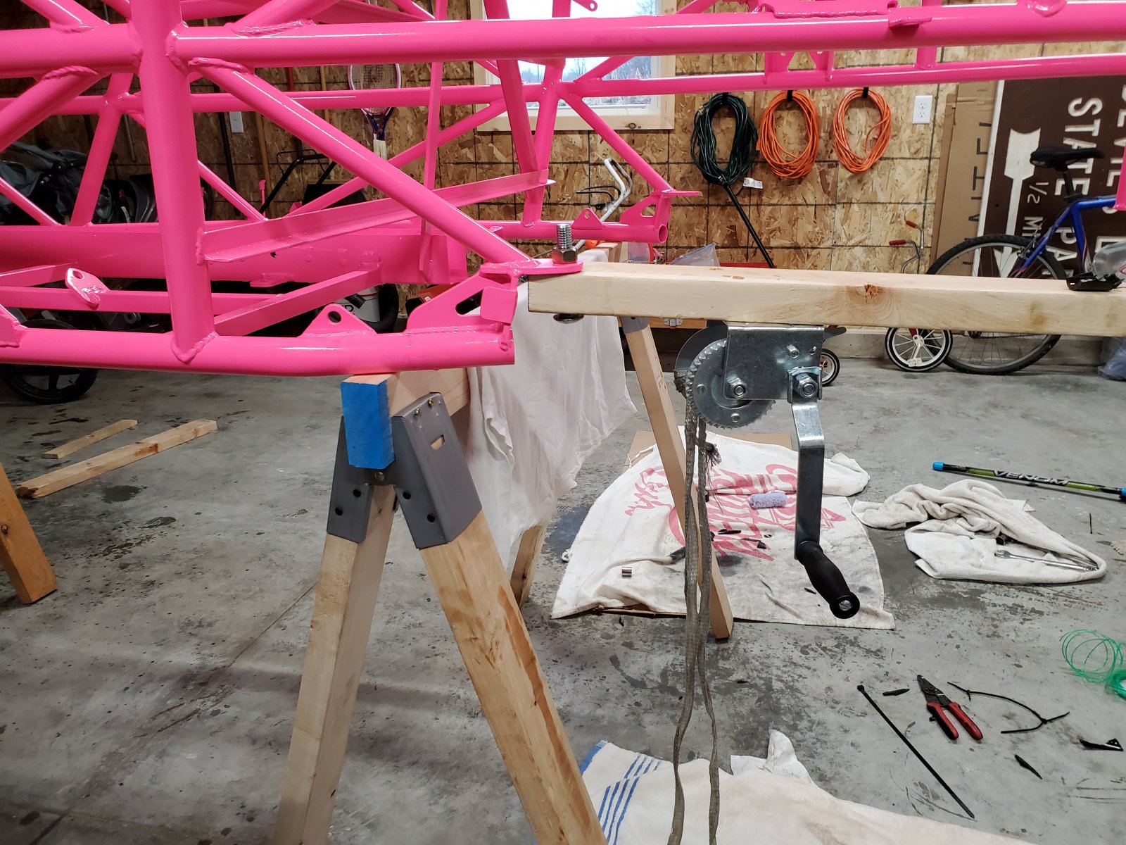

Had a hard day today. Hopefully I can save people some screwing around. I spent 6 hours today without getting the hoses through the frame and I'm covered in a slippery liquid that smells like stripper pee.
Don't even try to pull the hoses through yourself. Go get a boat winch and some fiberglass pull tape. Your back will thank you. I should have done this when I woke up this morning.
This is a manual version ripoff of what DF sells. I unabashedly stole the idea.
As far as preventing the hose from breaking, I can't help you there yet. I've lost count of how many times I broke it. Tomorrow I'm going to crank the garage heater to get everything warm. I'll have to run down more hose for the second side.
Wish me luck. Today sucked.
