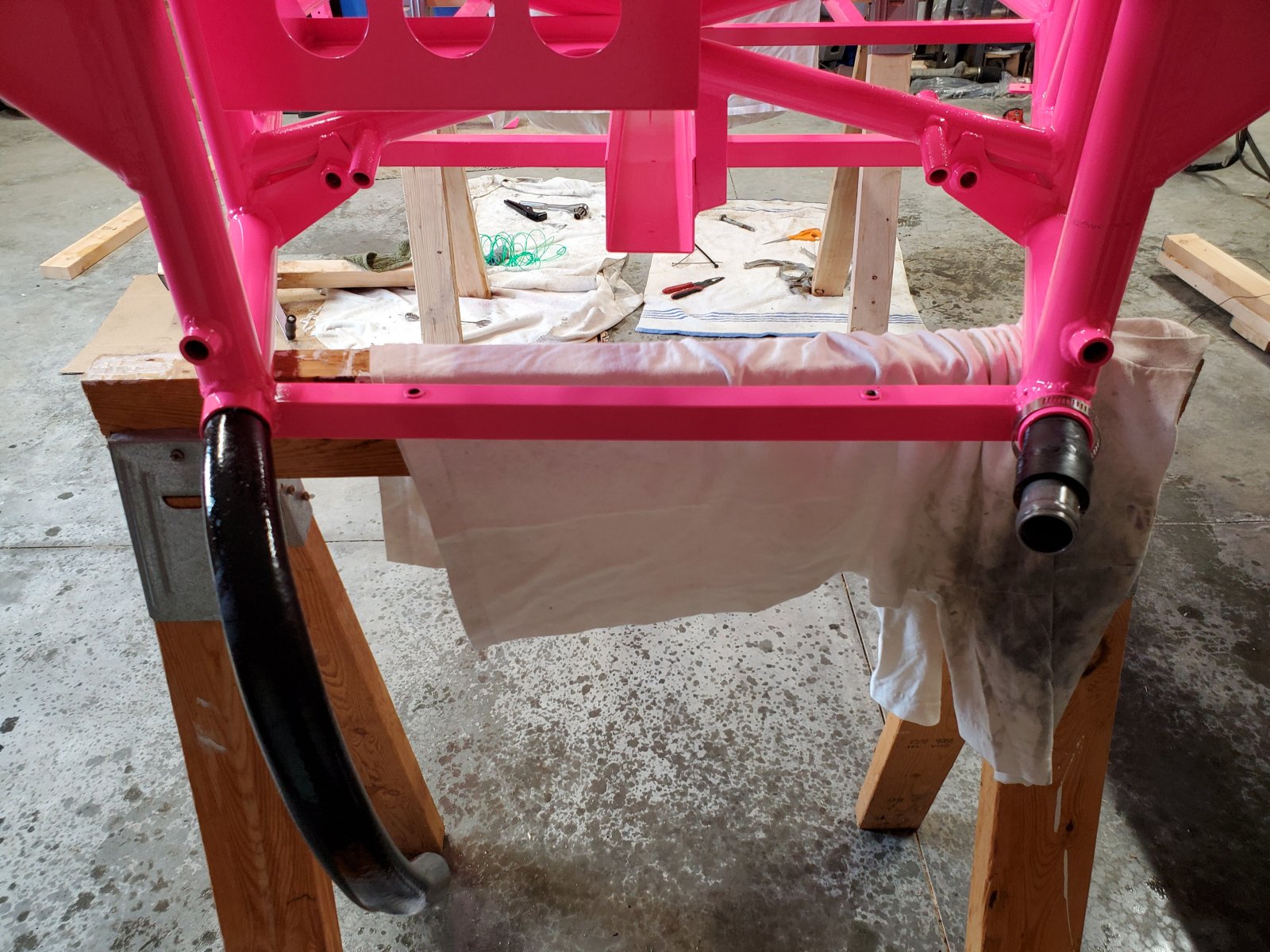

Use lots of lube.... lots and lots of lube. I poured it directly into the tube and soaked the whole inside before putting it in. (No "The Office" remarks.)
D

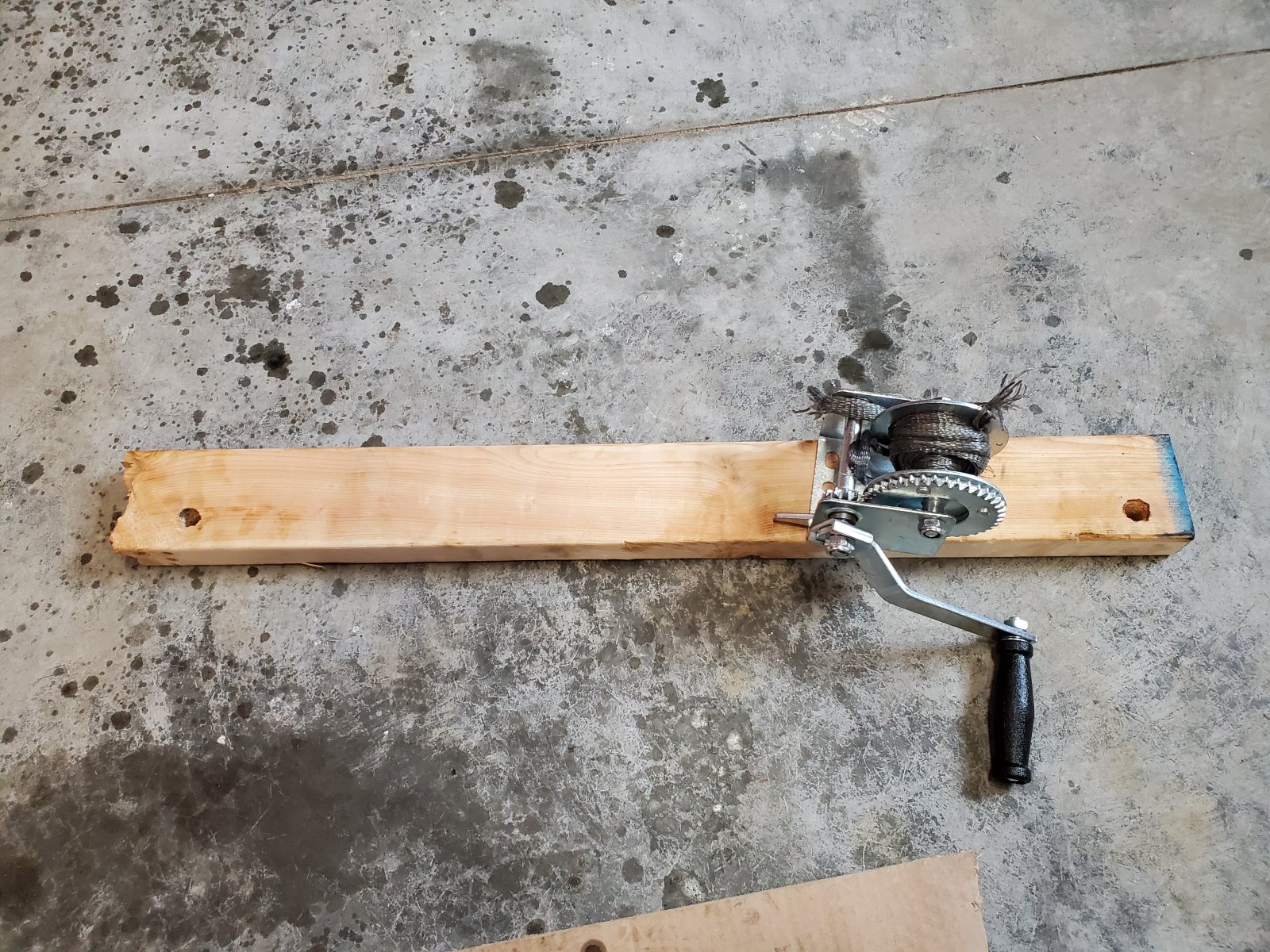

Had success today. Each one snapped again once before making it through. Somehow I had enough to do both and a foot left over. Big thanks to DF for including plenty of extra hose. Also, big thanks to my wife for being positive and encouraging through the ordeal.
Copy this setup for an easy way to tug the hoses through:

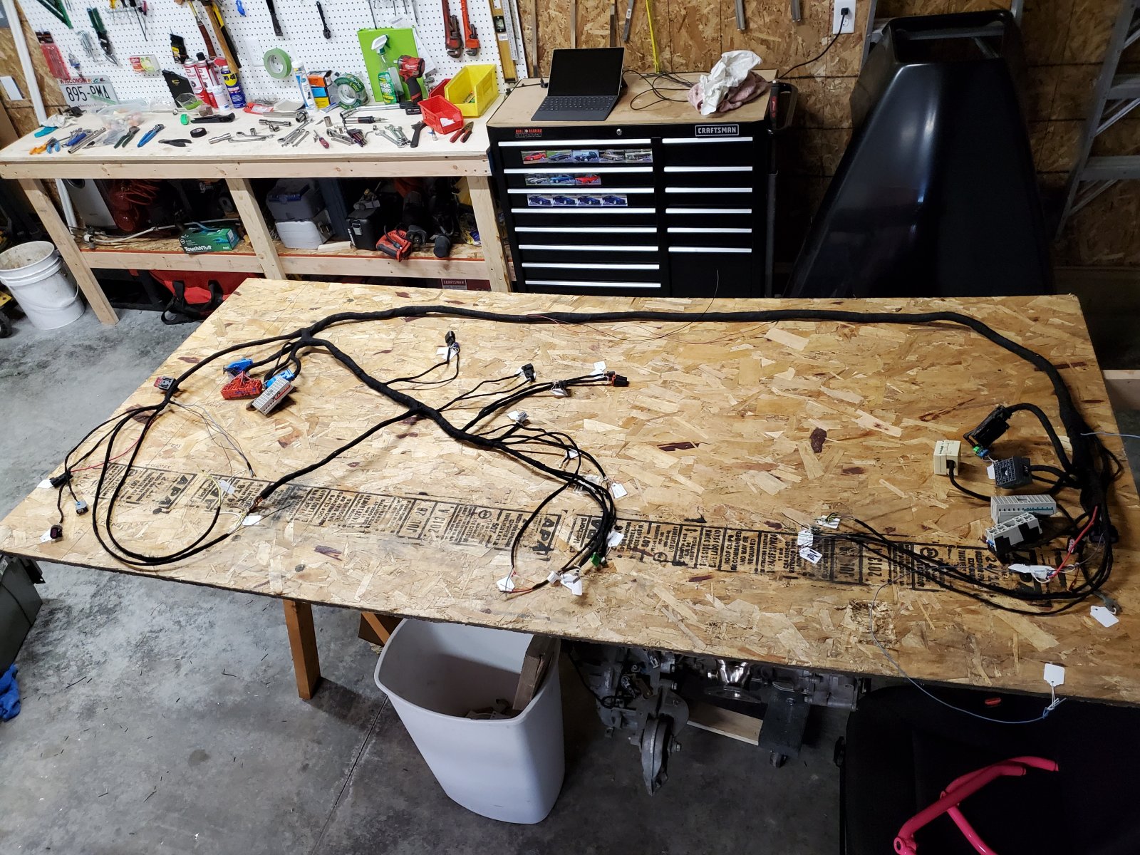

Got the harness done today! The new videos are great! Should get fuel tank and aluminum sheets back early this week. Going to push hard to finish by the end of May/early June.

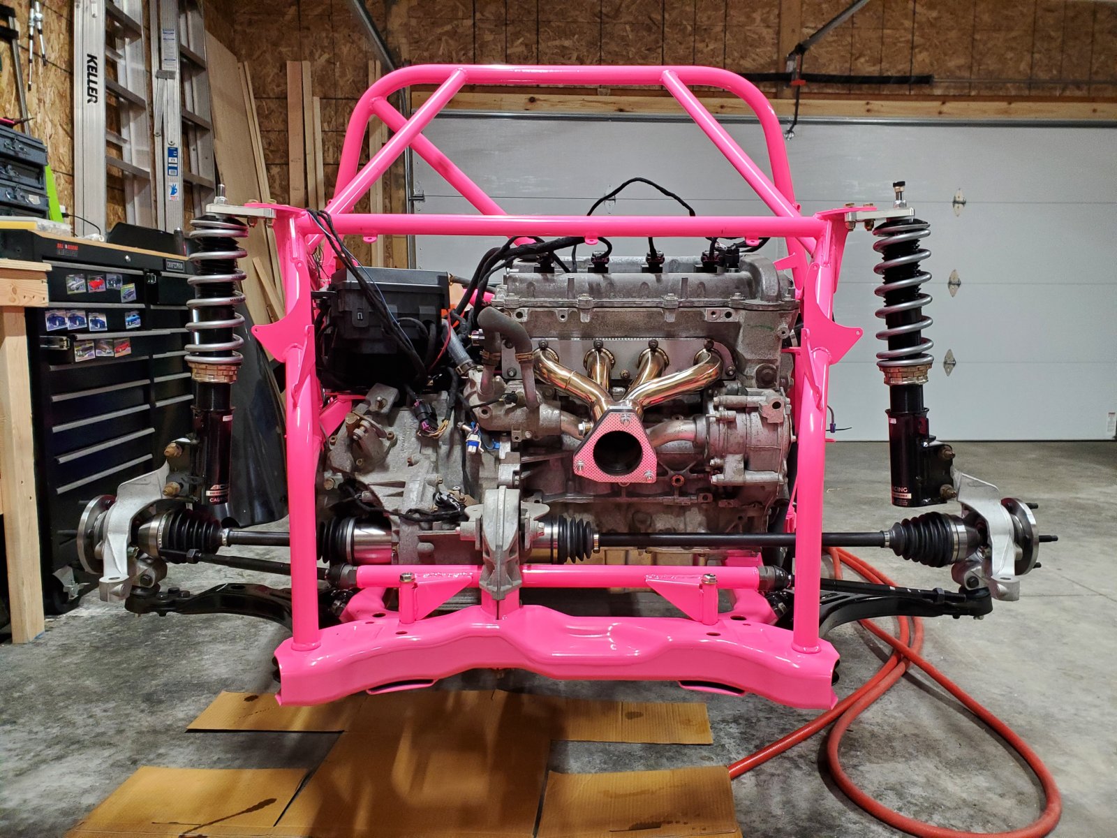

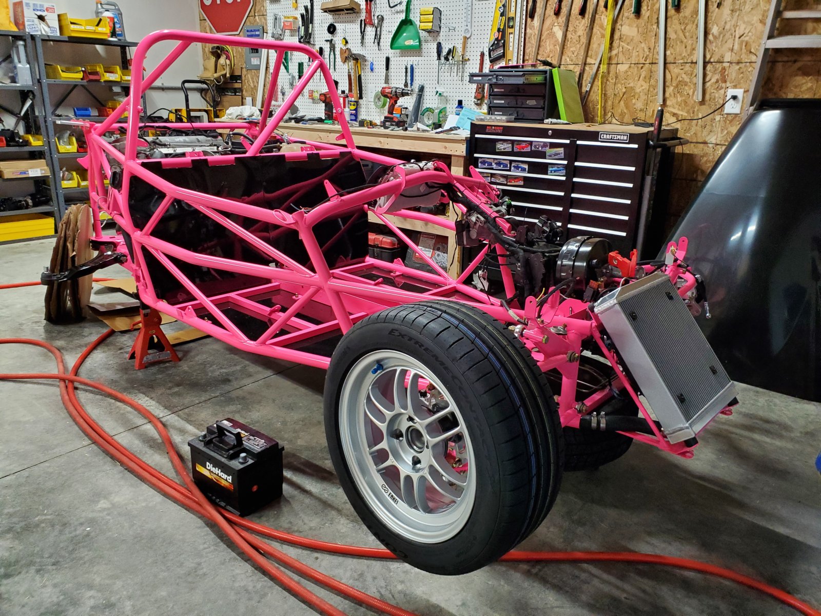

I got the rear suspension mostly together tonight. Also, 3/4 of my wheel/tire combo showed up. 15" RPF1 with 205/50 Continental extreme contacts. I spent a lot of time looking at wheels, but weight, affordability, and diameter were on my mind because I have an XFE car with the taller final drive. This was a bit of a no-brainer on the end.
1
Karter2026
Looks great! If you keep the tire at the same height with the rear gears you wont loose anything with those gears. Here is a great tool to figure size differences from stock. Use the compare tab on the Tire Size Calculator

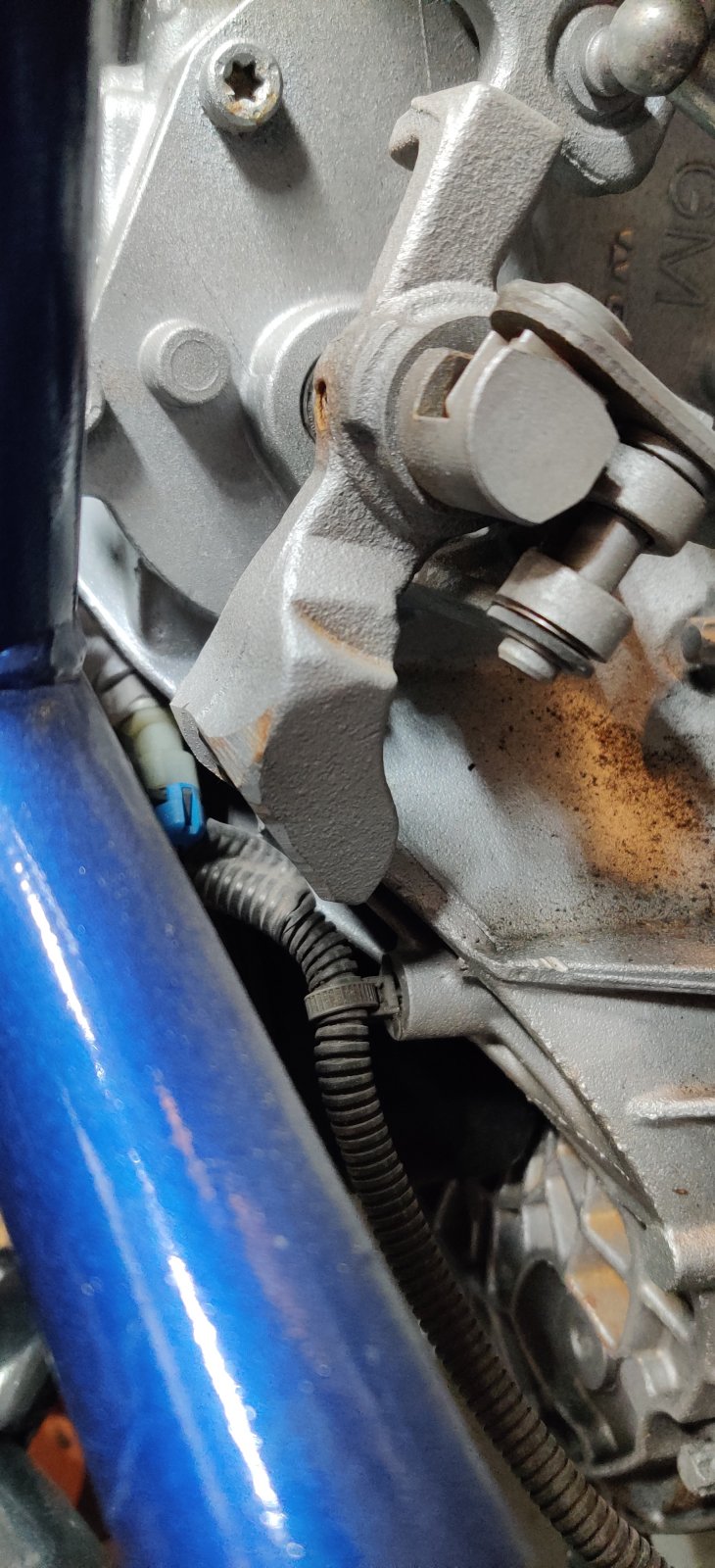

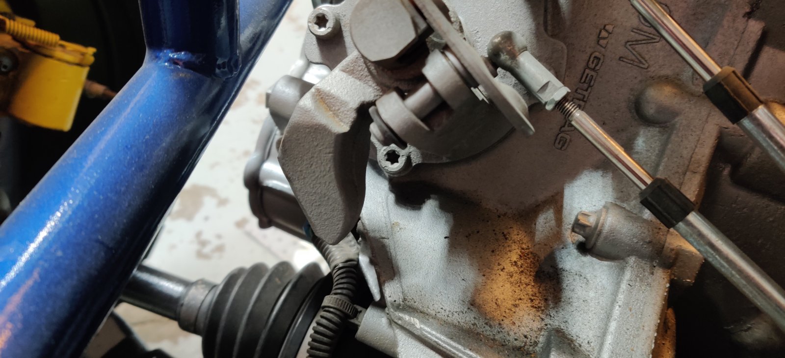

Now for the bad part. As I looked at your pictures things flash back to me. The bottom of the shift arm counterweight needs to be cut off It will not clear the frame rail when you put it in reverse. Before you get anything else in the way now is the time to do it ( well actually a lot earlier was the time) Tape up the frame rails beforehand. Here is an idea of how much you will have to cut off.
View attachment 13429 View attachment 13430
Thanks for the heads up and the pics! I'm a little disappointed I didnt know this. I'll try to knock that out tonight. I have a couple different tools to try.

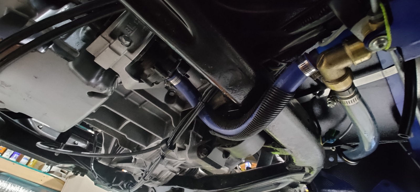

Question for the group, did you run your shifter cables over the front subframe member or under? Trying to decide how I want to secure them up. I went under, and I think I might swap around.

Everything on mine went over the top except for the heat exchanger tubes I just added. Just not enough room. If you look at top left of picture those are the shift cables.
D
Thanks for the picture Karter. I moved mine over and it makes way more sense.

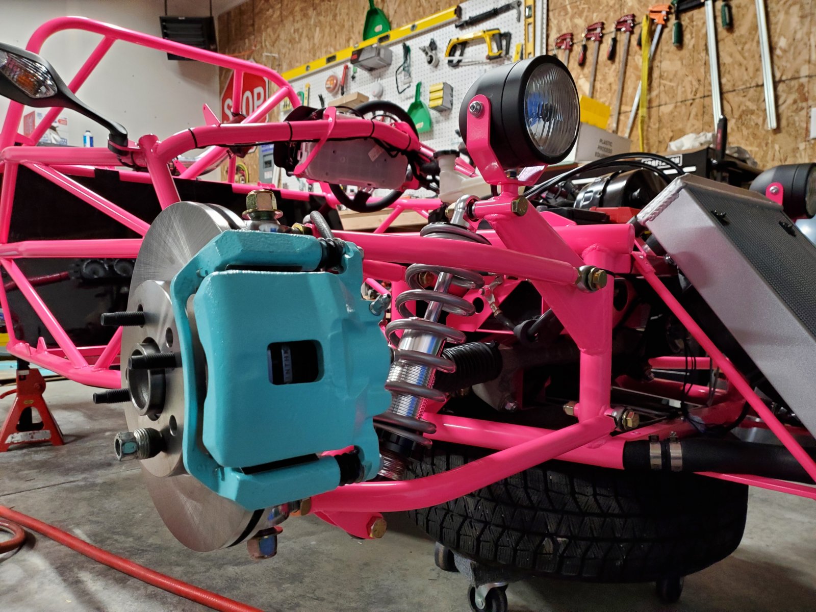

Had a big setback today that I should have researched a bit more. The RPF1s hit the front calipers. Going to take the calipers to work and try to machine or grind them down.
Wish I would have found this two weeks earlier: http://dfkitcar.com/forum/index.php?threads/canyons-trackframe-lsj-t-htown.225/post-5647
