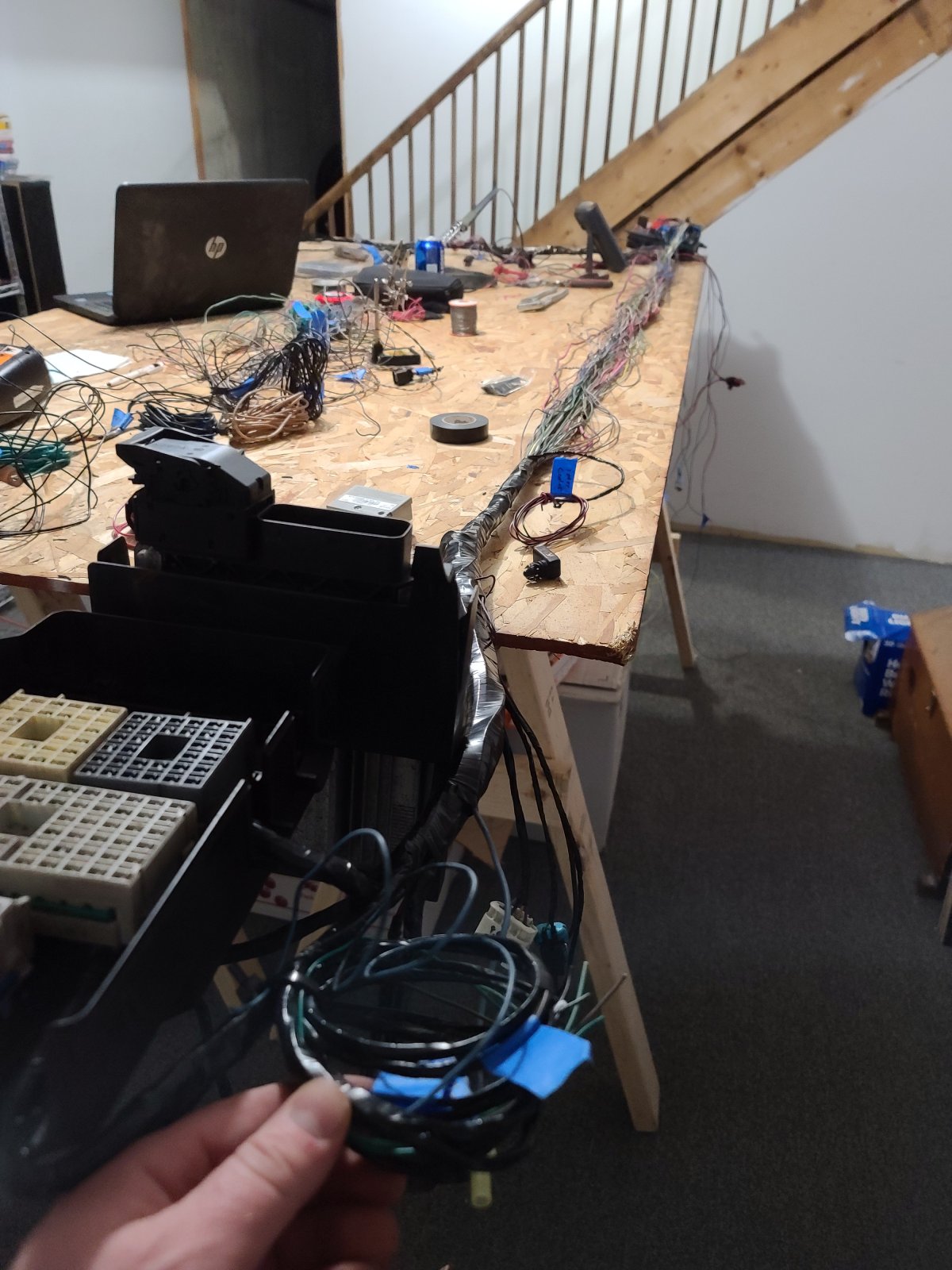

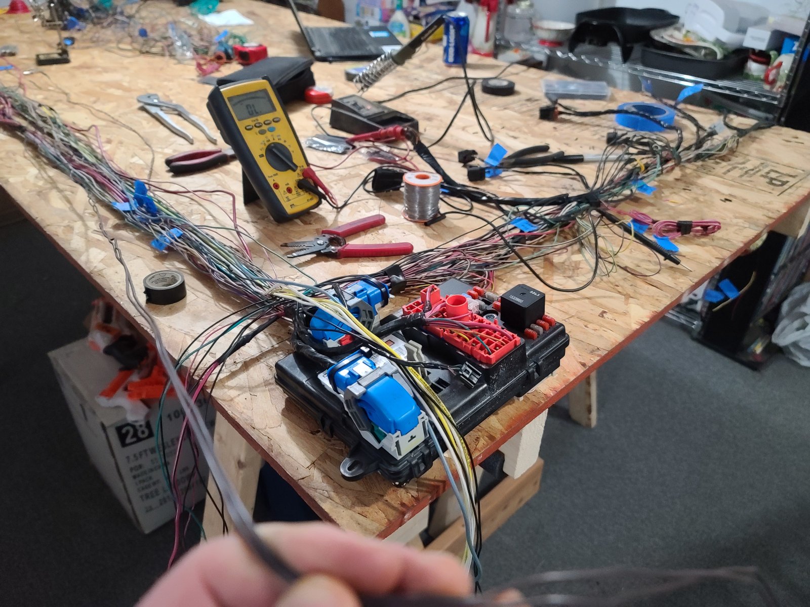

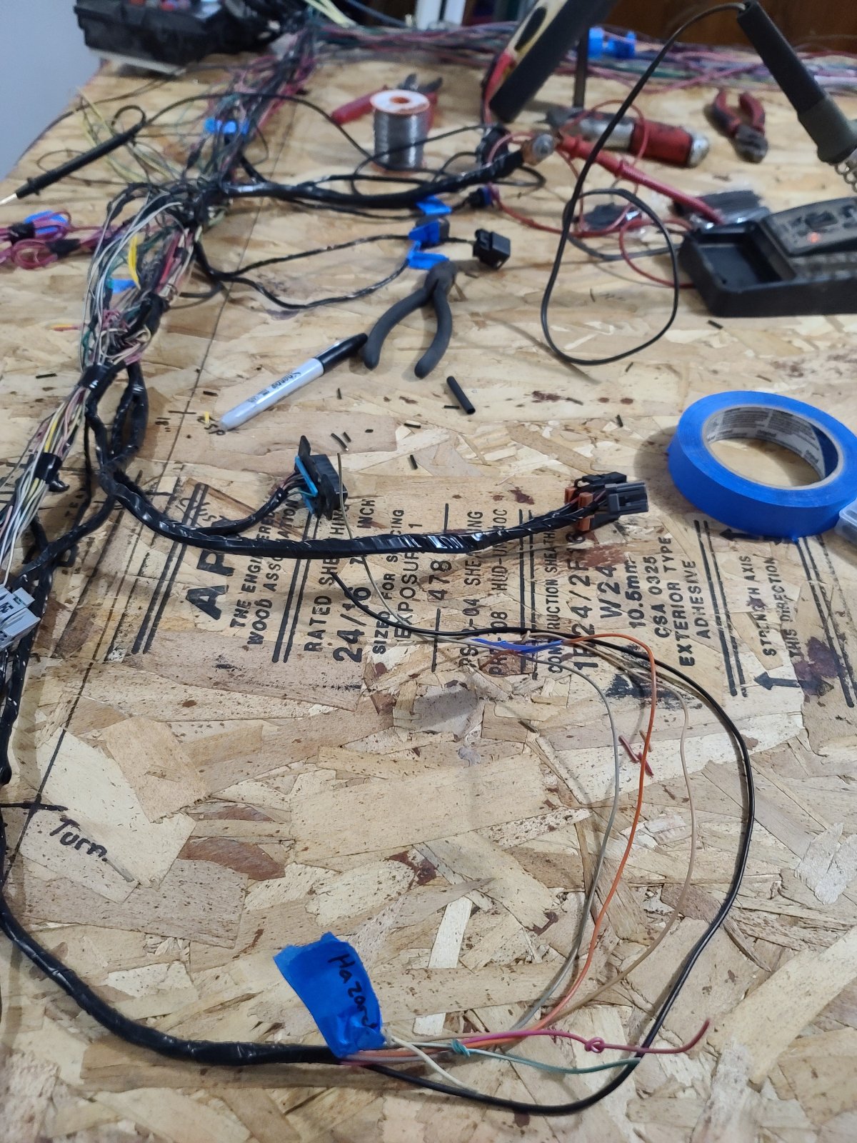

Nearing the end of harness build I have 2 brown wires coming off this junction I had labeled one rear tail light and the other plate light, they are headed to the bcm from ecm end of harness do I simply cut them out or did I miss something

Those are for your running lights. You should have one for each of your taillights, plus license plate light. Don't cut them out, you need them.
TheDon
I've already bundled the taillights and plate light with a brown wire each, I was thinking the ones in question went to the front or dash somewhere?

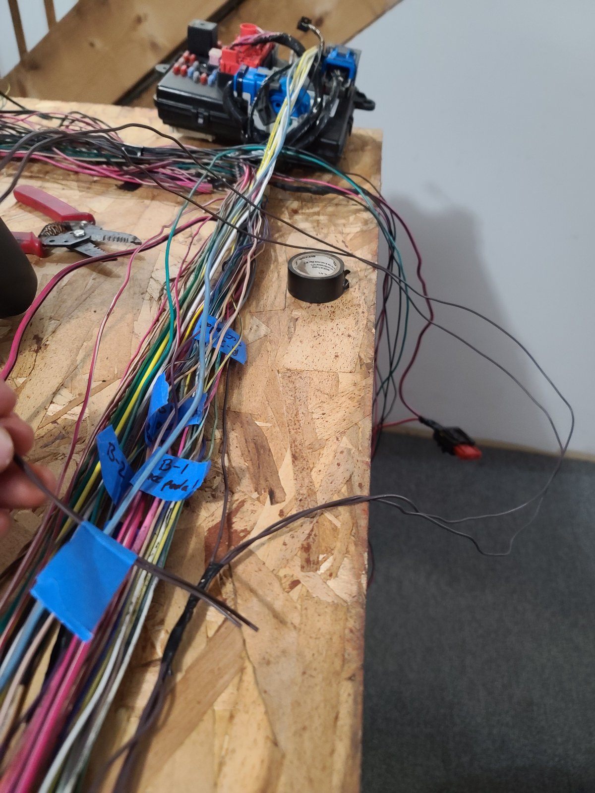

Yea that's what I was originally thinking,
Just did some unwrapping the mirrors get brown off the long extension wires 10' and 14', none go to headlights
Brown wires in question have continuity to brown wires bundled near taillights so they are running lights but not the brown that the red extensions were soldier on
