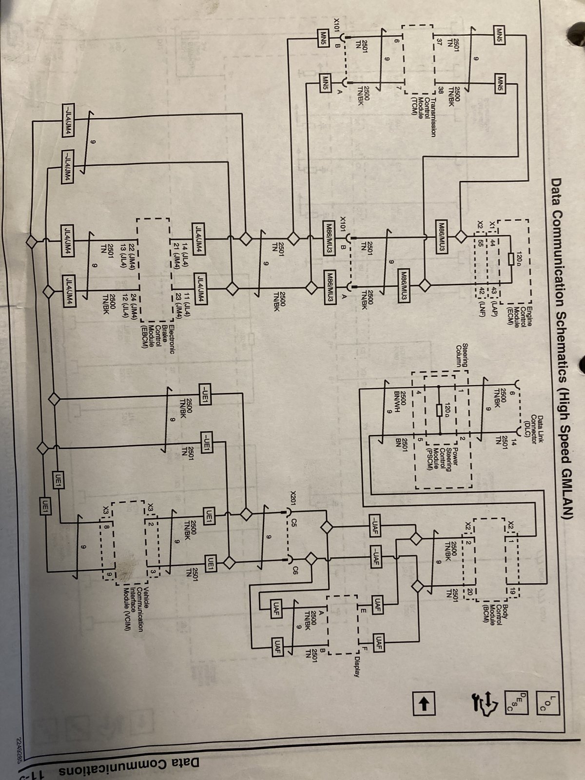

Group I have an extra set of tan twisted wires coming from my engine connector I cut it and I am not sure where it goes. I do have the BCM to ECM twisted tans for c5 and c6 connected. I’m not sure if these are extra….
2008 base mode ls 2.2 manual.
High speed GMLAN

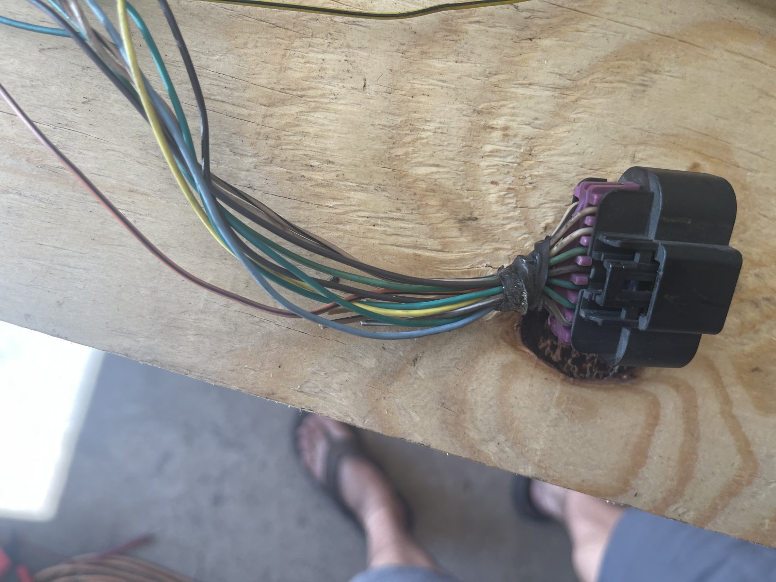

This is the engine connector I am referring too its the one that is in the rear near the fuse box and connects to the engine harness The picture is from before when I cut the two tan twisted wires I have sense put them back on the connector but they go nowhere right now since I was not sure

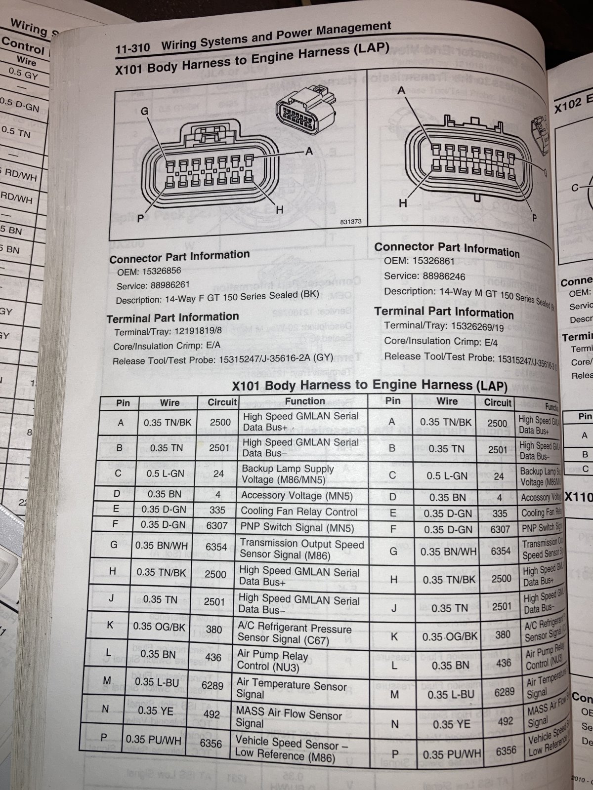

That’s connector X101. Pins A and B show up in the previous posted diagram. Pins H and J are also GMLAN but I looked through every wiring diagram in the manuals and didn’t find them used anywhere. I don’t know if I missed something, they are mislabeled in a diagram, or are just unused wires. That connector is not used on the Turbo and I can’t think of any other module beyond the ones on the posted GMLAN diagram that it would run to.
