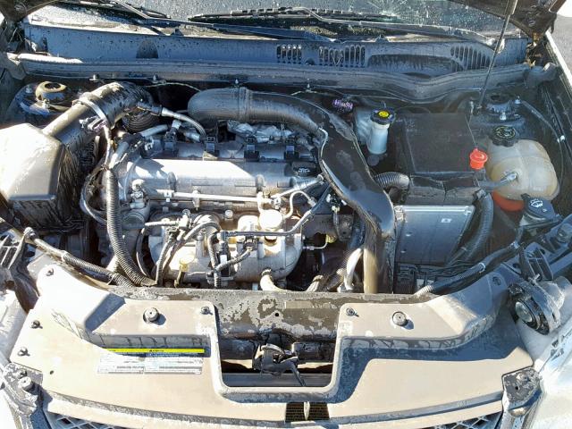

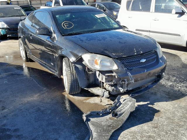

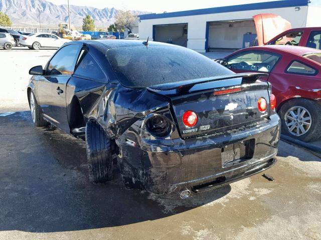

BTW, I am 1 step closer today to ordering, I purchased a donor 2008 SS/TC out of El Paso on Copart, so I will be starting the stripping process in about 10 days or so. It's all good!

Photos of my purchase.
