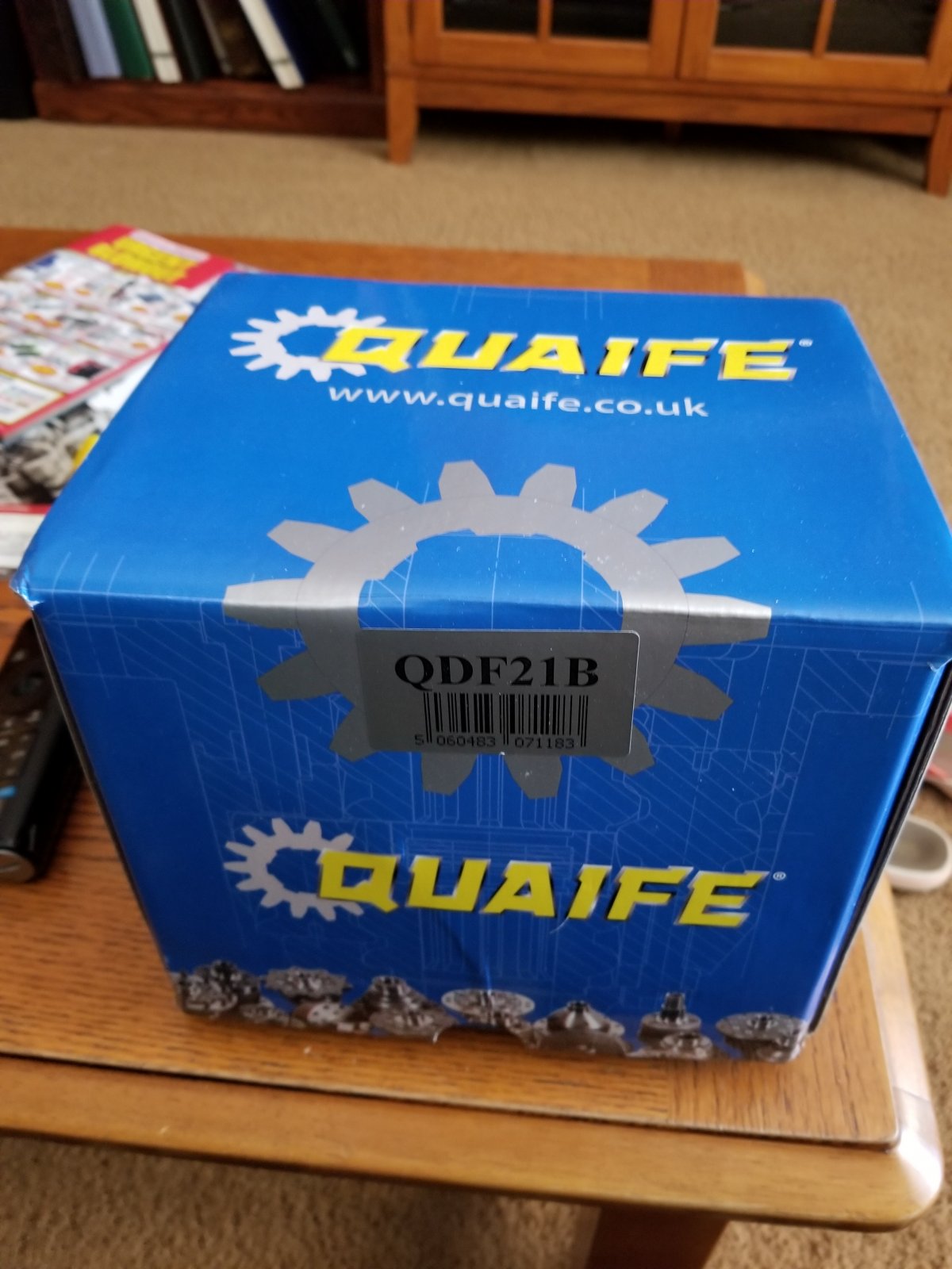

This the LSD I purchased (see pic) after much discussion with WG Motorparts in England - on eBay - about getting the correct one for the Buick Regal GS F40 version. I put some info about my purchase experience in my build log.
